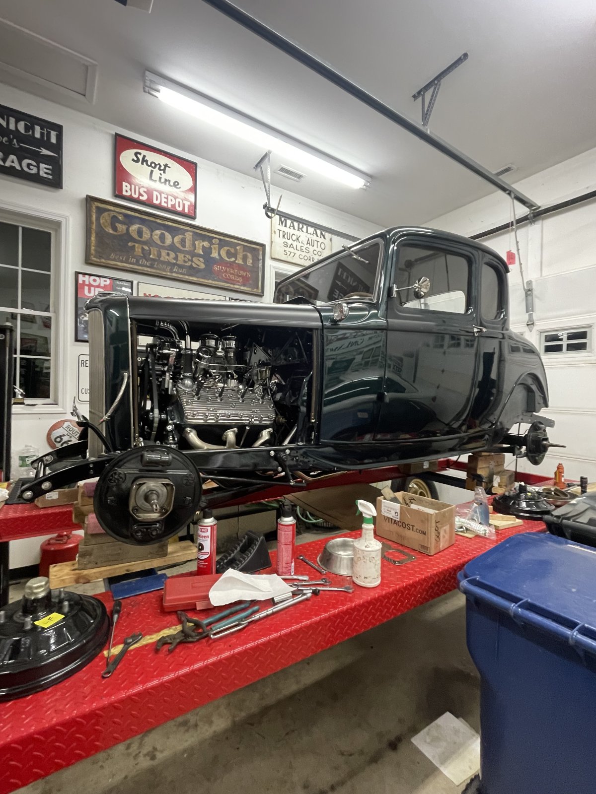

  4. ct1932ford
    Joined: Dec 3, 2010
    Posts: 13,501
    ct1932ford

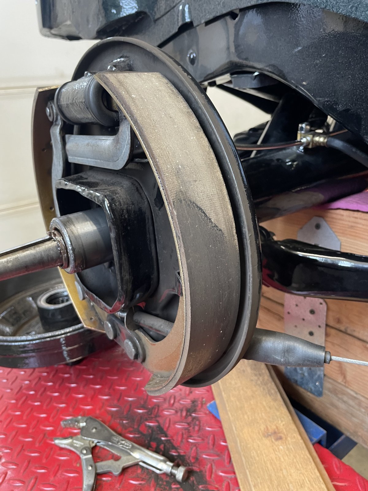

  7. ct1932ford
    Joined: Dec 3, 2010
    Posts: 13,501
    ct1932ford
    On to brakes etc. I can see why it stopped like ****. IMG_5557.jpeg IMG_5550.jpeg

  8. ct1932ford
    Joined: Dec 3, 2010
    Posts: 13,501
    ct1932ford

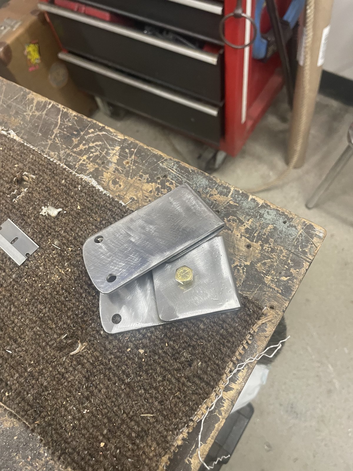

  9. ct1932ford
    Joined: Dec 3, 2010
    Posts: 13,501
    ct1932ford
    Making rear mounts for hood hold downs. IMG_5571.jpeg IMG_5573.jpeg IMG_5574.jpeg IMG_5575.jpeg IMG_5576.jpeg

  11. Duke
    Joined: Mar 21, 2001
    Posts: 937
    Duke
    What are the dimensions and thickness of the hood hold downs? Does the bolt just act as a set screw or go into a hole in the frame? Thank you
    The37Kid and Stogy like this.
  12. ct1932ford
    Joined: Dec 3, 2010
    Posts: 13,501
    ct1932ford
    Made them from 2” wide x 1/8” thick flat stock. Yes the bolt is just a set screw. No extra holes in frame and easy to remove when not running a hood. I made a set like these on my roadster and the work great.

  13. Duke
    Posts: 937
    Duke
    Thank you! How long is the upper piece? I need to build a set for my roadster
    Stogy likes this.
  14. ct1932ford
    Joined: Dec 3, 2010
    Posts: 13,501
    ct1932ford
    It is 3-3/4 long on top!

  16. Duke
    Posts: 937
    Duke
    Thank you! A copy will be making their way onto my car.

  17. ct1932ford
    Joined: Dec 3, 2010
    Posts: 13,501
    ct1932ford
    What's nice about my design is no extra holes in frame. Like to see them when finished.

  18. Happydaze
    Joined: Aug 21, 2009
    Posts: 2,485
    Happydaze
    Golly, there was more of the brakes not working than working! Should be capable of huge improvement. Makes you wonder how anyone could leave them like that / live with it ( or even risk dieing by it!). Probably wasn't driven much, possibly for that reason?

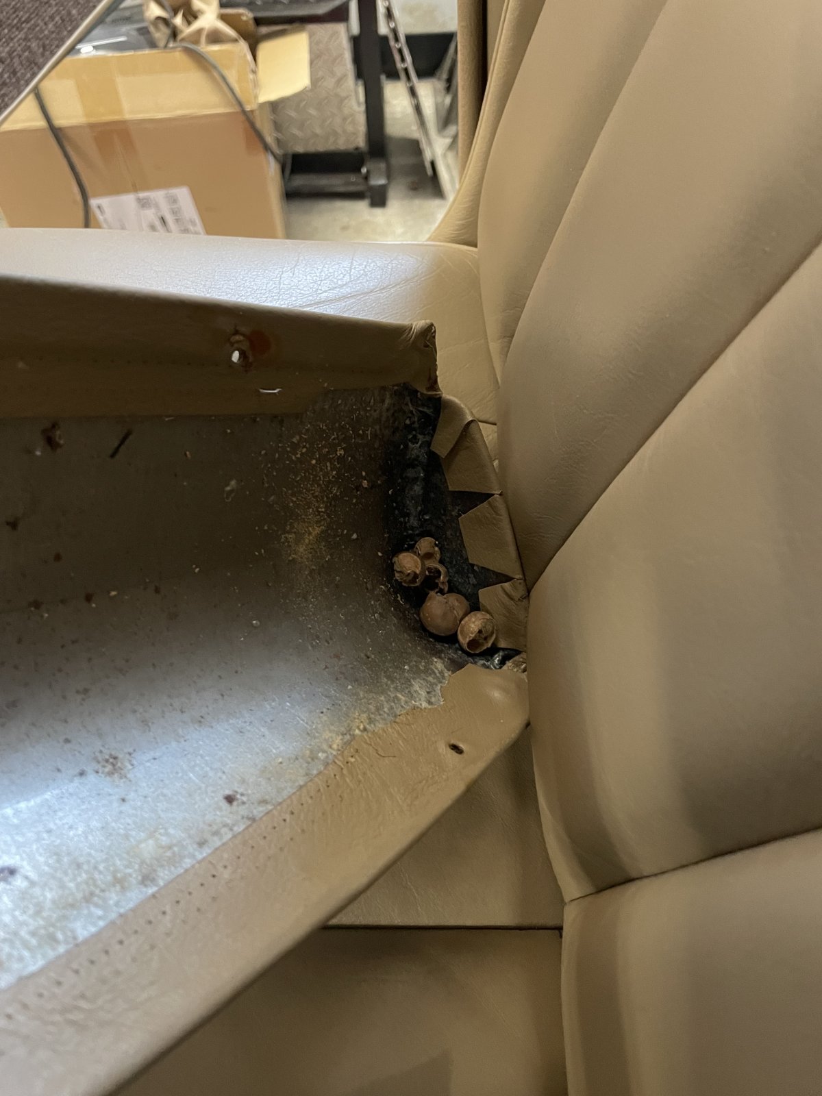

  22. ct1932ford
    Joined: Dec 3, 2010
    Posts: 13,501
    ct1932ford

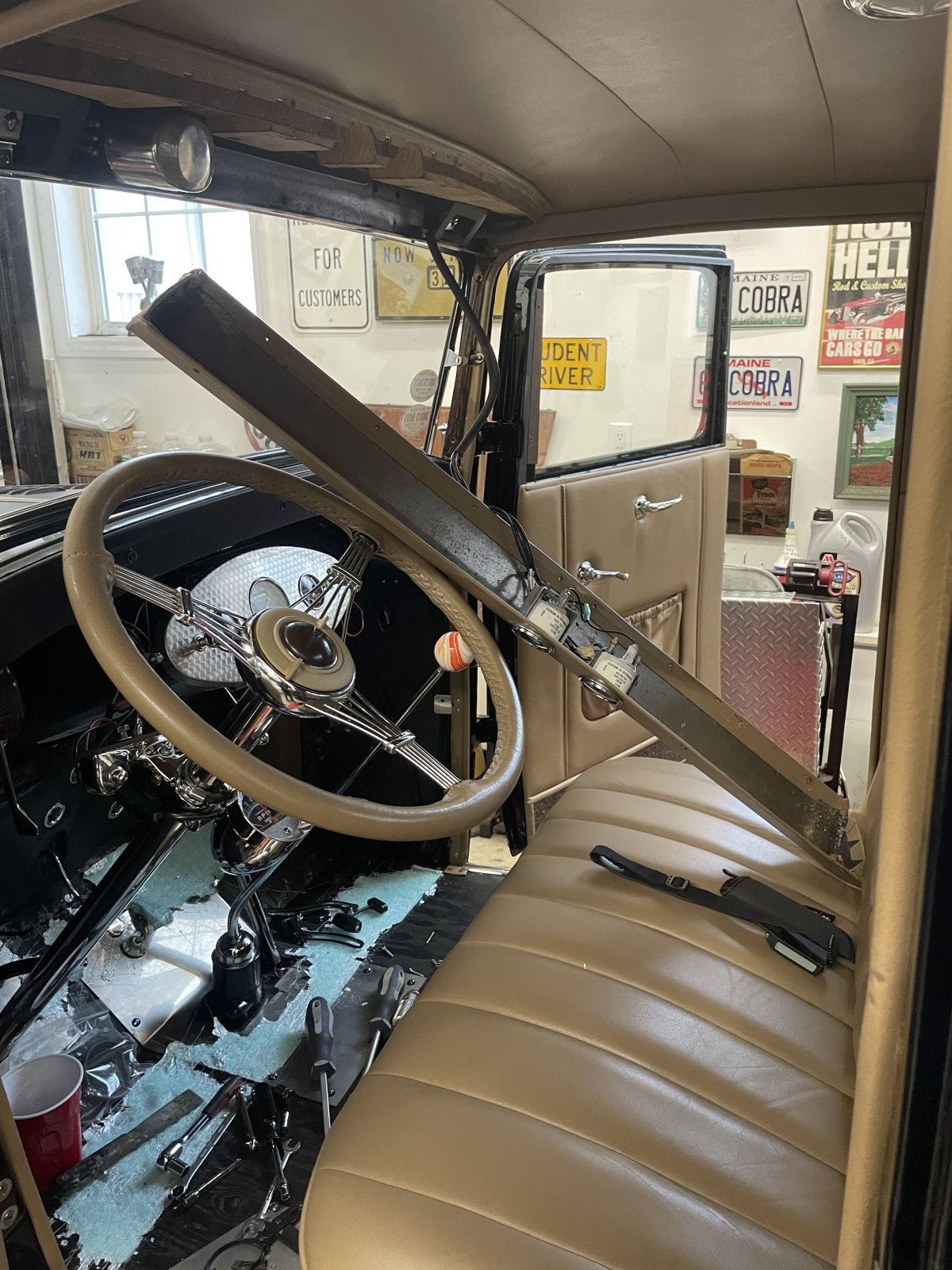

    All garnish moldings and dash out. Header panel out. Those mice in Canada must be amazing . Found nuts in header panel. Will be adding sun visors. IMG_5605.jpeg IMG_5607.jpeg IMG_5606.jpeg
    tb33anda3rd, TFoch, hfh and 5 others like this.
  23. Stogy
    Joined: Feb 10, 2007
    Posts: 27,523
    Stogy
    :rolleyes:...almost looks like skulls...did they get in through the 2nd wiper hole?...at least it looks to have only been storage...no nests and minimal t*******s...bonus

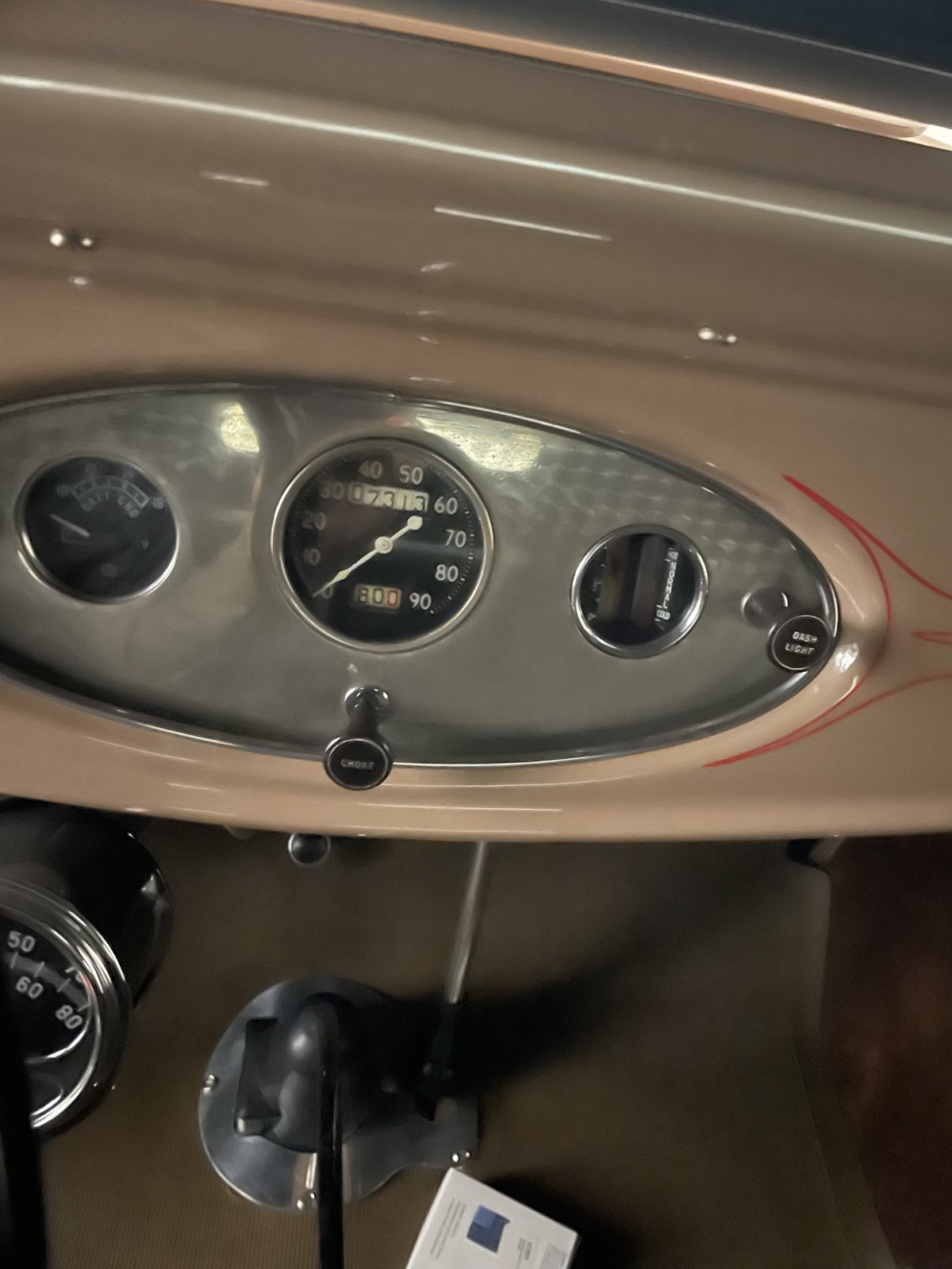

  24. Deuce Lover
    Joined: Feb 15, 2009
    Posts: 1,263
    Deuce Lover

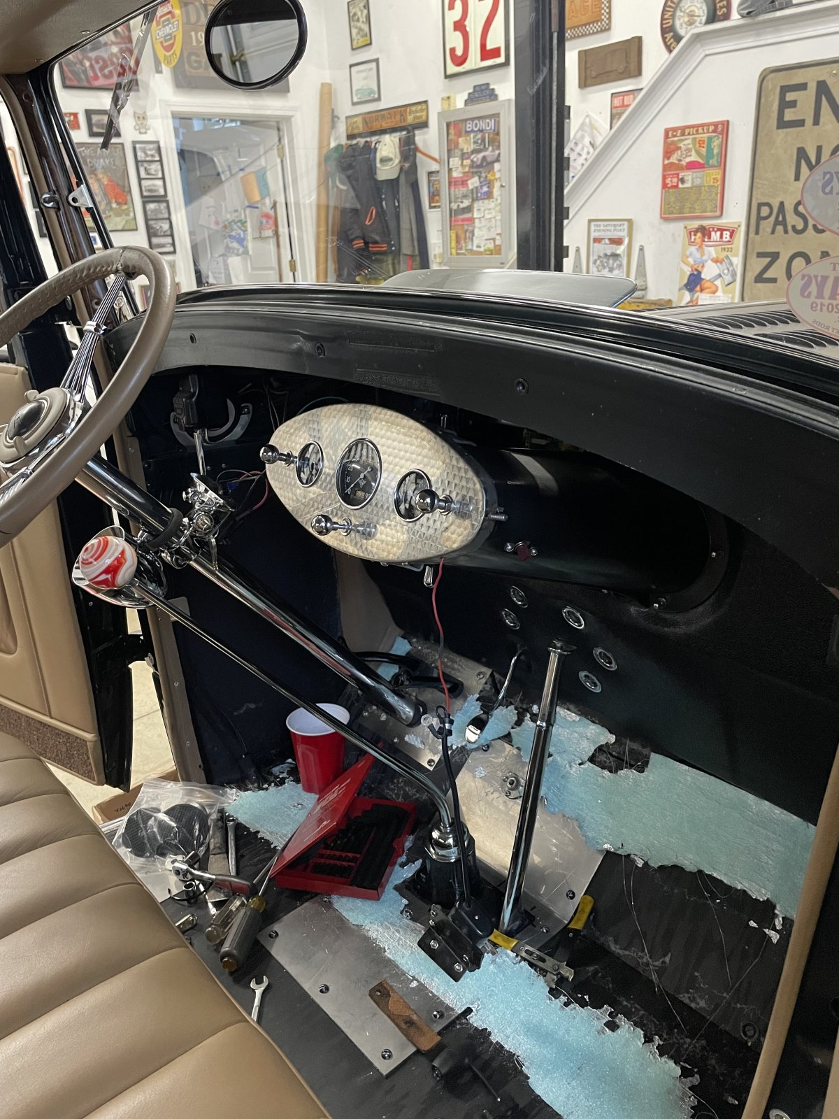

    Please post a front view pic of your instrument panel and what instruments if not orig 32 Ford.Thanks,Sheldon
    ct1932ford likes this.

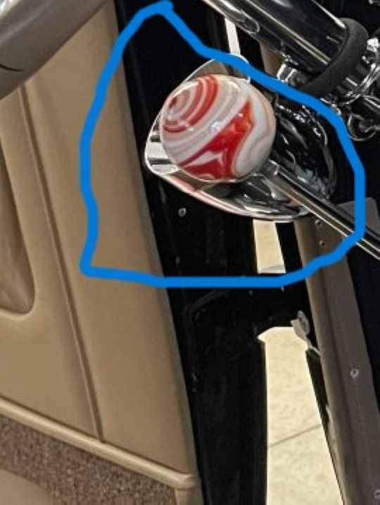

  25. loudbang
    Posts: 40,351
    If you squint just a bit it looks like your shiftknob is encapsulated in a fancy wine gl***. Yes is got me first time I looked at the photo LOL
  26. ct1932ford
    Joined: Dec 3, 2010
    Posts: 13,501
    ct1932ford
    Honestly, I don't see how they got in. When I got the car there were nests in the rumble deck lid. I even found one very skinny live mouse that apparently made the over 3000 mile journey .:eek:

  27. DDDenny
    Posts: 23,431
    Right on the money LB!

  28. krylon32
    Joined: Jan 29, 2006
    Posts: 11,767
    krylon32
    from Nebraska
    A mouse can squeeze thru almost any small space. Any mouse odor?

  29. ct1932ford
    Joined: Dec 3, 2010
    Posts: 13,501
    ct1932ford
    H
    One of the coupe and one of my roadster that does have an early fuel /temp gauge. IMG_5612.jpeg IMG_5613.jpeg
    TFoch, swifty and Stogy like this.
  30. ct1932ford
    Joined: Dec 3, 2010
    Posts: 13,501
    ct1932ford
    No , I think the trip was too much for those rascals. I hope!:rolleyes: There was a bar of Irish Spring in the rumble area. I should have known.:oops:
