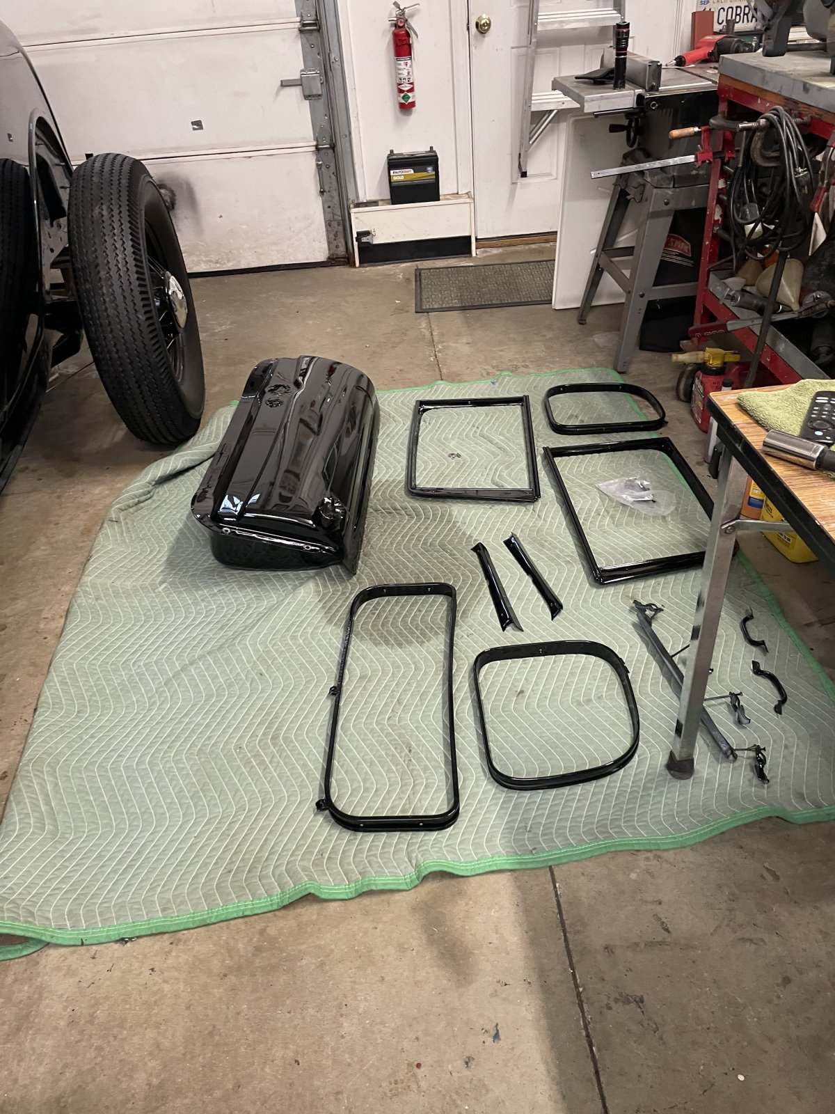

  7. ct1932ford
    Joined: Dec 3, 2010
    Posts: 13,500
    ct1932ford

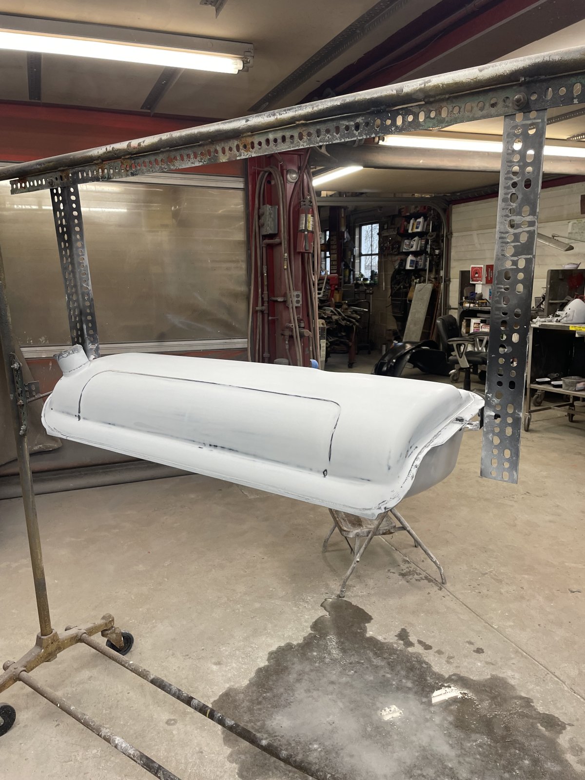

    Spent some time at Cousin Ted’s shop today and got some coupe stuff ready for paint.:cool: IMG_5782.jpeg IMG_5780.jpeg

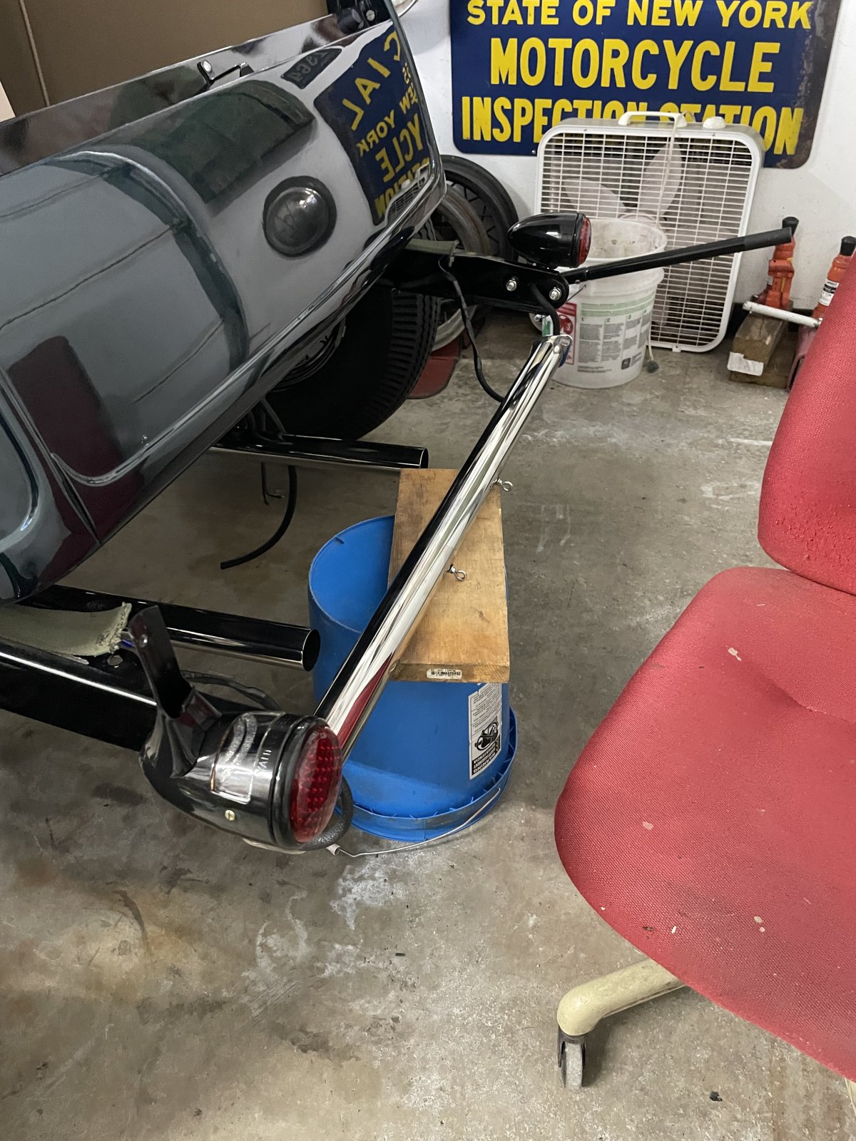

  10. ct1932ford
    Joined: Dec 3, 2010
    Posts: 13,500
    ct1932ford

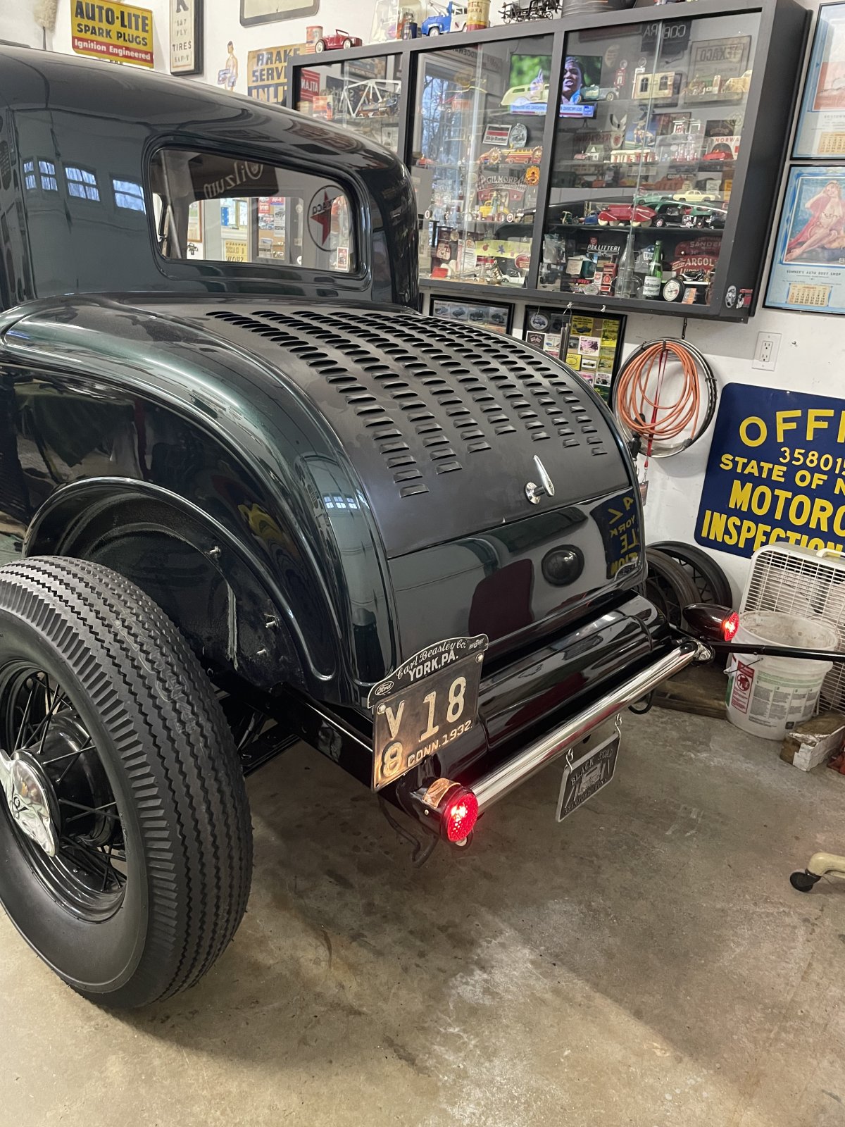

    Wired up the taillights and picked up painted parts from Ted’s . Install gas tank next. IMG_5812.jpeg IMG_5811.jpeg IMG_5810.jpeg

    Finished getting tank in, taillights and crossbar. Just need to strap up some wiring.

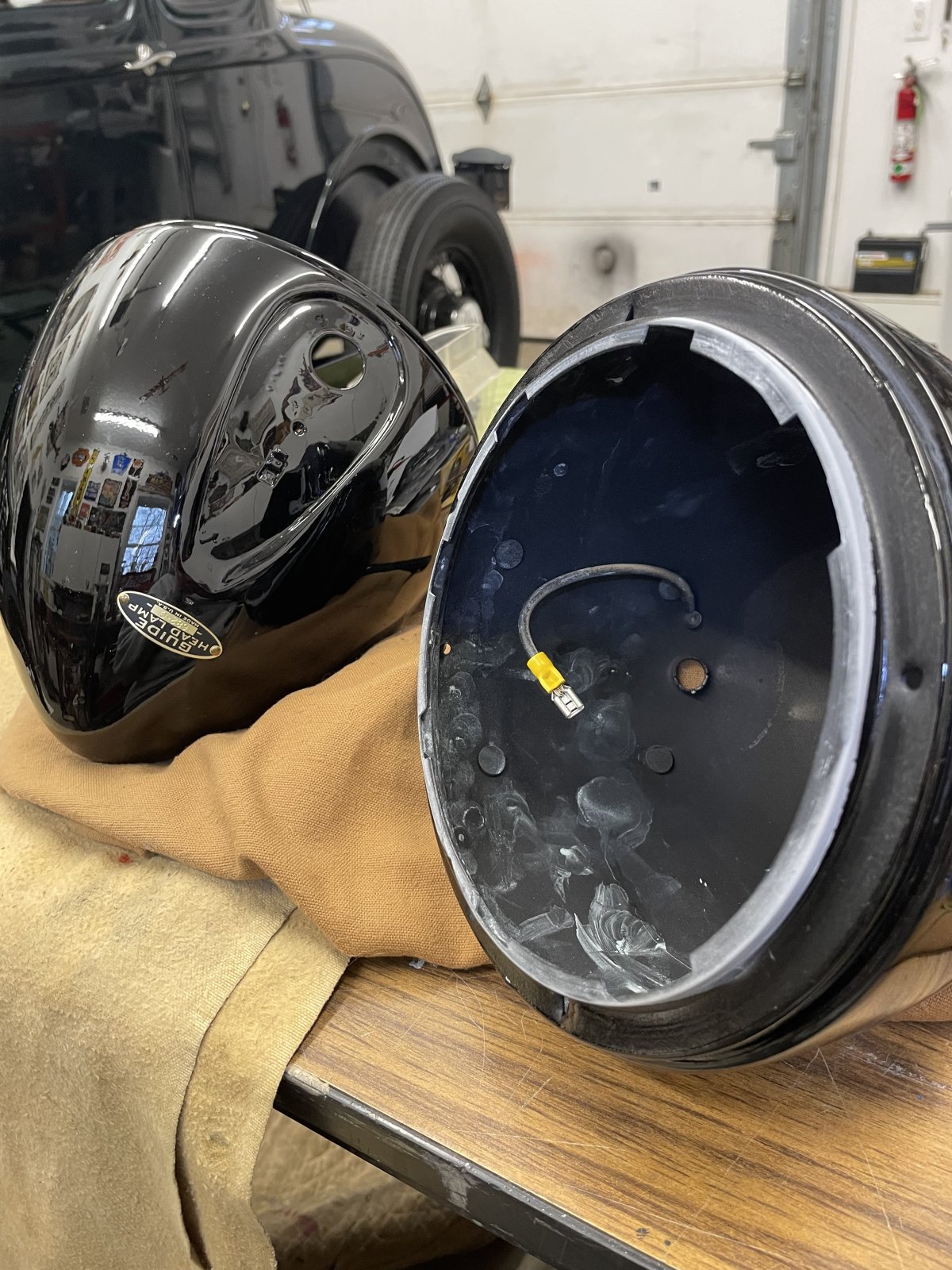

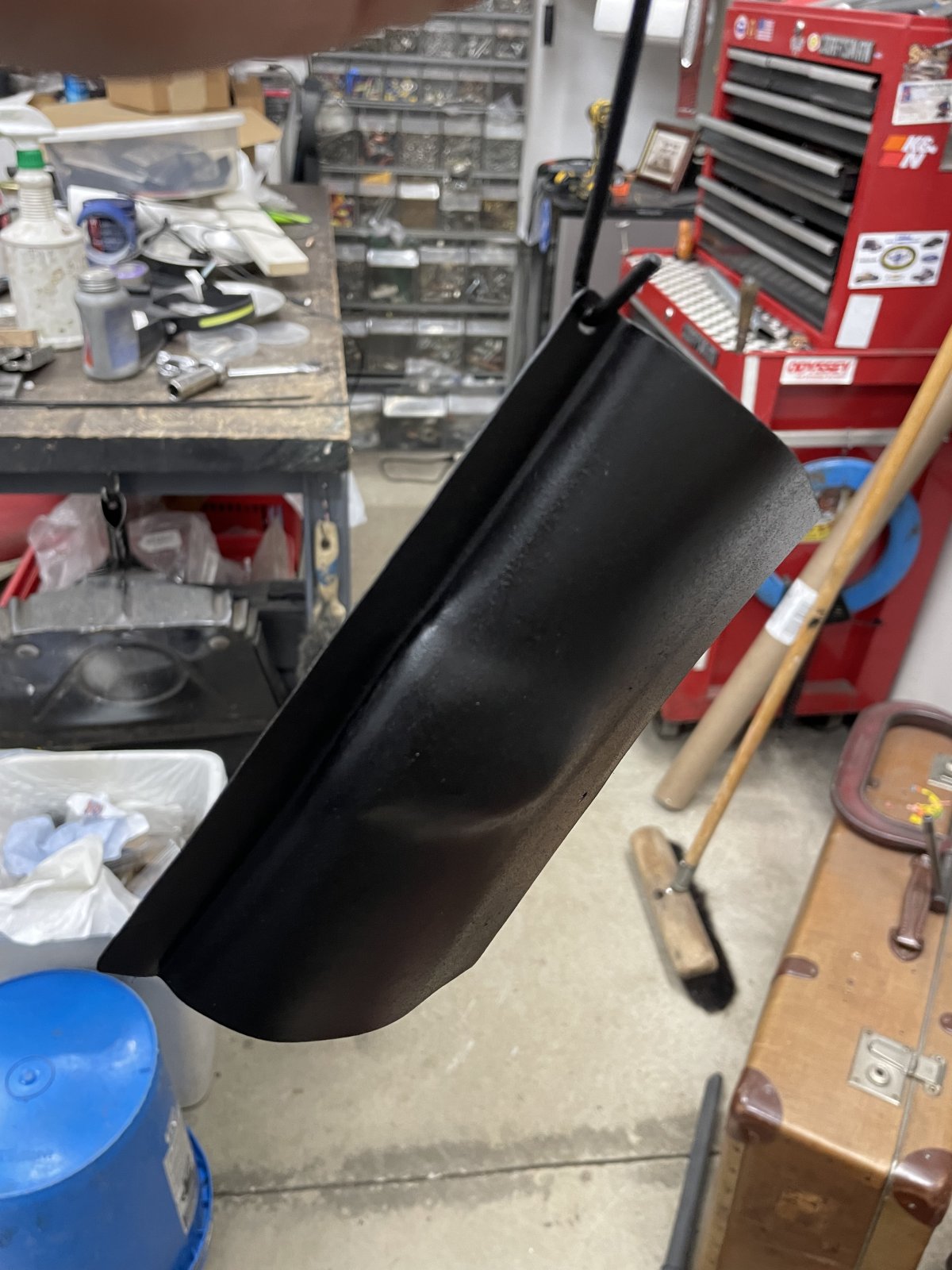

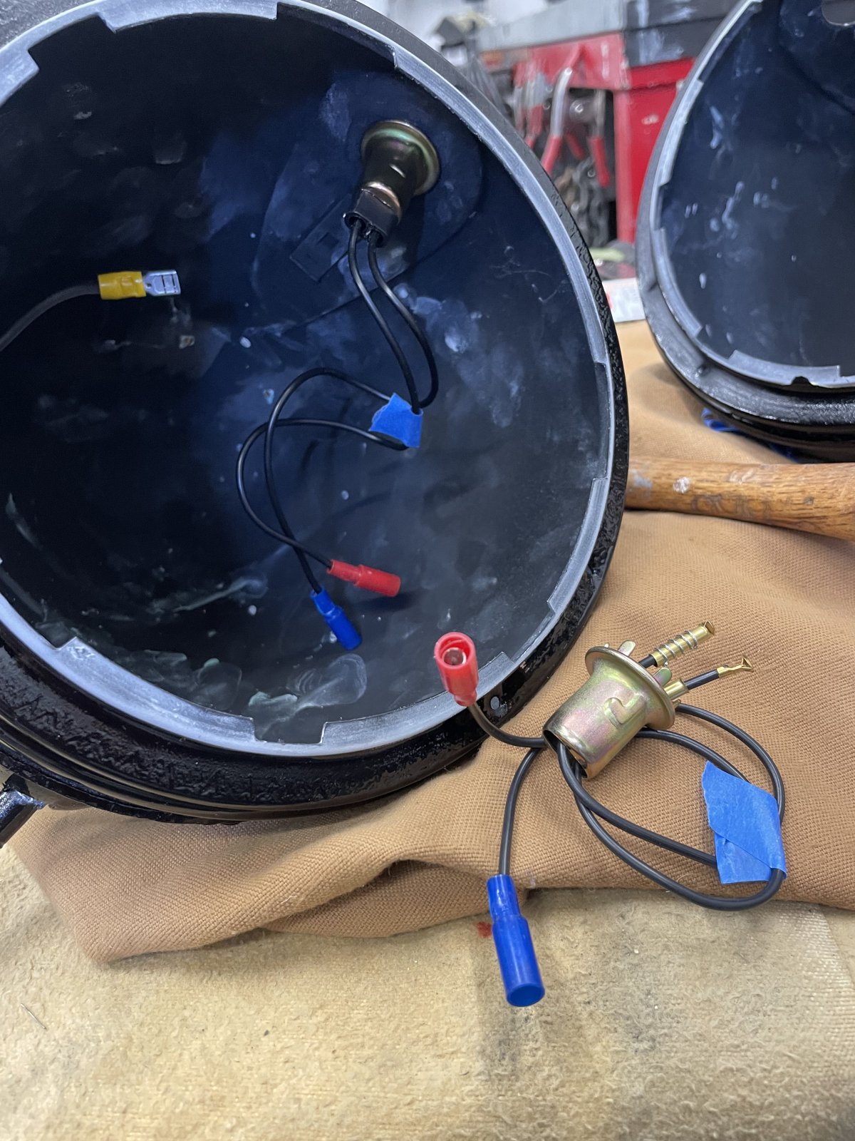

  17. ct1932ford
    Joined: Dec 3, 2010
    Posts: 13,500
    ct1932ford

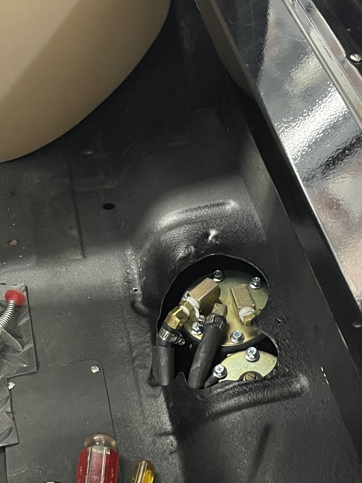

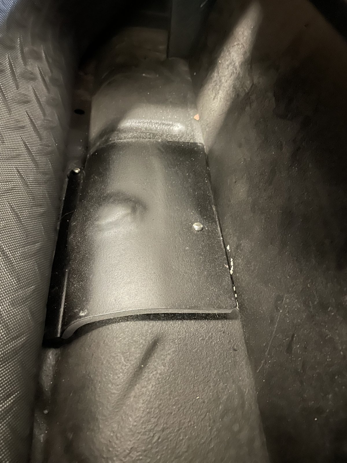

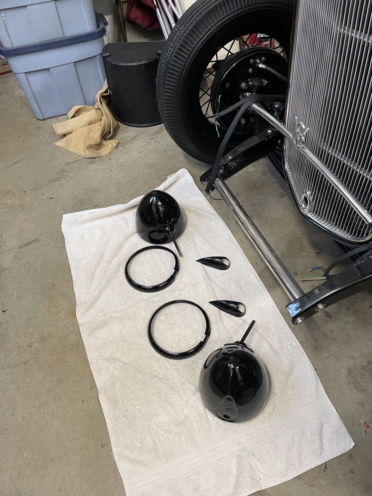

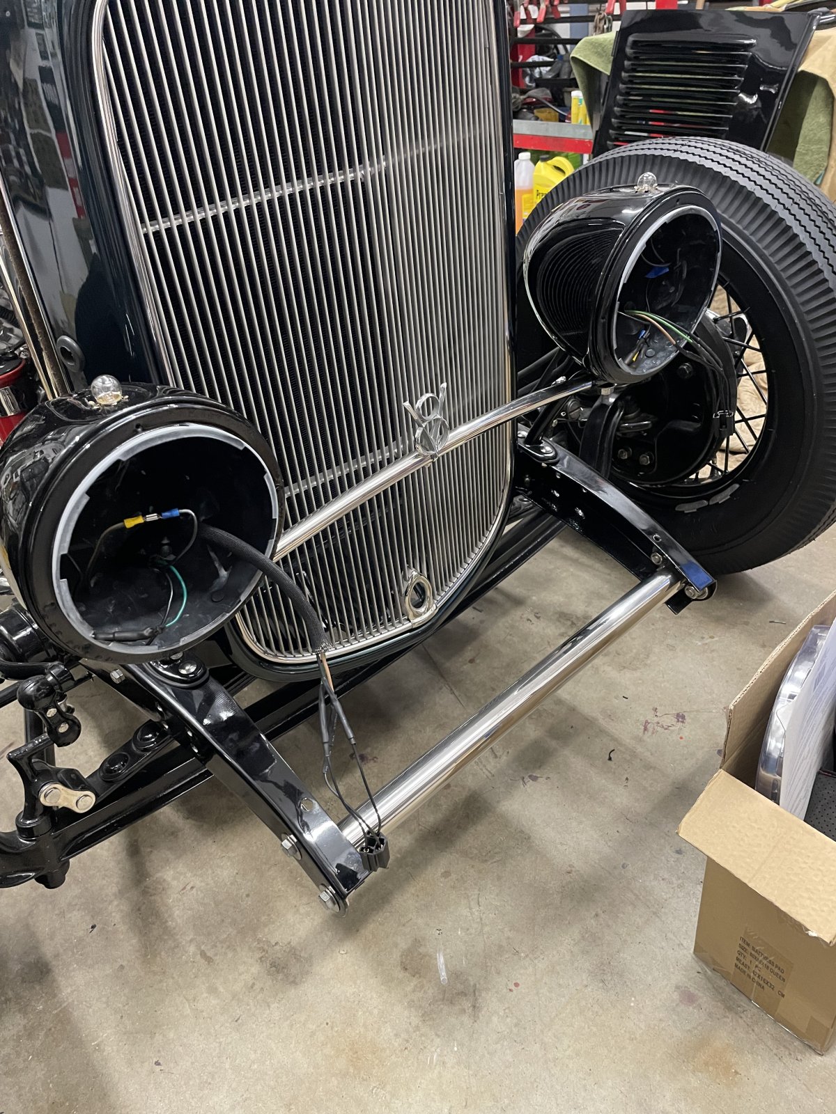

    Started the headlight ***embly and installation. Wiring completed, new guide tags on and parking / signal sockets installed.
    Also finished and painted floor cover to clear fuel tank line and vent. Common issues with Tanks tank.
    IMG_5810.jpeg IMG_5818.jpeg IMG_5819.jpeg IMG_5820.jpeg IMG_5822.jpeg IMG_5823.jpeg

  19. 60 Special
    Joined: Sep 8, 2007
    Posts: 320
    60 Special
    from Omaha Ne.
    Could you clarify on your statement "Also finished and painted floor cover to clear fuel tank line and vent. Common issues with Tanks tank." 60 Special
    ct1932ford and Stogy like this.

  21. ct1932ford
    Joined: Dec 3, 2010
    Posts: 13,500
    ct1932ford
    When using a Tanks 32 gas tank in a deuce , the fuel line and vent line are unlike the stock arrangement . They interfere with the floor so you need to enlarge the access hole and then a cover is usually installed over the lines.
    See This! https://www.jalopyjournal.com/forum/posts/14172901/
    60 Special, Stogy and loudbang like this.
  22. swifty
    Joined: Dec 25, 2005
    Posts: 2,707
    swifty
    Has your Tanks tank got the triangular stiffening brackets fitted like the originals? The Vintique tanks have them as standard but there mounting holes don't match an original ch***is so they need to be modified to correct that problem. I've never used a Tanks tank so not familiar with them.
  23. ct1932ford
    Joined: Dec 3, 2010
    Posts: 13,500
    ct1932ford
    No I could have added them but decided it looks cleaner with out them.
    Stogy likes this.
  24. ct1932ford
    Joined: Dec 3, 2010
    Posts: 13,500
    ct1932ford
    Finished headlights , actually all light now finished. Put some gas in it today and started it up.
    Will move to hood sides next. Even though the top is in primer. It will all come apart for complete paint at some point. Probably after this summer. I want to ring out any issues before I pull motor etc. for paint.
    I also finished up the trunk area and cover over fuel tank fittings. IMG_5825.jpeg IMG_5830.jpeg IMG_5829.jpeg IMG_5831.jpeg IMG_5832.jpeg

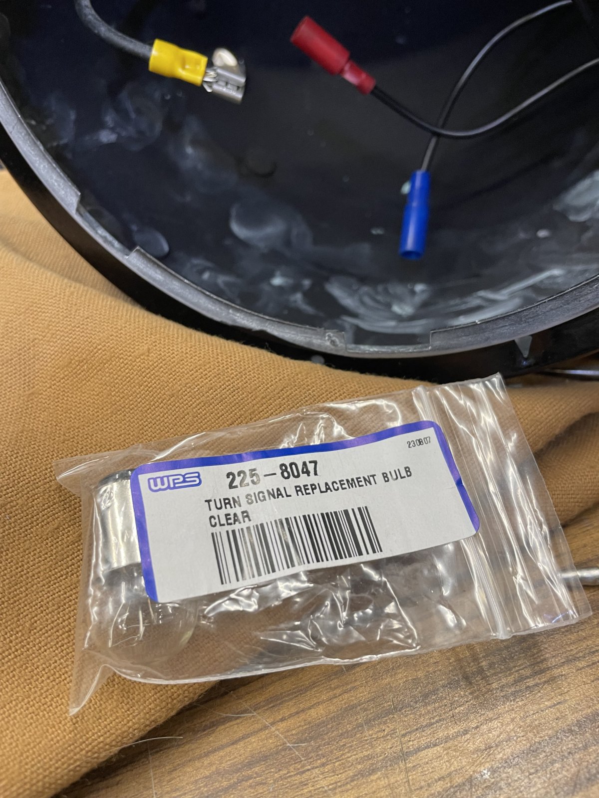

  26. Duke
    Joined: Mar 21, 2001
    Posts: 937
    Duke
    What did you use for headlight bulbs?
    Stogy likes this.
  27. ct1932ford
    Joined: Dec 3, 2010
    Posts: 13,500
    ct1932ford
    I’m using Napa sealed beams. Do you need number?
    Stogy likes this.
  28. Duke
    Posts: 937
    Duke
    That would be great, I seem to need part numbers to get anything that does not come off a Honda.
    Stogy likes this.
  29. brady1929
    Joined: Sep 30, 2006
    Posts: 9,749
    brady1929
    Mark,
    Where did you get those top bulb sockets for the Guide 682-C lights? And what bulb is used? Thanks.
    Stogy likes this.
