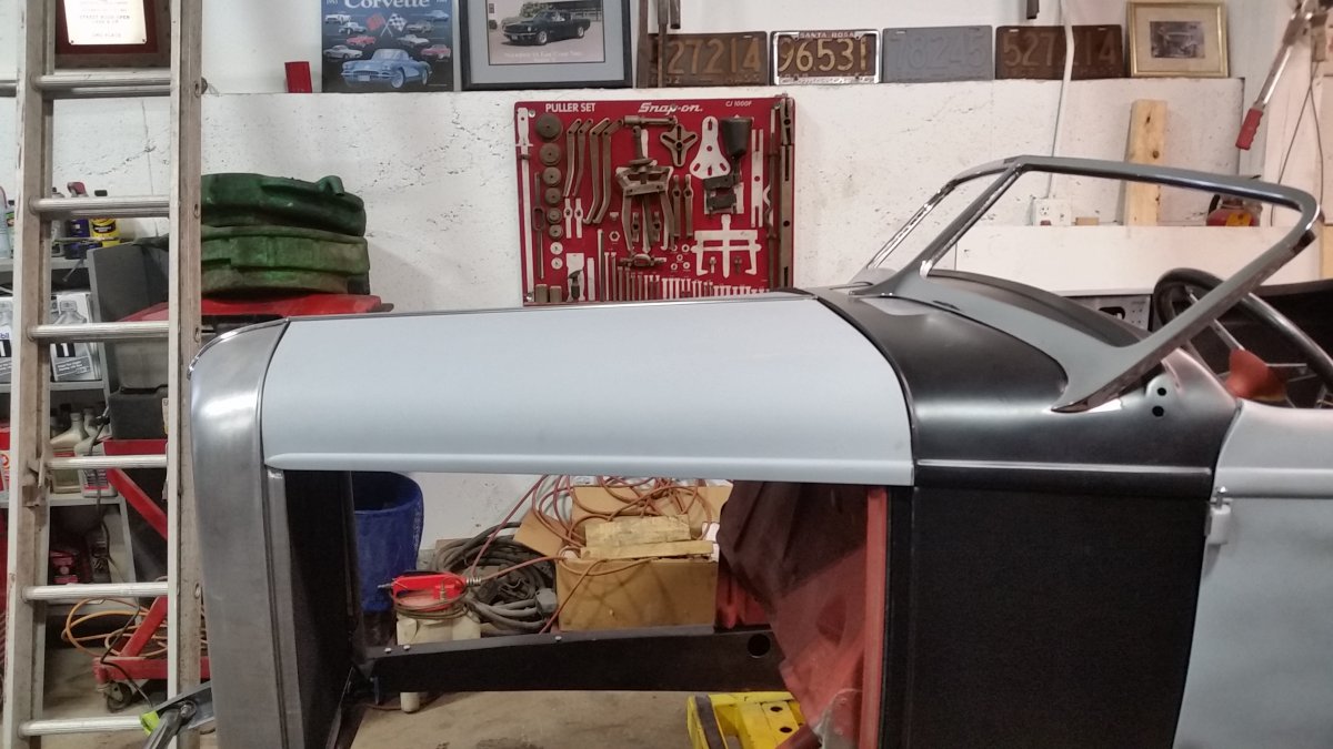

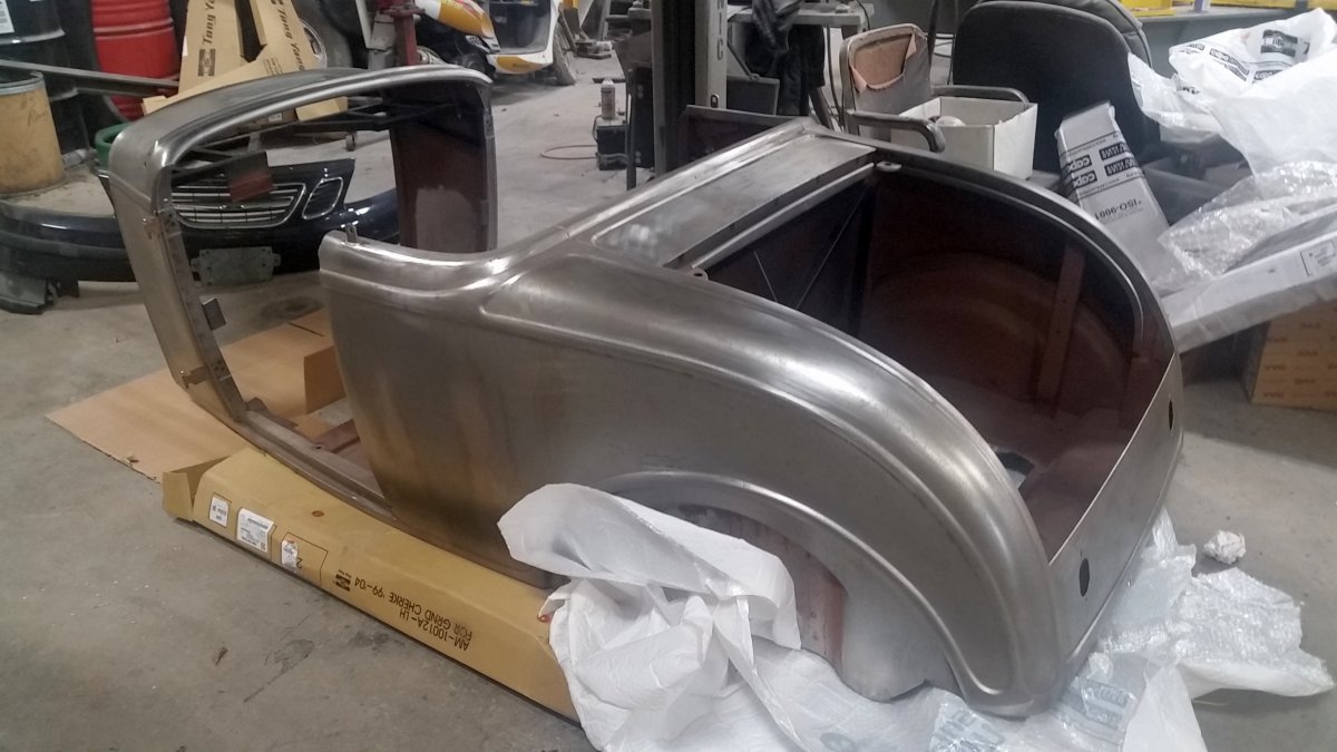

    Windshield fit the cowl excellent. Unfortunately the cowl vent will have to go, and that will lead to other modifications that will give the Rdstr a better look. 2017-02-25 12.40.03 x.jpg 2017-03-07 17.50.11.jpg

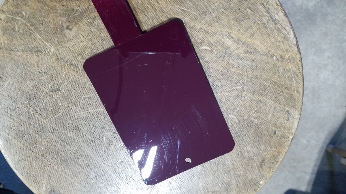

    This is the color I have picked out after months of searching for what I wanted. It's non-metallic that looks like Mandarin Maroon in the sunlight (picture 1) and looks more purple in the shade ( picture 2). And once the sun goes down, it almost looks black. My color choice is not etched in stone, but most likely I will stay with this.

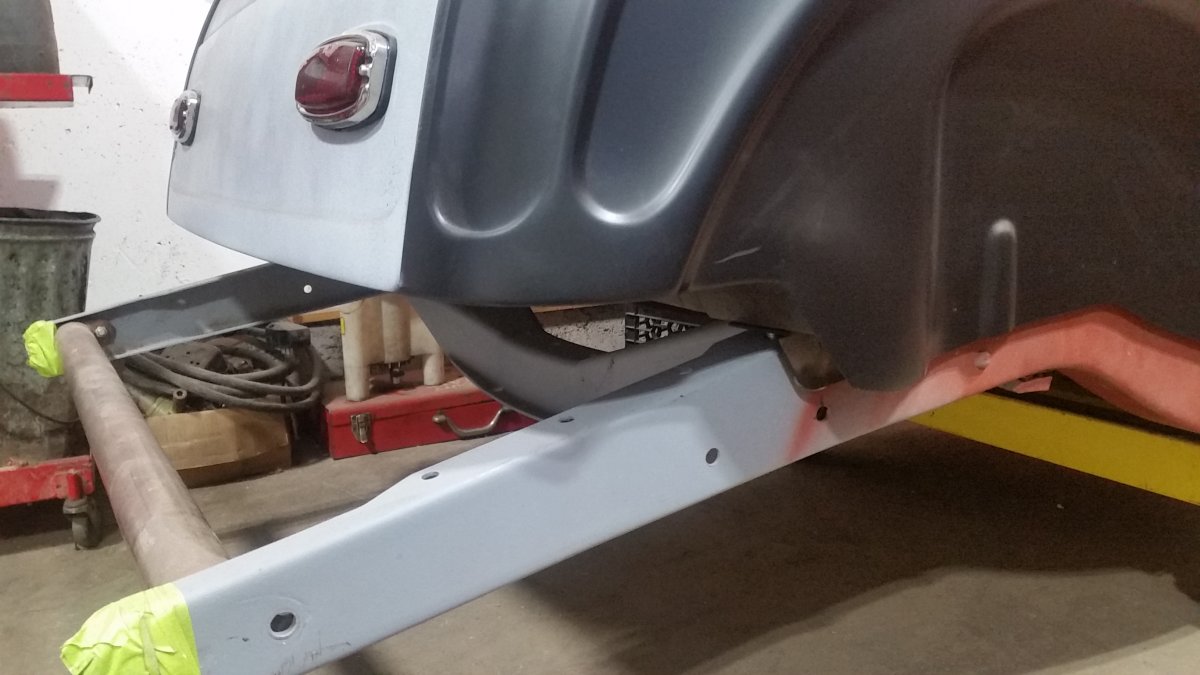

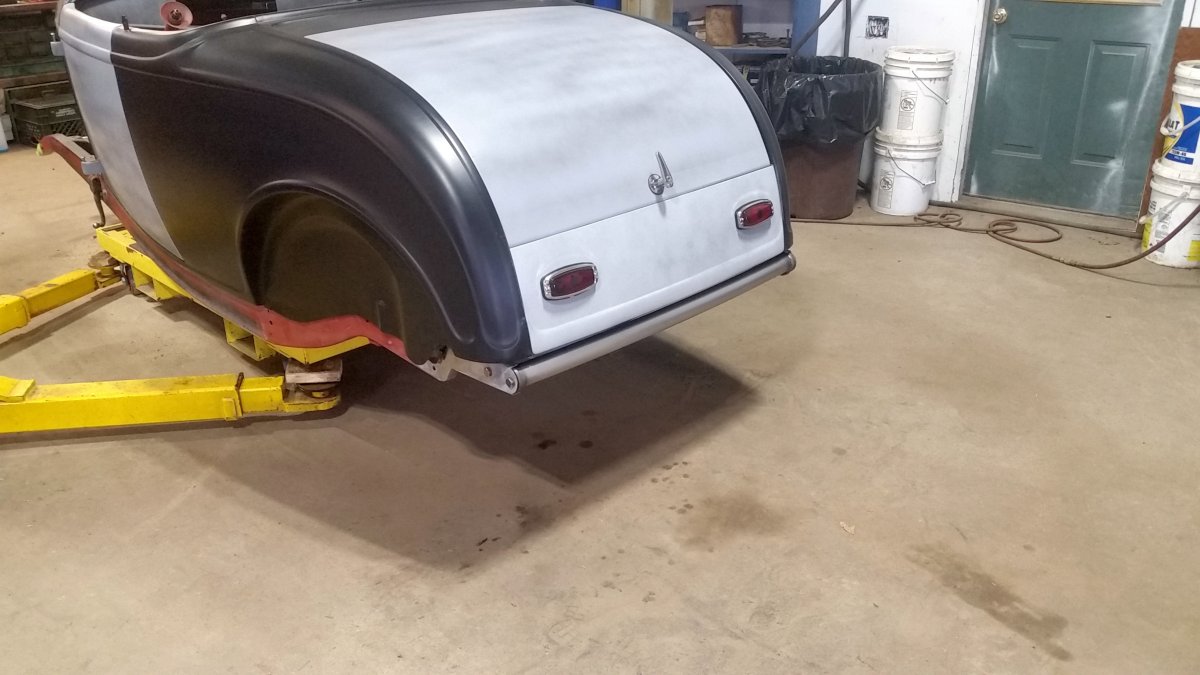

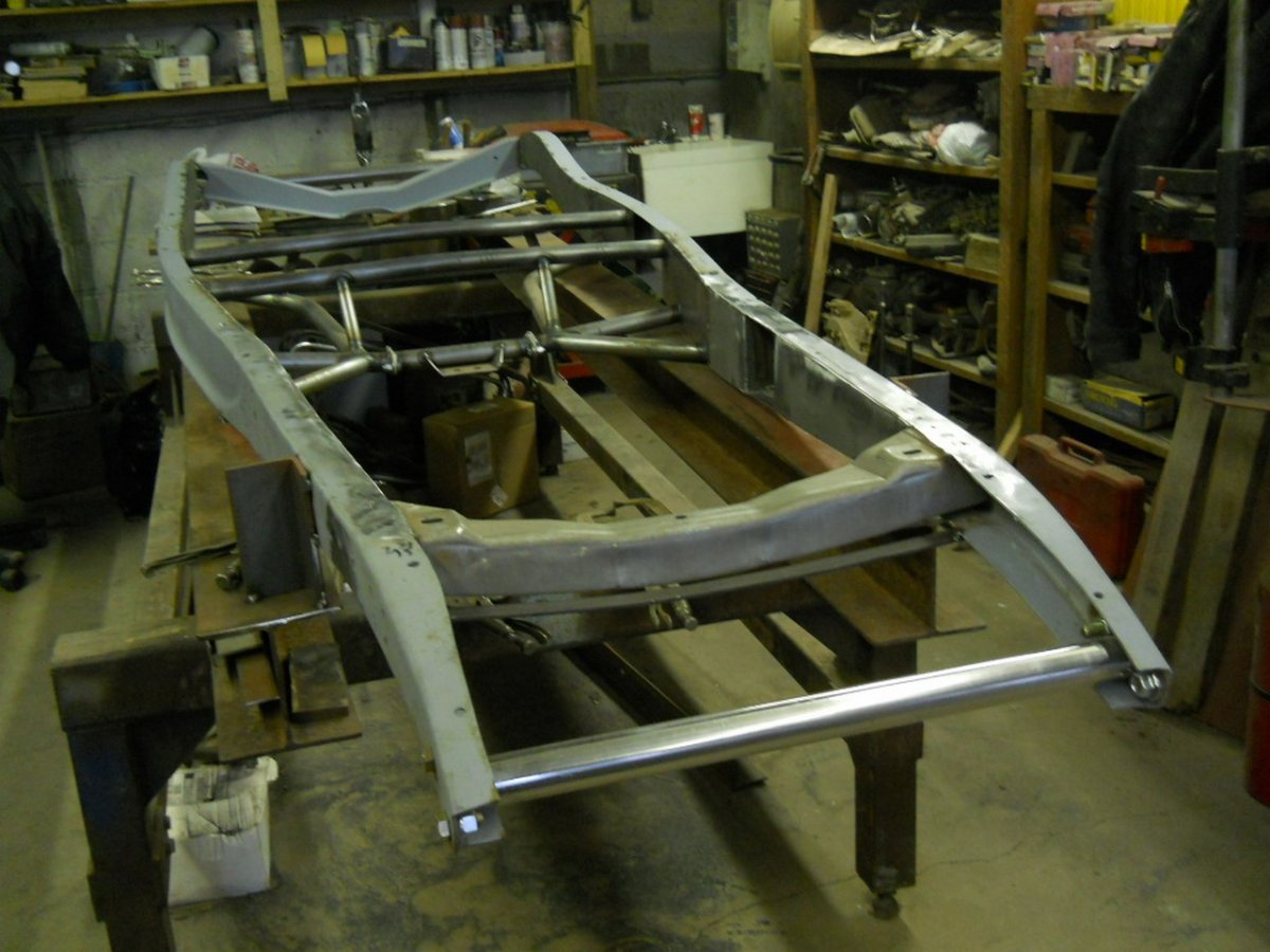

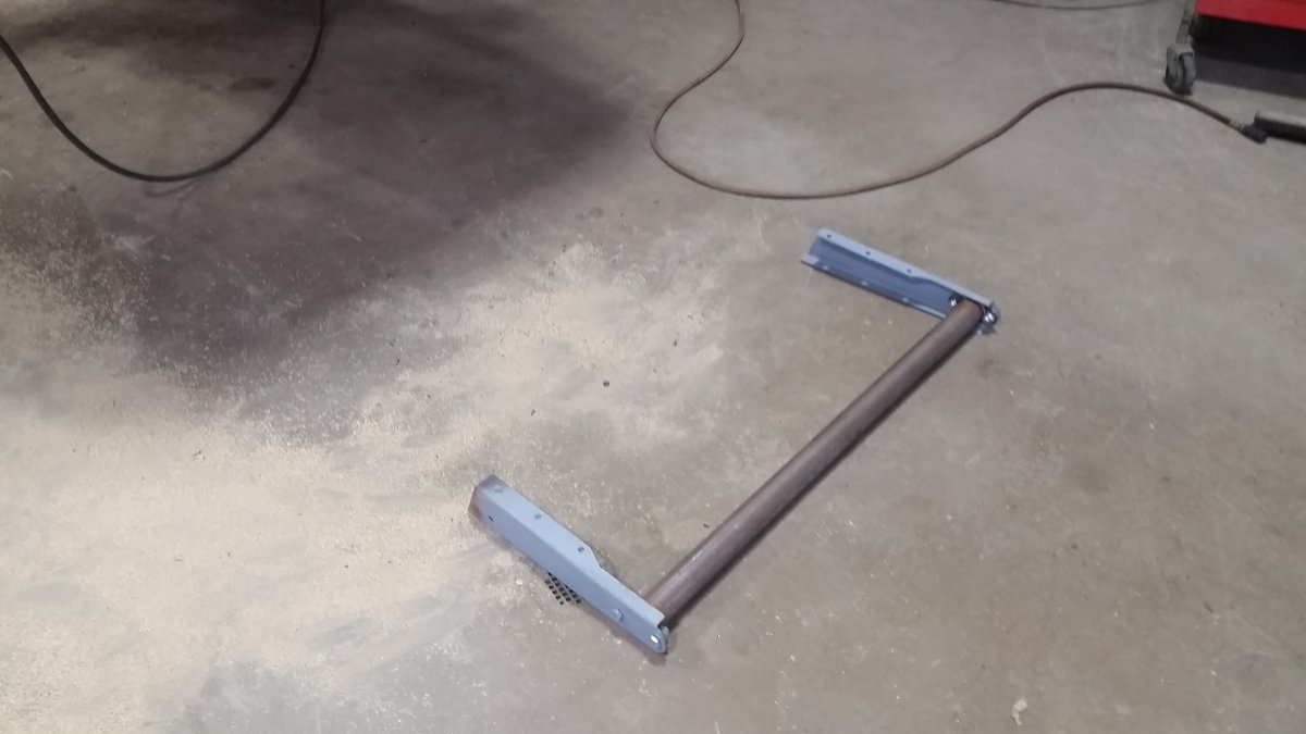

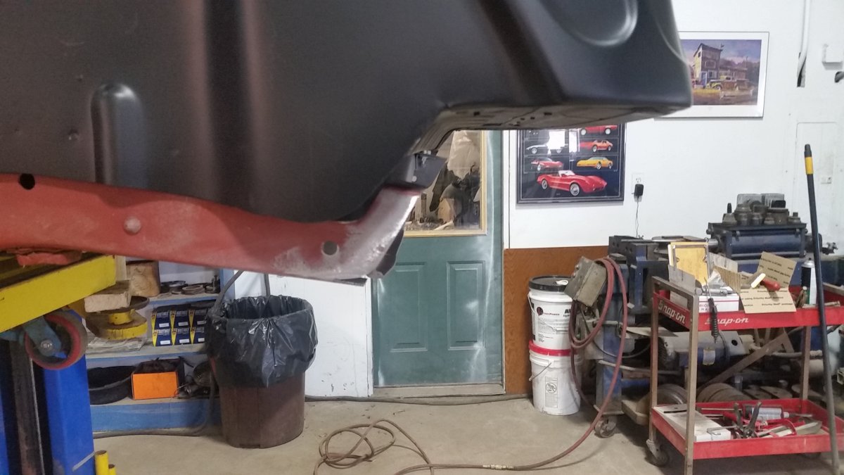

    I've never been a fan of the gas tank in the stock location. Shortened up the rear frame horns and kicked them up so I could install one of Walden's curved rear spreader bars. Follows the contour of the lower rear panel perfect and tidy's up the rear end nicely . 2017-01-18 14.53.02 x.jpg 2017-01-21 12.12.49 x.jpg 2017-01-21 12.12.33.jpg 2017-01-27 13.59.58 x.jpg

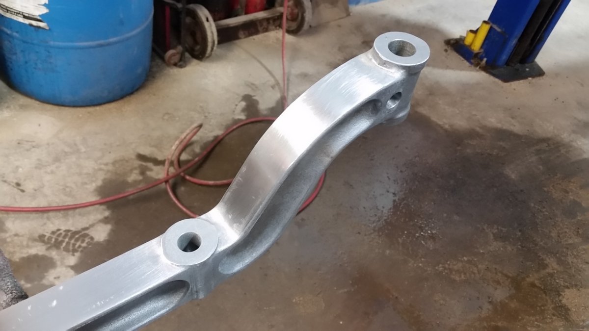

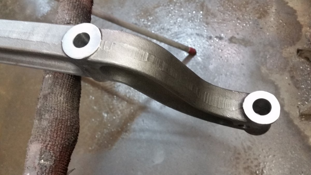

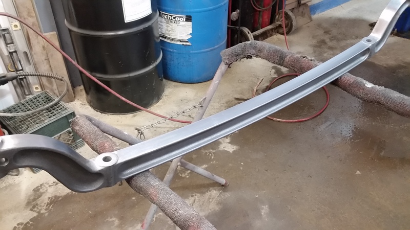

    Got rid of the forging lines on the So-Cal front axle and cleaned it up before it goes out to be powder coated. Axle 1.jpg Axle 2.jpg Axle 3.jpg

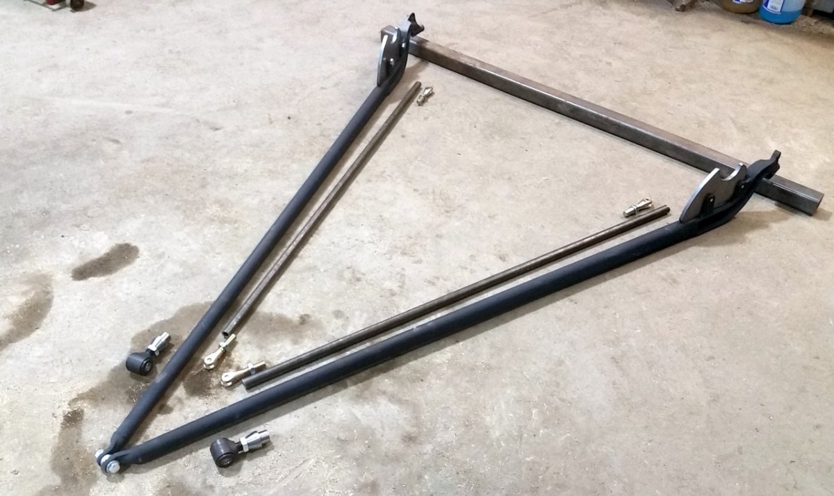

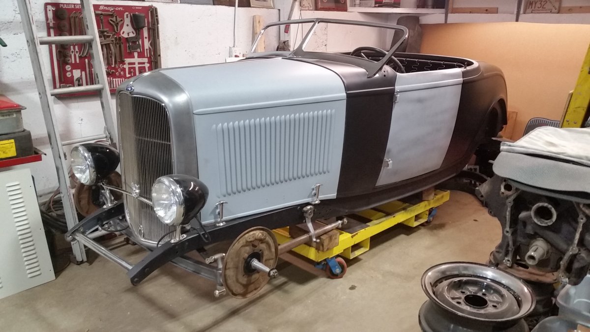

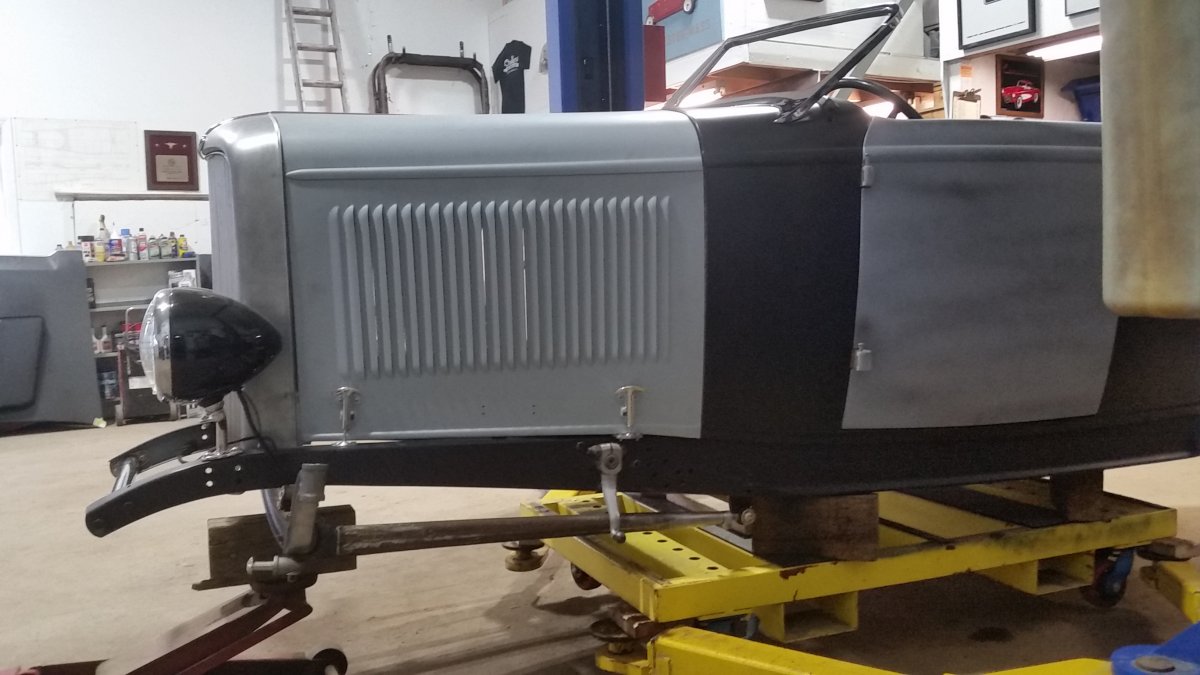

    Running 56 F100 front brakes along with 56 steering box. 34 Ford wishbones with the axle ends reversed to clear the tie rod. Wasn't happy with the look of the bones mounted like this, so later in the build I moved the wishbone mounts inboard about 4 inches. Not only looks cleaner, but also moves the draglink inboard and a tighter turning radius to the left. 2017-04-01 16.32.44.jpg 2017-04-07 17.30.04 x.jpg

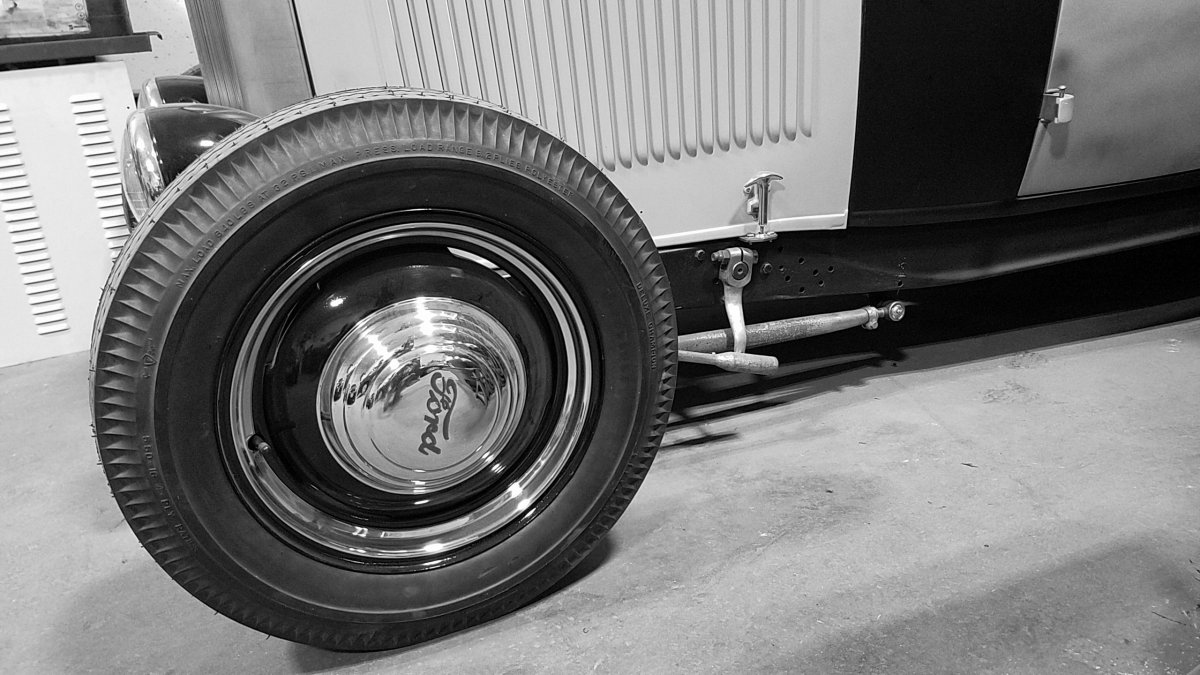

    Set of 36 wishbones will hold the 9 inch Ford in place. In this picture, the frame is sitting right on the axle tubes. Nothing a little surgery won't take care of later in the build. Need to keep those Firestone 7.50 x 16's on 16 x 41/2" 48 Ford wheels concentric with the rear wheel well.
