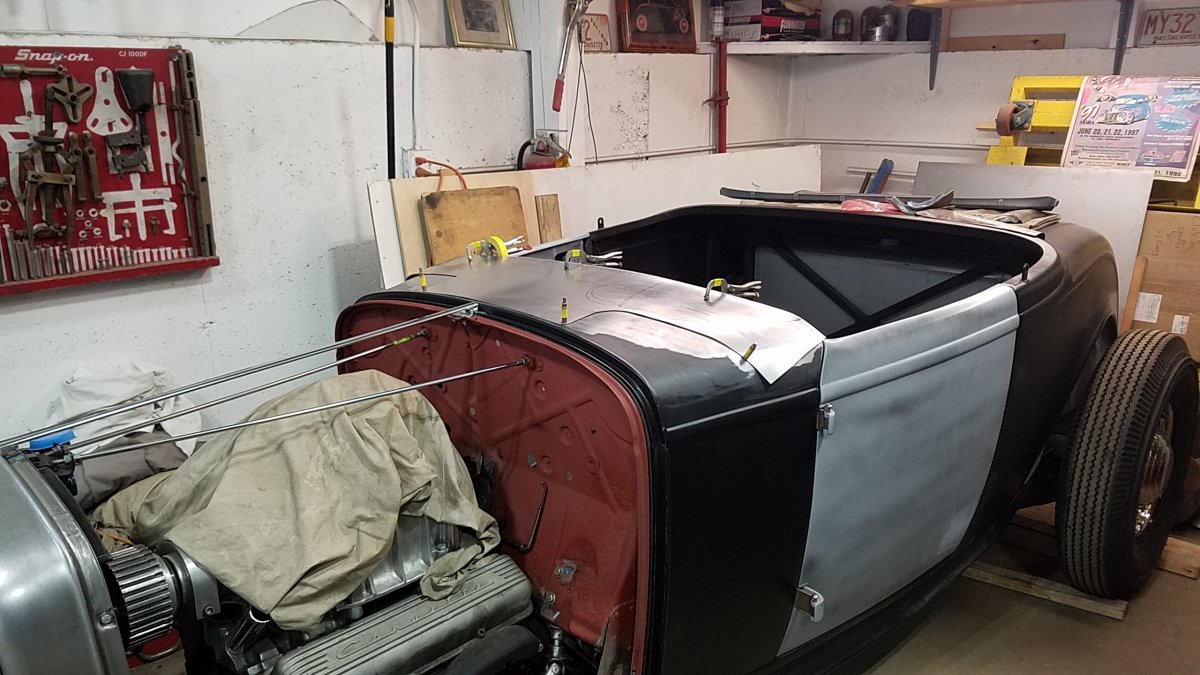

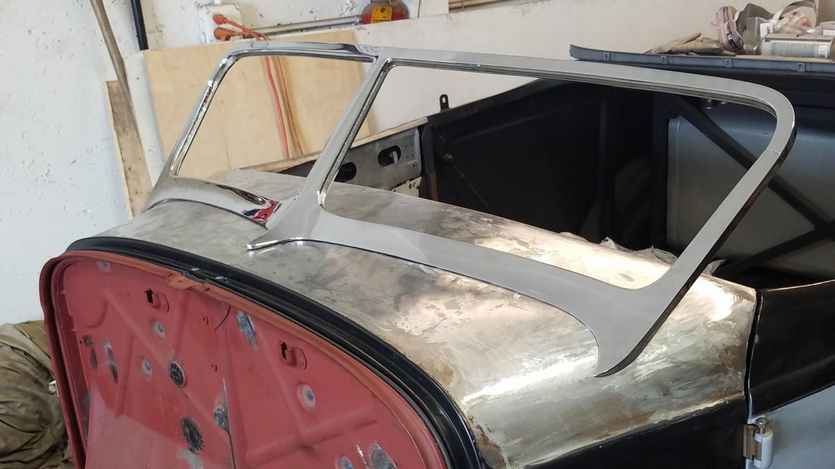

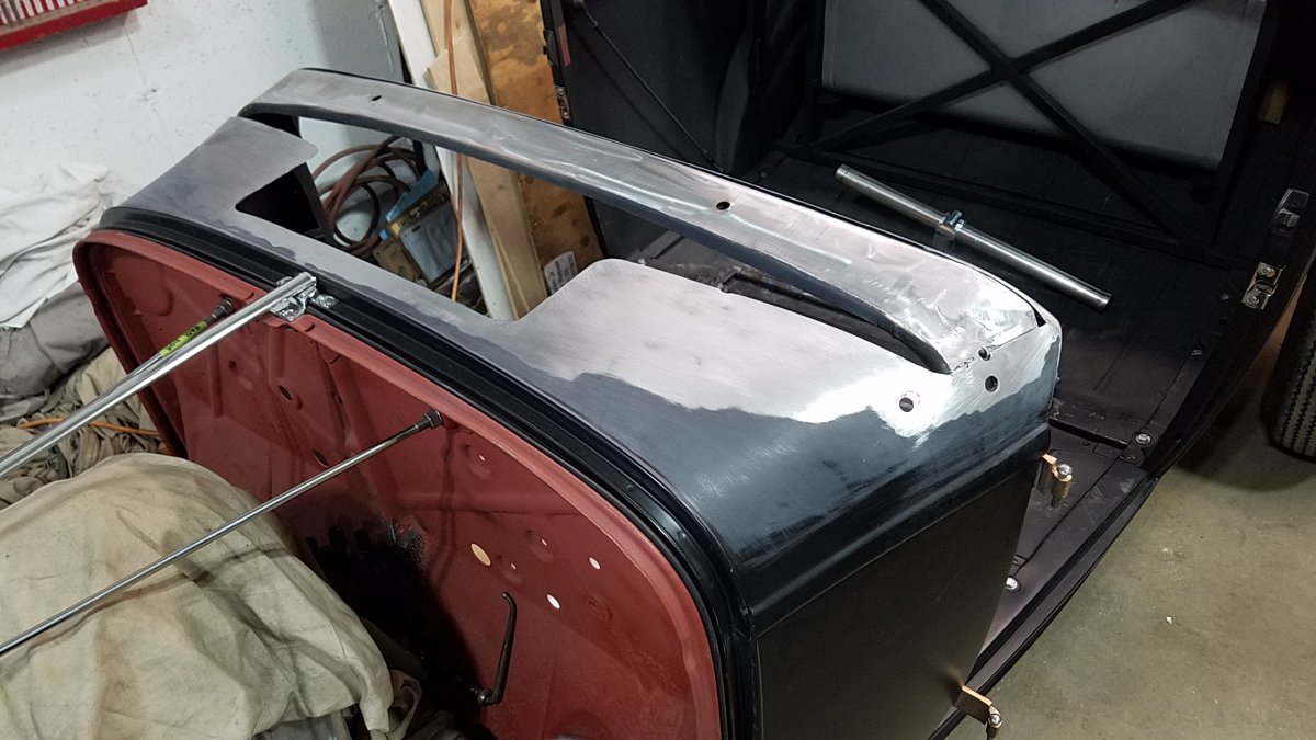

    Along with the cowl vent this hump for the stock windshield will also have to go. Fortunately for me, a good friend of mine, Jay Herbster, operates his restoration shop right next door to me. Jay is one of those guys that does amazing metal work and did 95% of the following modifications. I showed him pictures of the Doane Spencer Rdstr and told him I'd love to do the same to my cowl. "No problem" was his reply, so I'll post some pics of the transformation in the next few posts. To watch and help him with this project was great. Talented young man ,to say the least. 2017-01-07 15.31.47.jpg 20180322_161325x.jpg 20180323_163915 x.jpg

    Lot of compound curves in this panel that are crucial to retaining the stock cowl lines and having it fit the Duval windshield perfectly. 20180324_144808x.jpg 20180328_123357 x.jpg 20180328_142920x.jpg

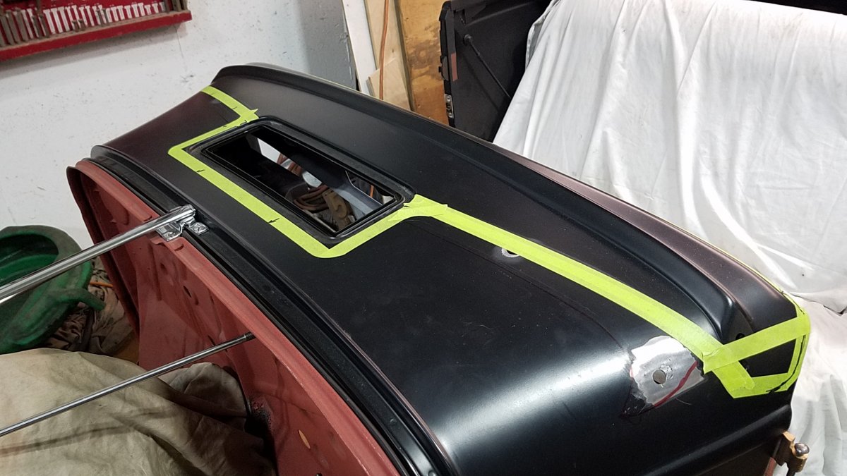

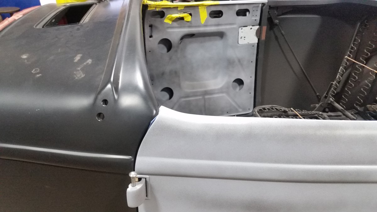

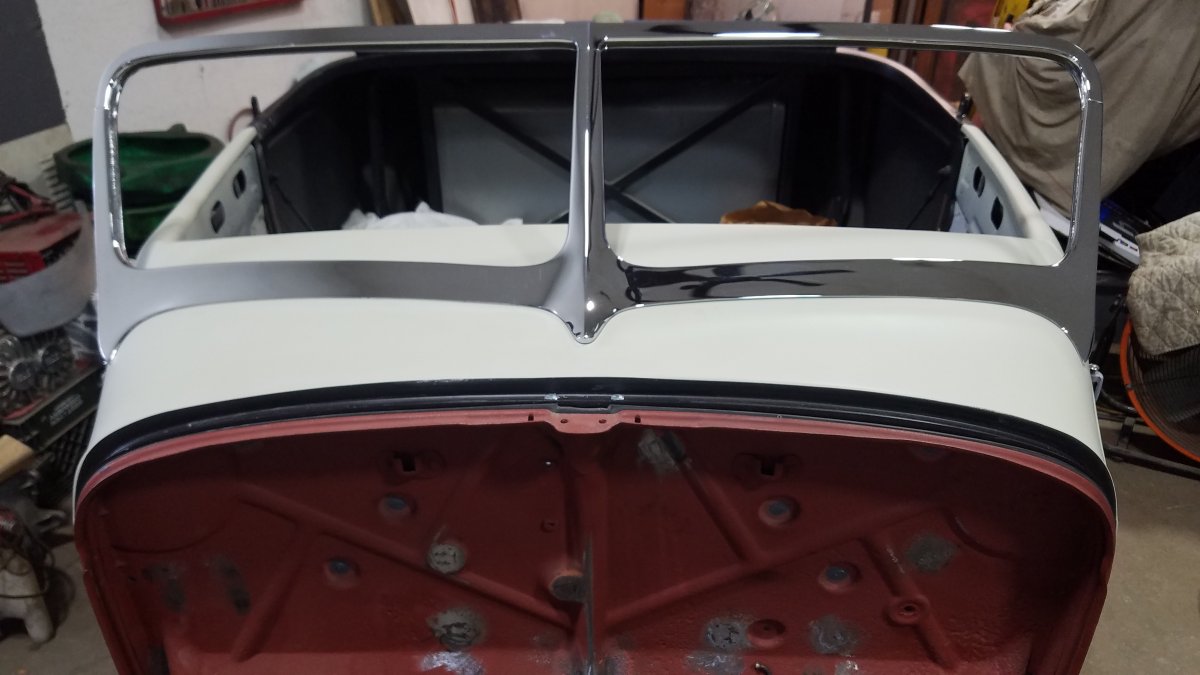

    Once Jay got the panel in shape, he fusion welded it to the cowl. In order to get a nice dash transition into the doors, he cut the door tops and made the new tops so the dash line would flow into the doors. 20180414_104843.jpg 20180426_132642 x.jpg 20180426_152623.jpg 20180428_111555 x.jpg

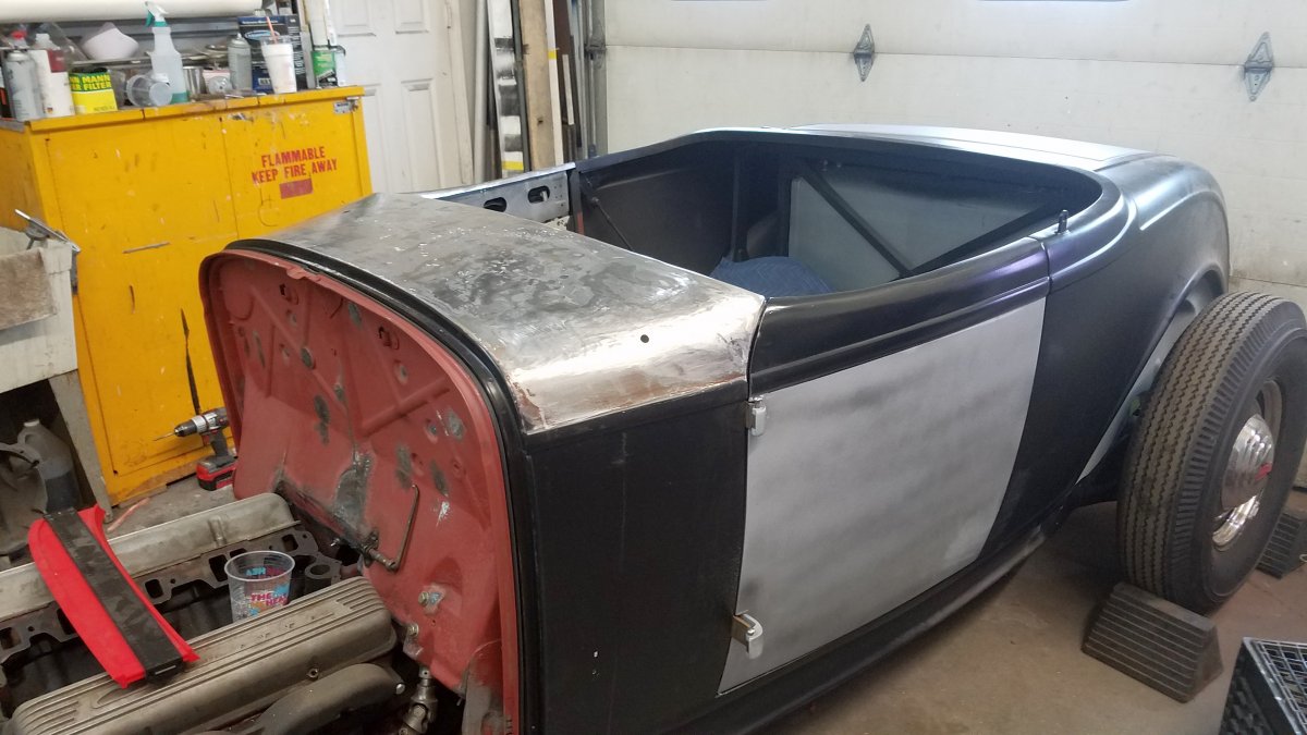

    Here is the corner piece being installed. There is also an inner piece that goes in toward the dash. Also note the inner pieces that continue the door jam up under the new dash and door to eliminate the open gap. Once his finished pick and filing the little imperfections, he leaded the top of the doors and dash. From here on in I just needed to give it a tight skim of filler and drill the rest of the mounting holes for the windshield. Cowl 5 14 18 c x.jpg Cowl 5 14 18 g x.jpg 20180516_115841x.jpg Jay leading drivers door 5 30 18 b.jpg Cowl 8 11 18 b.jpg

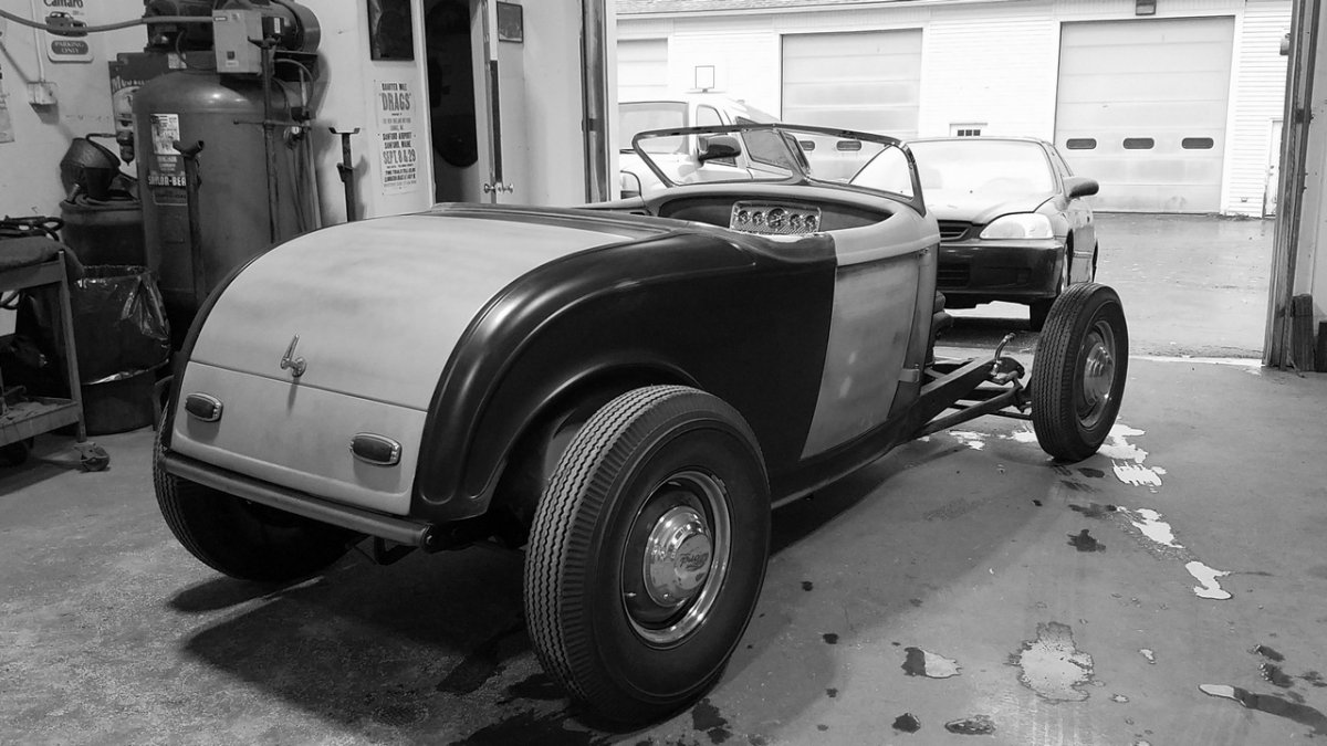

    A ton of work and a lot of hours, but well worth the effort. This will be the last Deuce Rdstr I build for myself, so it might as well build it exactly the way I have thought about for the last 30 years. Cowl 8 11 18 d.jpg Deuce Rdstr 8 6 18 c x.jpg Rdstr cowl  9 28 18 d x.jpg Rdstr 9 28 18 a ra x.jpg Rdstr 10 26 18.jpg

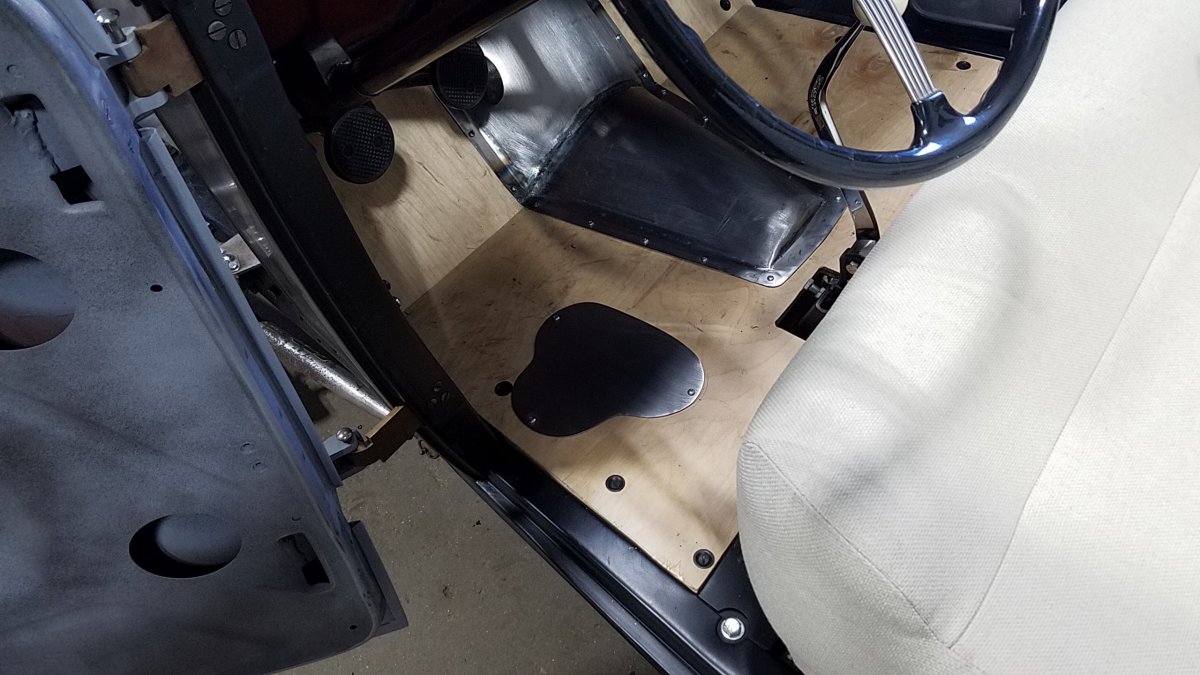

    Cut and fit the floor boards and fabricated the trans tunnel. The floor boards bolt in the Brookeville body just like the originals did. Trans tunnel 1 x.jpg Trans tunnel 3 x.jpg

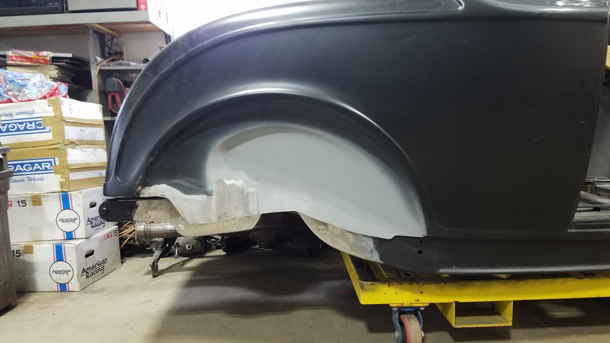

    By drilling out the spot welds on the sides, I cut and raised the section of the trunk floor above the differential. This let me make templates for the kick up and with the inside pieces welded in place, will let me remove the body and finish the kick up and no have to worry about body to frame clearance. Made the rear panel to finish the trunk floor kick-up that can be removed for easy access to the Model A spring in case I need to add or remove spring leaves to dial in the ride height. Also made a couple of cutouts to give me room to run the tail pipes over the Model A cross-member and keep them out of site.
    20170930_180108 x.jpg 20171009_122746 x.jpg 20171027_172031 x.jpg 20190126_132642 x.jpg 20190126_132925.jpg

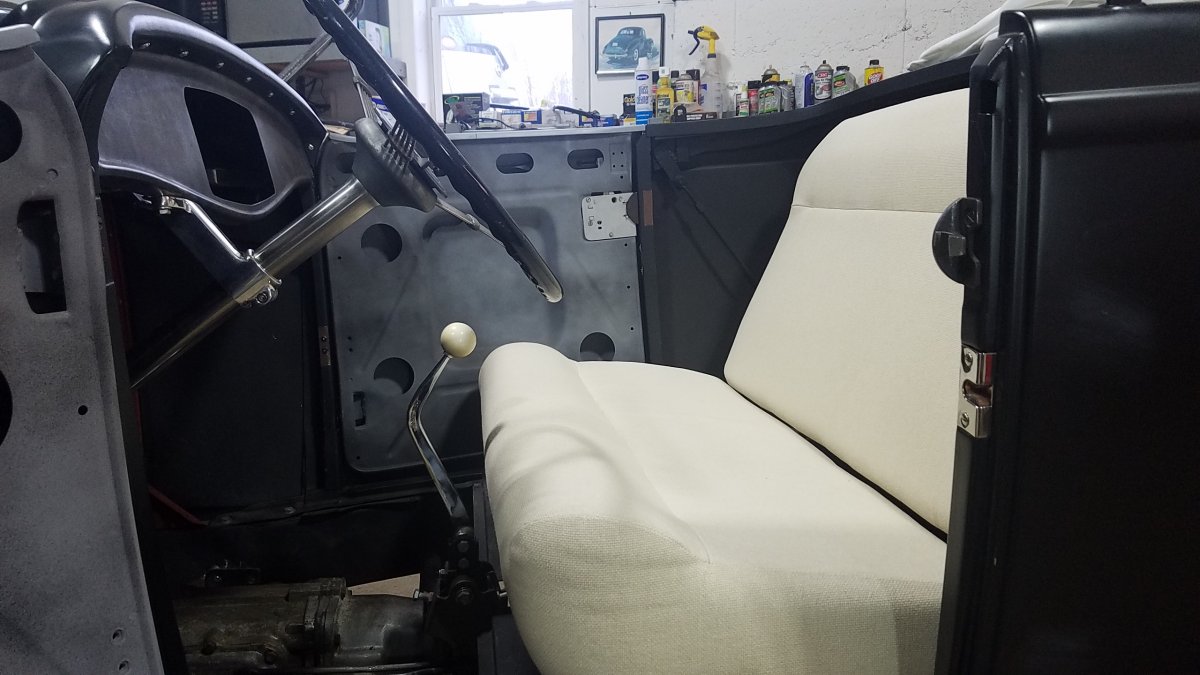

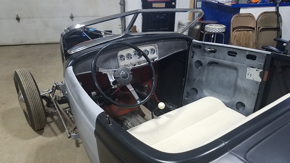

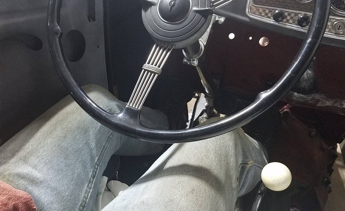

    Had the seat temporarily covered so I could set the height of the seat, locate the pedals, steering wheel and shifter. Nothing worse then going through all this work and having a car that is not comfortable to drive , or your knee hits the steering wheel when you try to step on the brake or clutch. Or you have to reach for the shifter to get into the next gear. Making it as ergonomically correct as possible. Leg room in Rdstr.jpg 20180224_160859.jpg 20180224_161742x.jpg

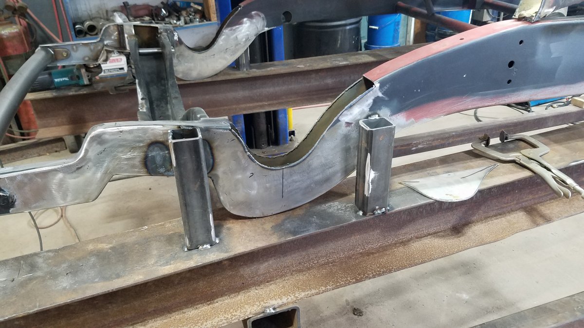

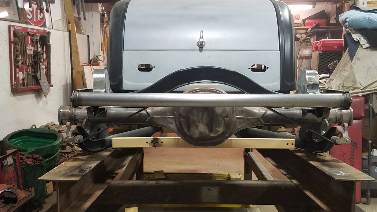

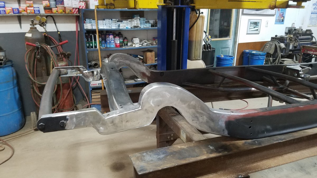

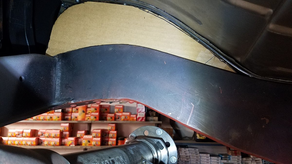

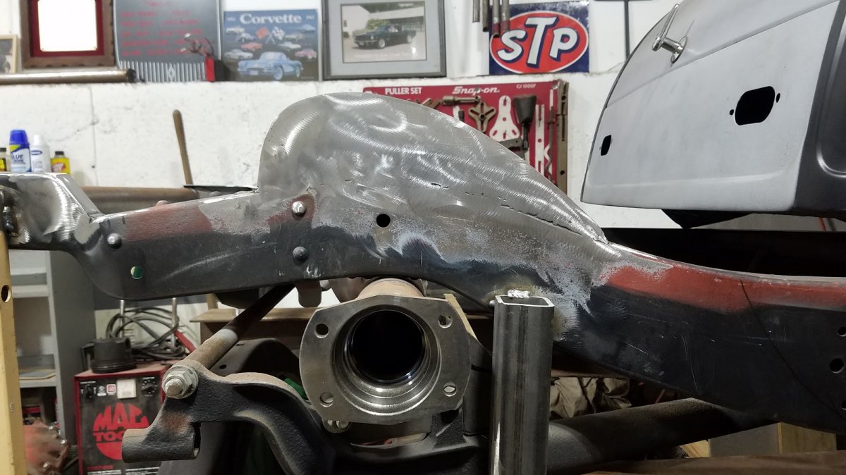

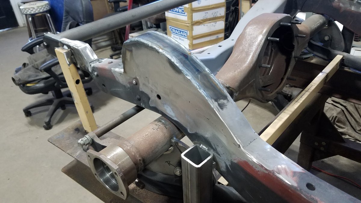

    Here is how I completed the rear kick up on the frame and install the Model A rear cross-member at the same time. By tack welding the inside plates on while the body was on the ch***is gave me the shape and height I needed without needing to put the body off and on a few times. Welded the outside plates on , than made the filler strips to cap them off. To weld the rear A cross-member in the correct position (and proper angle to prevent any binding) I installed the A rear spring ( less a few leaves) which located it perfectly. Once this was done, I flipped the frame over and cut out the "C sections" (should give me about 4 inches of axle tube clearance) than capped these off like I did on top. Wanted a nice flowing line from the bottom of the frame rail where it disappears up under the body. Still need to cut the body to follow the new cutout.
    20190105_182700.jpg 20190111_122512x.jpg 20190111_150143x.jpg 20190119_171913 x.jpg Deuce Chassis 2 2 19  a x.jpg Deuce Chassis 2 2 19  e x.jpg Deuce Chassis 2 2 19  g x.jpg Deuce Chassis 2 2 19  q x.jpg 20190203_120749 x.jpg

    Great idea. The flowing frame section like that looks so much better than just a half moon cut.

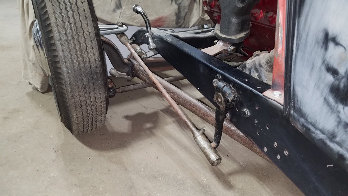

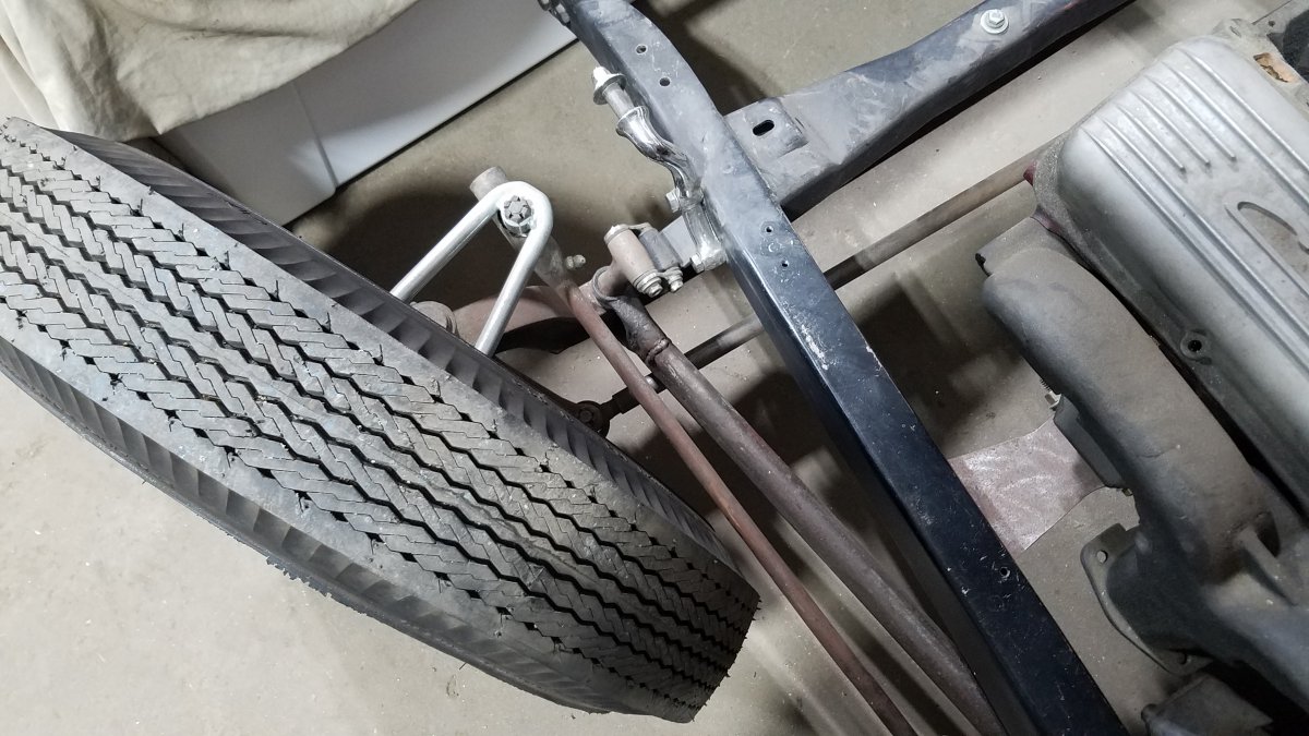

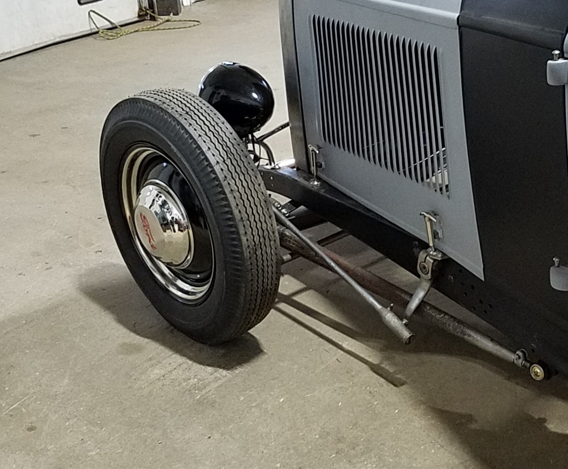

    Back when I built my Deuce 5W back in the eighties, I used a 56F100 box in it . In order to clear the wishbone, I heated and bent the arm outward. Worked fine, but the turning radius on left hand turns was a lot less than right. While putting this ch***is together, I did the same thing. Than I remembered the lack of sharp turns to the left. So I decided to move the front wishbone mts inboard about 4 inches. Now I can run a stock 56 pitman arm and turn almost equally sharp as to the right. And it gives the wishbones a better look, disappearing under the ch***is. Sometimes we grow older and wiser. :) Deuce drag link interferance a x.jpg 20181031_171018.jpg 20181031_171049.jpg
