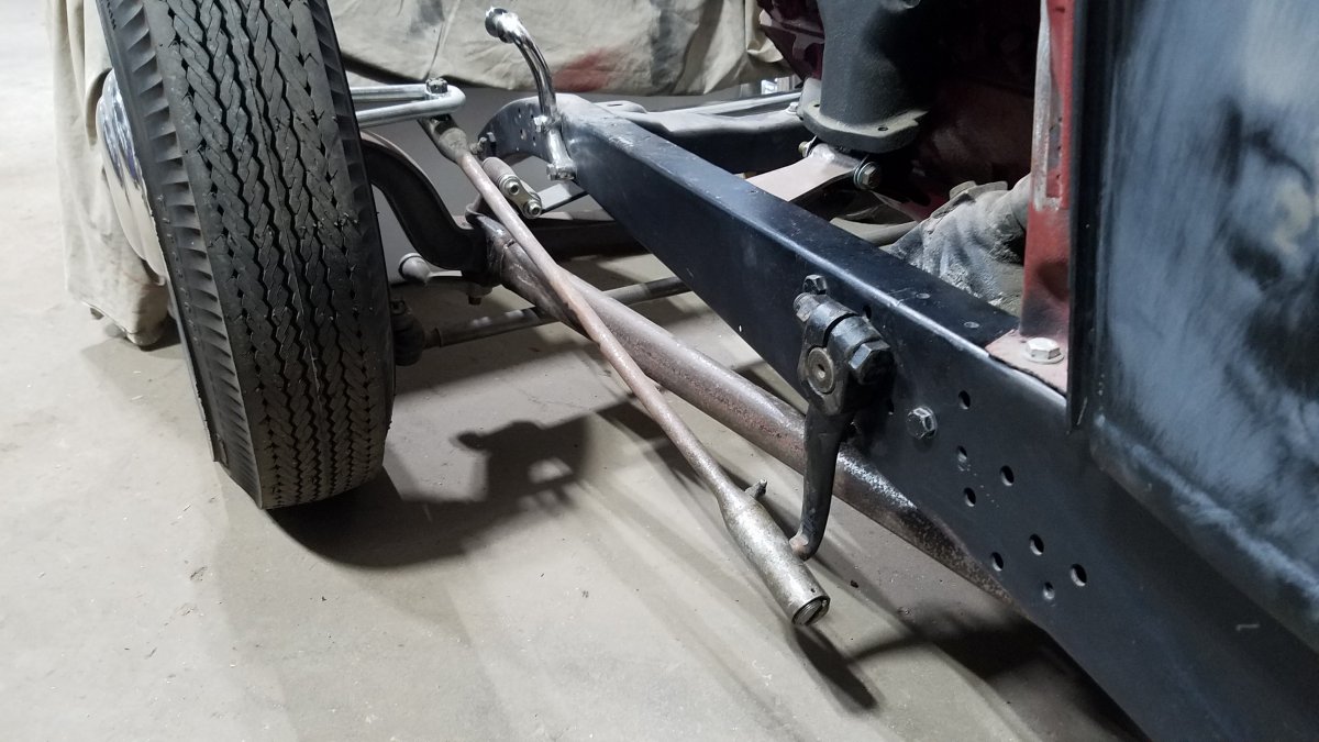

    Shifter location is very important to me. I like my hand to drop off the wheel and fall right on the shifter. And I don't like having to pull yourself off the seat back to get into 3rd gear. I modified a stock Hurst mount by cutting the top half off and moving the shifter mount forward 1 inch, and shortening the rods the same amount to give the stick just enough to clear the seat. Made a small cutout in the cross sill for shifter clearance. Sitting in the seat, everything feels comfortable, like an old pair of shoes.

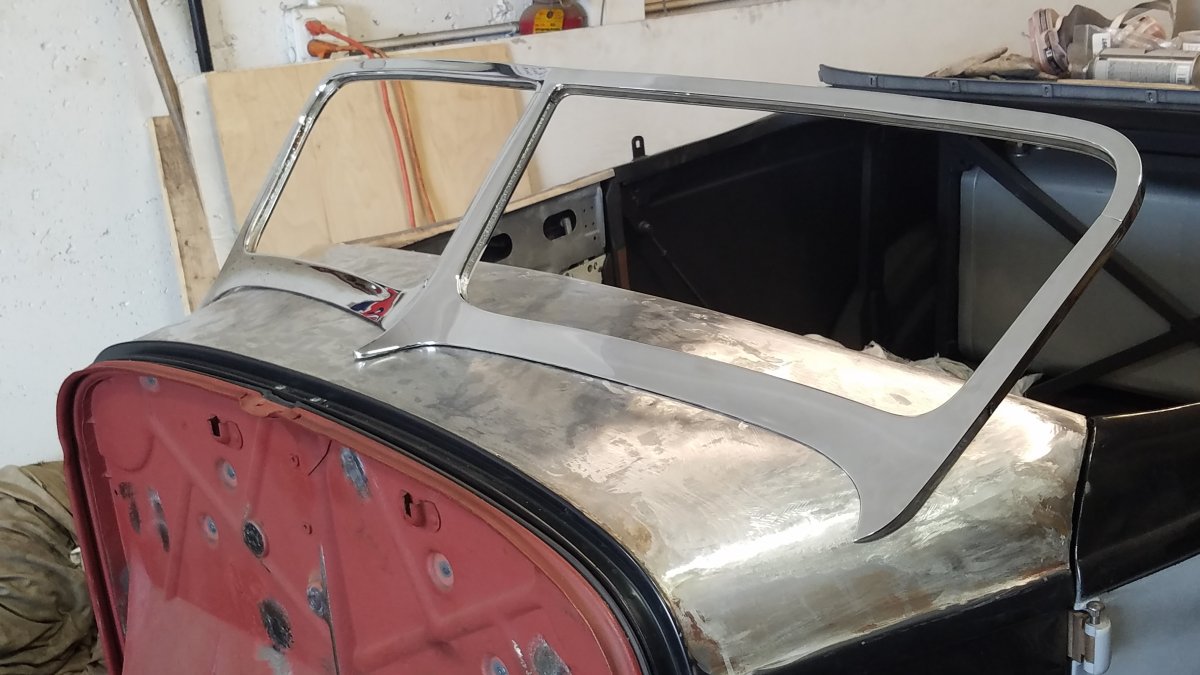

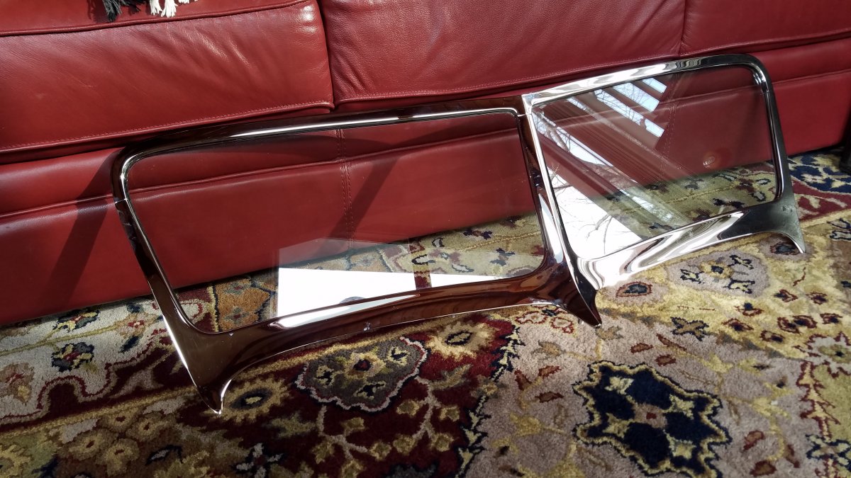

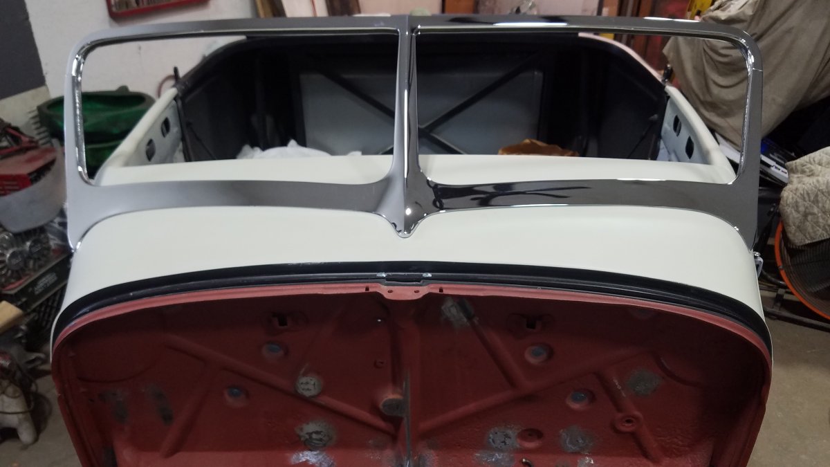

    Finding this Duvall windshield in the for sale section of the HAMB back in Dec, 2015 has certainly kept me busy over the past 3 yrs. Funny how buying one single part can totally change direction. I have two other "project cars" that I was ready to start on, one right after the other. And just like that, they get pushed back, still sitting and waiting for their turn. I sold my last Deuce Rdstr 31 years ago. I wanted one more to take into retirement with me. This is it.
    Dec 2015
    Dec 2018

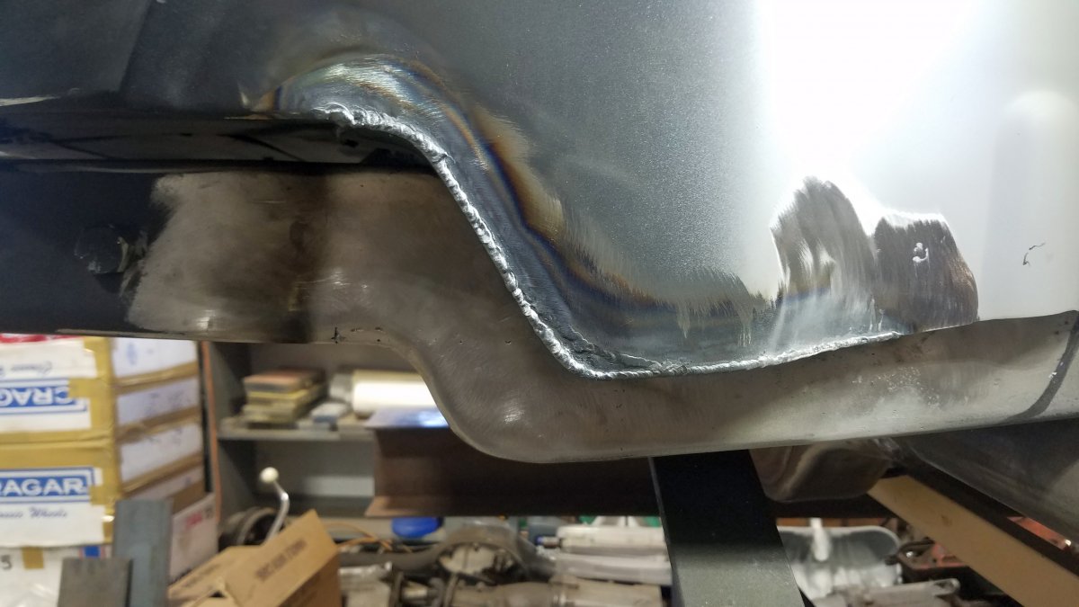

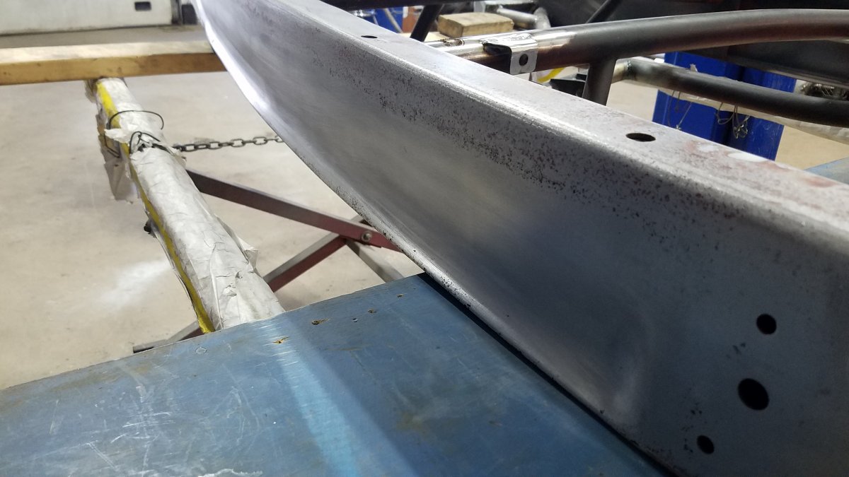

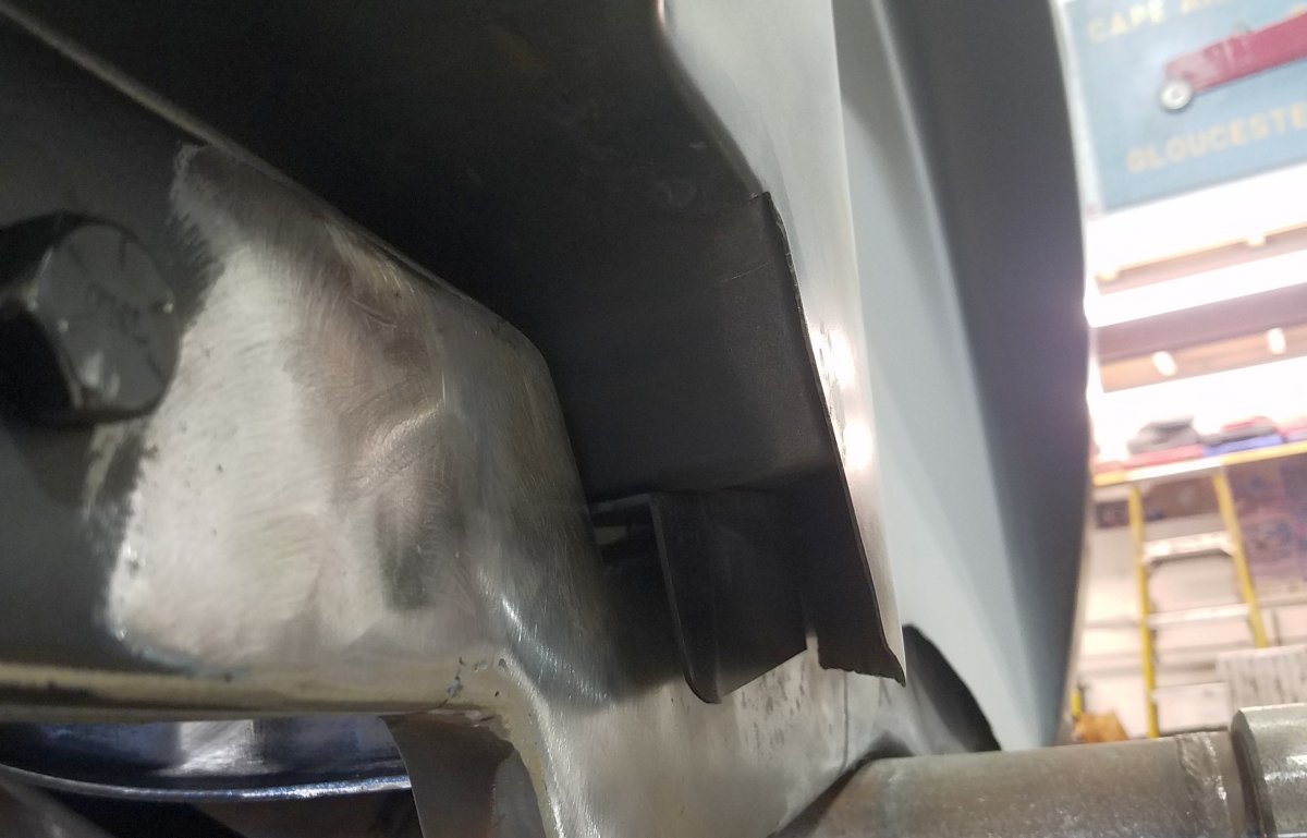

    Looking at the car from the back, I didn't like the opening between the rear wheelhouse and inner sub rail. Looked unfinished. Being an open-wheeled car, this is in plain view. So I made a couple of filler panels and welded the inner and outers together. While doing this I also made the lower wheelhouse follow the frame kick up a little closer. One more small detail only a few will notice.
    Rear inner fender panel to chassis 1.jpg Rear inner fender panel to chassis 2.jpg Rear inner fender panel to chassis 3.jpg Rear inner fender panel to chassis 4.jpg

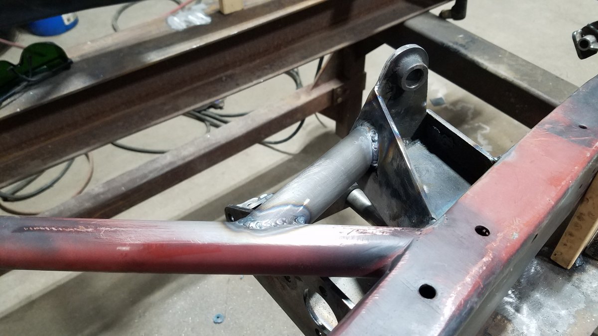

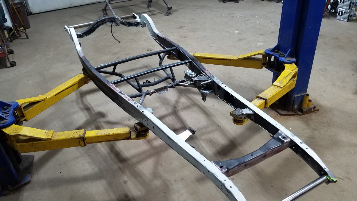

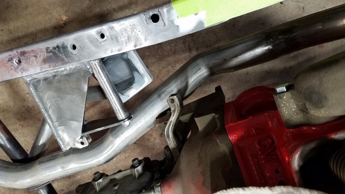

    Here are a couple pics of the mounts I made to move the wishbone mounts inboard. You can see in the last two pictures how much more turning radius it will have on left turns, plus the wishbones look better(and will work better) mounted this way. Tie rod bungs came from HAMB member CTaulbert ( very well made), and complete the job.
    Deuce Chassis 2 2 19  p.jpg Deuce Chassis 2 2 19  o.jpg Deuce drag link interferance a x.jpg Deuce drag link interferance b.jpg

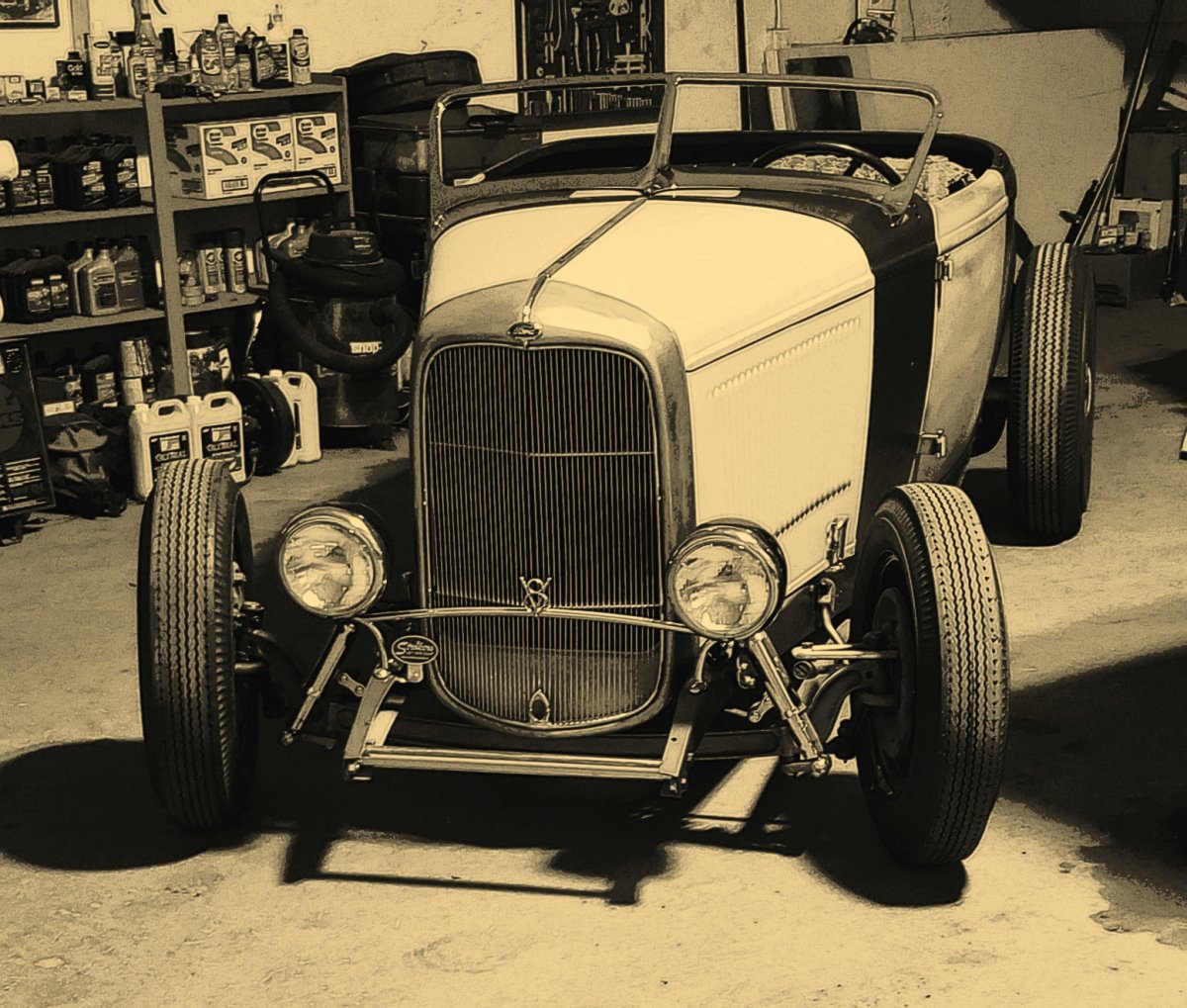

    Inspiration shot from last year.

    @Baron, I’d love to see a shot of the wishbone mounts from below, too, showing how you attach them. Looks like a good solution.

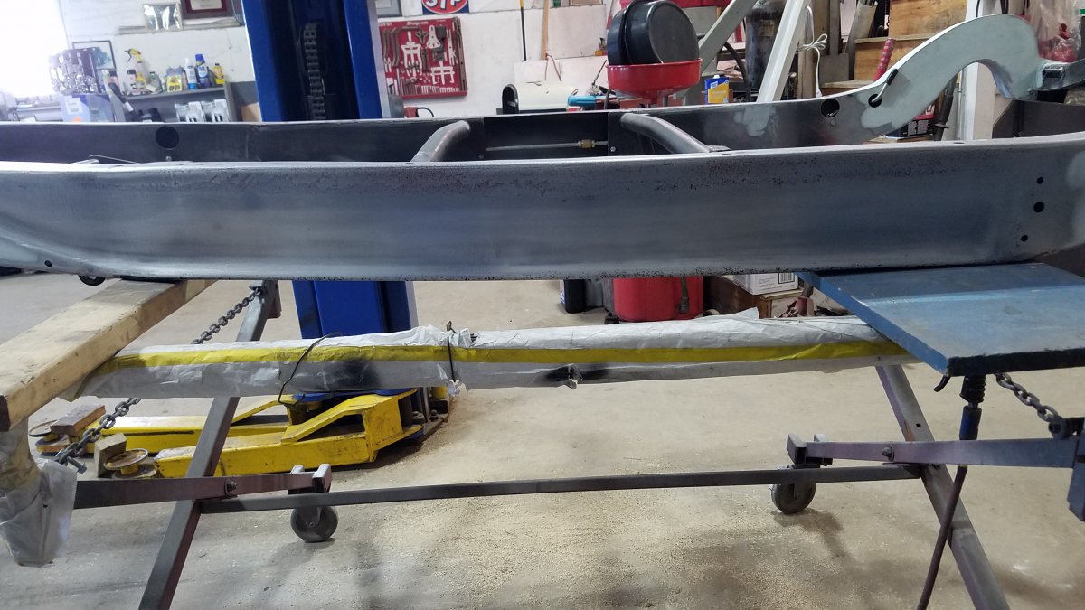

    Not great pics, but these show how I boxed them front and rear to the boxing plates and tied them into the center cross-member for a little extra support. Deuce Chassis 2 2 19  h.jpg 20190223_150955.jpg

    Here are some pictures of the inner trunk pan I made for the raised floor. Knowing I was going to swap out the 32 rear cross-member for the Model A, I knew what little space there was to run the tailpipes was going to be even less. So, I made these two 3 1/2"cutouts in the rear trunk pan (where the floor kicks back up) and welded those to the body to make room for the tail pipes to go over the Model A cross-member. I still need to weld a couple of stainless tips on the pipes to extend them down just enough to angle cut them so they just peek out in front of the rear spreader bar. 20171028_150622 xm.jpg Rear pan cutouts for exhaust.jpg 20190223_145850 xh.jpg

  19. brEad
    Joined: Dec 23, 2016
    Posts: 2,039
    brEad
    @Baron thanks for the pictures, exactly what I wanted to see. Looks very stout and provides that extra turning radius you were looking for. Nicely done!

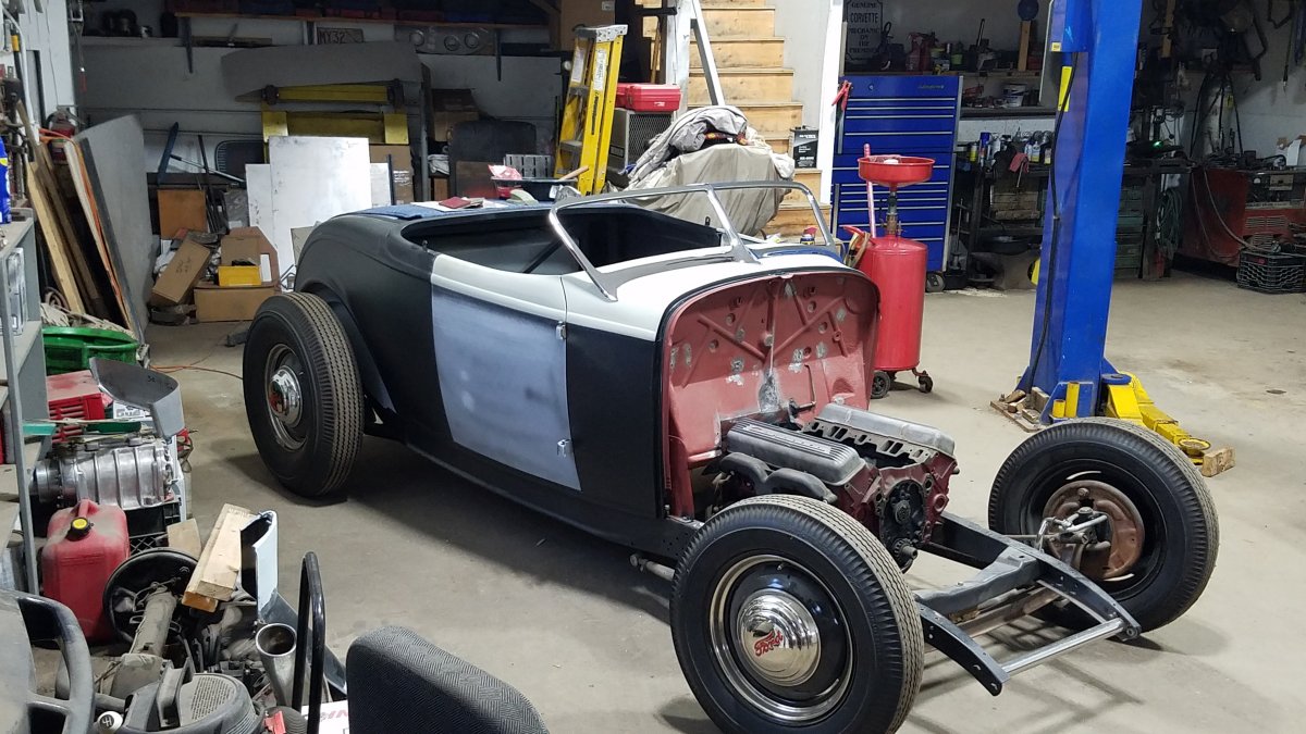

    Almost ready to hit it with some epoxy primer. Little more sanding and it will be ready to go.

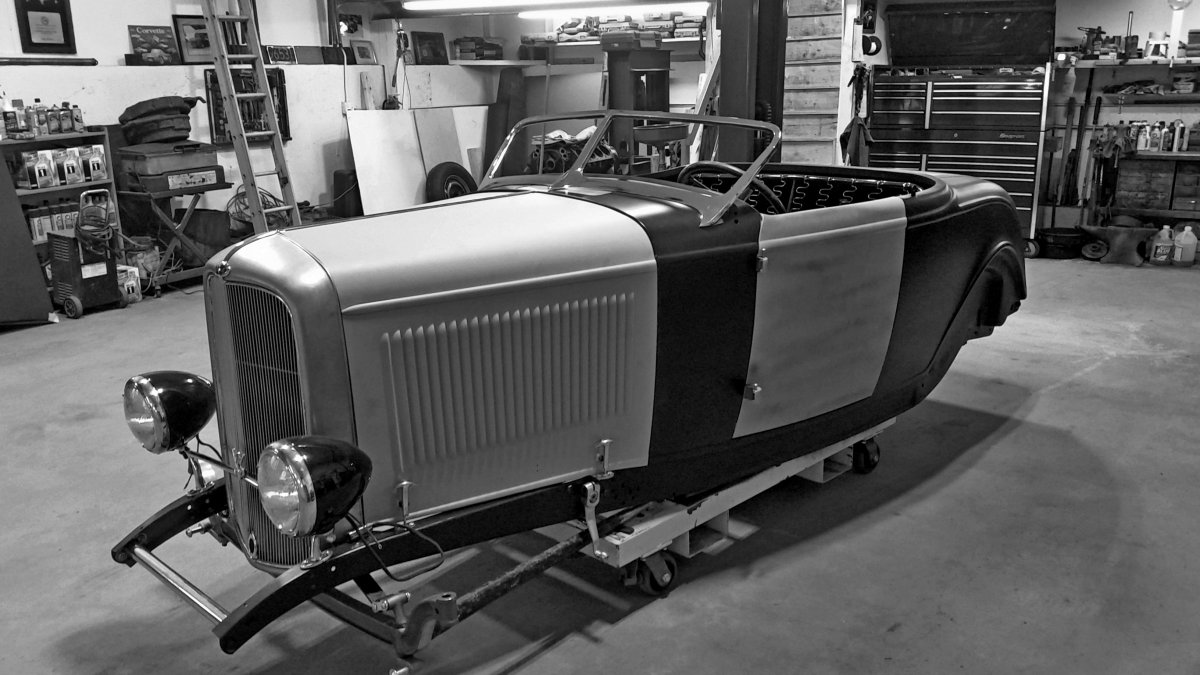

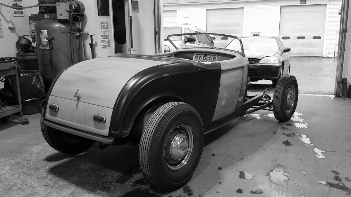

    Took this picture almost exactly 2 years ago. Fitting the hood a grille shell to the body and locating the headlight bar/headlights. Rdstr 3 24 17 bw.jpg

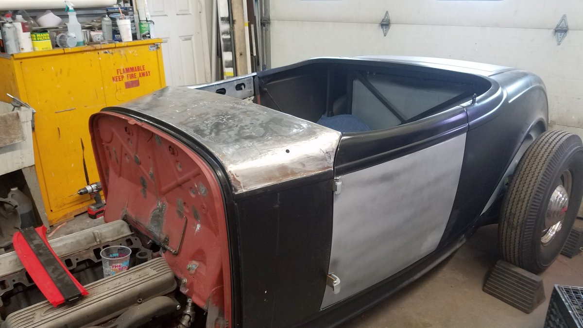

    One of the last pictures of the body on the ch***is. Next time it goes on will be for good.
