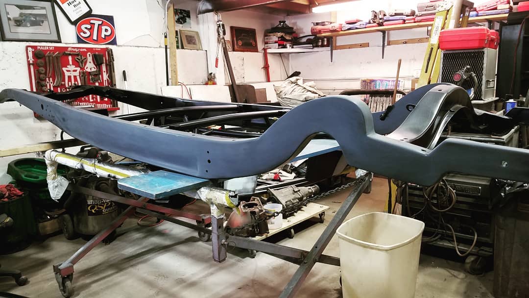

    Couple coats of SPI epoxy primer and the ch***is is looking almost ready for paint. Chassis in epoxy primer 4 1 19.jpg

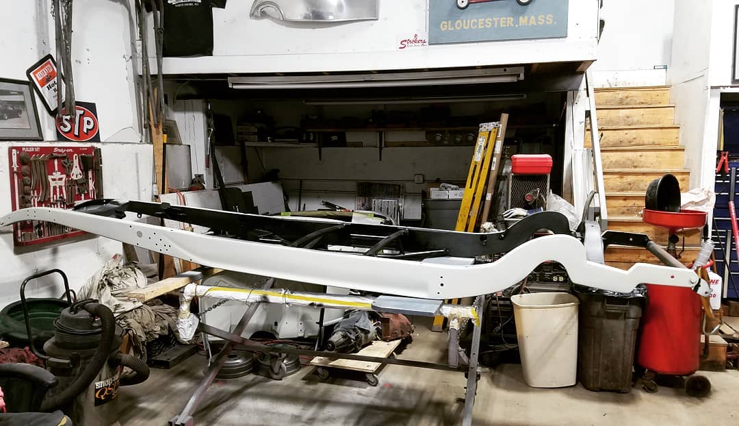

    Rails are looking pretty good in the Spies Hecker spray polyester. Couple small spots need a little more attention. Chassis in Spies Hecker sparable polyester.jpg

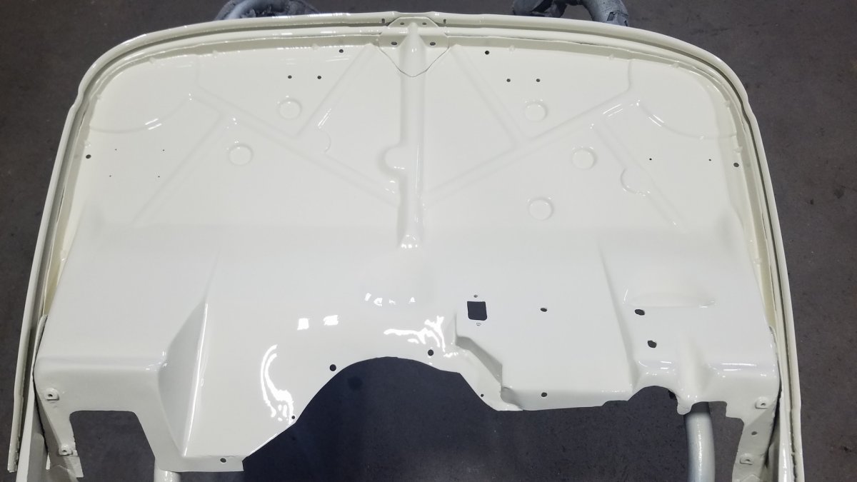

    I've had this old firewall kicking around for a long time (almost 20 years). Other than being badly pitted, it wasn't too bad. I must have 40 hours between making space for valve cover and bell-housing clearance ,making a dimple for the distributor along with welding up a few holes and filling the pits and smoothing the whole thing out. Tomorrow I'll go over this one more time, filling a few more pits on the mounting feet before one or two more coats of primer. Going to look great in Ford Wimbledon White.

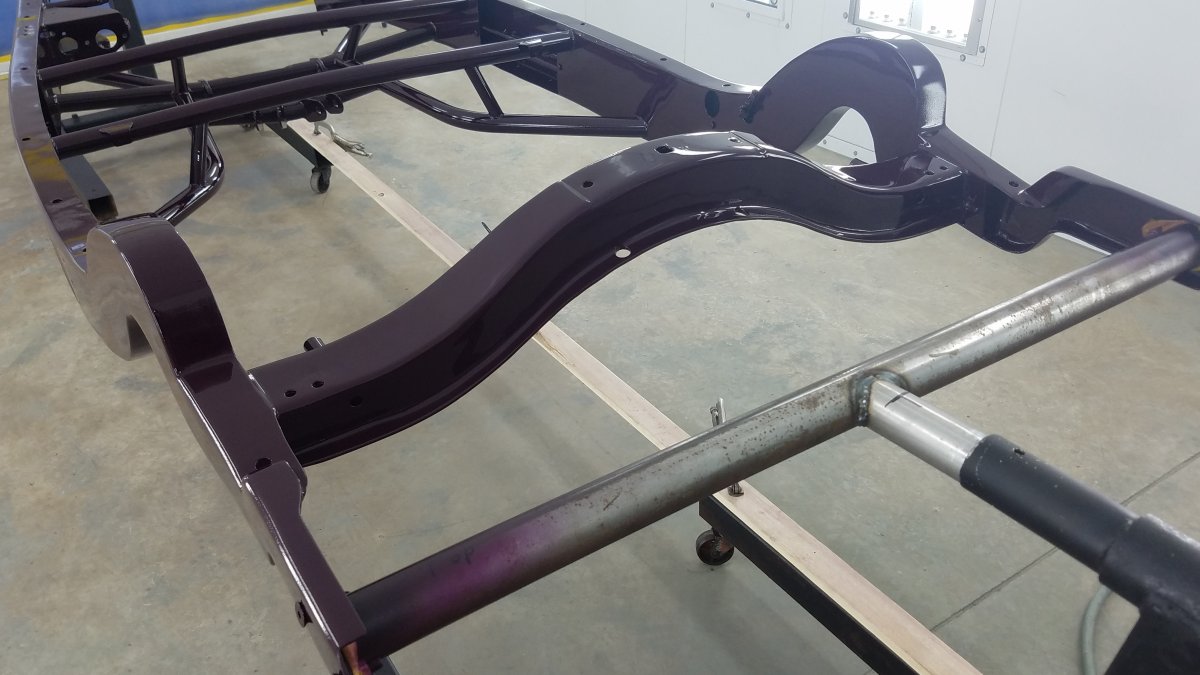

    The ch***is was painted this past week. Thanks to Mike Noonan for doing some beautiful paint work. Came out great. 20190630_092621b.jpg 20190628_170447.jpg

    Finished up the firewall today and painted it Wimbledon white. One more piece to the puzzle finished. Deuce Firewall 7 20 2019.jpg

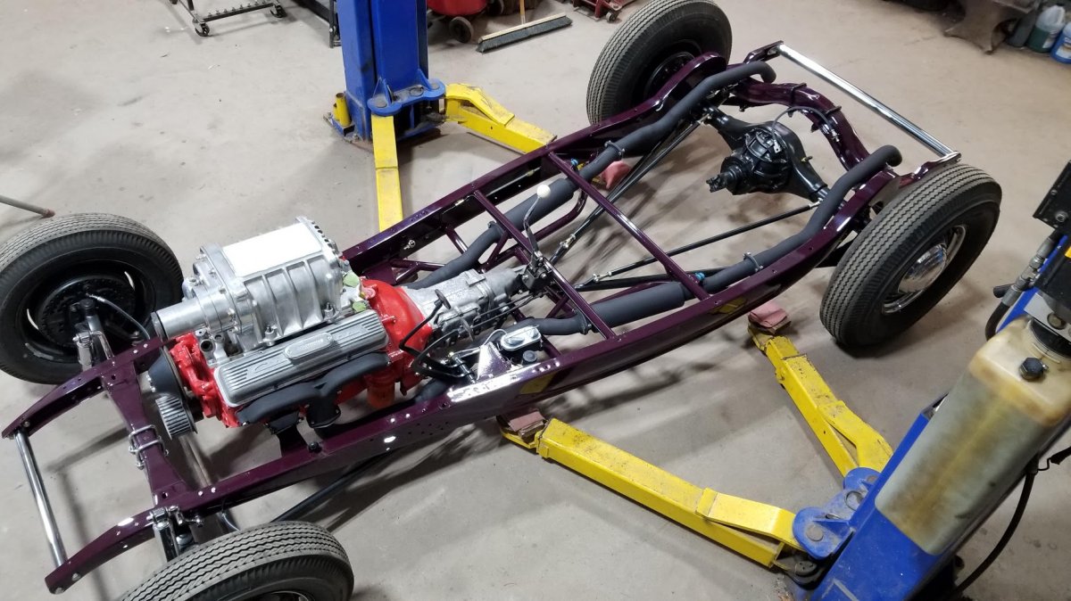

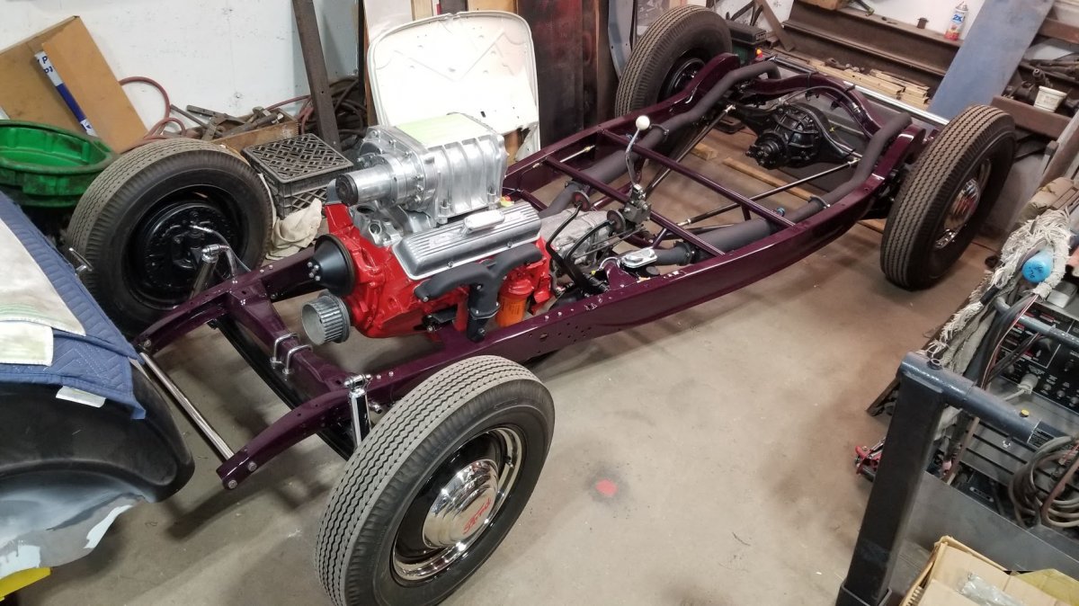

    Installed the 327 and 4 spd today, and ran the line from the clutch master cylinder to the slave cylinder. 20191116_104041.jpg 20191116_162205.jpg
  18. Baron
    Joined: Aug 13, 2004
    Posts: 3,677
    Baron
    Bolted the exhaust system on today. 2 1/2" pipes with Porter steel pack mufflers should let the blower motor breath and should sound decent. 20191117_123255.jpg 20191117_122524.jpg

  22. Baron
    Posts: 3,677
    Baron
    Thanks. The whole car will be painted the same. It's Aubergine . Looks purple inside the shop and more maroon outside in the sun. Took me two years to decide on a color....lol

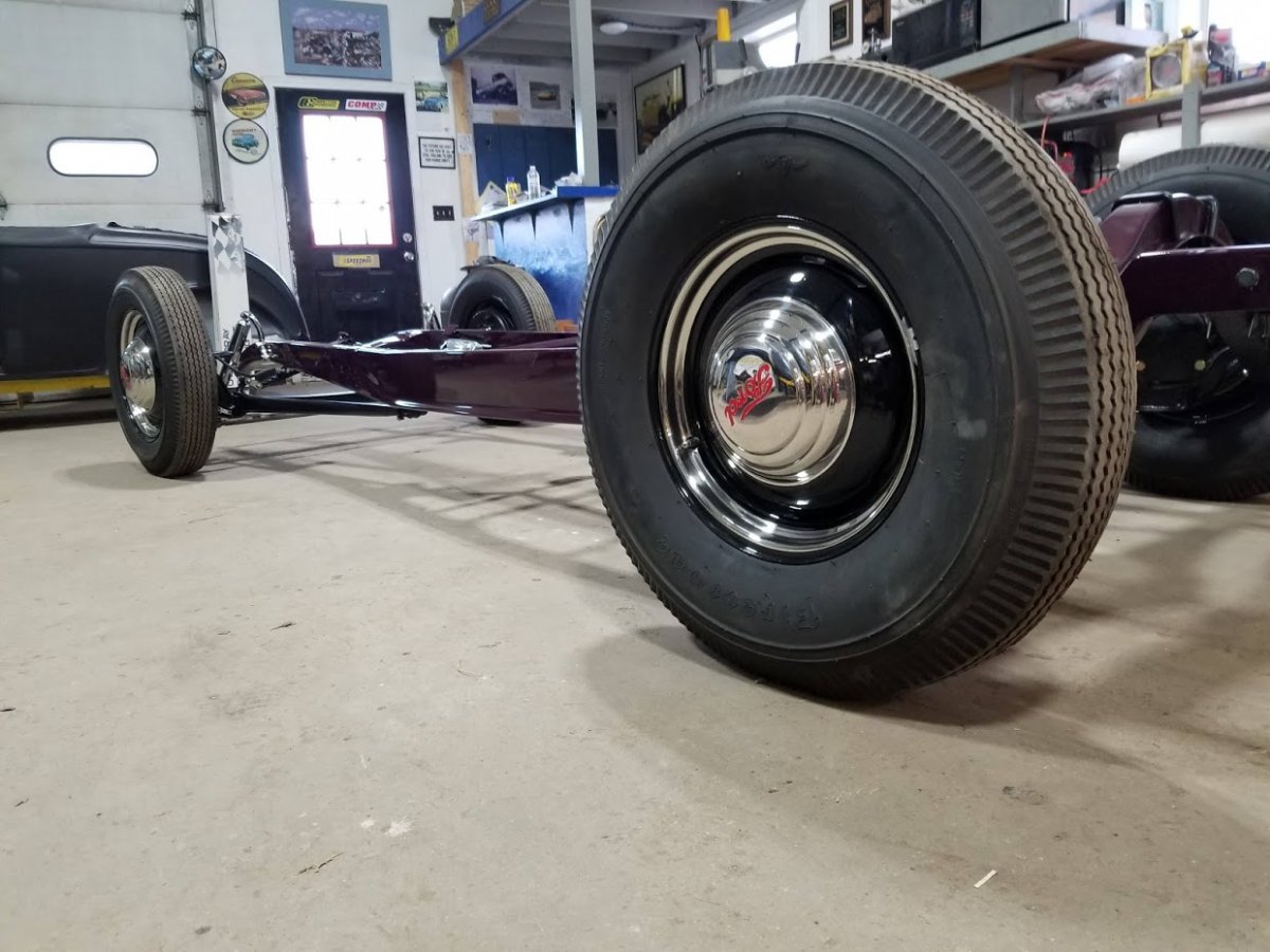

    Finished the front brakes Saturday. Brakes and clutch have been bled and are done and ready to go. Next on to install the fuel pump, radiator and hoses and get the motor ready to run. Plan is to run it long enough to break the cam in,hopefully before Christmas. 20191123_115233.jpg Chassis 11 25 19 b.jpg
