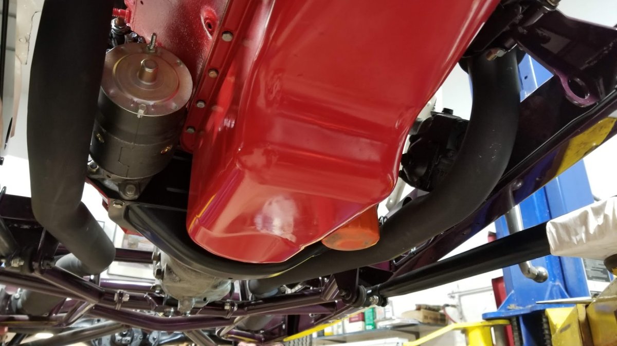

    Getting ready to start the motor for the fist time this weekend. Plan is to run it long enough for cam/lifter break in. 20191220_164151.jpg 20191220_153327.jpg

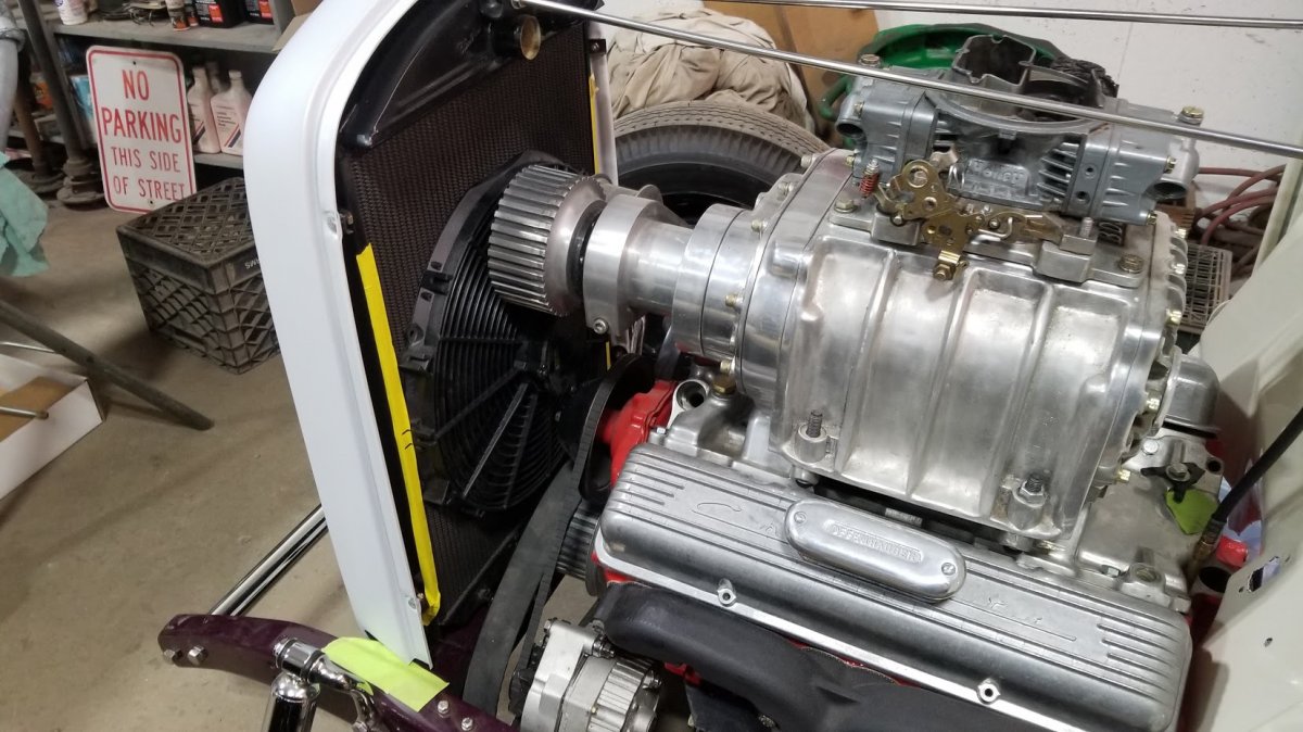

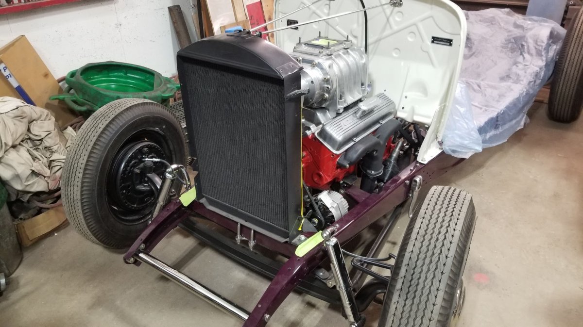

    Would have preferred a mechanical fan, but even with a two inch blower belt, that was impossible. Even to install this 16" Maradyne Fan, I had to order a 5 inch longer blower belt to move the tensioner pulley up to make room for the fan motor. The last thing I wanted was to see the fan mounted in front of the radiator where it would show up through the grille bars, so this should work fine. Next step is to make some mounting brackets for the fan. 20191226_170103.jpg 20191226_171633.jpg

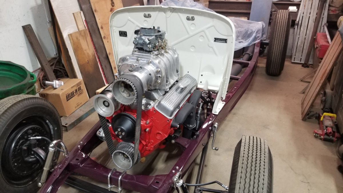

    Finished the brackets to mount the fan to the radiator. Made up the ignition wires and made a mount for the ignition coil. Waiting for the shorter poly locks (to fit under the Corvette valve covers) and a new blower belt. Once those are here, I'll adjust the valves, install the intake and it should be ready to start. Good way to start off 2020. 20191228_164329.jpg 20191228_112329.jpg

    Fired up the 327 today. Everything worked out as it was supposed to. Motor idles good with the "30-30" cam and exhaust sounds great.

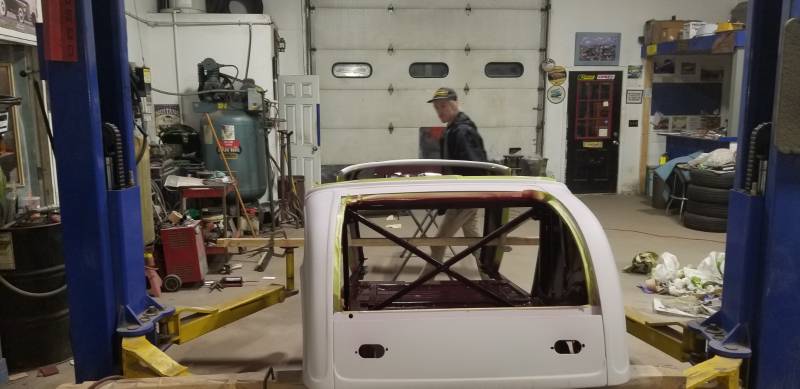

    Getting the body ready for paint. Inside should be painted Wednesday and the underside of the floor Friday. Than I bolt the body on the ch***is for the final time. I'll install the doors, decklid and fit the hood and grille shell for the final fitting, than pull those all back off and paint the body on the ch***is. This way I know all my panels will fit correctly, with proper gaps. In the past, every time I pull a body off a ch***is for paint, some thing always seems to change when it goes back on. Little more masking involved, but all my gaps will stay the same. Resized_20200113_131950(1).jpeg Resized_20200113_131959(1).jpeg

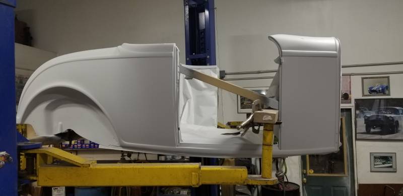

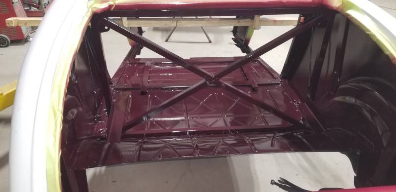

    Pete got the inside of body painted yesterday. Giving that a day to cure and Friday Jay will be applying the Wimbledon white to the underside of the floor. If all goes well, I should be able to drop it on the ch***is by the end of the weekend. IMG_20200115_181441_206.jpeg Resized_20200115_175235.jpeg Resized_20200115_175212.jpeg

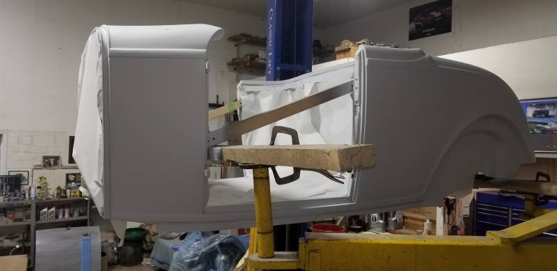

    20200119_143821.jpg 20200119_135352.jpg 20200119_135427.jpg 20200119_143840.jpg Floor's painted and the body is back on the ch***is. Time to fit the doors, trunk and hood one more time before paint.
