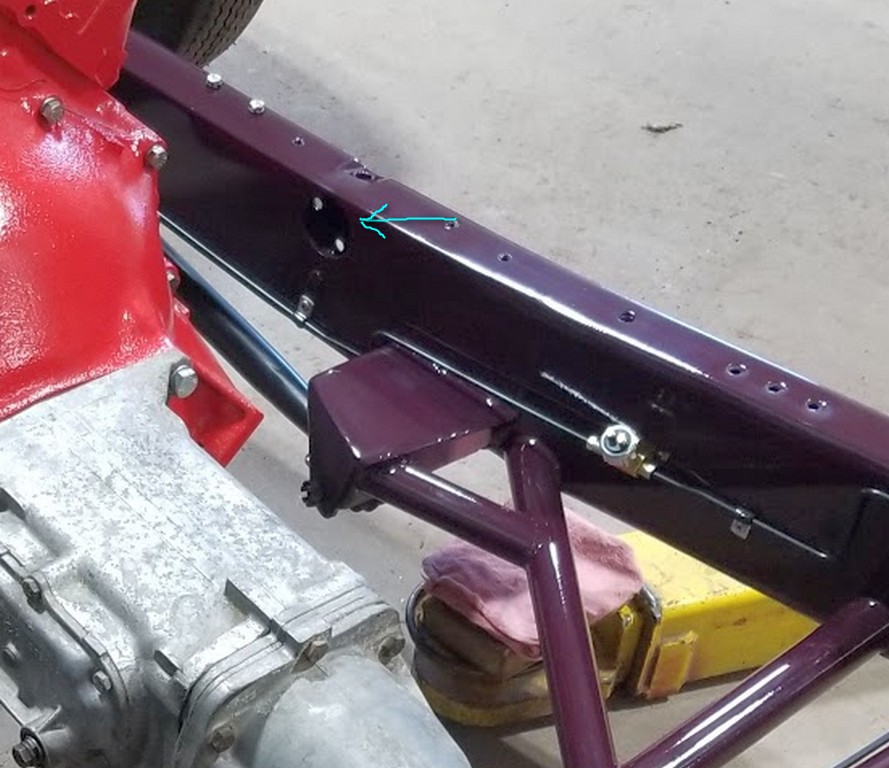

    Baron, any photos of where you ran the wires after they drop from the fuse panel, also any shots that show if/where they enter/exit the frame both front and rear of frame.

    I'll take some better pictures in the next day or two. Here is where the wires will enter the frame for the headlights and cooling fans, gas sending unit and tail lights, along with the positive battery cable to the starter. Deuce frame access hole for wires.jpg Deuce frame rear exit hole for wiring.jpg

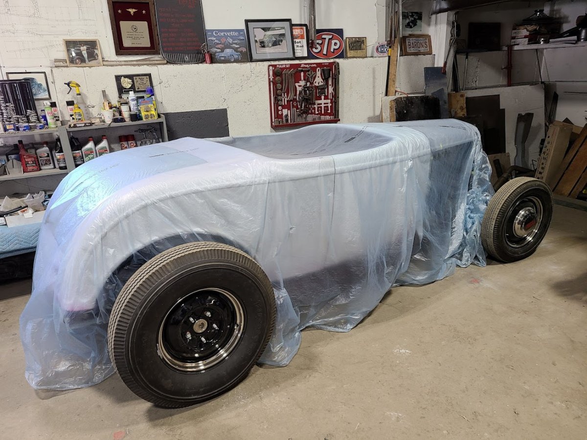

    Paints on hold due to COVID-19. Continuing the wiring and finishing other little details. All good.

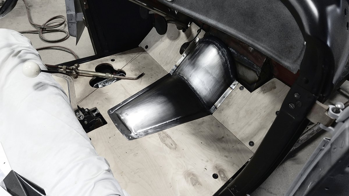

    Looks real good, i have the same car. Can you tell me where you got the trans tunnel? I want to replace the stock type tunnel/firewall and that one you have would work well. Appreciate it

    Something I bent up and welded together in my shop.

    I bent this using a vise on my work bench, then used a brake to bend the flanges. Made it out of cardboard first, then transferred it to the sheet metal. Gas welded it together, bead blasted the weld,scuffed it with some 180 , and a skim of bondo to hide the weld. Trans tunnel 1 x.jpg

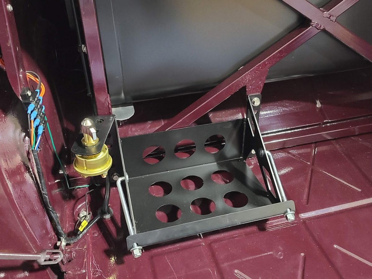

    Mounted the battery box and kill switch this past Friday. Picked out the material for the seat, and hope to have that upholstered in the next few weeks. Battery box 1.jpg Battery box 3.jpg Battery box behind seat 1.jpg

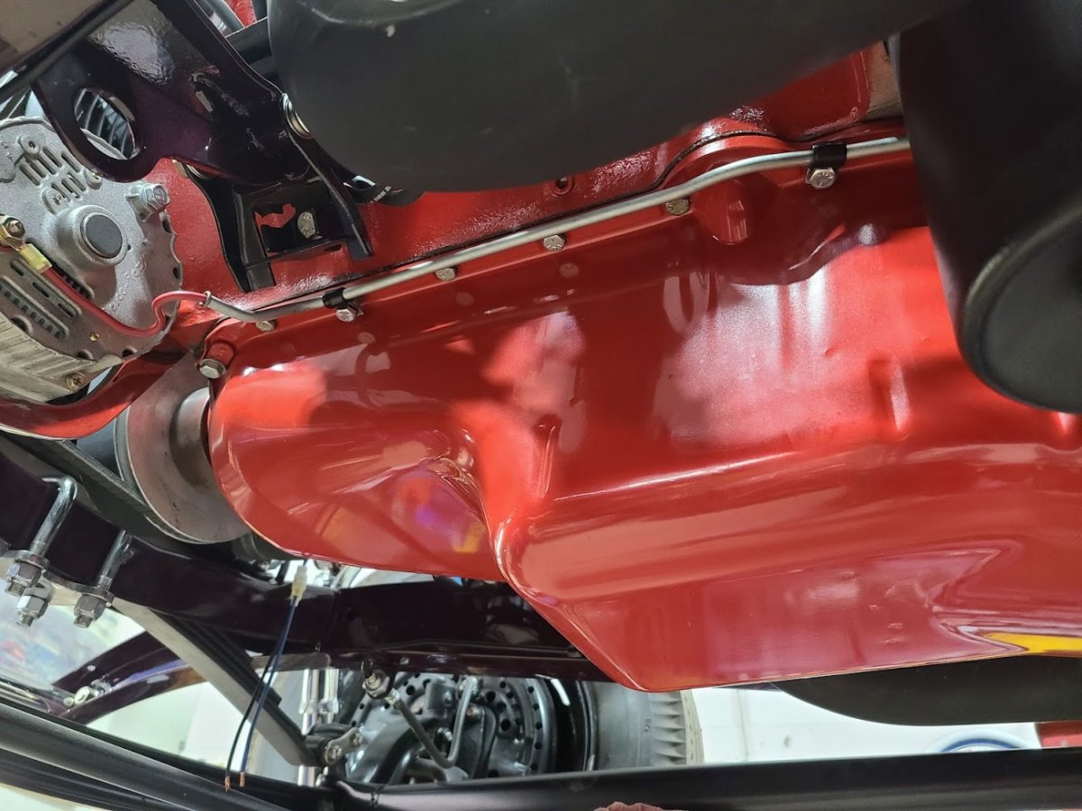

    Finished the fuel line/filter and vent hose yesterday. Nice when your able to start it up with the key for the first time.
