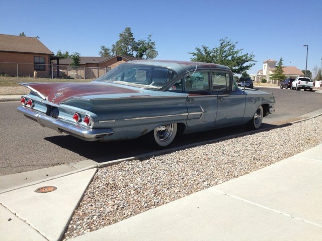

    It looks like the accelerator pump may be the issue, it squirts some but very very weakly. On the plus side I found a 30 foot spool of new hard line in the garage so ill probably just replace everything from the tank to the carb and rebuild the carb today. I'll keep you posted but in the mean time here's a pic to share, thanks guys! ImageUploadedByTJJ1370794665.576694.jpg

    You see that old tv antennae?
