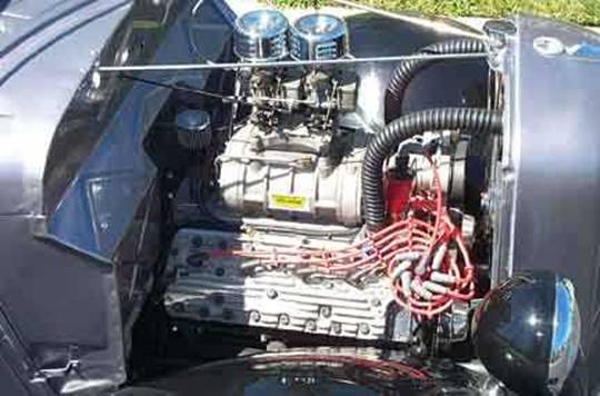

  3. Hey Mate,
    Looks pretty trad to me...
    Danny

  6. Hey, thanks for the picture. I haven't seen a RoadRunner kit that wasn't fully pollished. I do like that, I may have to call and see if he can put me together a kit that uses the 2" drive pulleys.
