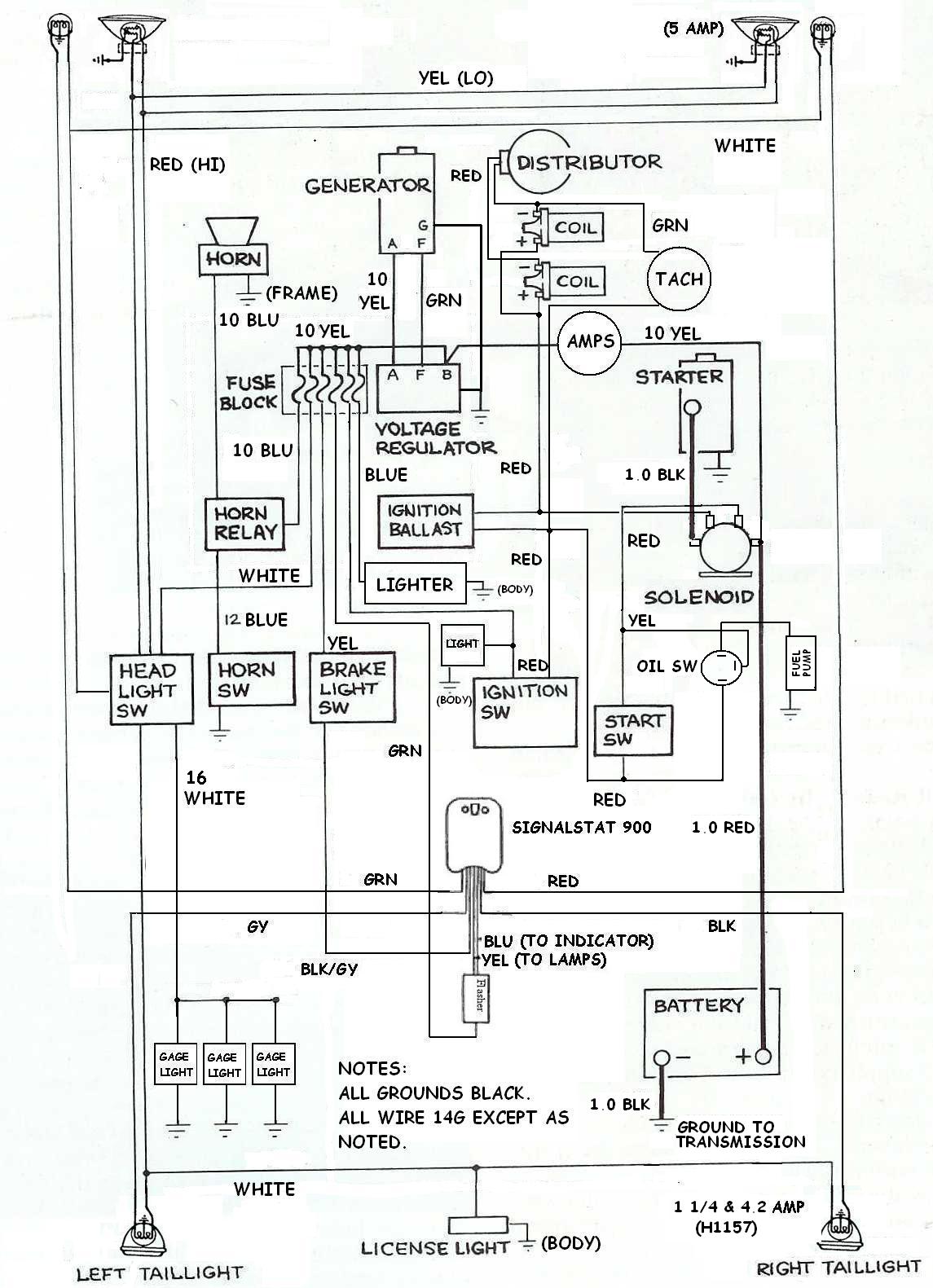

I've done some searches and haven't turned up much on these. I'm going to attempt to wire my project from scratch with cloth covered wire. I want a panel or block that terminates at the panel rather than the typical panels with the looms already attached. Thier great for thier purpose, but not for what I'm doing. So I'm looking for a stand alone panel such as these Centech units: http://www.centechwire.com/catalog/panels/index.html I'm only running the very basics, ol 283 with generator, headlights, tail / brake lights, etc, thats it. No turn signals, radio, wipers...it's a hotrod. Recommendations? Feedback? Thanks
