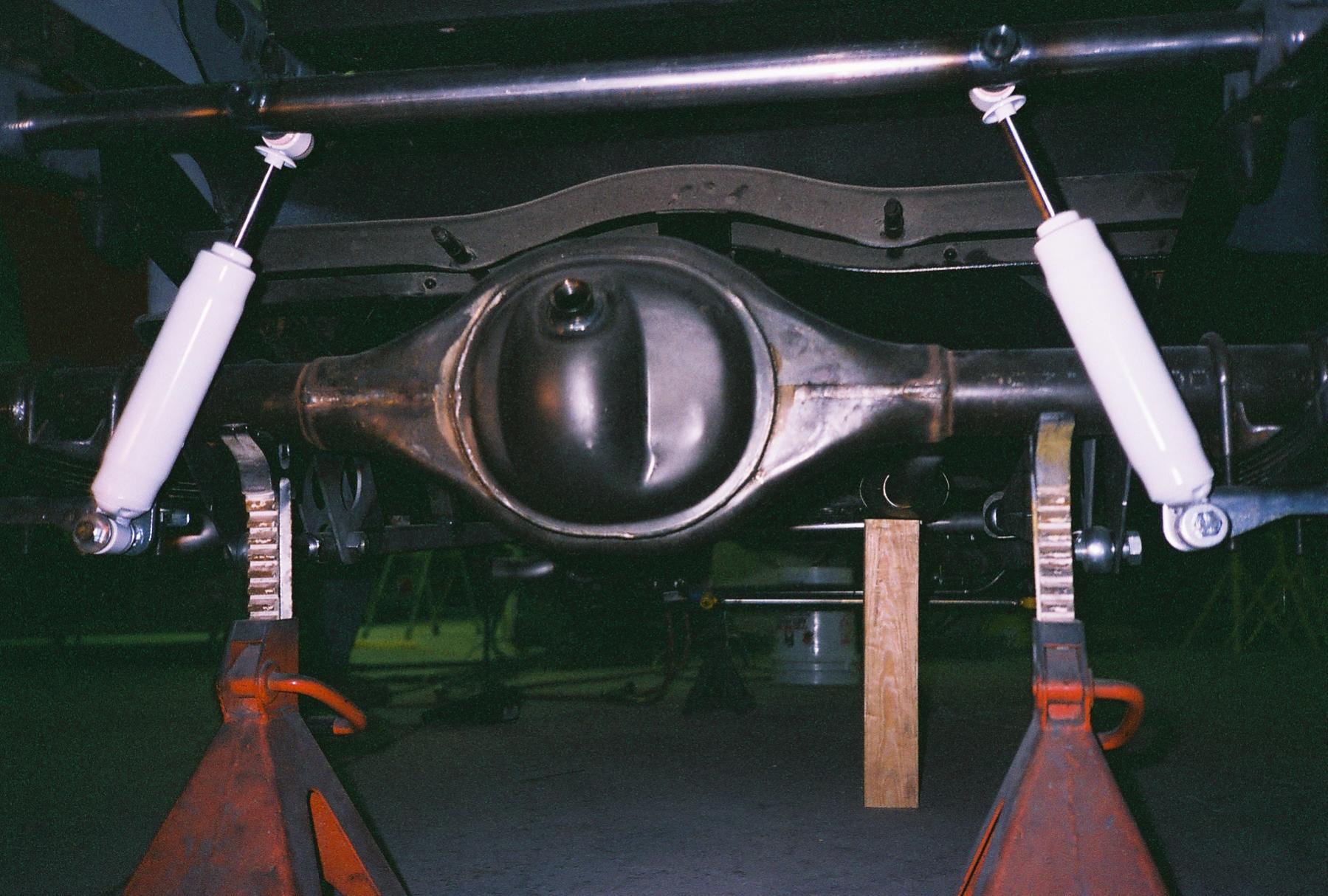

    The rear end will be replaced with a 9 inch ford using coilover shocks and ladder bars.

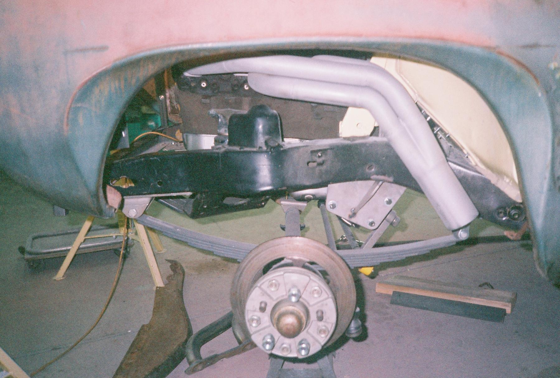

  14. Building a 60's Gasser style Henry J myself, I choice to keep the
    original frame and modify it as required. Is it easier to cut the frame
    forward of the firewall and stub on the 2 x 4 rails???? Are you going to
    run the steel nose of go to a fiberglass tilt one? I figured in the 60's
    more were built with the stock frame modified with a straight or dropped
    axle and parallel leaf springs. I used one of the Speedway Motors axle
    kits with the 4" dropped axle w/ ford spindles, vega steering, 56" wide
    9" ford rearend and some 50" long nostalgia ladder bars, 1 3/4" fenderwell
    headers with dumps under the front fenders and radius wheelwells.
    Right now the frame is out from under the body for finish welding and
    filling some of the 60-70 holes in the stock frame. Since we tilted the
    steel nose, the front frame section needs to be detailed as it is almost
    like outside paint with the nose tilted.
    Will post some photos of the project.
    John

    Are you using the original rear springs? I had planned on coilovers but the original springs would be easier on the budget now. I'm gonna narrow a 9 inch ford rear end.

  20. How narrow you going ? I have that early bronco 9 inch in mine and fits pretty good.

    Haven't measured yet. I hope to find one from a Bronco or Mustang. I have one from a truck but it'll for sure have to be narrowed. I have the aligning jig to narrow the rear end and Moser will respline the axles for 100 bucks. It's fairly easy to do. I'm a custom muzzleloading gunmaker and have a pretty good little country machine shop to make my barrels so building the front axle is not a problem. Getting anxious to get started.
  23. I ran the original rear springs, new bushings & shackles, if I need to
    get them rearched or something later, not a big issue. Talked to the
    Eaton Spring people about Henry J springs, they can custom make them,
    but do not have a stock replacement available.
    I had Moser build my 9" housing and 31 spline axles. Ordered 56" axle
    flange to flange, which makes the housing 51" with late ford(Torino) ends.
    I also had them do it as a centered pinion, so the driveshaft runs down
    the center of the tunnel(do not know if it would create an issue later) but
    it did not cost any more to have it built that way.
    John
