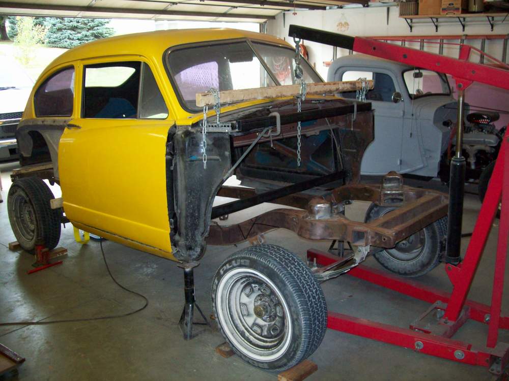

    Hey Swade,
    I'm following your lead. does the bottom cut line look ok?

  5. swade41
    Joined: Apr 6, 2004
    Posts: 14,611
    swade41
    from Buffalo,NY
    I like the bottom line but it depends on the cars ride height and also the tire height.
    drgrcr50 and I both cut ours at 32 inch diameters but his car sits lower so the cut is higher up the body.

    I didn't want the cut to be too high. I'd rather raise the car up a little. I like the way yours sits. Now to make the cut.

    Ok fellers, we're getting down to the nut cuttin' now. Or actually the firewall. It's sure got to be cut. I'm using the stock steering box and I think a 3 inch setback will do it. Take a look at the picture and see if I have the right idea on a cut. The marks aren't centered, just an idea. It's thinking time now.
  20. Smilin Jack
    Joined: Nov 8, 2010
    Posts: 465
    Smilin Jack
    Fenders and radiator support are back on loosely and everything fits. Something must be wrong. There is room for the tunnelram and to get the distributor out too.

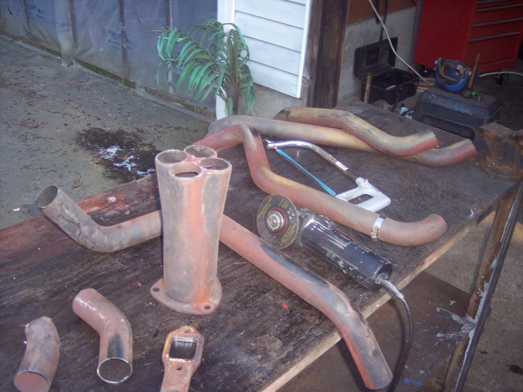

  21. Building a set of custom headers is not as tough as you may think, here's the ones I built for my J. I took a set of fenderwell headers from a BB Dart that were cracked at the flange, got them for free, and cut the pipes off about 2 inches from the flange, then cut the flanges into 3 pieces each, making them individual flanges on each end, dual flanges in the middle. That made it easy to repair the cracked one and gave me my starting point. Since they were fenderwell headers from a full bodied car they had lots of pipe to work with, I cut the collectors off, bolted one of the middle 'dual' flanges on each side and started cutting and fitting, putting the pieces together with duct tape until I was happy with where they exited. Then I put a couple tack welds on each joint, and fitted each end pipe the same way. Once that was done and I liked the way it all fit, I welded the pipe joints up and made them smooth and pretty with the grinder, welded the flanges back together, then welded the collectors back on. It was a fun project, not too difficult, but a little time consuming, I spent about 12-15 hours, my only cost was half a roll of tape and welding wire. I'm not an experienced welder, just been fooling around for about a year or two, and it was not beyond my scope. Just remember to plan for those spots you can't reach to weld as you ***emble them. All the tubes ended up being within 1 inch of each other in length and they don't hit anything. Mines BB mopar with an Alston frame, but the principle would be the same with chev, maybe easier with the stock style ch***is since you don't have to go up and over anything.

    440Dave,
    Thanks for the info. I've got myself g***ed up into thinking I can do the headers. So far today, everything has gone smooth. Firewall cut and the old engine is in place and ready to make the motor and trans mounts. It kinda bothers me when every thing runs smooth. I'm more used to blood letting. LOL
    I plan to get the headers fitted and tacked and get someone who can do a neater job of welding than I can to finish them. Thanks again,
    jackie
