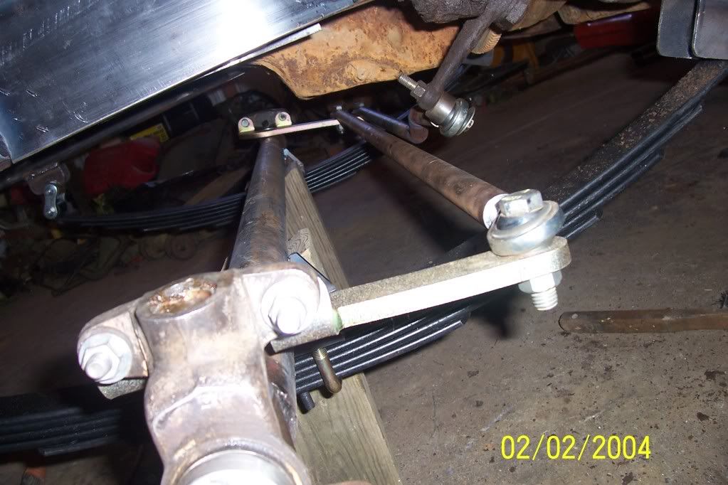

    I'm using the stock steering box. I will get some pics of it and post. Worked out well. I'm going to drill out the pitman arm for 5/8 bolts for the heim joint. I got things bolted together temporarily. still have to get the brake caliper brackets bolted on.
  17. Smilin Jack
    Joined: Nov 8, 2010
    Posts: 465
    Smilin Jack
    Thunderbolt, here are some pics of the steering box and pitman arm. As I said, I still have to get proper bolts in but I have it "dummied" up to see if everything works ok.
  18. 64 Thunderbolt
    Joined: Feb 8, 2011
    Posts: 277
    64 Thunderbolt
    Hey Jack, Thanks for the pictures!
    That gives me some ideas!

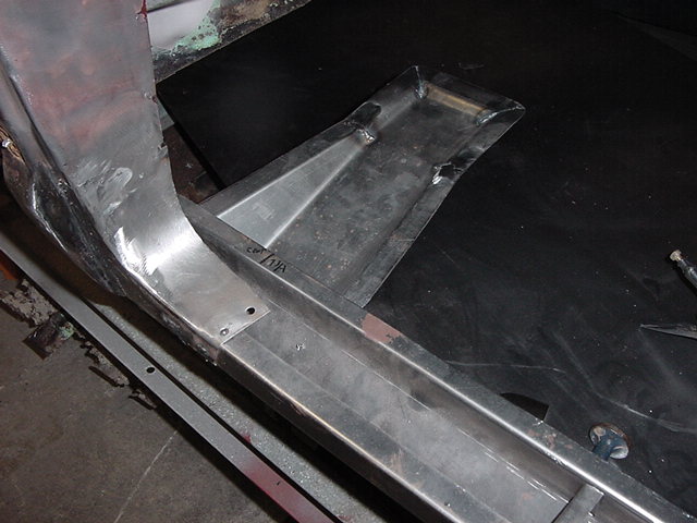

    One floor pan in and one to go. Chip Foose probably wouldn't like it but I doubt he'll be looking at it. LOL I tried to make it look clean on the bottom too.

    Well, I got the p***enger side floor pan without much problem. The driver's side ain't gonna be so easy but it's going in. I was standing in front of the car feeling proud of myself and realized when I moved the axle from under the springs to the top, I welded the darn thing in upside down. I cried tears big as horse turds for a while, took it out and cut the brackets loose and welded them in like they should have been. Oh well, that's hotrodding! LOL

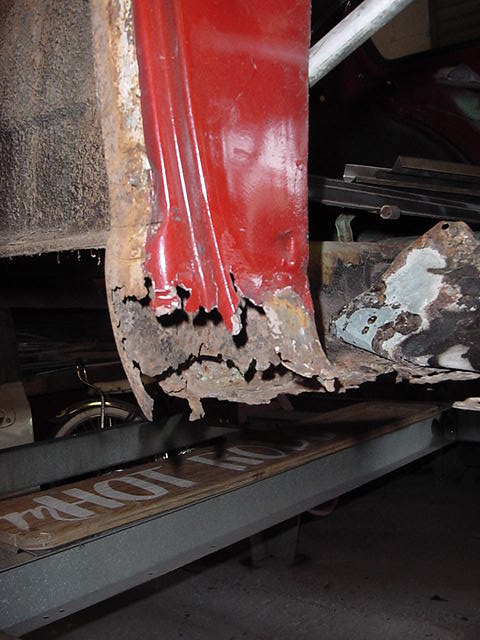

    I got the driver's side rocker panel mostly finished today. About ready for the floor pan. This rocker panel was rusted completely through. Had to rebuild the "V" shaped sub frame before making the outer rocker panel. It'll need a skim of body fille4r but all will be ok.
  30. HOTRODPRIMER
    Joined: Jan 3, 2003
    Posts: 65,275
    HOTRODPRIMER
    Wow,,Jackie,,I had no idea that rust was hiding under that rocker panel but you sure have it looking good now!
    What are your plans for the new floor pans to keep them from oil canning? HRP
