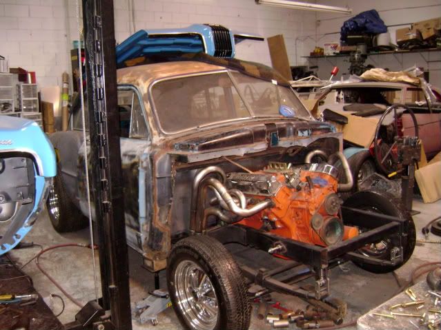

    Mine has a 2x4 frame stub, and a 54 chevy truck front axle. the steering is-unique, to clear the big block mopar starter, but is a vega box. I have 30 inch ladders, with coilovers at the rear, but if you can find one, a 57-59 ford car 9 inch bolts to the stock springs[​IMG]

    I like those headers. They are wild lookin'.
