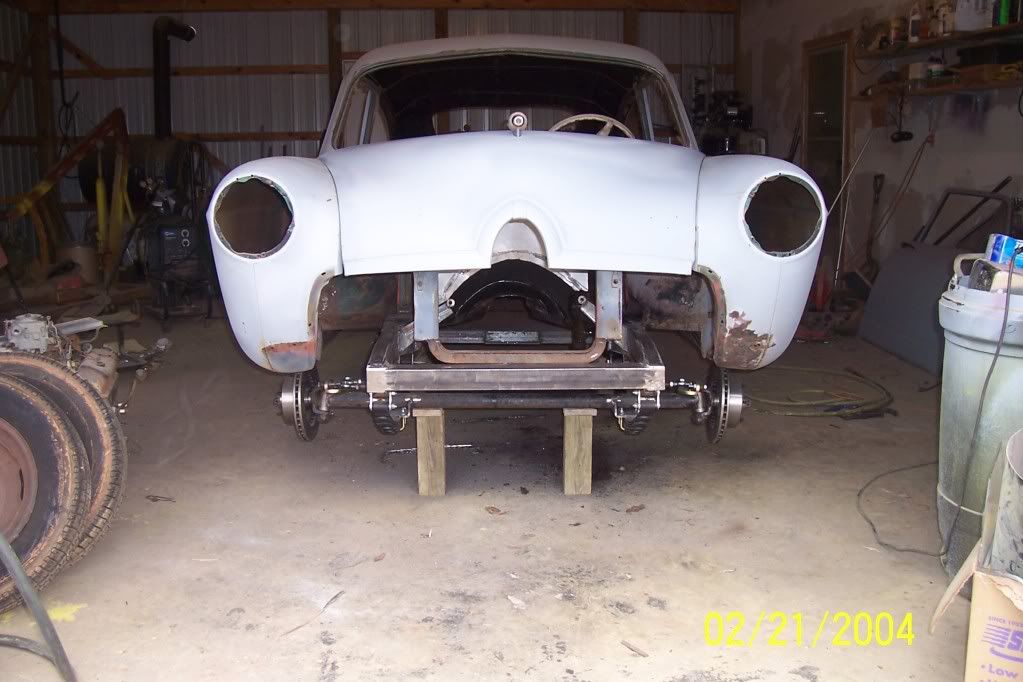

    Well, the ladderbars, front bar, and coil over shocks are ready and waiting on a rear end. Can't do more until I get it though. Always welcome ideas.

    She's slowly taking on the look of a g***er. Still have to make my own motor noises, not kewl, but it's a raspy fuel altered sound so ain't bad. LOL Got to have a Moon fuel tank for the front.

    New way to think about "your car looks like it's on stilts man".....lol looking good Jack, I took a similiar picture myself today.

    Man! Those stilts look dangerous. Please buy a set of jack-stands. I don't want to hear any jokes at your funeral about why they called you Jack. All it would take is someone to lean on a fender.

    The back is on jack stands. The front stands are 4 x 4 an all is solid. The old g***er may do me in but it'll be down the track! LOL
