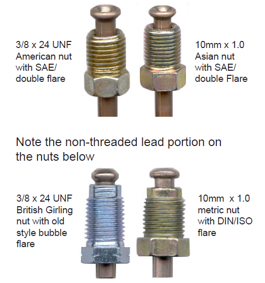

    If you’re trying to make bubble flares and make them work for your master cylinder then it’s no wonder they leak.
    There’s a big difference between 45 degree double flares (which I believe you need) and bubble flares.

    Take the B and transpose a D....double flare is what I guess I mean! NOT the plain old household water-pipe flare but a Double flare for the MC.

    Tube nuts need to be the correct ones for your flare
