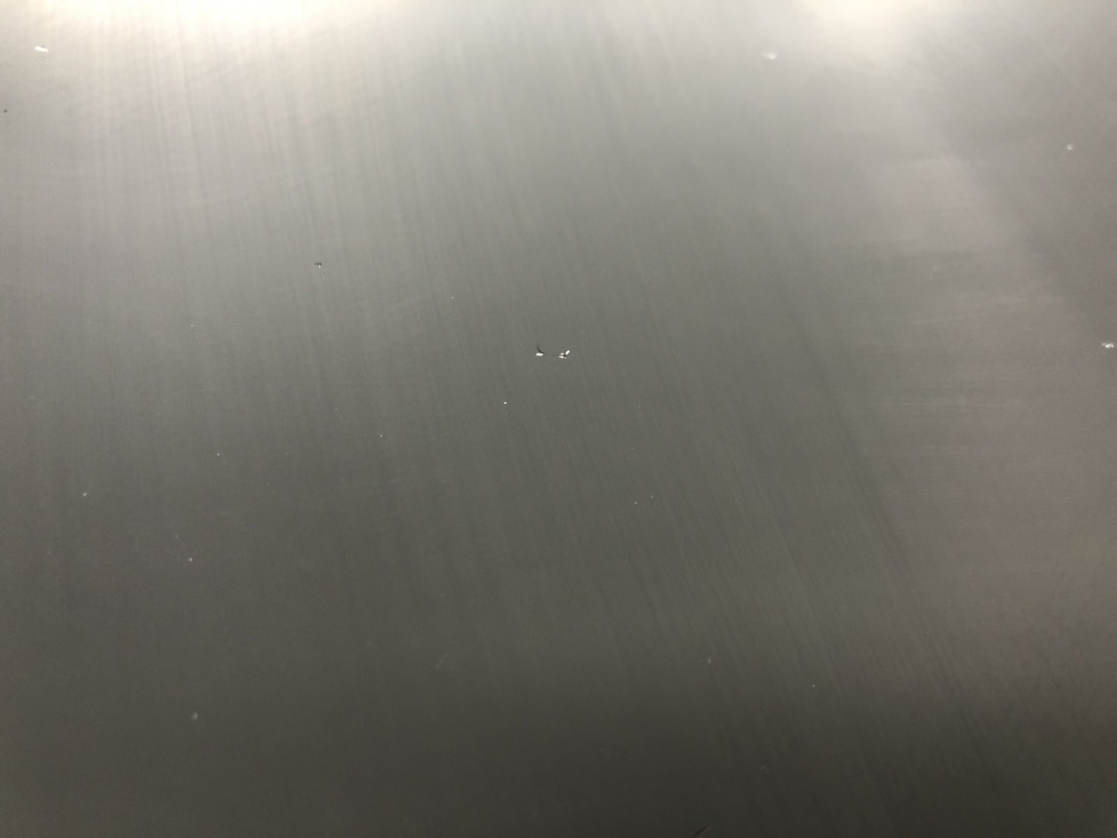

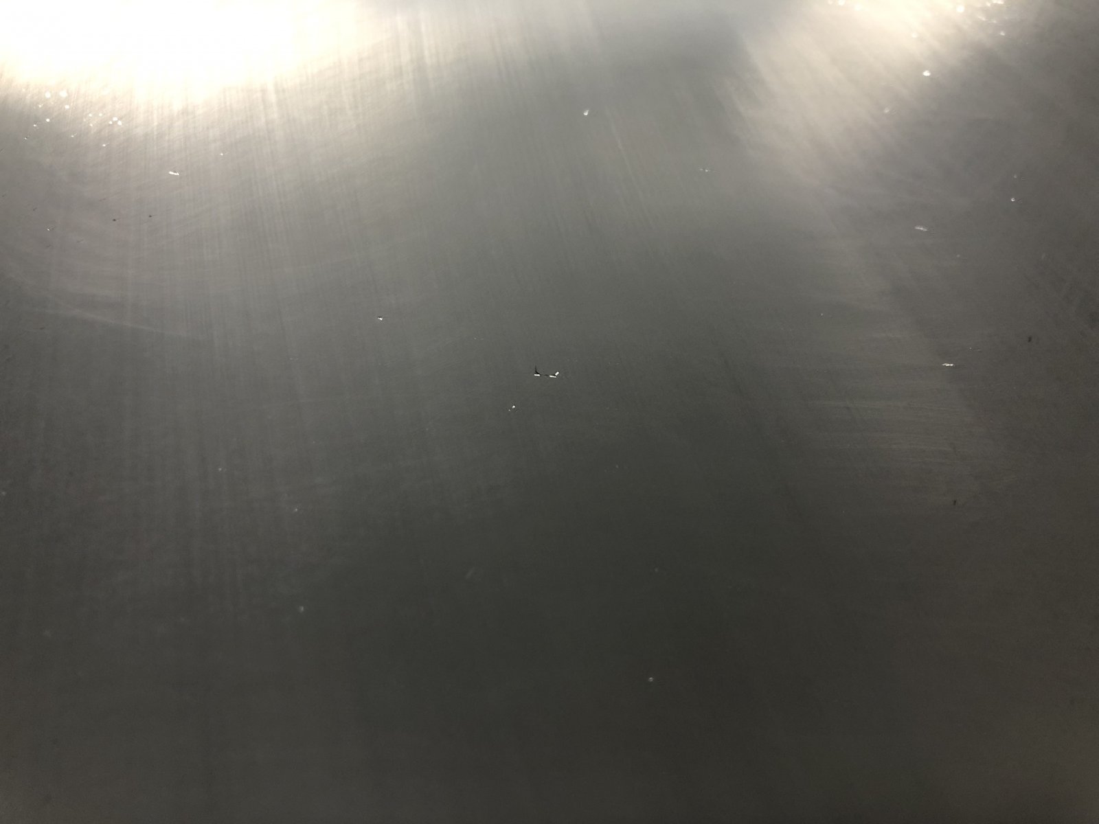

    This might be a new question, but how would you suggest I fix this? I should have sanded down to metal, but thought I had gotten past all the original lacquer crows feet, but apparently not. I saw this after my first 2 coats, so I stopped and sanded these places flat with 600... (or so I thought). They continue to be pronounced after my 3rd coat. Should I sand down again? Or skim these spots over with glaze, primer and keep going?

    Ya got to strip it, or it'll come back. Do it right or don't do it.
    SS327 and Thejumpsuitman like this.
  12. KenC
    Joined: Sep 14, 2006
    Posts: 1,150
    KenC
    If you have some epoxy primer, you could try sealing over that area, letting it cure will and try that. Otherwise, bare metal is the only cure, IMO.

    da34guy
    Catalyzed epoxy will lift the old lacquer sooner or later.

    KenC
    IME if it not applied really wet, allow plenty of flash time between coats and it doesn’t lift immediately it’ll be fine. Once the reducer is gone an it’s hard the risk is gone.
