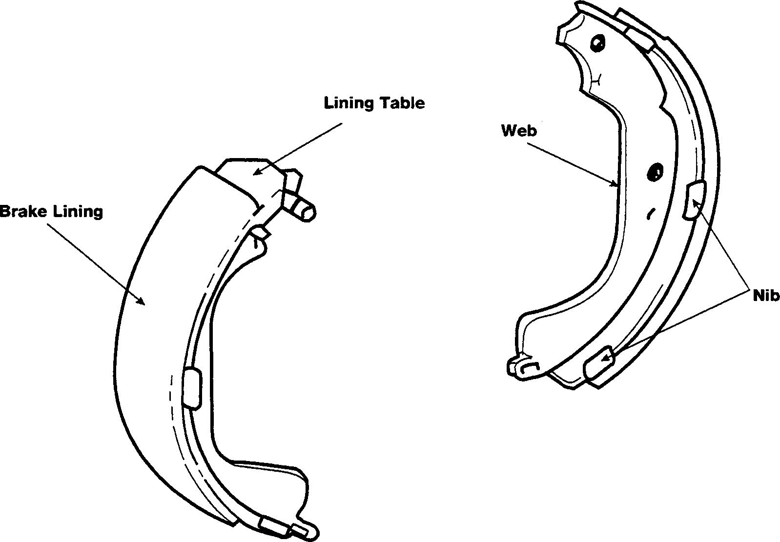

  29. MOONRNR
    Joined: Dec 30, 2023
    Posts: 212
    MOONRNR
    Let me try it this way. A brake shoe ***embly is made from several components.
    1) WEB
    2) LINING TABLE
    3) BRAKE LINING or PAD
    Yes, they will return to the stop unless there is a mechanical/hydraulic failure.
    As the pads ... er sorry ... brake linings wear, it will require more fluid to move the shoes to fully contact the drum. As you periodically (hopefully) adjust the shoes (or have self-adjusting brakes) the lower shoe will also move closer to the drum.
    So, if you never have to add fluid to compensate for the additional distance movement, where does the required additional fluid amount come from? Help me here, I cannot understand.
