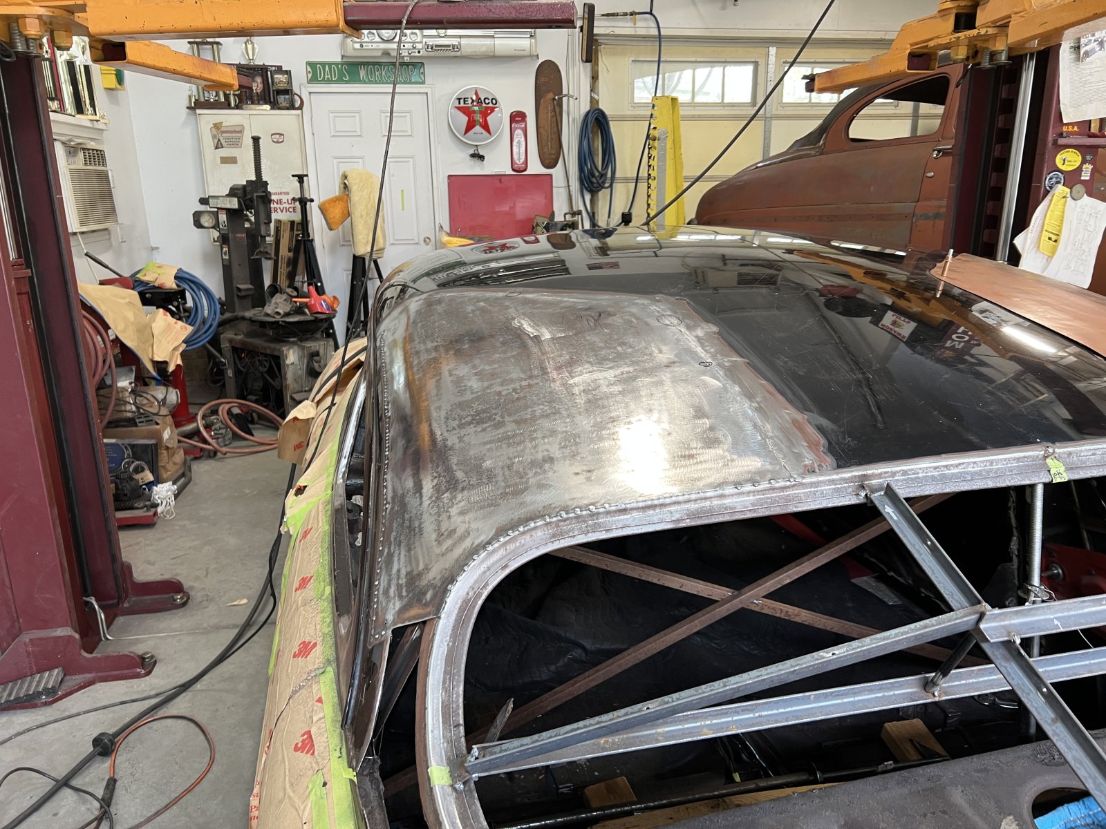

    ebfabman
    545A44B6-19A2-4EA6-B8E6-AF93C9C3E6D7.jpeg A little roof work. 1B86281F-CCA0-4A5C-A9CD-D5AF5A92CA20.jpeg

    I have a few questions. It looks like you have some pieces from another roof that you are adding to the corners above the rear window. Is that correct? Or are those fabricated pieces? Also, will you share what amount you chopped the front and rear at?
  10. ebfabman
    Joined: Mar 10, 2009
    Posts: 604
    ebfabman
    Sure. Yes I had a roof from a part out and I didn't want to waste it so I used it on this chop, although the sections could have been easily wheeled out. I cut about 4.5 inches out of the A post and around 5 inches from the C post. The measurements weren't exact. I just cut til I liked the profile and flow of the roofline to deck lid.

    Superb looking chop and excellent workmanship. Thank you for extending the 1/4 windows....makes all the difference. So few people do that and I really like the look with the longer window than shortened up...keeps the c pillar in balance and not so fat.

    Video demonstrated some time invested in the silhouette. As you said, "Just cut 'til I liked it".
    I recall MANY pros commenting on how hard it would have been to get that perfect 'teardrop' profile.
    So they just went with short quarter and 'matched it all up'.
