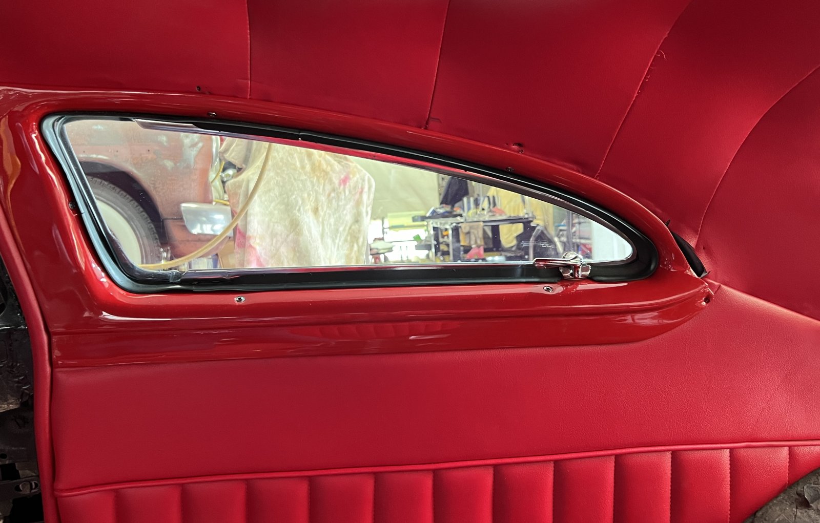

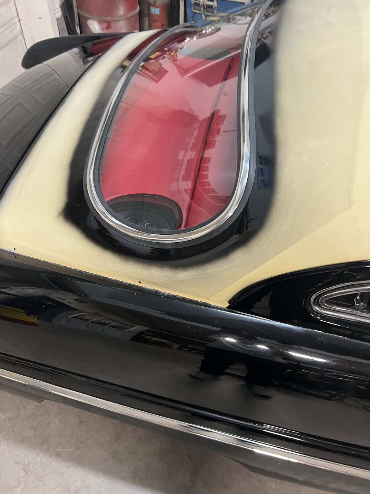

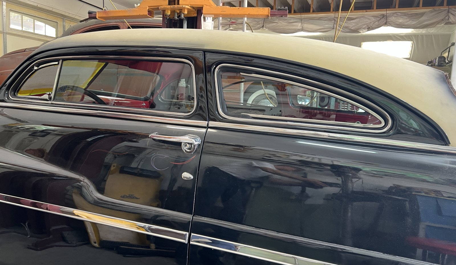

    Well, it’s not all successes and glory. When I added two inches to the quarter window opening, it made the section around it longer. The old headliner wasn’t wide enough to cover the elongated opening. I have a little extra material so I guess I’ll glue in a few patches to cover the bad spots. Oh well, could be worse. IMG_6606.jpeg

    Those flip out rear windows and how cleanly you built those is one of the stories on how nicely done this car is. Others building Mercs should study your vision and execution. Another bad *** Merc getting ready to hit the streets, congrats so far.

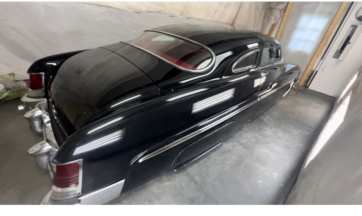

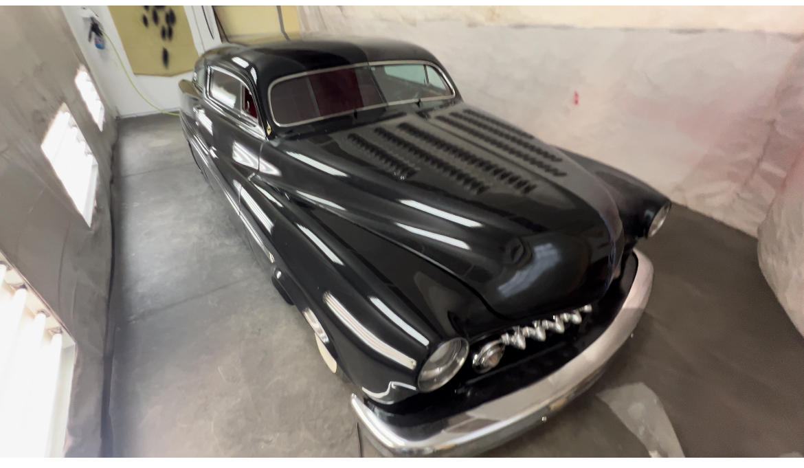

  9. greaser 35

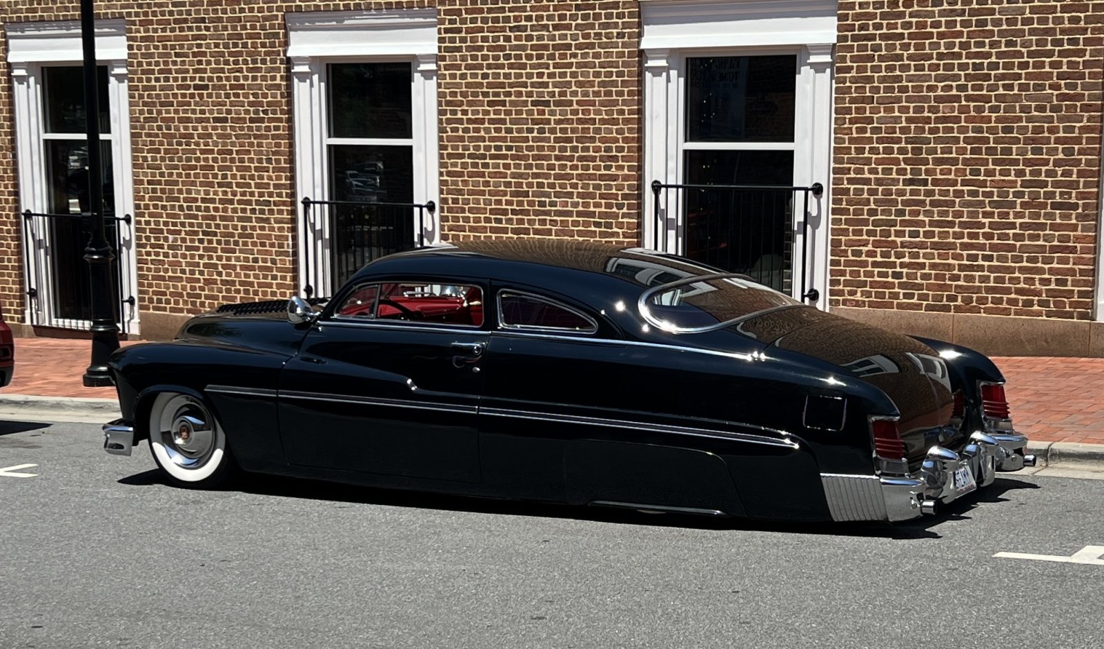

    Install the belt molding spears, spotlights, and sombreros. Close to a wrap. IMG_6696.jpeg

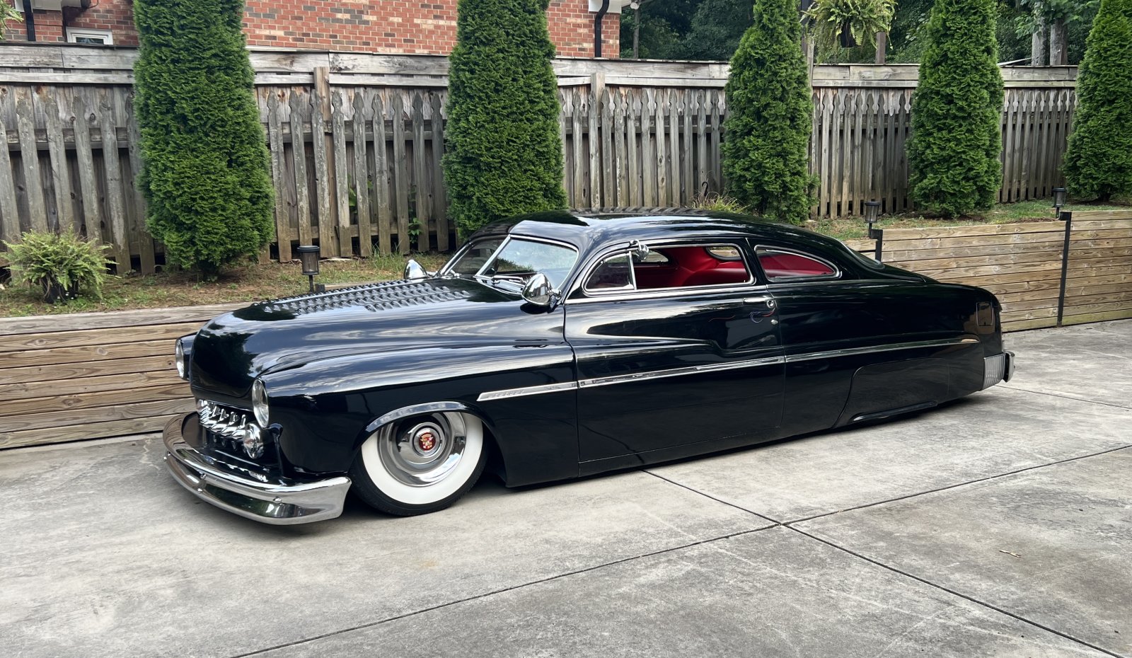

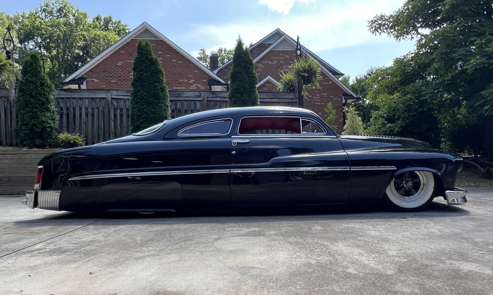

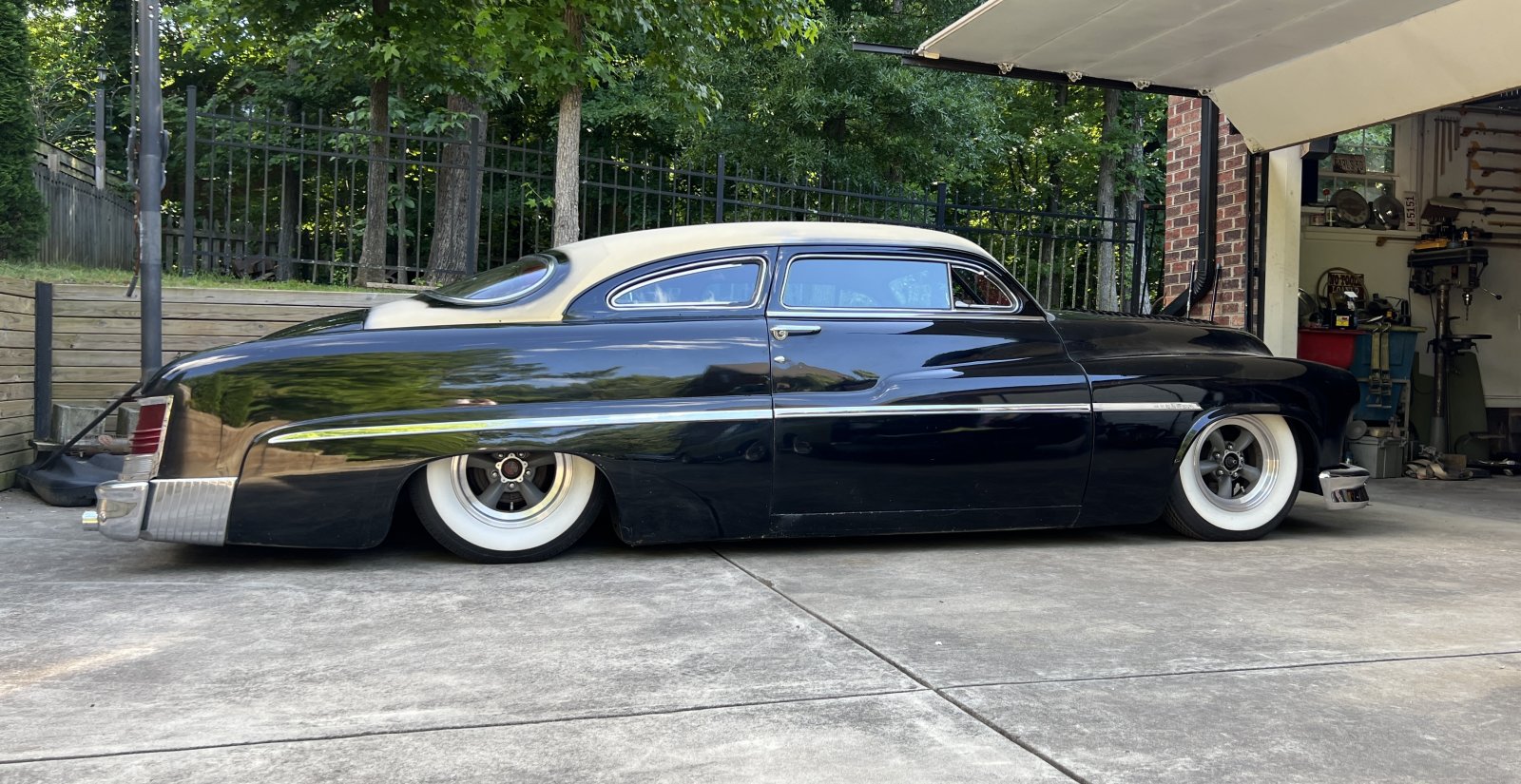

    Well, that’s a wrap for now. Time to enjoy the cruise. Thanks to all who followed along on this chop journey. Long live Custom Cars! IMG_6711.jpeg

  22. James D
    Joined: Feb 8, 2007
    Posts: 4,982
    James D
    That's a thing of beauty right there.
