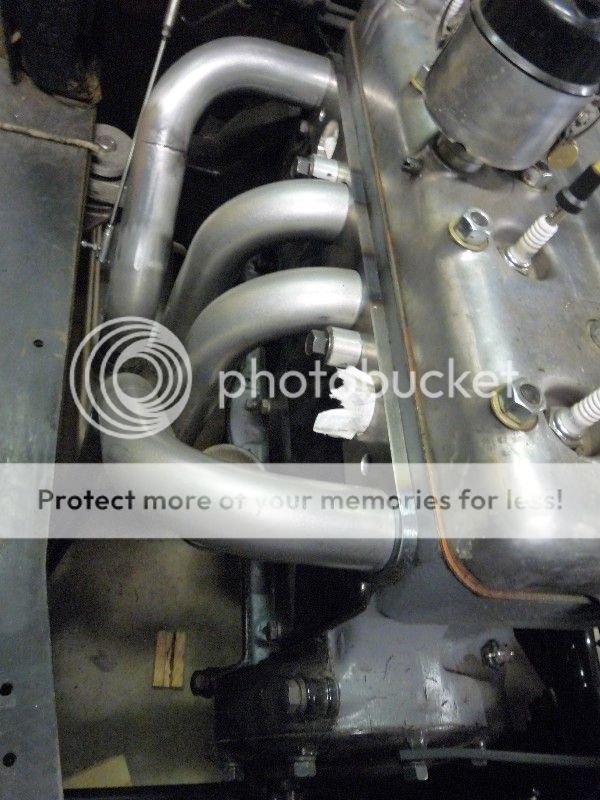

    I want to recognize my friends Eric and Cory for building my new custom dual exhaust header. I could start a new thread for this, but since it all happened while the rest of us were cuttin' the top I figured I'd just tack it on this one. Eric was an instructor at WyoTech and is pretty dang handy with a TIG machine. Between the two of them they were able to build a sweet customer header that has perfect clearance and looks beautiful. Here's the basics on how it went.....
    First was the layout. I had been planning for this for a while and had my friend and fellow club member Andy (owner of Hells Gate Hotrods) mandrel bend me up some 1.75" exhaust tubing per a template I drew. He also cut me an extra thick flange to help prevent warping.
    The firing order of a Ford model B 4 cylinder is 1-2-4-3 so we tied 1 and 4 together and 2 and 3 together. That should give it the right sound but more importantly allow the exhaust to properly scavenge and the engine is running. The mandrel bender was able to make the tubes for 1, 2, and 3 all in single tubes, but 4 had to be done in two piece because the distance between the two top bends was too short for the dies.
    After the header was tack welded up we fit it in the car and realized that the header couldn't be parallel with the engine after the bottom bends because it would cause clearance issues with the motor mounts. After some thought, it was decided that the best way to resolve this was to cut all four tubes above the bottom bend and "clock" them out from the engine a few degrees. This kept the clean look while giving clearance without having to extend the exhaust any further below the car.
    Here's what the header looks like on the engine. No welds will be visible once I'm done with cleanup. There is plenty of room between the motor mounts, body, engine, and header. Its really a work of art.
    After we were done, Andy made a jig off of this header and will be able to make them for sale soon. He does custom exhaust flanges/headers but hadn't done a Ford 4 cylinder before this.
