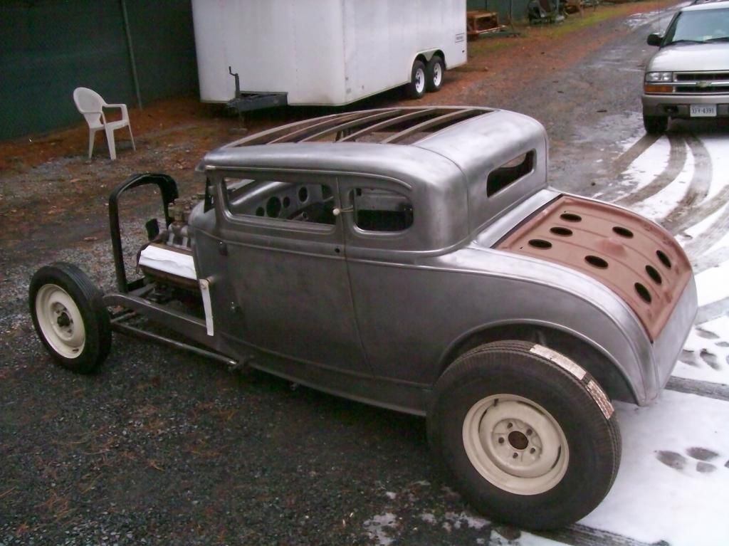

  1. Trying to finish another coupe for the DETROIT dead line... this time a severely metal worked 'a' on deuce rails...Anti sectioned on bottom,sedan doors, chop has been really fine tweaked, note the radius of the rear quarter windows and rear window-
    Body has a lot of trick stuff goin on with it, i will get into more detail later..
    Mill is a desoto baby hemi, 6 94s on an eelco log manifold- camaro 5 spd out back..
    We have been busting *** on it, Will be finished and painted by Autorama..

    The car is sinister looking. Love the chop. Do the floors drop down inside the frame rails for increased head room?

  11. Like i said in the original post, car will be finished and painted for Autorama. There are a lot of differences between this build and Kris's car, if you look hard enough. Thanks.

    What's that chop 5" ? Looks great

    Are you running a 276/291? Are you going to run all 6 94's or just 4? She is looking great keep it up!

  30. chop is 6 inches, with the extra material added to the bottom, it leaves plenty of room in the car without any kind of recessed floor pans. Im 6' 1" and there is plenty of clearance.
    gunswanted- it is a 330 out of a '56. will be running a progressive set up with all 6 carbs, eventually. Ive done the six strombergs straight up and it was worth it but maybe not the time and $$ involved in the long run.
    JJ- Yea, that is the dash from Hershey. It wasnt half bad after being d.a.'ed and sanded down. It takes more than a little bit to fit it in an A but it looks cool.
    The body will be painted a special shade of BLACK for all who were wondering. Thanks for the interest guys, will keep this updated
