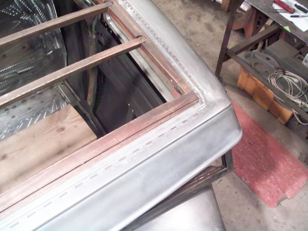

    Drip rail repair..

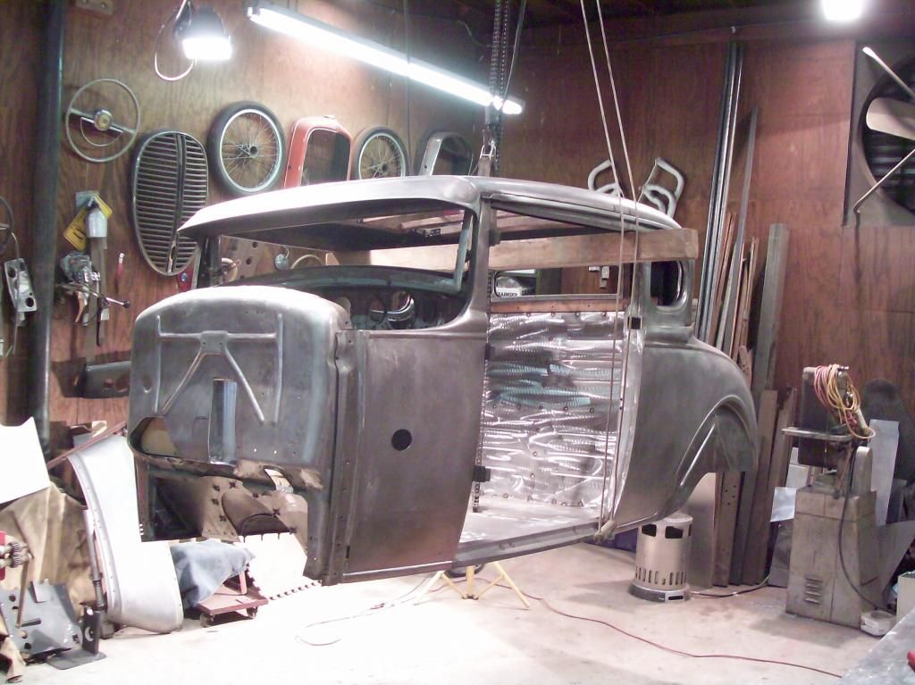

    body pulled off of frame, beginning to do all the under carriage welding and sheet metal finishing..
    Body is coming to Cincinnati this week to start paint process by Brandon. Cavalcade indoor show is this coming weekend, so I will be busy with vintage race cars and artwork at the show. Coming along quick!

  8. Just to clear some things up, the drip rail picture posted above was to show the extra length that had to be fabricated because of using the longer model a sedan doors..

    Is the roof a bit proud on the left there - or is it just the photo?

    No proud roofs on this build...just a really well thought out and executed hot rod. I only wish I had the skill and patience to build something so nice. If anything there is a proud builder with a car sitting on some non level ground. Seeing this thing is believing. It leaves you wishing and wanting when you see it.

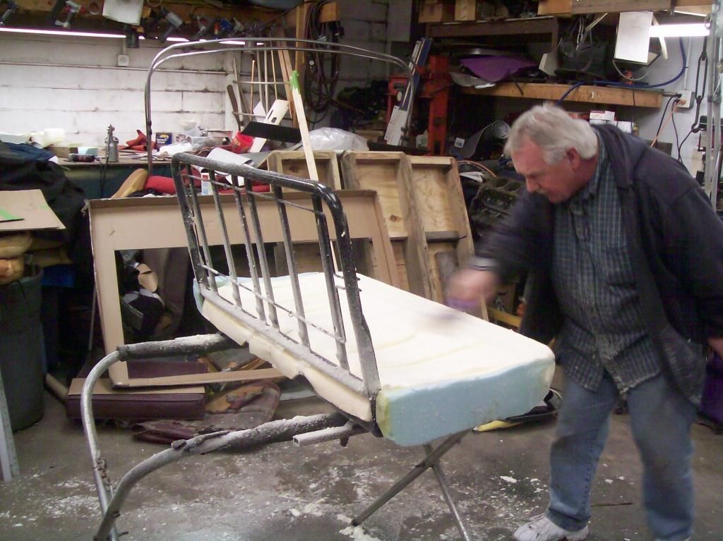

    Left off last week, i am back in Cincinnati, my old man is in Virginia finishing up the ch***is. Last weekend was CAVALCADE indoor show here in cincy, so i was busy striping for the charity auction, watching over the race car i had in the survivors alley portion, and generally having a good time. The old man showed up thursday from VA for the weekend, with the finished body on the trailer for our painter Brandon to get started on. On the way to Brandon's, they stopped off with the body and seat frame at The Canvas Shop where our upholsterer Ray Ray (the rainman) to fit the seat frame to the body width and start carving some foam.
    Heres Ray at his shop in Beechmont doing some carving..

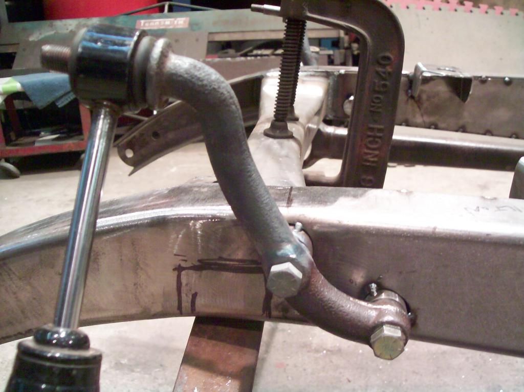

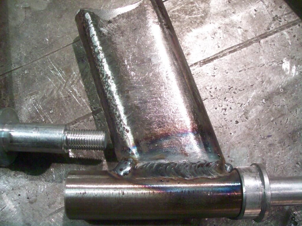

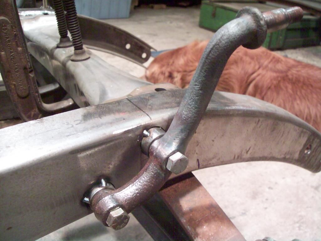

    Here are some ford truck shock mounts, with some sleeves he turned down to be welded within the frame rail.
    tacked in the rails,,
    Another after being heated and bent shot
    Some shots of the rear shock mounts, with the ford wishbone style mount

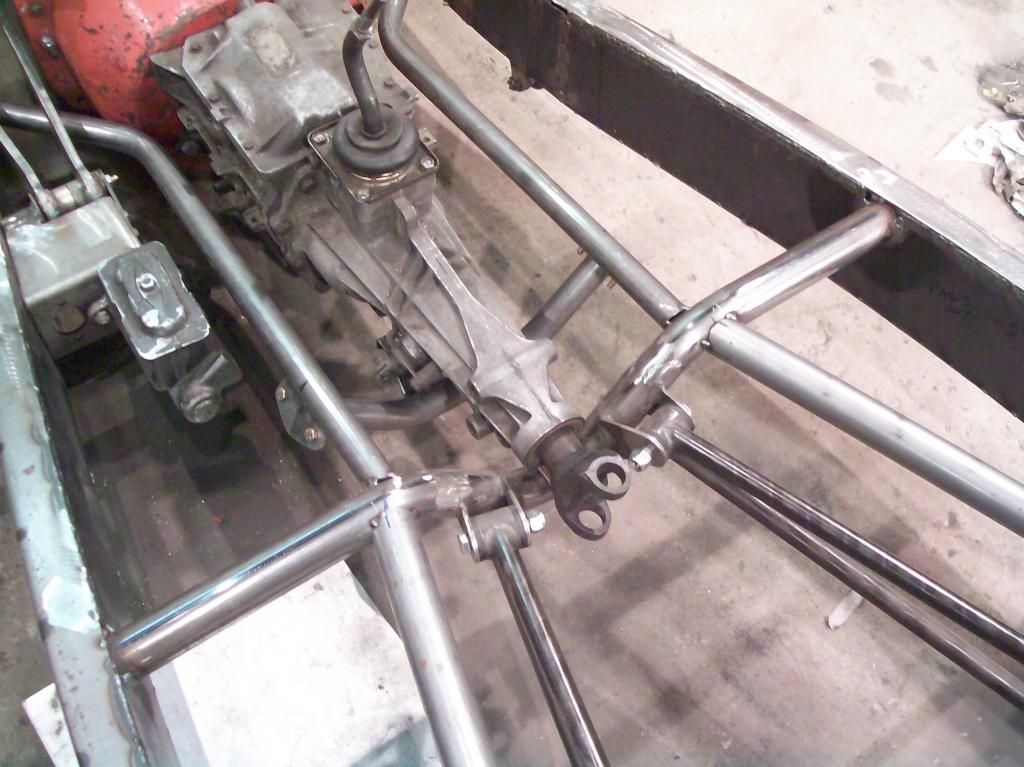

    And the center tubing cross member that was fabricated from scratch..
    tacked together..note the ladder bars ..
