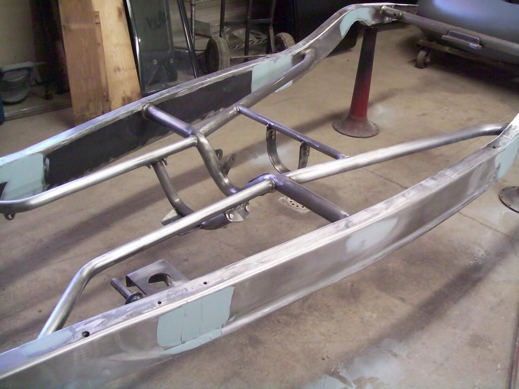

    Posts: 224
    Hogdriver
    from VA
    Nice and simple. I bet it will even steer down the road straight. This thing is gonna stand tall in Detroit. Love the wishbone shock mounts. Wish I had done the same.
  4. TexasSpeed
    Joined: Nov 2, 2009
    Posts: 4,638
    TexasSpeed
    from Texas
    If this means that this will be at the LSRU.. Then I'm stoked I'll be able to see this thing in person! Subscribed.
  5. GOATROPER02
    Joined: Mar 22, 2006
    Posts: 2,059
    GOATROPER02
    from OHIO
    Couple more cars and you guys might just get it right:D....Bad*** man!!!!
    Tony

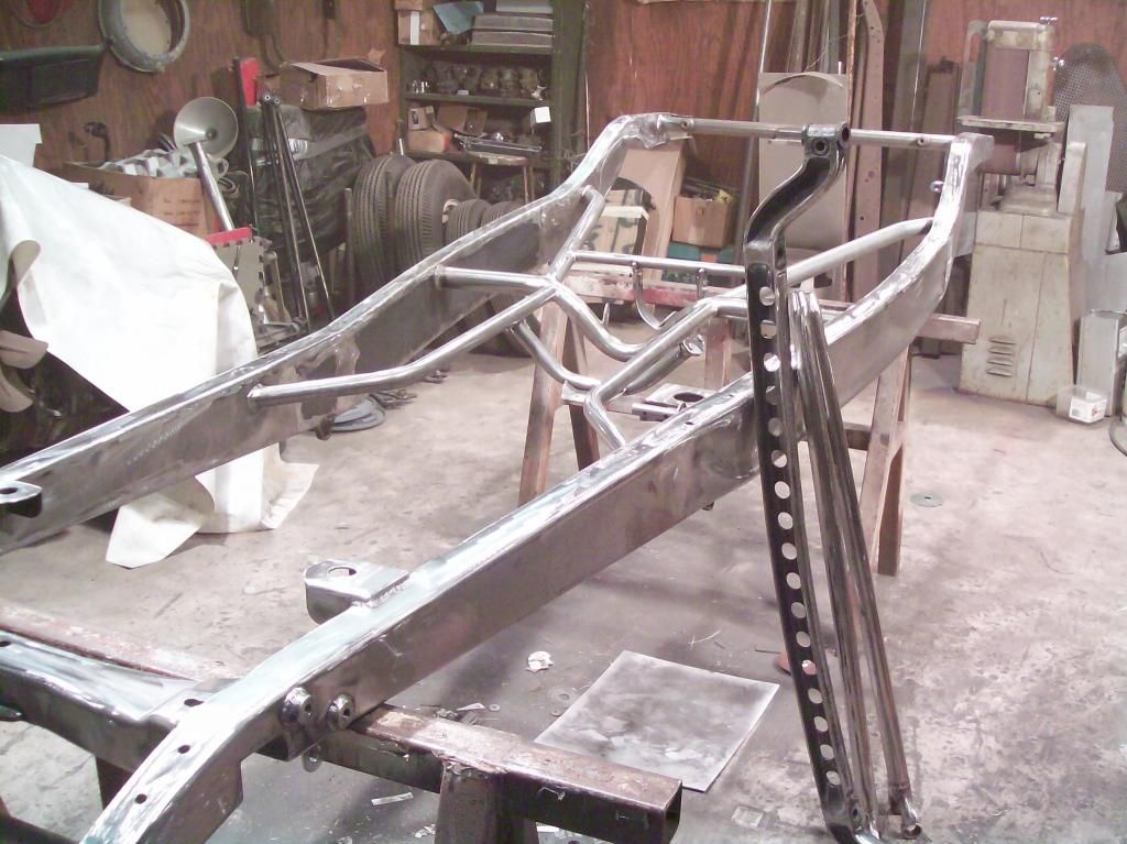

  6. Thanks dudes and bros... to answer HERETIK above, we use round spun moon style fuel tanks, mounted tight up against the bulkhead in the trunk section. The stock A fuel tank has been all whacked out to accomodate the cowl steering box, and over all foot room.

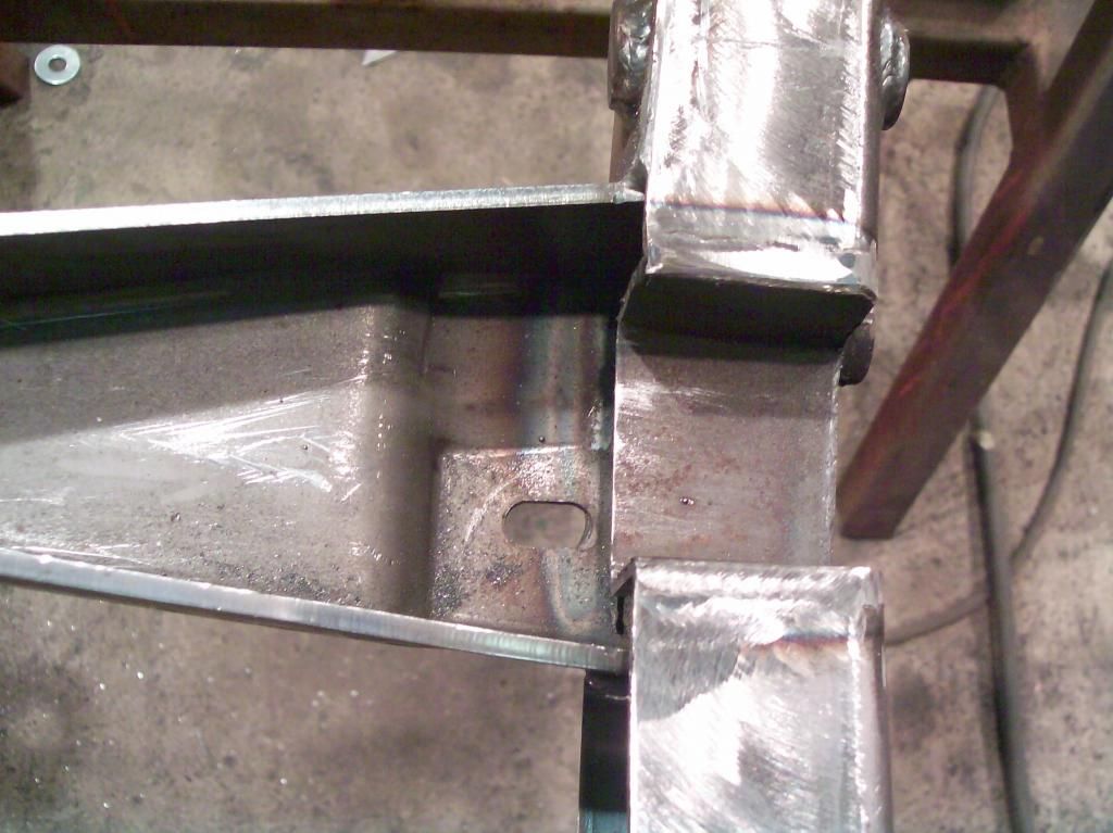

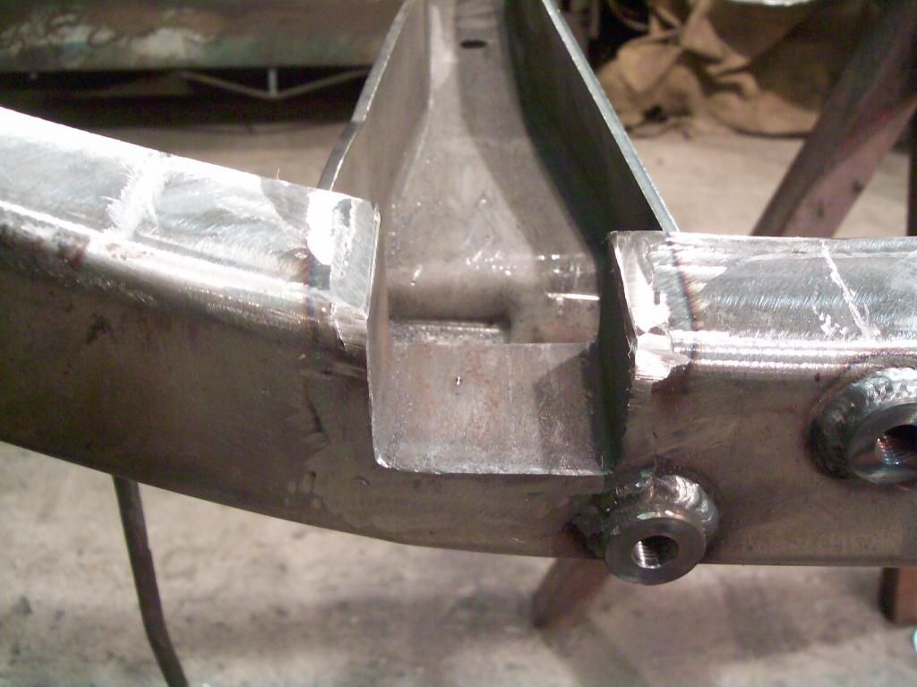

    HERE ARE SOME PROCESS SHOTS OF A FRONT CROSSMEMBER C NOTCH PROCEDURE.
    ROUGH WELDED IN..
    FINISHED GROUND AND MOLDED
    TH
  7. 30TudorSedan
    Joined: Sep 20, 2007
    Posts: 382
    30TudorSedan
    Subscribed! Looking forward to more updates, one great looking coupe!
  8. Working out the custom mix for the paint color today and last night,,,, will be a nice OLD looking shade...of BLACK!
    TH
  9. brandon
    Joined: Jul 19, 2002
    Posts: 6,398
    brandon
    i was smilin' because the decklid won't end up weighin 100 pounds....:D lovin the cool optional model a hemi window....:eek:
  10. Think ****era funny car tin work windows circa 1975!Lets you see if the headers are on fire and the front tires are burned off! Solid Baby!
    TH
  11. PRIMER STUDIO
    Joined: Nov 13, 2006
    Posts: 1,246
    PRIMER STUDIO
    from Butte,MT
    Nice build! Gotta love a hammered 30/31 coupe!

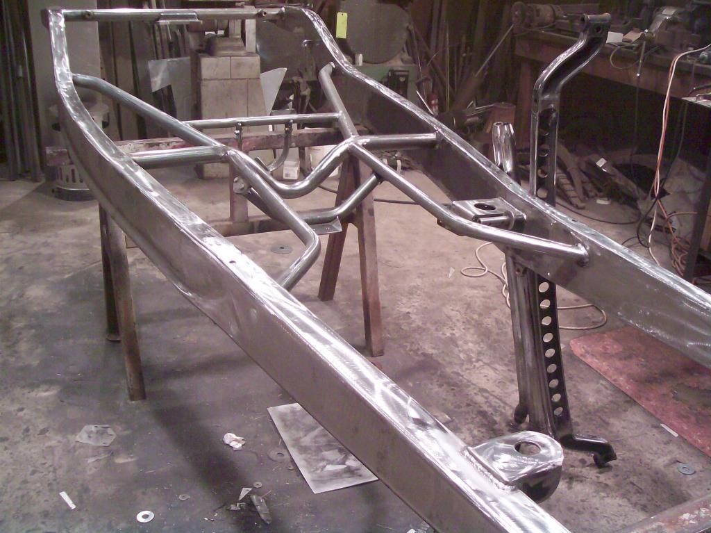

  12. Helmet down, tungsten glowin..
    TH
  13. thanks for your explainations :cool:

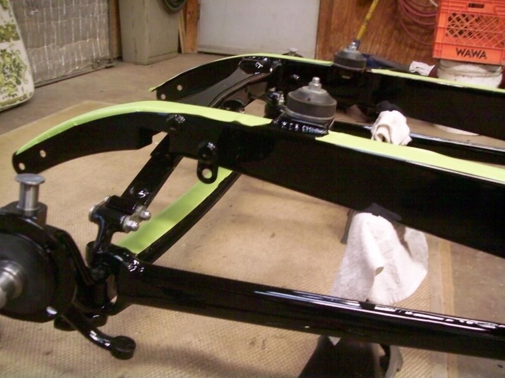

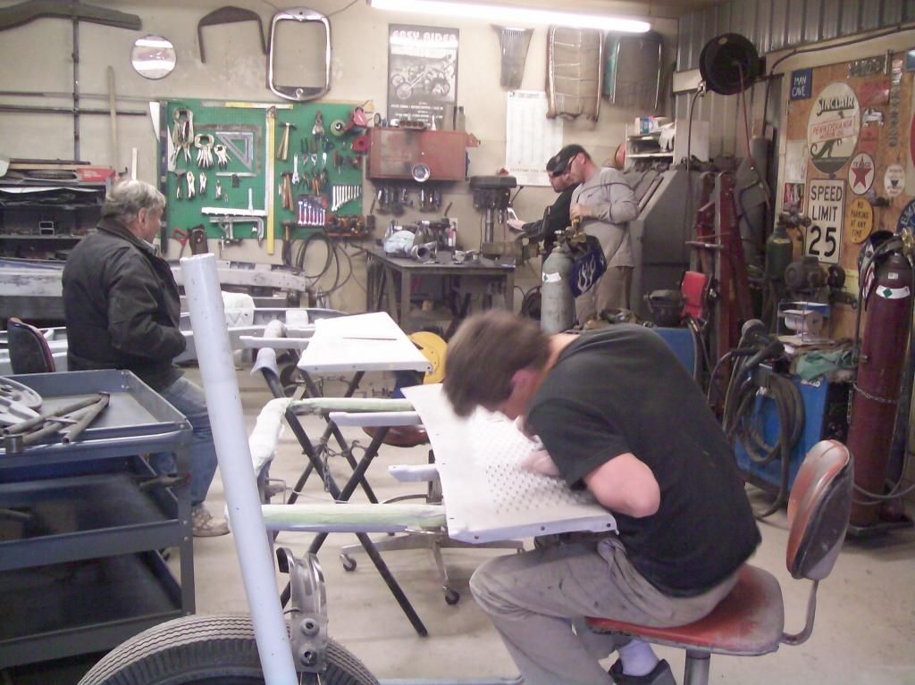

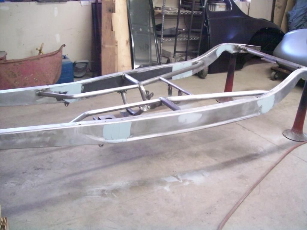

  14. Last week, frame got metal finished completely, and taken up to our good friends Bad Donkee (Jr Kelly) and the dudes up in Pa to body work and paint the frame and ch***is components to match the same hue of black that Brandon is painting the body.
    Junior, Miles, Clark and the dudes helpin to really knock the project out
    Polishin out the i beam..
    Madmen with grinders
    some quick and tidy body working on the rails
    TH

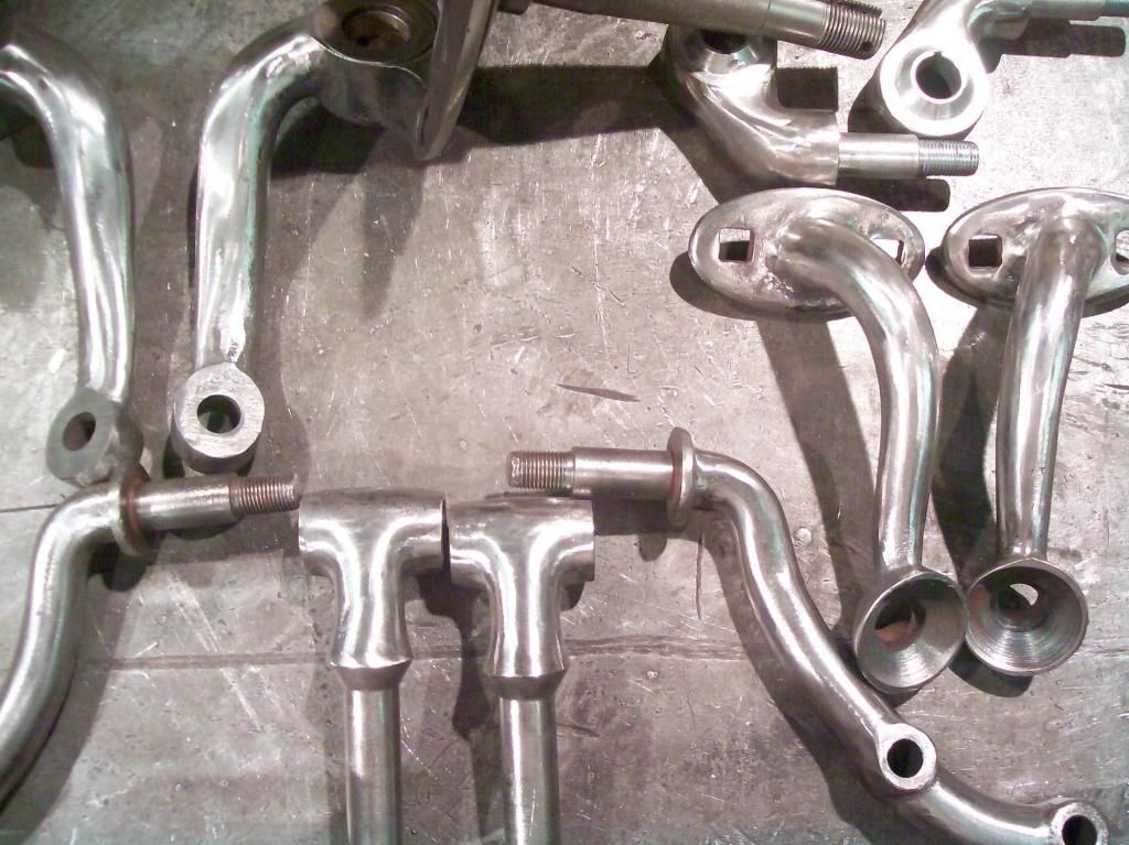

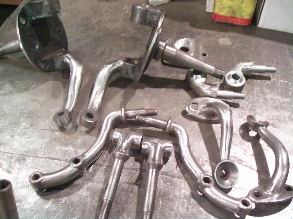

  15. SOME PARTS ****...
    This is the kind of **** that gets my rocks off
    TH

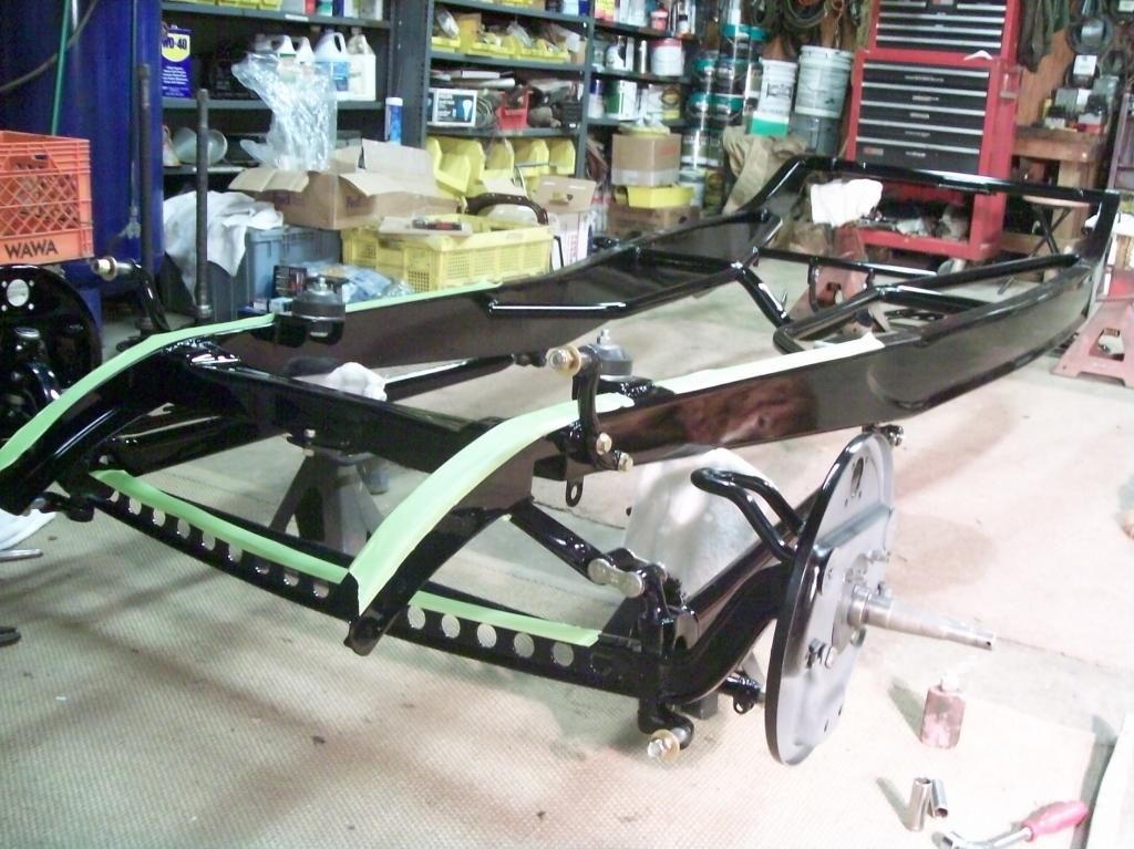

  16. Heres a quick teaser pic... of the ch***is... Miles squirted the rails.. did a great job. I know from experience that painting rails of any kind (dragsters) is NOT an easy task..
    TH

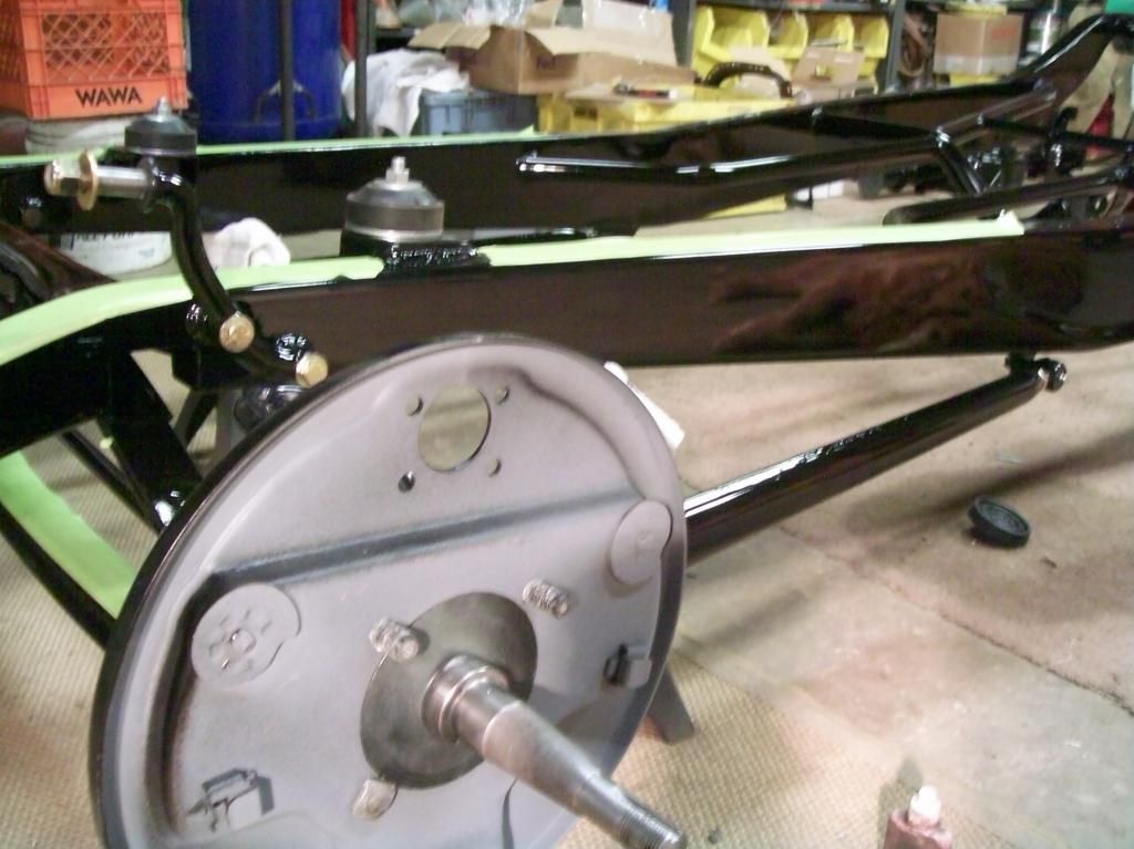

  17. CH***IS FINAL ***EMBLY...
    TH
  18. more
    buick drums always look good
    TH
