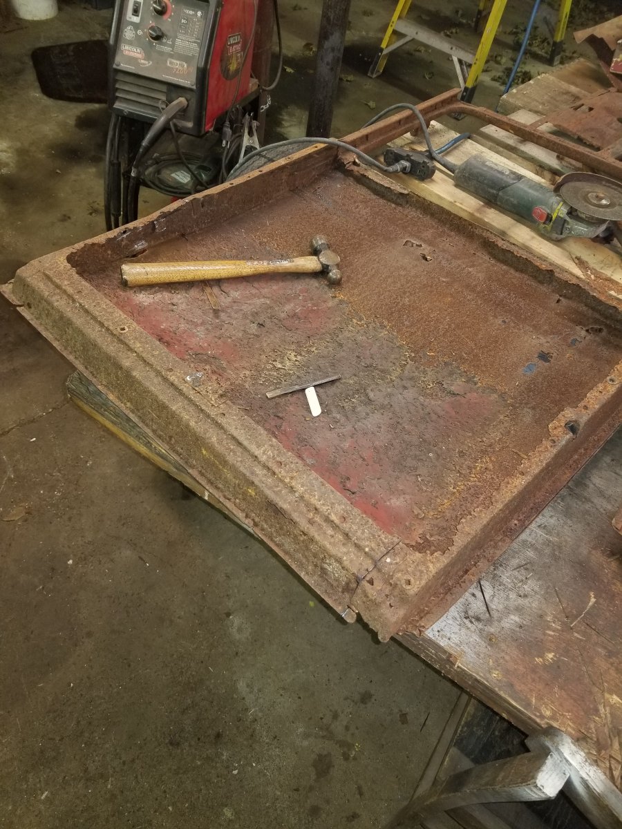

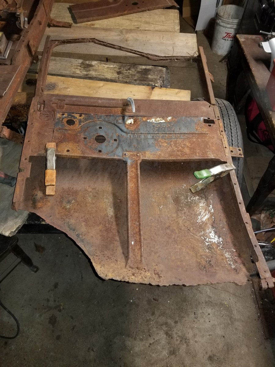

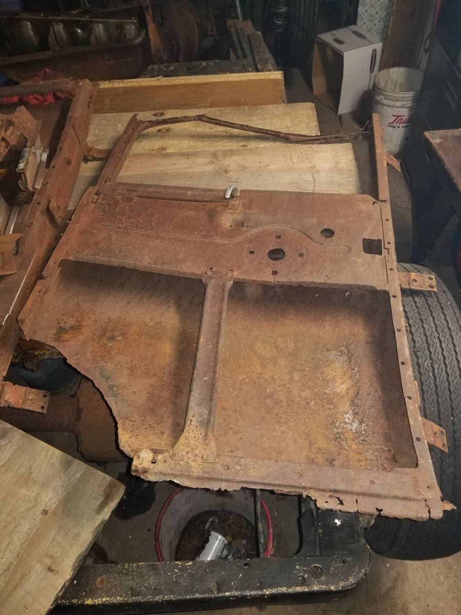

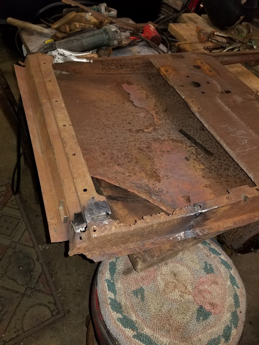

    This is a door that Sloppy pulled off of a doodle bug that was sitting deep in the woods of Maine
    I gathered up all my scraps let's see if I can make something. The inner panel was very thin and buckled so I cut out the bad and fit in a passenger side piece. 20191129_154556.jpg . . .

    I dug out a sedan door that had intact inner structures and most of the bottom so I spliced some from it 20191130_165401.jpg 20191130_175436.jpg into the coupe door. The sedan door has a decent top on it too so I will be grafting that at a later time

    Had a couple hours in the hideout today
    I cut out a crispy but better than none inner door piece from the donor sedan door.
    Measured a few times, cut, fit, cut again,

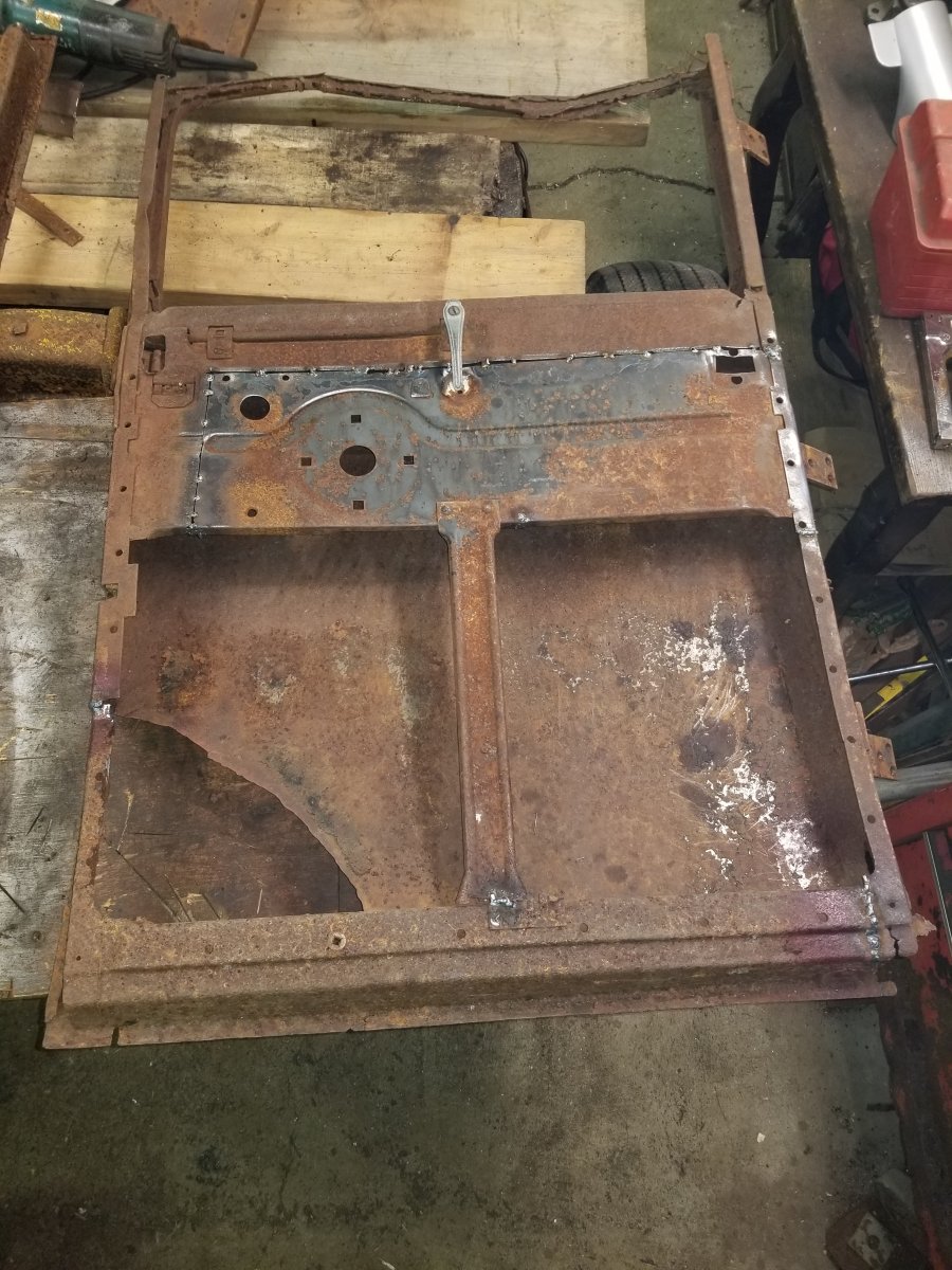

    Then welded it up. 20200202_141144.jpg 20200202_141325.jpg 20200202_154058.jpg

    I scored a repop pass side inner structure from Mike B. of course. So I fit one side of that, more soon 20200202_212659.jpg 20200202_212721.jpg so now I have to cut out the rust and make new pieces at the corners, yay!

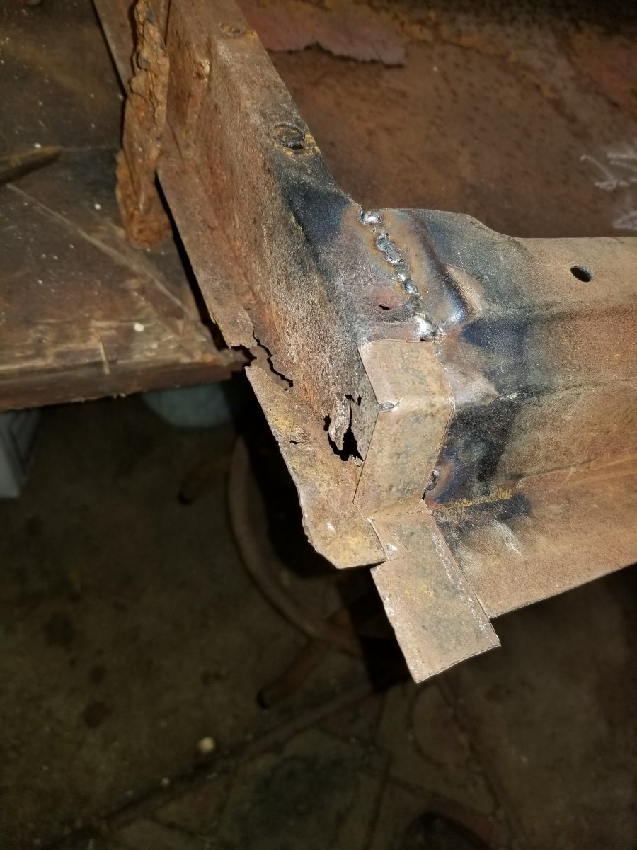

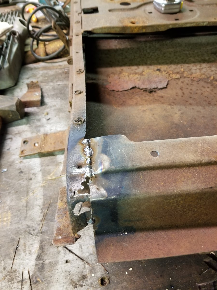

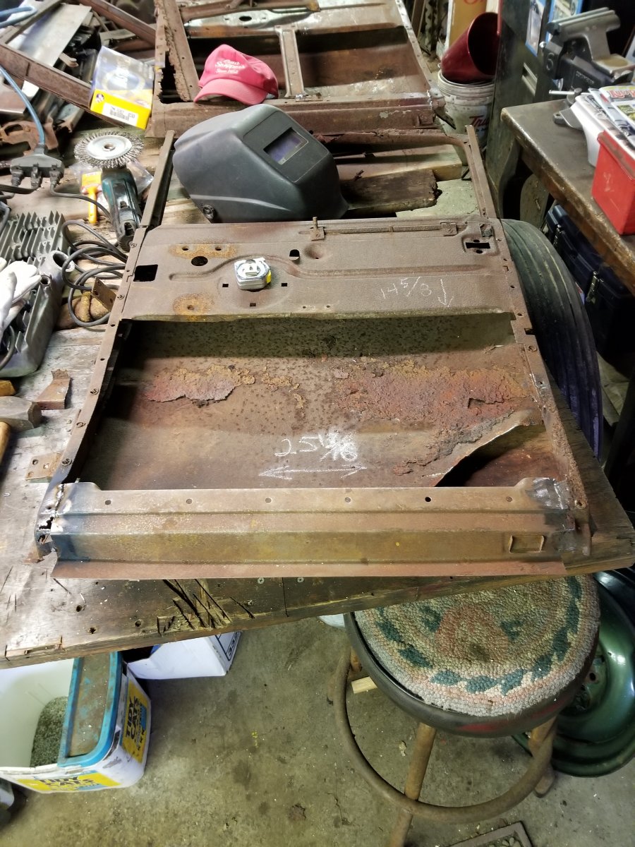

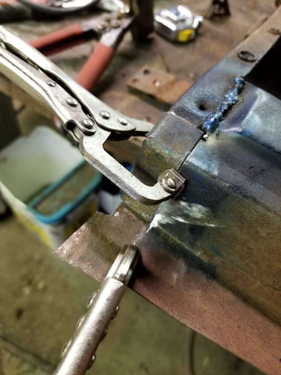

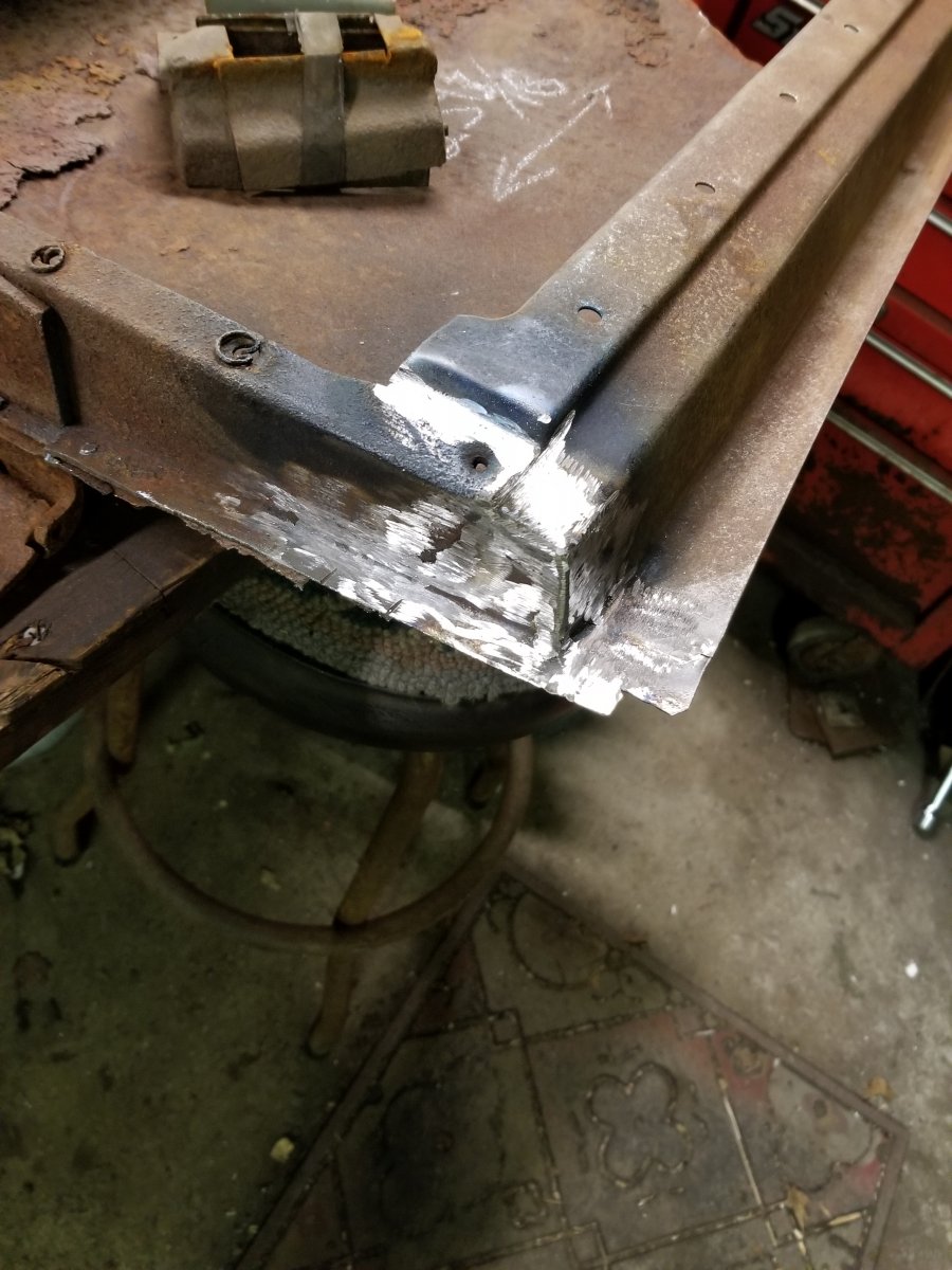

    Got a few hours in the garage today, lit a fire and got some grinding and welding done on the passenger side door. 20200329_145706.jpg 20200329_145656.jpg
    30 bottom corner is killed so I fabbed 20200329_162002.jpg 20200329_163251.jpg up a piece

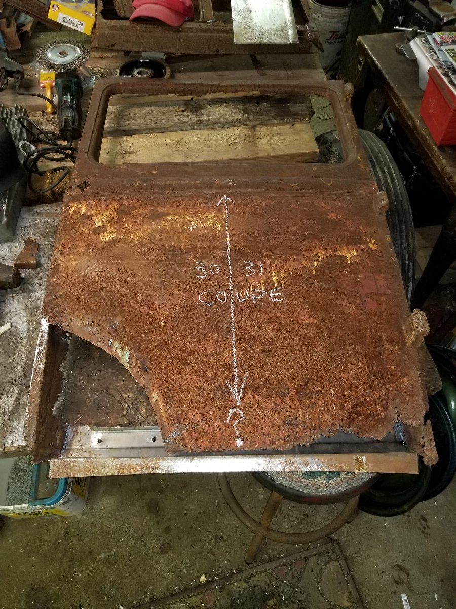

    The side had rot holes in it so I made a piece for that too. Alot of fitment, cut and grind. 20200329_192222.jpg 20200329_192232.jpg 20200329_192244.jpg

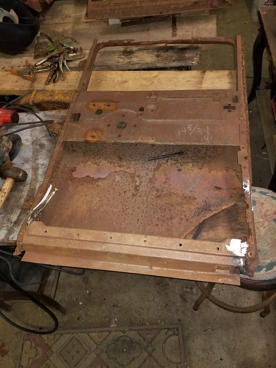

    I posted a thread asking the height of a coupe door and 20 minutes later Continental John hooked me up- Thanks bud. 20200329_151722.jpg

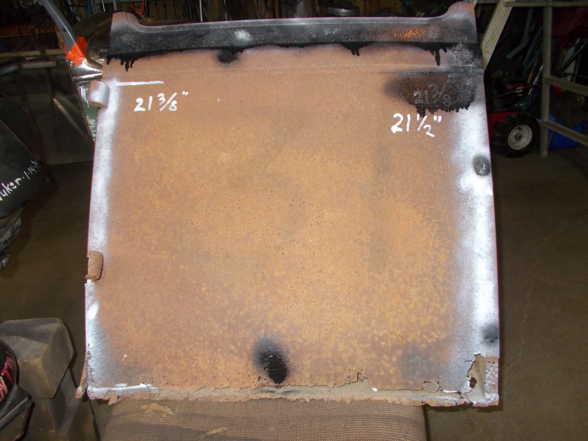

    Hold the phone,
    memory says a '30 coupe door is slightly taller [at the B jam than the A jam] .
    measure between bottom of the beltline and the top of the lower bead...
    I will post the A jam and B jam measurements Monday, raining now...
    well this ain't the wizard of oz... I won't melt...
    measured a door that still had a slight bead crease at the bottom...
    painted over measurement was with bead curled up... didn't let the tape drop all the way down,
    bent the ragged edge back to normal,
    front was 21 3/8"... the rear was 21 1/2"... cross checked on my sportster quarter... 21 1/2". DSCN5795.JPG
