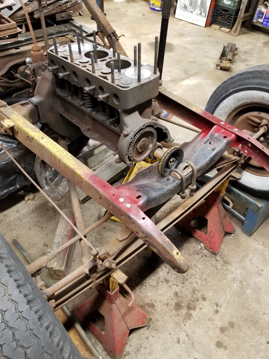

    After a sun porch remodel I am back on the coupe project. I really want to put the body together and weld stuff but. . . I need to focus on the drivetrain and ch***is first. I need to focus
    That is sometimes a problem.
    Anyway, I got some stuff done last night. Front cross member swapped out and crank pulley installed. 20200811_180424.jpg 20200811_182623.jpg 20200811_182943.jpg 20200811_195119.jpg

    I can relate to that three steps back to make one step forward deal, need a ch***is for my Roadster to fit the body pieces to. Bob

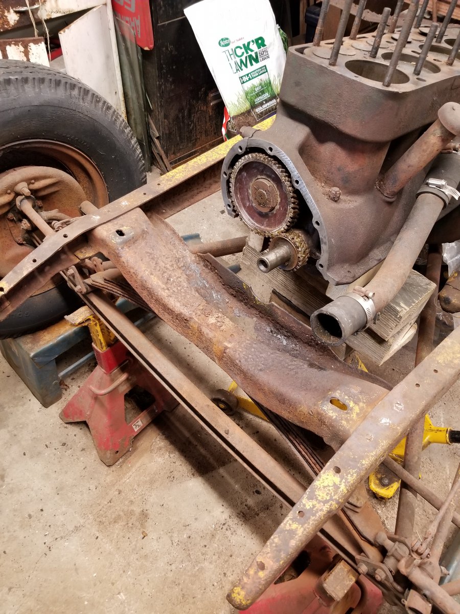

    Got some more done today, errrrmmm, I mean tonight after work.
    Installed timing cover and front motor mount.
    I don't know if mount is installed correctly
    I briefly looked it up but couldn't find anything helpful online so this is what I came up with on the third attempt. I would appreciate a knowledgeable person to direct me if this is wrong, thanking 20200812_195356.jpg 20200812_195350.jpg 20200812_195344.jpg

  12. The37Kid
    Joined: Apr 30, 2004
    Posts: 32,493
    The37Kid
    Are those gears good enough to use, or was the front cover installed just to test things? Bob ?

  13. wheeldog57
    Joined: Dec 6, 2013
    Posts: 3,848
    wheeldog57
    Yes, the gears are fine. I brushed on a little grease so they look messed up in the picture. I got to see them again yesterday because I neglected to install spring and plunger the first time. Was dreading the job but it only took 30 minutes or so.

    I have a question. . .
    Does the oil pump/distributor drive need to be clocked? I pulled it out to inspect and clean and I did not Mark it before I removed it.
    Thanks in advance

  16. The37Kid
    Posts: 32,493
    The37Kid
    You'll correct that when to set up the distributor timing. Bob

  17. wheeldog57
    Joined: Dec 6, 2013
    Posts: 3,848
    wheeldog57
    Ok Bob, so when I put dizzy in I have to line up #1? I would like to install valve cover and NOT have to go back in there.
    Thor1 likes this.
  18. tb33anda3rd
    Joined: Oct 8, 2010
    Posts: 17,583
    tb33anda3rd
    put it together. the cam in the distributor is what gets adjusted. the funky pin sticking out of the timing cover gets removed and re-inserted backwards into the hole. rotate the engine slowly till the pin drops into the digit in the cam gear. that is top dead center #1. loosen screw holding cam and rotate it till rotor pants to number on on the cap. 20200812_195350.jpg

  19. wheeldog57
    Joined: Dec 6, 2013
    Posts: 3,848
    wheeldog57
    @tb33anda3rd thank you sir, sounds simple enough. Now I can put valve cover back on. . . . Progress!

  20. JRN1967
    Joined: Jan 26, 2018
    Posts: 135
    JRN1967
    from Monson MA
    To expand on what tb33 said.
    Loosen cam locking screw on top of cam & turn cam until cam rotor slot is pointing towards distributor body No. 1 cylinder firing position. Next turn cam counter-clockwise until points are fully open; then turn cam clockwise until the points just close. Stabilize cam with cam wrench & tighten cam locking screw. Re-install timing pin.

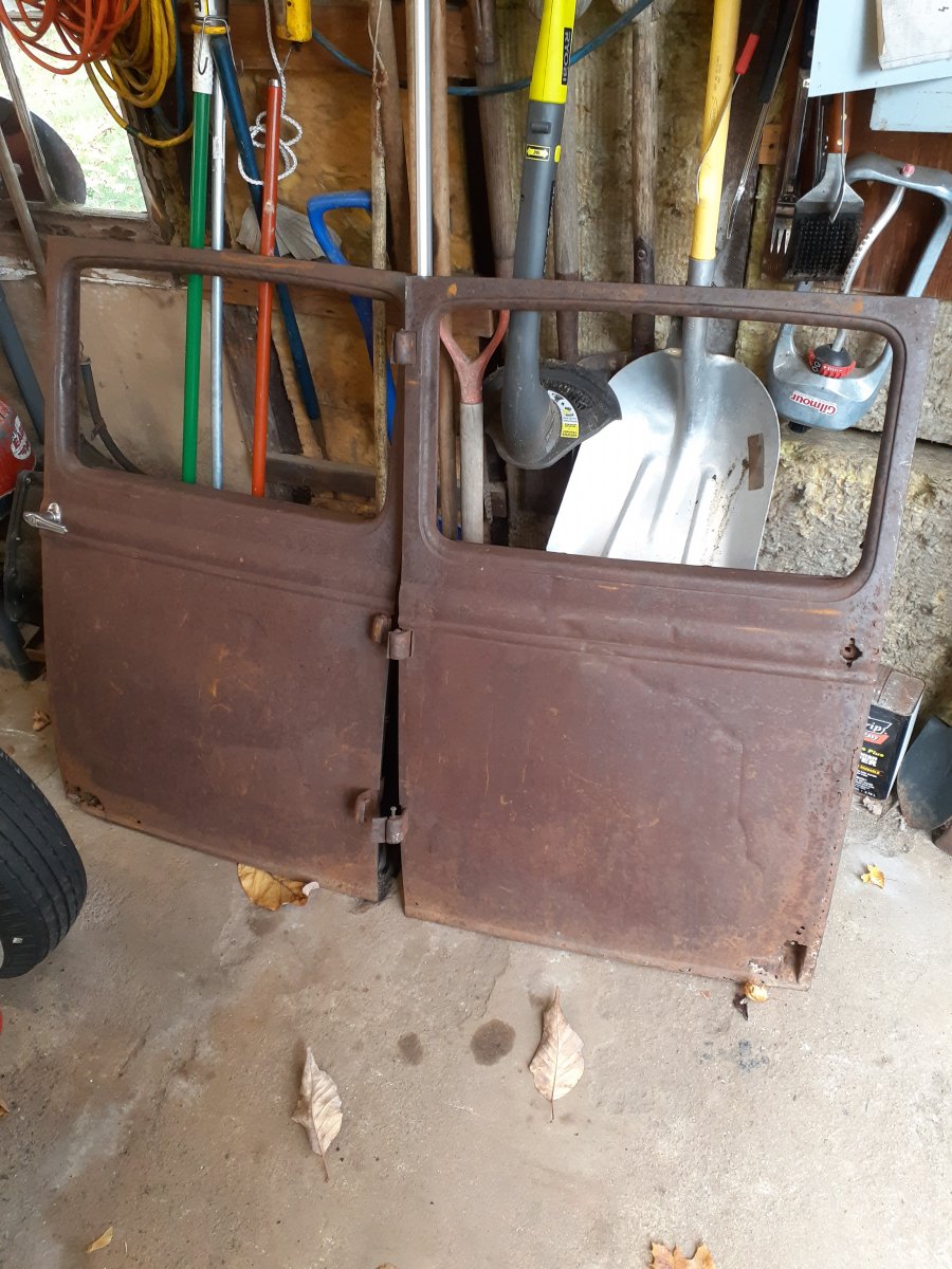

    After 3 years of looking for decent doors, finding
    "most of doors", cutting and welding on said doors. . . . @sloppy jalopies PMd me about these.
    A pair of workable doors, finally! Like everything else on this build, they need work but they are WAY better than the others I have.
  23. The37Kid
    Posts: 32,493
    The37Kid
    Nice New England doors! Those Montana / Nebraska doors are just overrated and would look out of place. :rolleyes:
    Bob

  25. adam401
    Joined: Dec 27, 2007
    Posts: 3,008
    adam401
    If you have early Ford parts in New England that dont need the bottom 6 inches welded back on your way ahead of the game. Good score.
  26. tb33anda3rd
    Joined: Oct 8, 2010
    Posts: 17,583
    tb33anda3rd
    I always say: in New England if the rust hasn't reached the door handle it's "rust free"
  27. Baron
    Joined: Aug 13, 2004
    Posts: 3,672
    Baron
    Compared to the doors you had, these look like "new old stock". :)

  28. 32 hudson
    Joined: Mar 5, 2005
    Posts: 785
    32 hudson
    Nice decent doors. You are a lot further ahead with these.

  29. general gow
    Joined: Feb 5, 2003
    Posts: 6,472
    general gow
    MODERATOR
    i thought the torched out hinge pockets were stock. these must have been modified at some point? ha.
