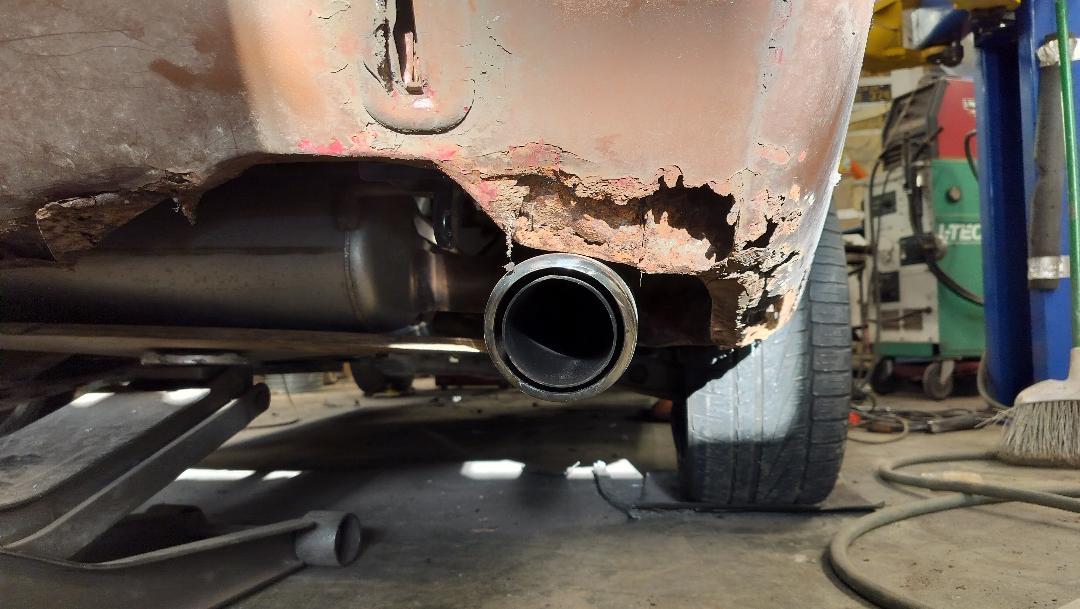

    Tail pipe location using Miata stock exhaust and hangars over to the right a few inches from original location.

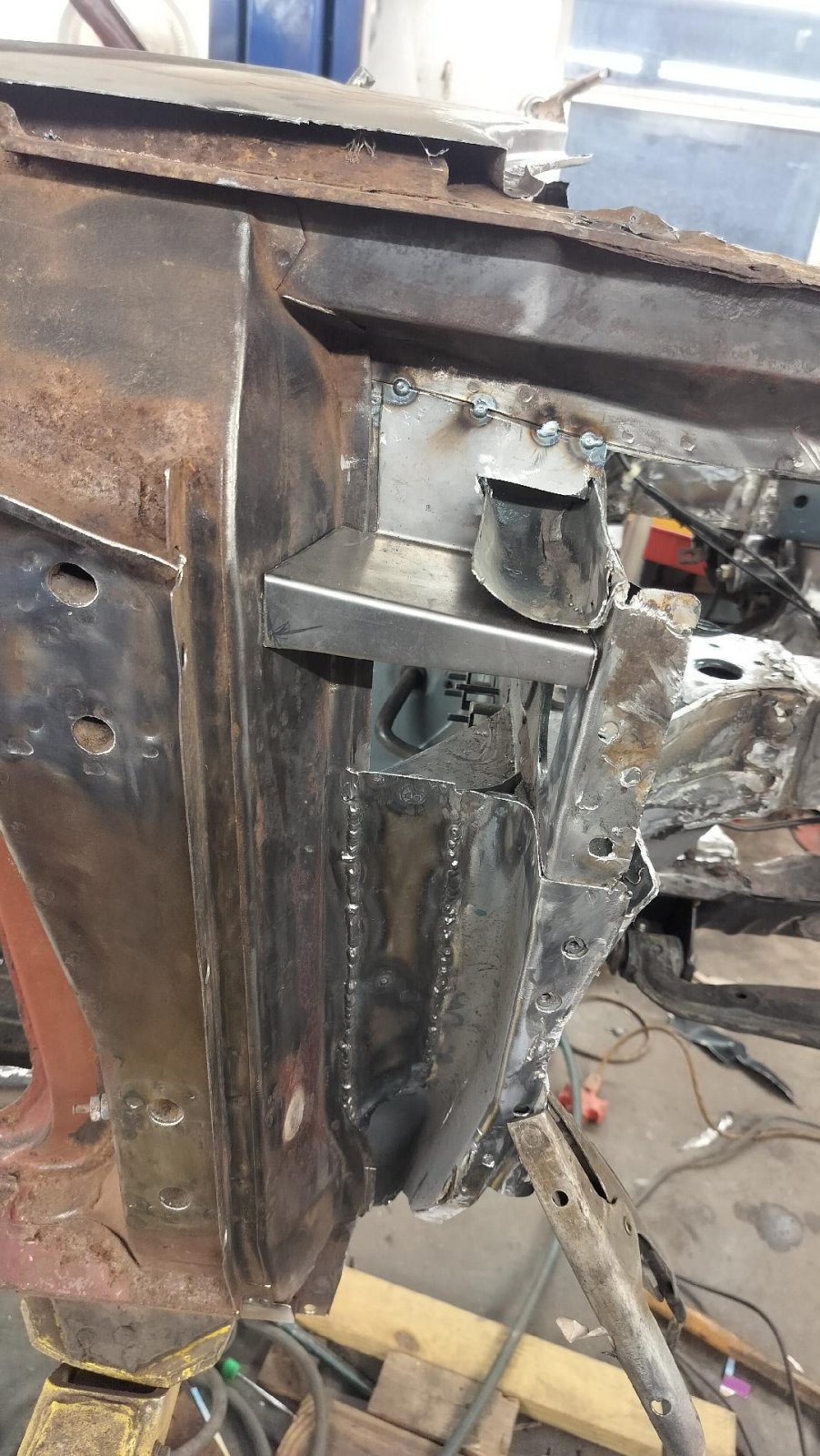

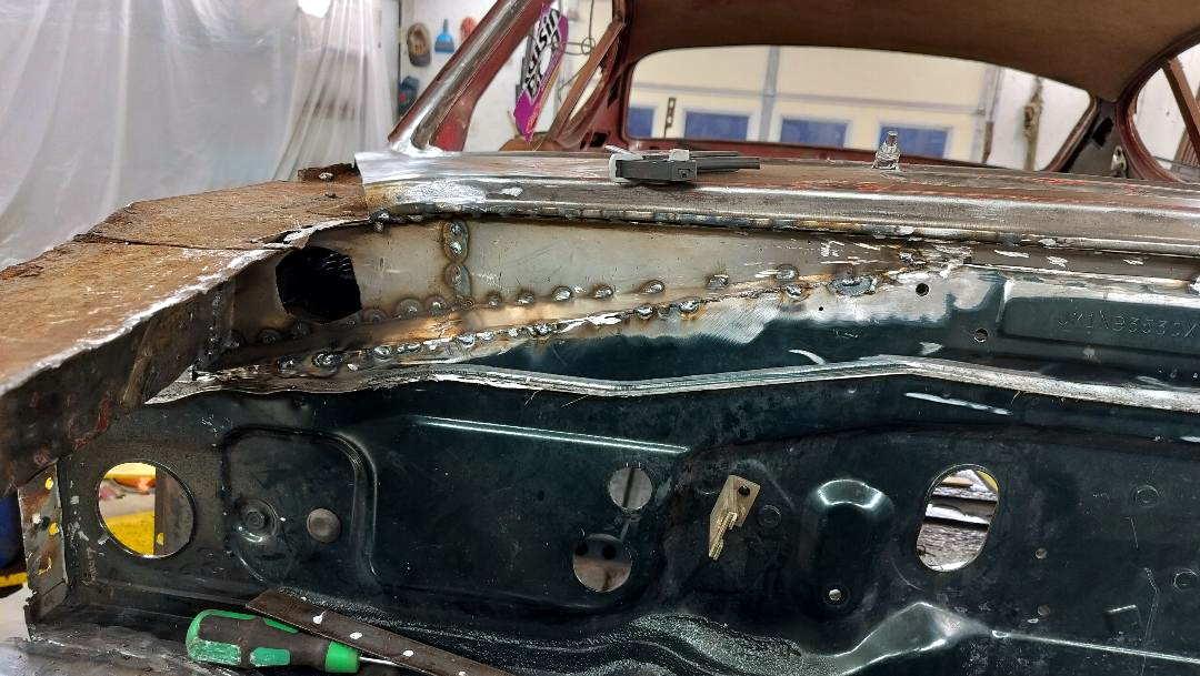

    Upper cowl to A pillar welding right side. 1708296608_a-pillar-welding-b_mmthumb.jpg
    Front clip back on for measurements. 1708296745_front-clip-back-on-for-measuremments_mmthumb.jpg

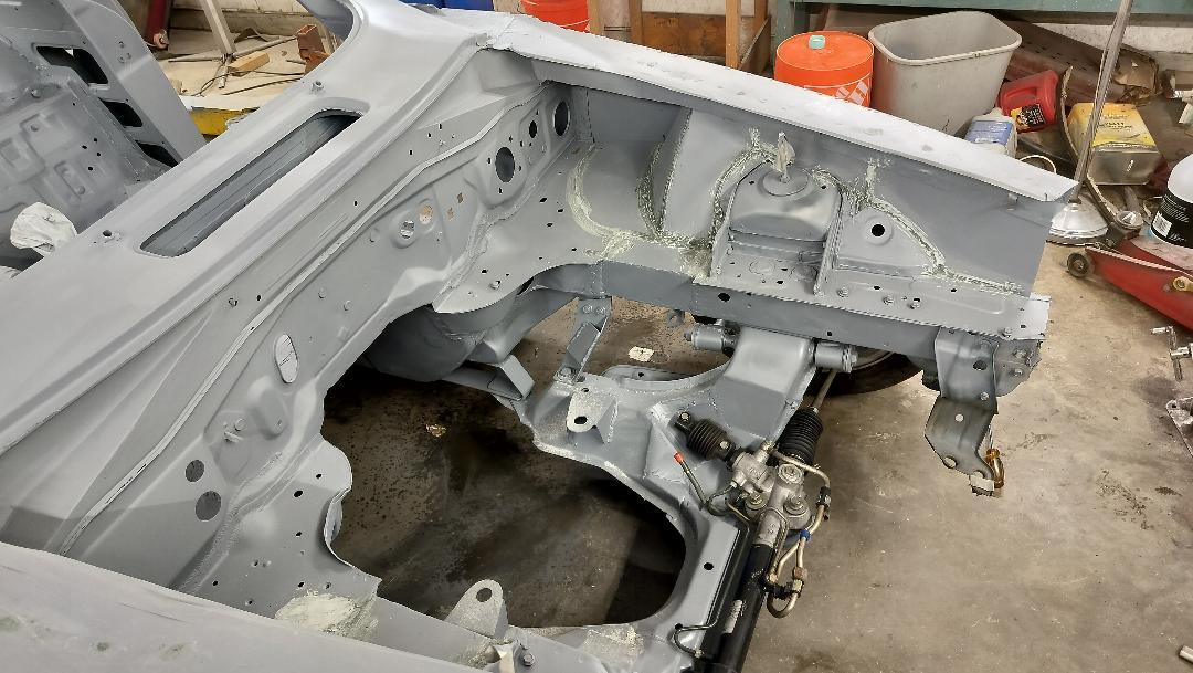

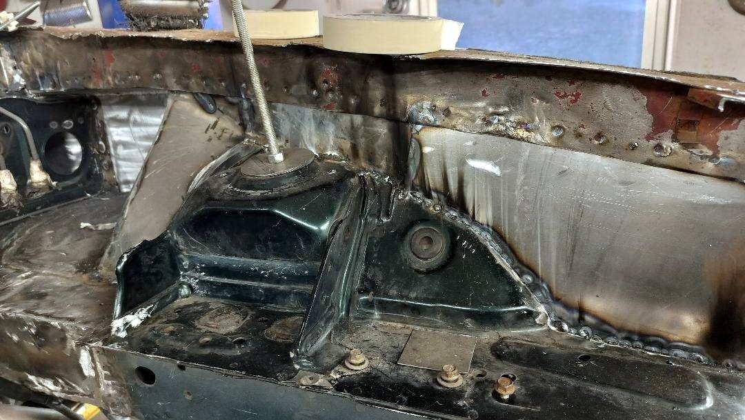

    More progress. Still using 18 ga on most of the inner fenders and firewall.
    I slanted the firewall towards the outside to allow for some sort of hood latch mount. Probably just simple SS hood pin style latches (not much to fail with them). I left a large opening where I will route the wiper transmission cable tube though a removable steel plat with a rubber grommet. This is the wiper kit I am using (I also used this on 46 Packard 15 yrs ago). https://www.specialtypowerwindows.com/power-windshield-wiper-kits
    I did use 16 ga for about 6" above the shock tower. The black smudge marks are where traces of seam sealer caught fire from welding 1708783014_left-inner-fender-engine-side_mmthumb.jpg
    Right side will house the Miata fuse box assembly. I think I will drill a couple of 3/8" drain holes in the recessed area. 1708783166_right-inner-fender-engine-side_mmthumb.jpg
    Cowl drain from Miata. I sized the inner fender to clear 195/65R15 tires at full lock and shock fully collapsed. 1708783327_right-inner-fender-outside-a_mmthumb.jpg I have to replace the top of the inner fender braces where the fenders weld since they are crusty/ rusty and then i can move to the rear of the car to finish the splices.

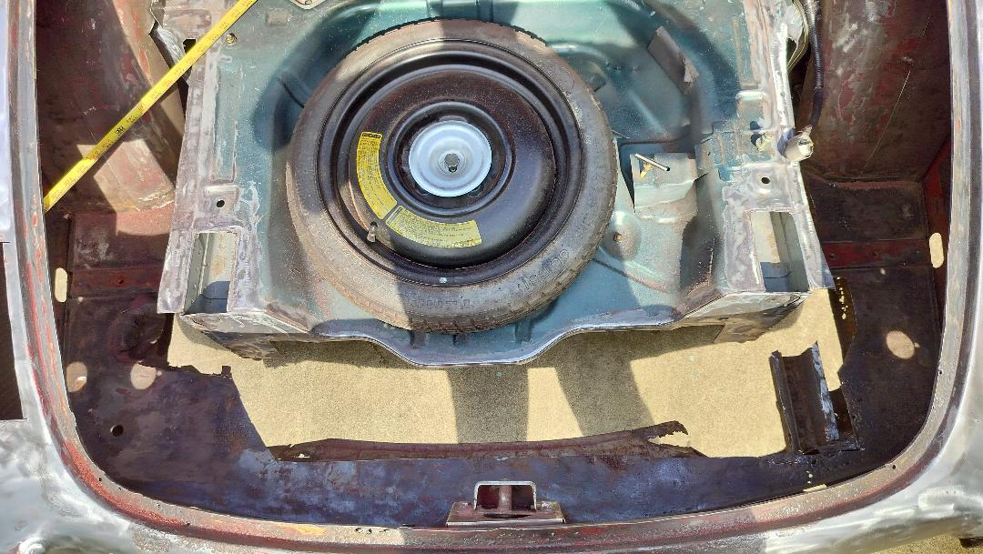

    Miata trunk floor waiting to be spliced to the Volvo.

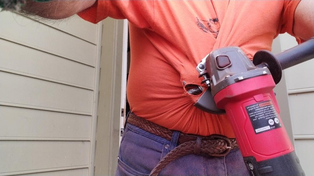

    I did some of the paint stripping in tight places and around the fins with a 4 1/2" wire wheel. This is what happens when your arms get tired and you relax. [​IMG]
    Last time this happened was 45 years ago when I was 30 yrs old running a heavy 7" grinder with a cup style wire wheel - ouch, it still hurts to think about it. 1710509973_wire-wheel-caught-in-shirt-3-14-24-c_mmthumb.jpg
    I lucked out on the injury. 1710510236_wire-wheel-caught-in-shirt-3-14-24-a_mmthumb.jpg

    Getting ready for 2 coats of epoxy primer today - some nice metal under all the ugliness. I don't normally paint on the lift side of the shop but I needed to paint some underneath
    I use https://www.summitracing.com/parts/sum-swsp312g-12 which like all Summit Racing Paints is made by Kirker Automotive. You can buy Kirker branded products or the identical Summit branded product usually cheaper from Summit Racing. I have been using their full line of products for more than 15 years with no failures of any kind. Top coats whether single stage or base coat only come in a limited number of factory mixed colors. I save at least 50 % on my total paint costs.
    The roof and a few other areas had significant surface rust damage where the old paint had lost adhesion. Some body filler knifed in and then some high build polyester primer will take care of that.

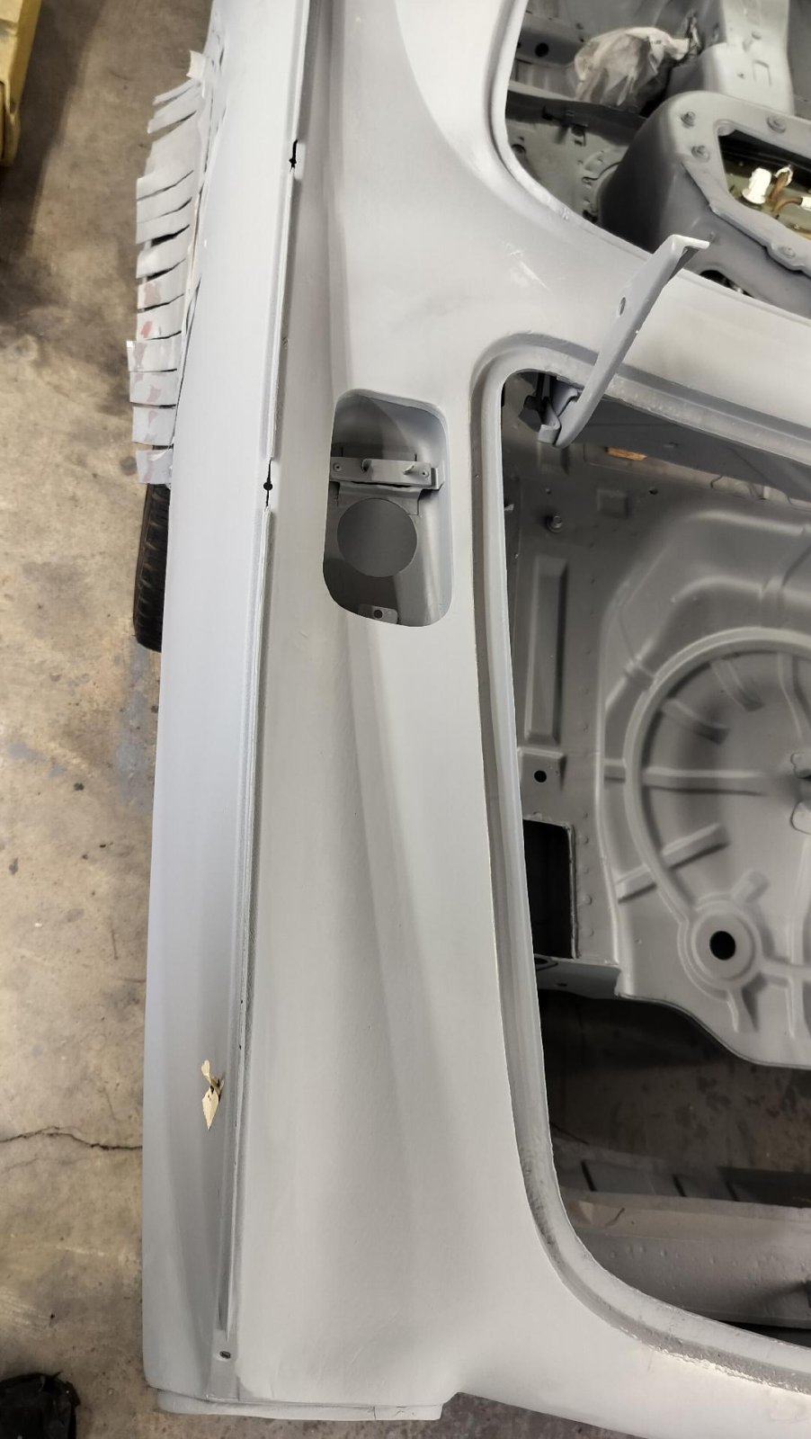

    Polyester primer over epoxy primer after thoroughly cleaning with Prepsall , polyester primer only on exterior metal to make my first guide coat sanding with 80 grit.
    Moved the gas filler compartment from rear edge of rear fender forward to accommodate the Miata fuel tank position.

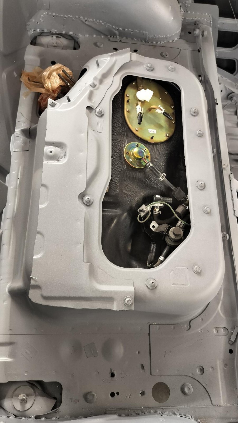

    Miata OEM fuel tank location eats up Volvo back seat space. I will not have any evaporative emissions equipment (some parts and hoses still showing in the pic) and I will plug the rollover valve. I am modifying the Miata fuel filler neck for a 60s/ 70s GM style vented cap. I will leave the plastic check valve in the Miata filler neck to minimize the slosh back of fuel into the neck.

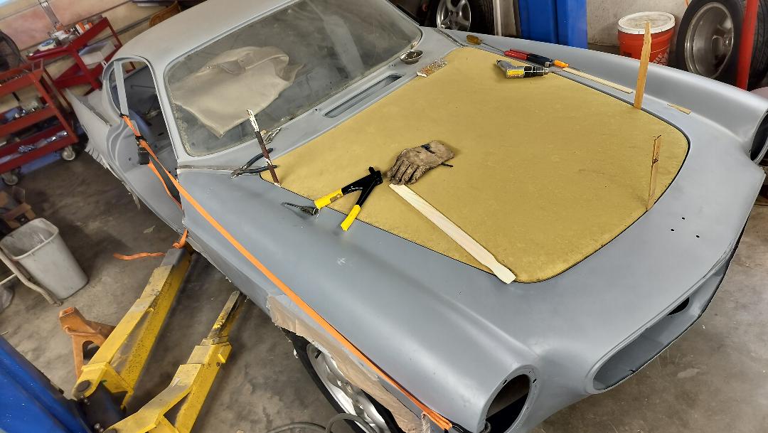

    Front clip from the 1970 P1800 on the 1964 body. Straps to pull fenders back tight as possible. Pop rivet temporarily while setting hood gap.
    Coming soon will be the fender flares (as little as possible) to accommodate the wider Miata wheel track and lowering the car.

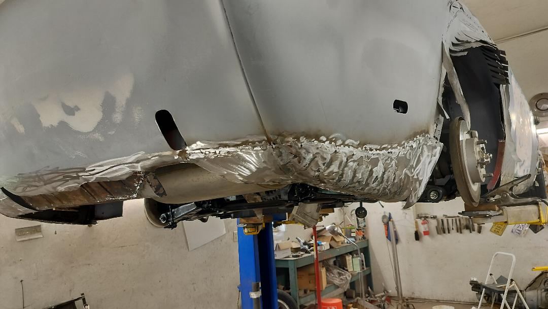

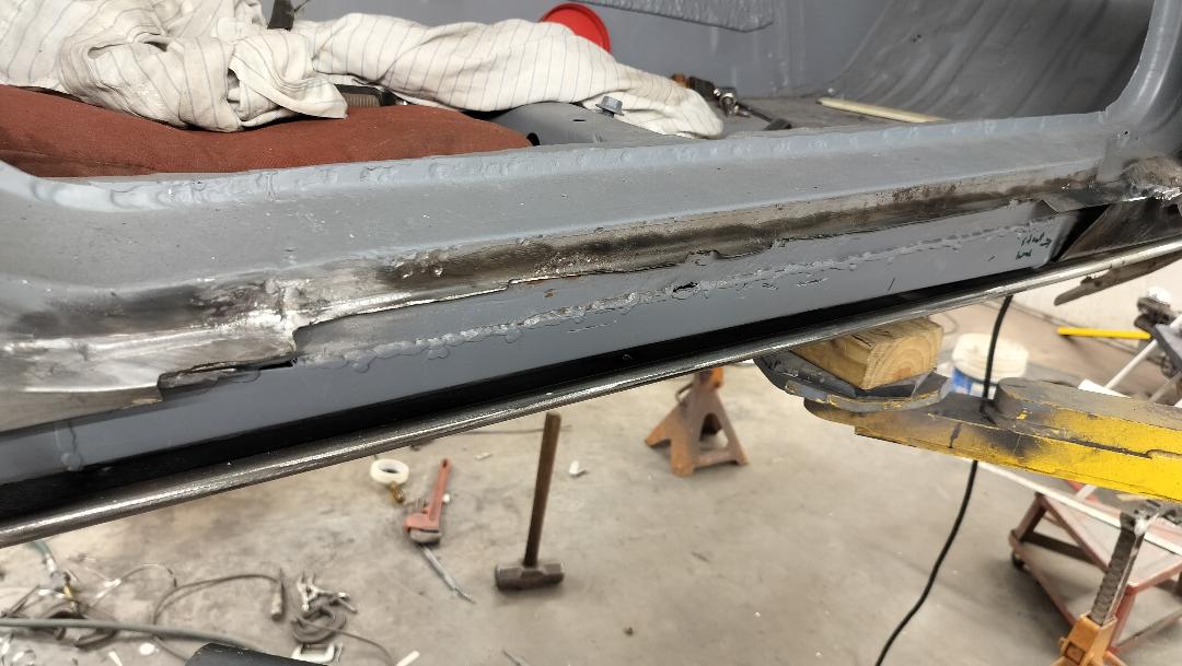

    Work begins on my very ragged rocker panels.
    I decided to make the rockers a multipiece weldment instead of a 1 piece formed. It is very hard to find the exact angles to bend and then bend the angles accurately. Also there is a slight crown outward about in the middle of the door . To work around this I bent a 90 deg angle piece from 20 ga for the bottom of the rocker. I then clamped .5 in dia 16 ga steel tube and welded from the backside of the tube so I wouldn't have to grind the welds. This weldment was clamped to the inside vertical rocker and welded.

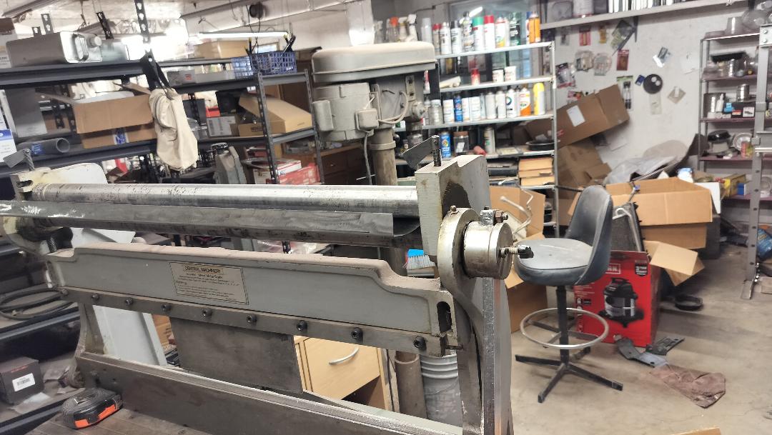

    Now I need to create the outside vertical rocker skin from 20 ga using a slip roll to create the rocker curve profile.
    Now I can weld this to the bottom while piecing in to the top metal that is good. Because of the 1/2" round tube the angle is automatic because you just weld to to the tangent of the tube circle.
    With both rockers finished I can move on to the complex curves of the rear quarters behind the rear tires.

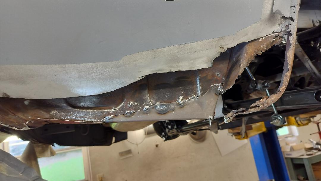

    Rear rear inner and outer quarter repair. Not pretty but it will finish out OK. Rear rear inner quarter repair R.jpg

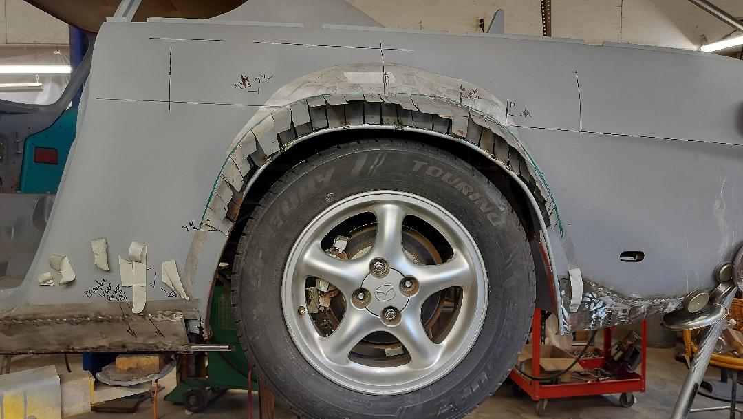

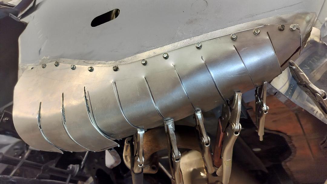

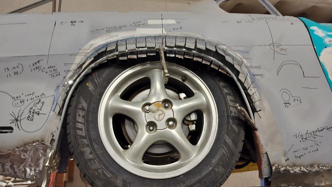

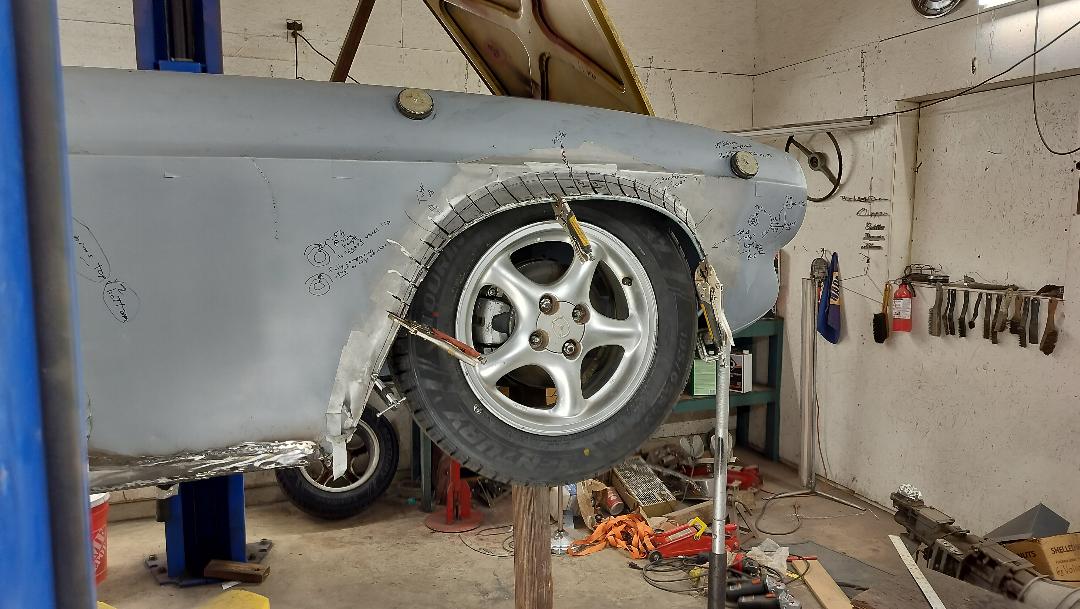

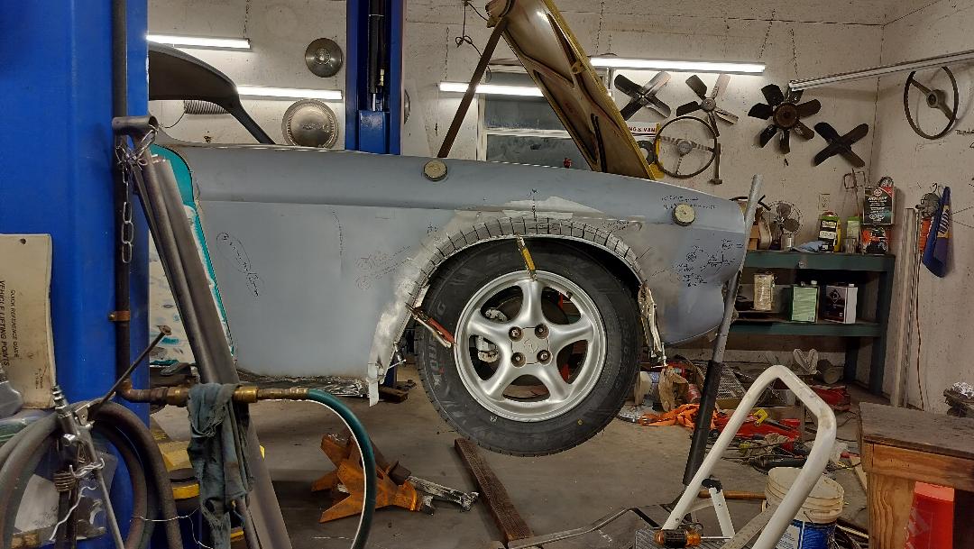

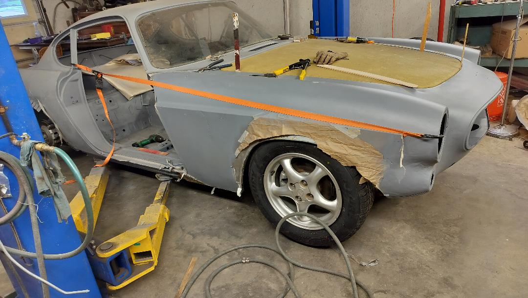

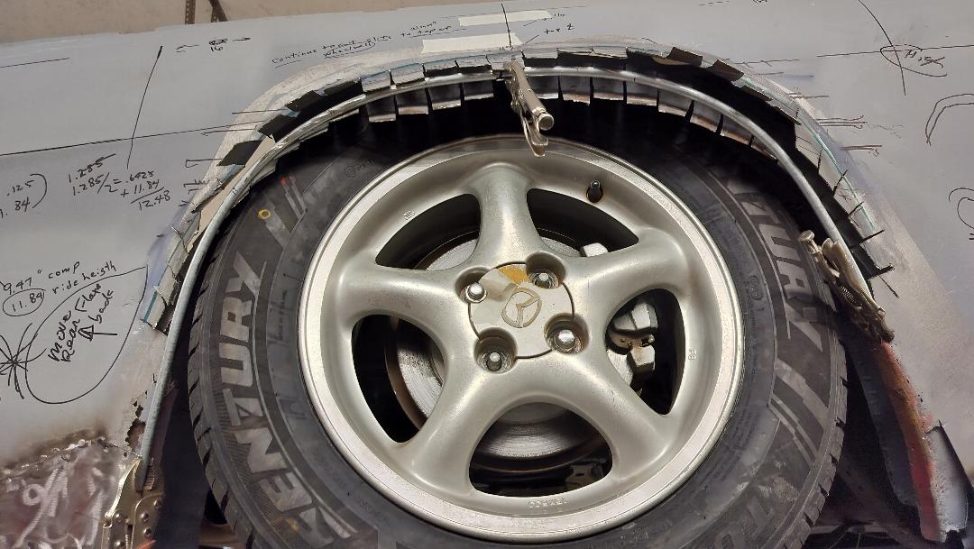

    Front wheel wells 1st try at ride height and fully compressed. I am using 3/8" steel fuel line for the finished edge on the wheel well.
    All of the pics below are the first try at shaping the wheel well openings. The tubing mimics the stock Volvo shape except stretched upward to allow for the lowered stance.
    First pic at ride height next is compressed.
    Front wheel wells 1st try.jpg Front wheel wells 1st try fully compressed.jpg
    It turns out the rear wheels encroach on the body worse than the front and requires tapering the new wheel openings above the side chrome line which I will do the same on the front to match the rear wheel opening shape. Also the rear inner fenders are much to restrictive requiring me to modify the shape to allow for the suspension to fully compress and clear the inner fender.
    The pics below show the suspension fully compressed.
    This reveals that I am going to have to move the wheel opening behind the back tire some more than the stock Volvo shape to clear the back edge of the tire where the body gets more narrow. Also I think if I move the rear of the wheel opening back a little I can bring the flare inward because I don't like that much flare.
    Needless to say, this will take several more iterations to get the flares to look acceptable to me !
    Rear fender flare fully compressed 1st try c.jpg Rear fender flare fully compressed 1st try b.jpg Rear fender flare fully compressed 1st try a.jpg
    I may reshape the rear of the opening like the Aston Martin DB4 below.

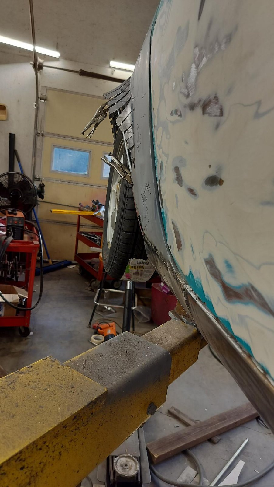

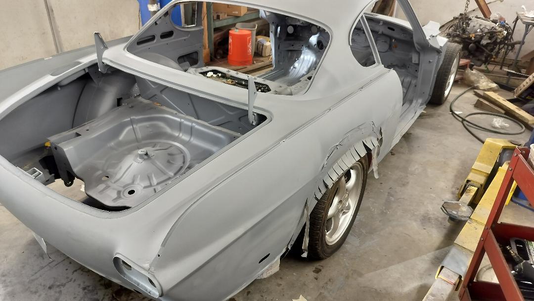

    Rear fender wheel wells second iteration, 195/65 R15 tires are at expected ride height according to my calculations. My intention is to replace the Miata rims with something later.
    I have about 1/2" clearance for the fully compressed suspension.
    The upper 2/3 of the inner fenders are tacked to the 3/8 steel tubing that will be the finished fender lip. Still lots of tweaking to get the lower portions contoured properly,
    R Rear fender wheel second iteration.jpg L Rear fender wheel second iteration.jpg
