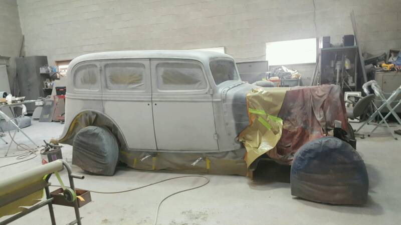

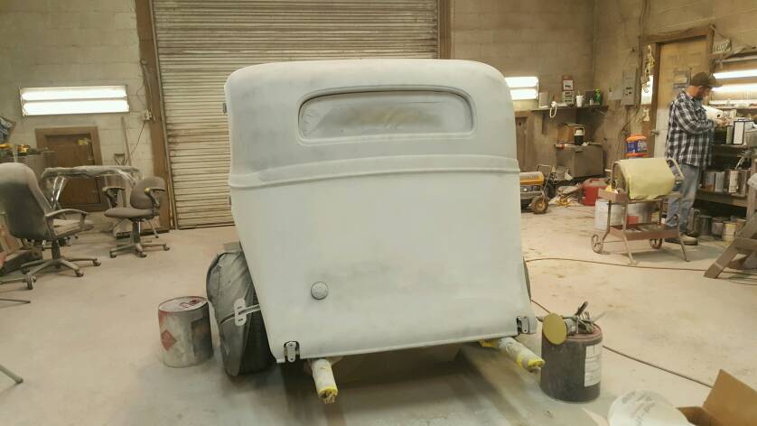

    Here are some more updated pictures, the rest of the body has been stripped now. The shop is using WG55 USC filler (dtm) Today its getting our FORTRESS Semi Gloss Epoxy Primer, will update next time I am there.. Just to give credit where credit is due the car is being done correctly at BACK WOODS Paint, Body and Restoration in Woodland, AL. 1459427282324.jpg 1459427292275.jpg 1459427300842.jpg 1459427307121.jpg

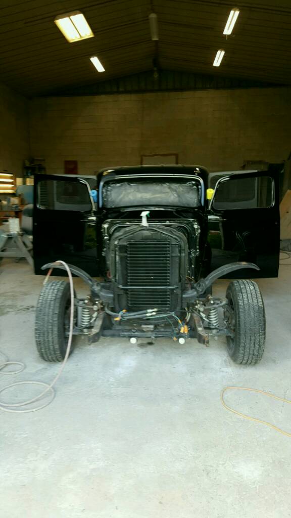

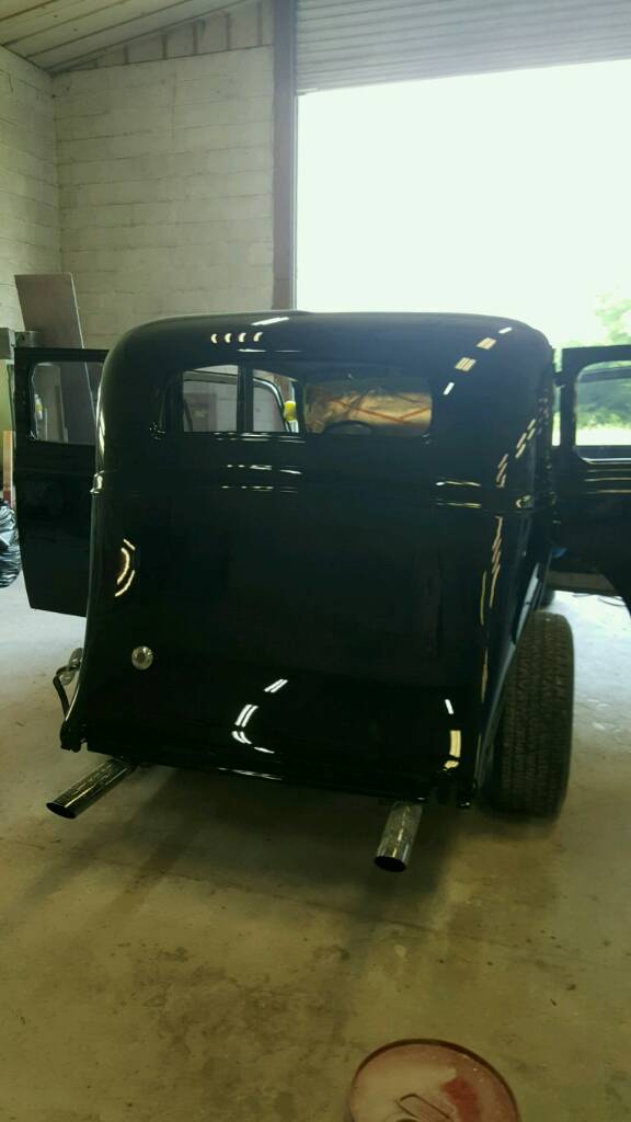

    Here are some updated pictures, buick was epoxy primed then high build urethane, sprayed topcoat last week with our deep black basecoat. They will ***emble this week, and I will get final pics.

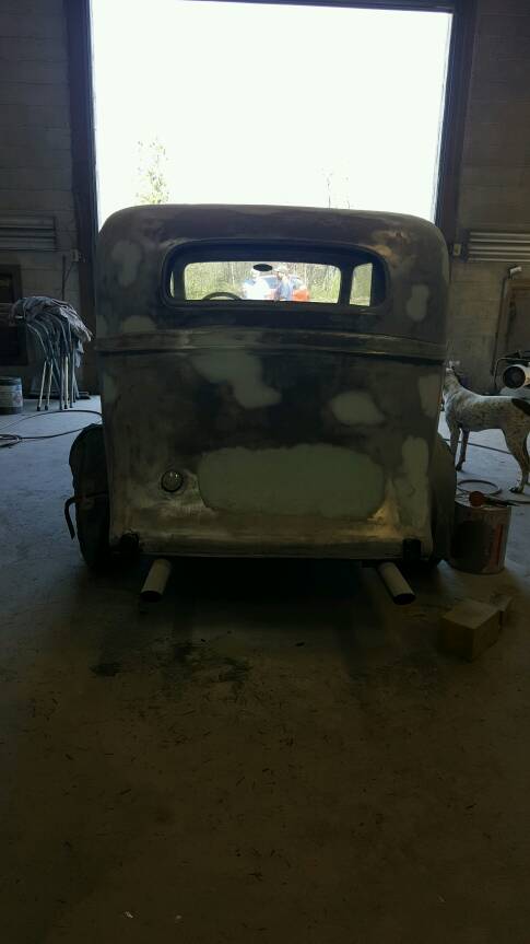

    Just noticed that the plastic filler looks like it is directly applied to the metal. I've heard the filler should be applied on top of the epoxy primer. Thoughts/feedback?

    I have been applying filler to bare metal since the 1960's with no problems ever! That's how all the body shops used to do it. Filler over epoxy is a fairly new deal.

    On this build, the bodywork was already done, and needed to do as little as possible. The shop does their body work on top of the epoxy, which is what we recommend. There are a good bit of bodyfillers that go directly to metal, and it's OK for it to stick to metal here and there, but definitely needs to go on top of a 2k epoxy.
    This is debatable with people, but I will give this scenario and not get into the chemistry side. Let's say you put body filler directly over metal, then did your priming. Most people watersand and bodyfiller is very porous, when you block your primer there will most always be a spot here and there where you cut through the primer to the body filler. That moisture from wetsanding can cause flash rust on the metal below it, eventually causing the bodyfiller to turn loose. At least with a epoxy down first you create a barrier. Now people don't like doing bodywork on top of epoxy because it is hard to feather-edge your bodyfiller. So there is a trade off. But if there were a warranty claim, our epoxy would have to be on the metal. Great question and it's one that make the paint reps and bodyfiller reps want to fist fight!
