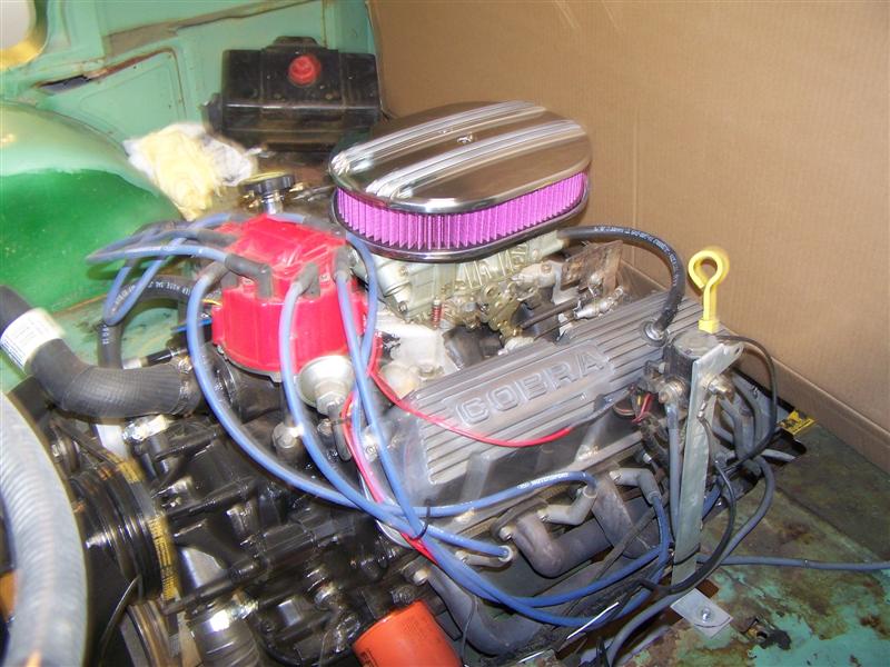

    Very cool, I am in the middle of a econoline pickup build. Wacky 302, AOD and a 9 inch. Here is a youtube of the fresh fire after the swap. Body is alot further then this vid.
    http://www.youtube.com/watch?v=BKctT2LpNo8
    Tons of hours into the tailgate and roll pan. Its is Dodge Ram T/gate that I sectioned in but I think it looks great.
    Just now strating a disc brake conversion. Fun project!
