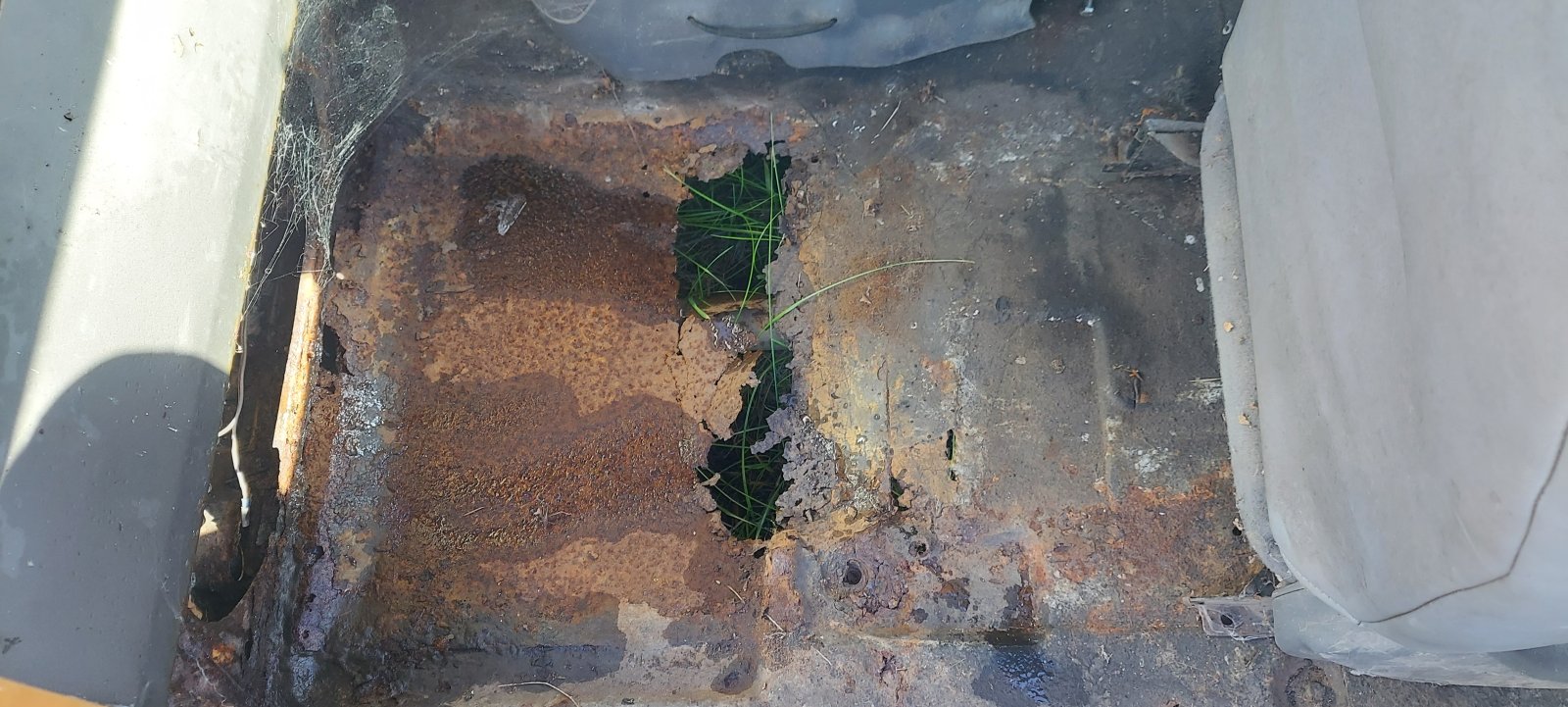

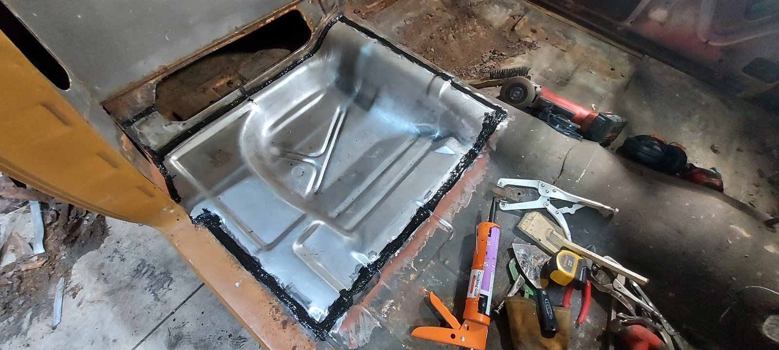

    Just need to seam sealer and prep the rest of the floor for paint. No pro by any means but can get **** done. Ems makes a good quality piece too.

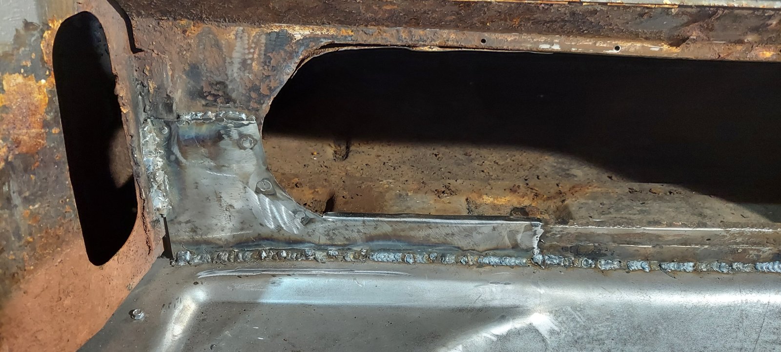

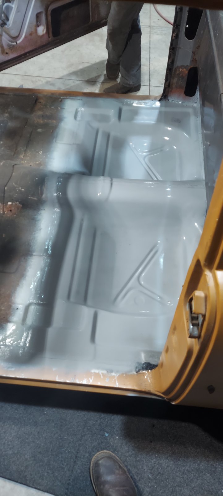

    Seam sealed the edges of the new floor pan, now just to strip the rest of the floor and paint it. Then removed the p***enger fender for lower corner repair and pulled the tailgate off to replace it with better one I bought awhile back.

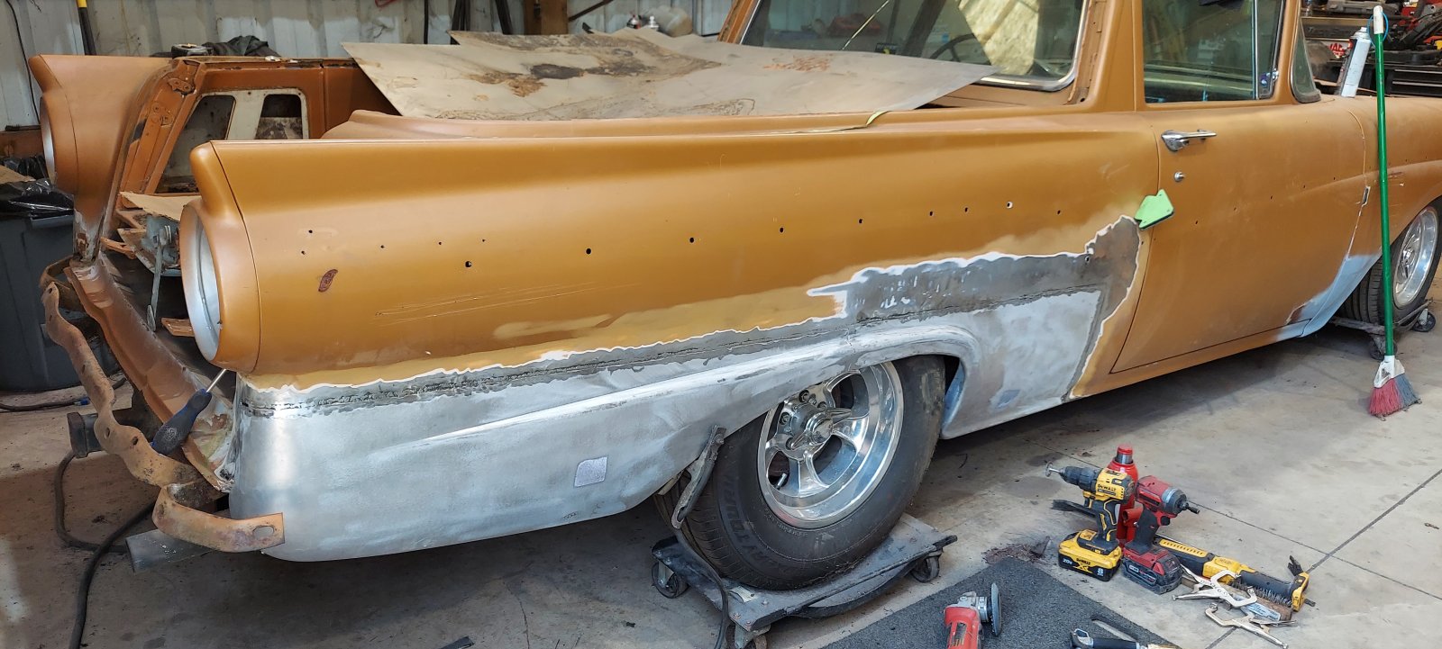

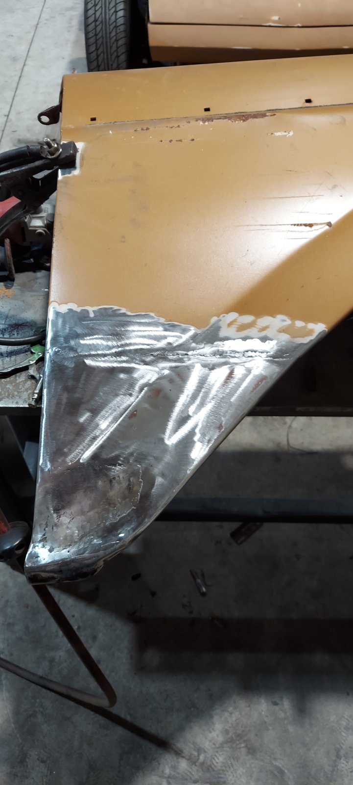

    'Roughed in' my lower fender corner. I used a piece from another fender which needed a little patch done on it. I should have taken a before pic of this fender but I didn't. I have a little more metalworking followed by some filler left.

    Here's tonight's update, bolted fender back on. I'm satisfied with the lower rust repair, needs some filler to make it better but it'll do!

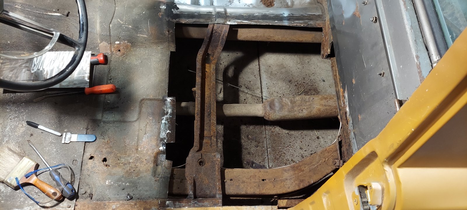

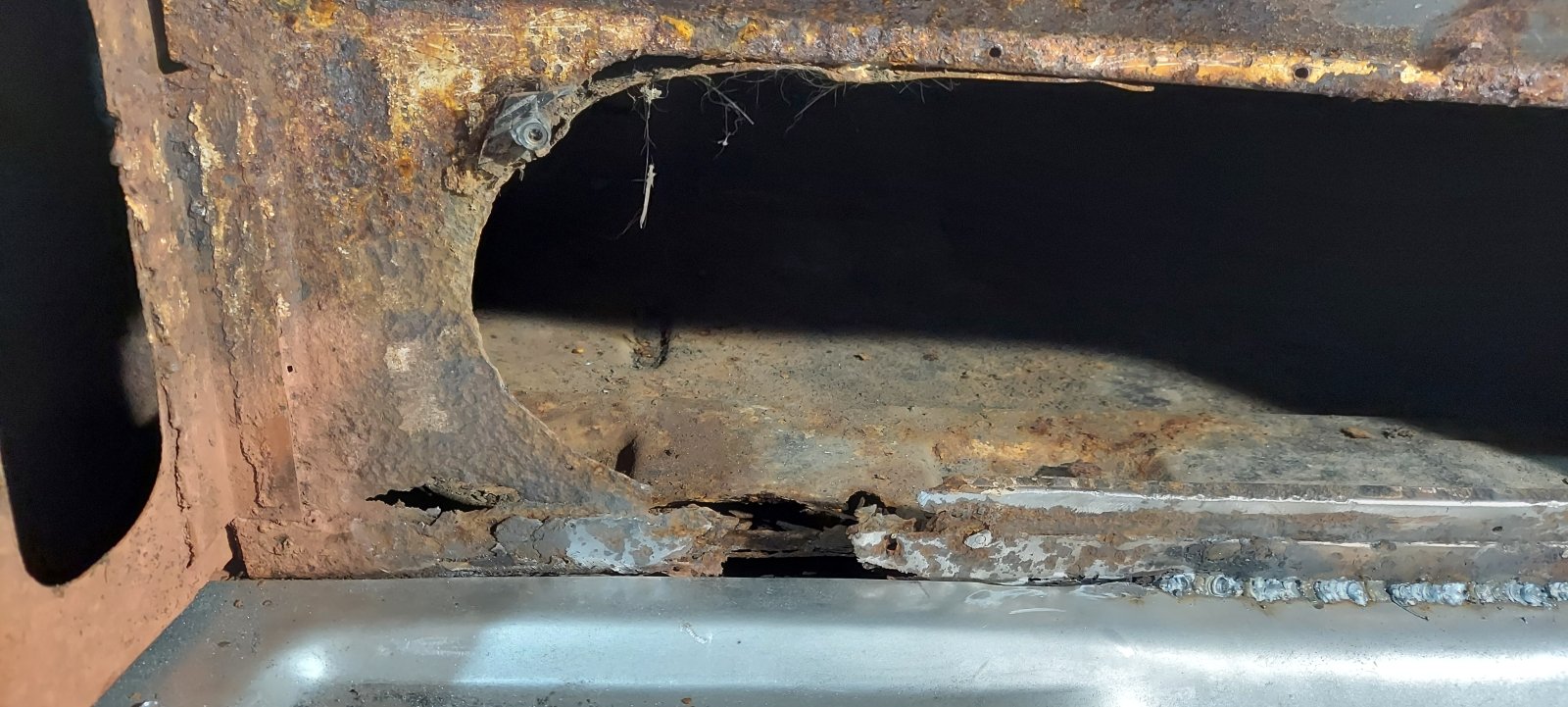

    After further investigation I ended up ordering the drivers side floor pan as well tonight..kinda 2 steps forward 1 step back..oh well

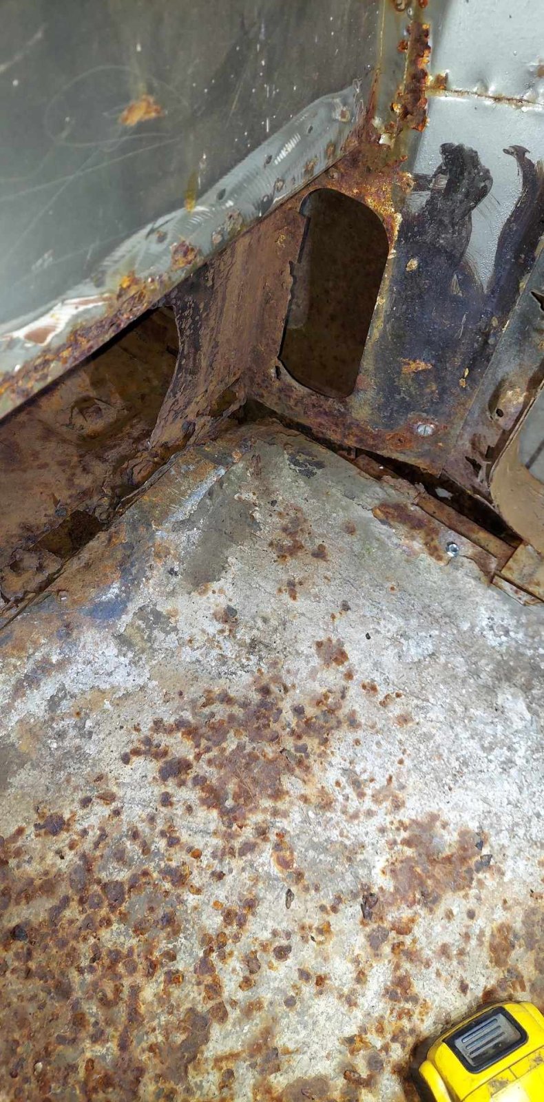

    Rusty cars **** sometimes!

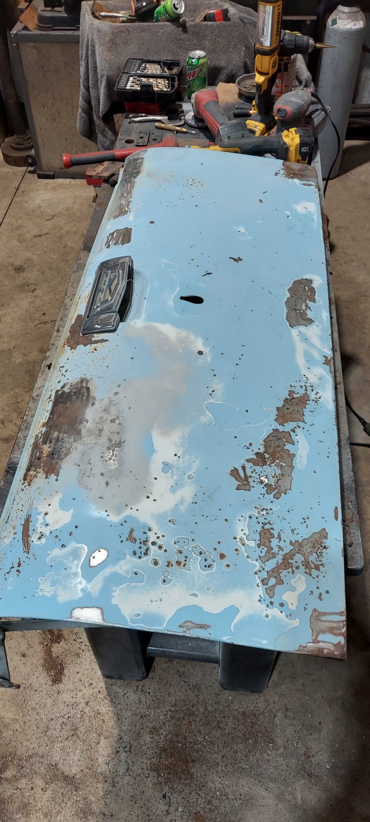

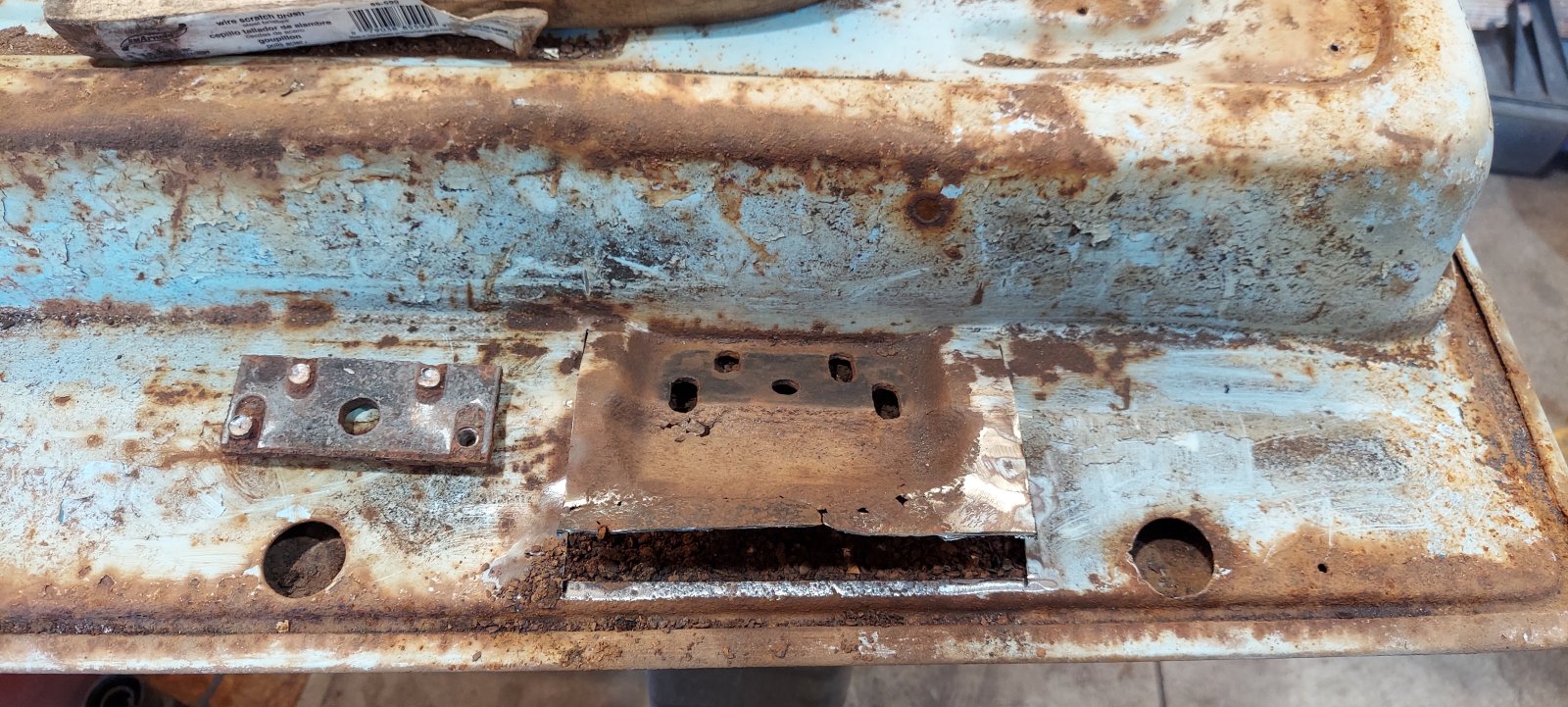

    Started to work on my "new" tailgate while I wait for my floor pan to show up. Found a bunch of pinholes in it. All the screws had to be drilled out and I cut the bottom of the tailgate to get the threaded bolt plates out..that ****ed!
    I also cleaned up and rattle can rebuilt the engine bay. I also picked around on the quarters and am gonna need to buy inner quarter panels as well...

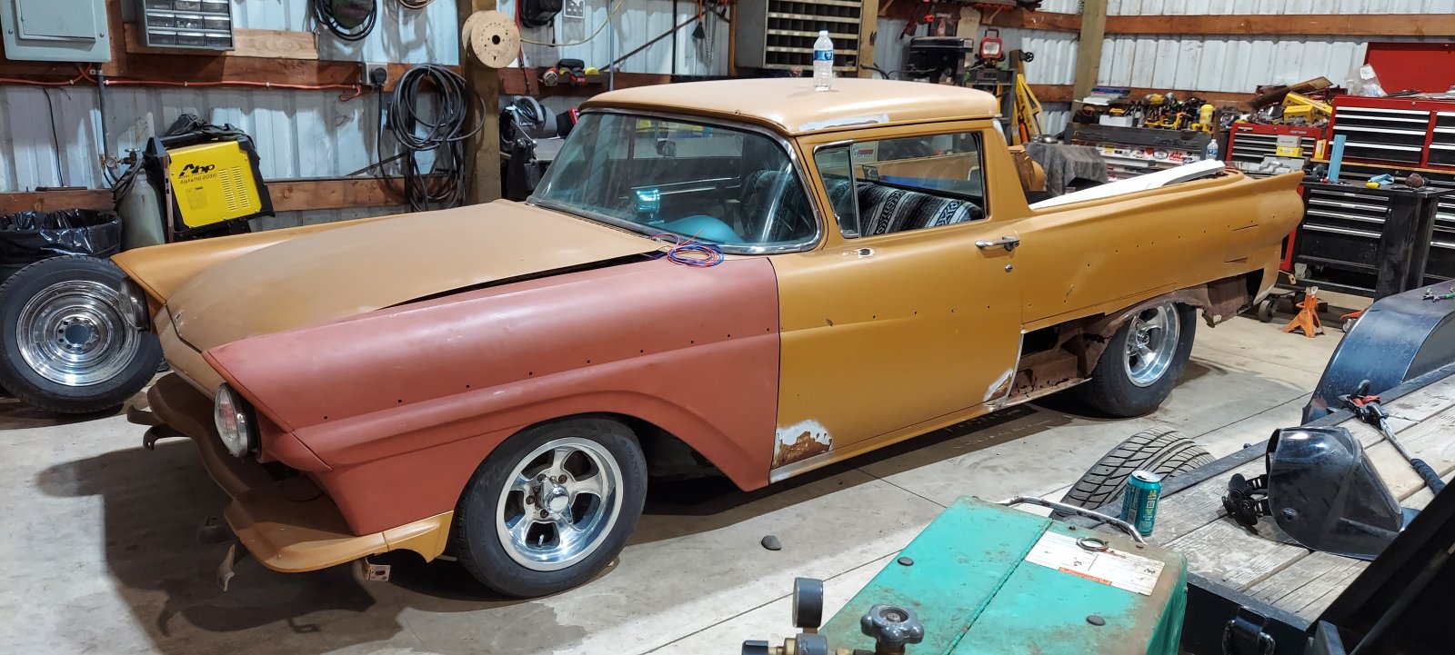

    It's my first time seeing this thread and so scrolling down from the beginning I was pretty surprised to see the rusty/abandoned pic.

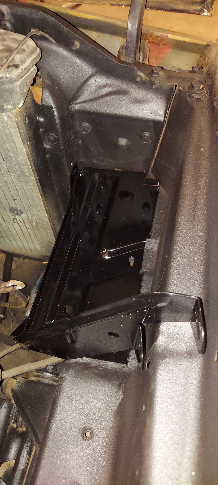

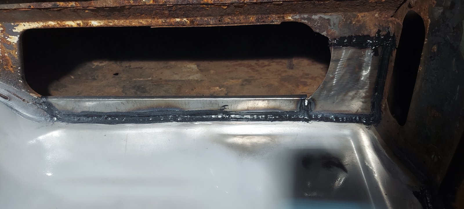

    Started the drivers side floor pan. Just have to weld in place now. Also got a new battery tray.

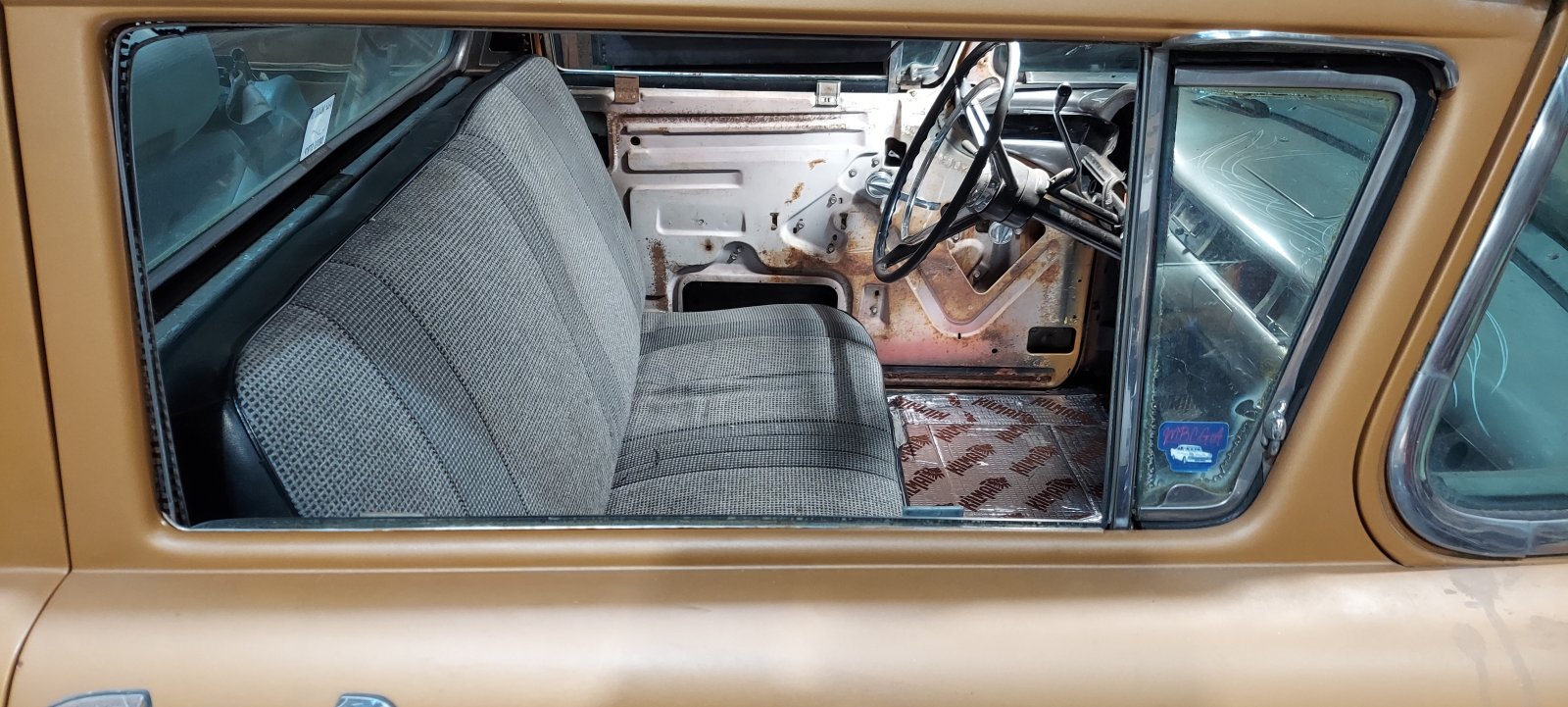

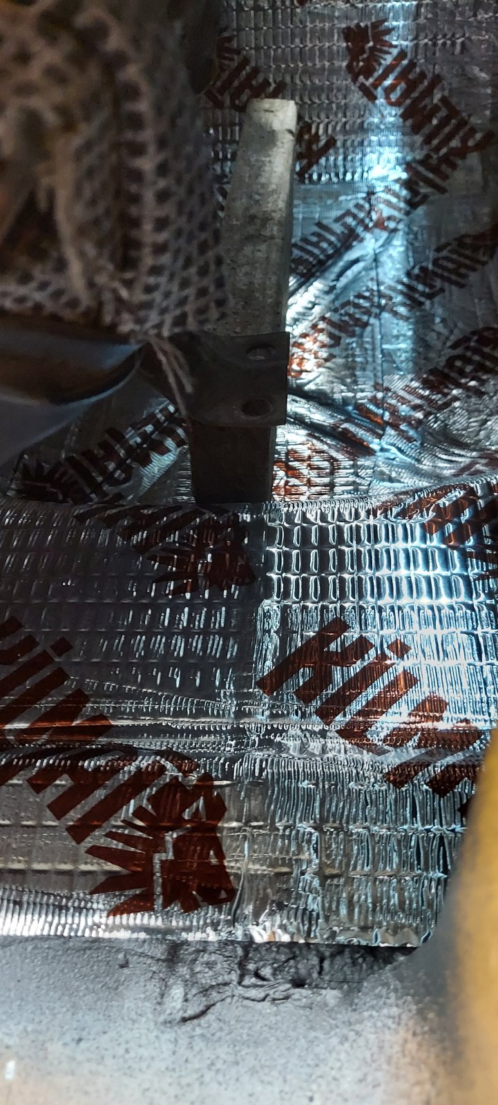

    Kill-mat installed. Also test fitting the seat out of my F100, I found a better seat for that so this will be in a new home.

    Seat brackets made and bolted in, grade 8 bolts installed after. Started chopping out the rusty quarters. Need to order inner quarters and build some pieces.

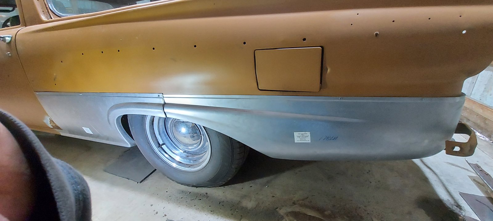

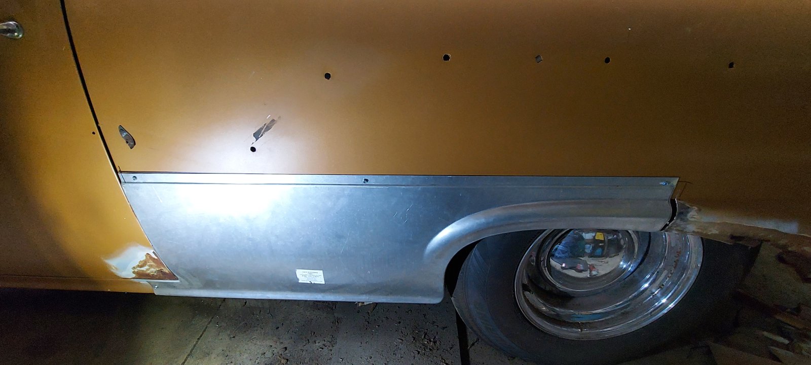

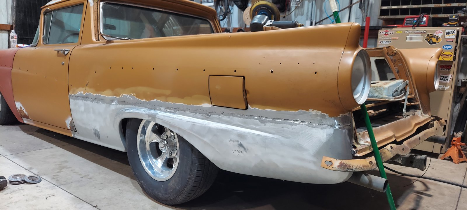

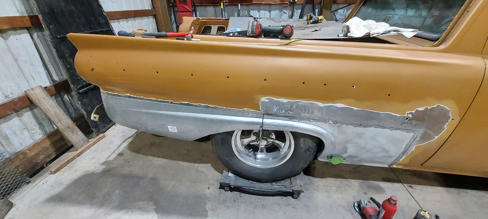

    Work got done this weekend. Handmade inner quarter panels front and rear and burned in the outer skins. Not perfect by any means but this is also the first quarter panel skin I've ever done.
    Now onto the p***enger side!

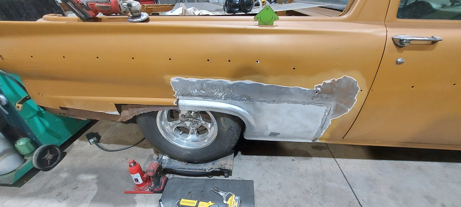

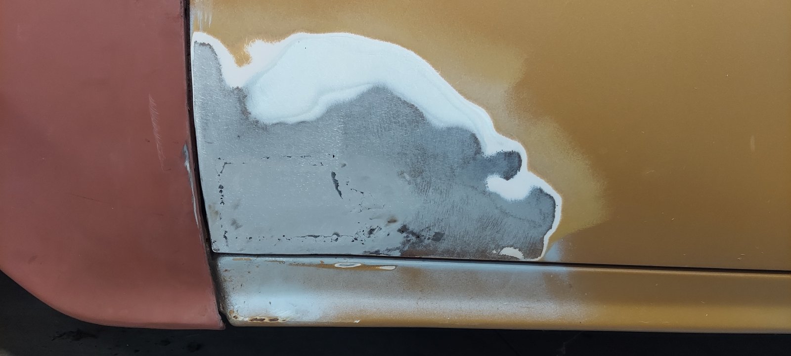

    Couple small patches on the doors. This completes the rust repair on the drivers side minus some filler.
