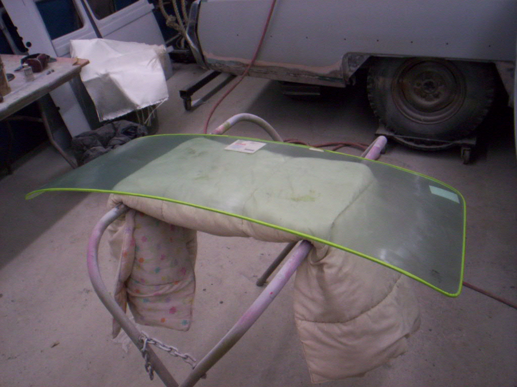

    I have the windshield but the top of the frame was gone. Plan is to take the gl*** and make a mold from fibergl*** and use the mold to build a frame around. I am planing on building a back gl*** from say a full size chevy pickup front gl***,I have one, and cut it down to the shape I want for a back gl***. I need a curved gl*** and think a front gl*** out of something will work. I`ll build the rear window frame much the same way as I plan on building the front frame.

  26. fitzee
    Joined: Feb 26, 2003
    Posts: 2,862
    fitzee
    Here is a few pics from last nights fire wall and trans tunnel repair and some from today. had the roof off a 1980 chevy pickup in my stash and after sizing it up I think I can mod it to work for the top of the frame.There some other cool shapes on the roof so keep them too. The gl*** show up today,thanks Peter, Did a quick fit and the gl*** is not for a merc!! I`m thinking it is for a 52 ford.It is close but you can see it not the one for it.I still can use it cause where it is different I will change the frame.So I gl***ed over the window so i can make a mold of it and use that for the frame building.Just waiting for the fibergl*** to dry and it is on to the next step.

  28. Rocket56
    Joined: May 12, 2009
    Posts: 59
    Rocket56
    52-54 merc and ford is the same gl*** according to all the listings , but sedan and hardtop could be different like the GM products ...sorry you got what I was given . I am sure it will work out.
