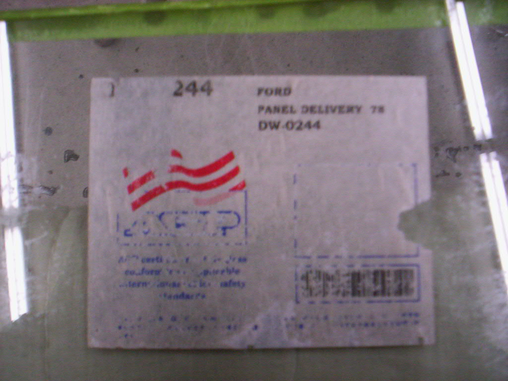

    I hoping it is the same but it only says it is for a delivery on the window sticker. The bottom is different this is why the two cut were there. i need to lower both corners to make it work. also it get wider as it go up the side.
    I not too concerned about the fit just that I would like to know what is available in case I brake this gl*** when cutting it or if it brakes down the road. Nice to have a back up plan

    Figure it out!! There was a number on the tag so did some searching and found that a 52 merc hard top took a DW245 gl*** while the 2 door sedans and wagons take a DW244 gl***. which is the number on the gl*** I have. Nothing said about delivery. Why would they do that?? There was many more sedans and wagons around why didn`t the gl*** just say sedan!!!

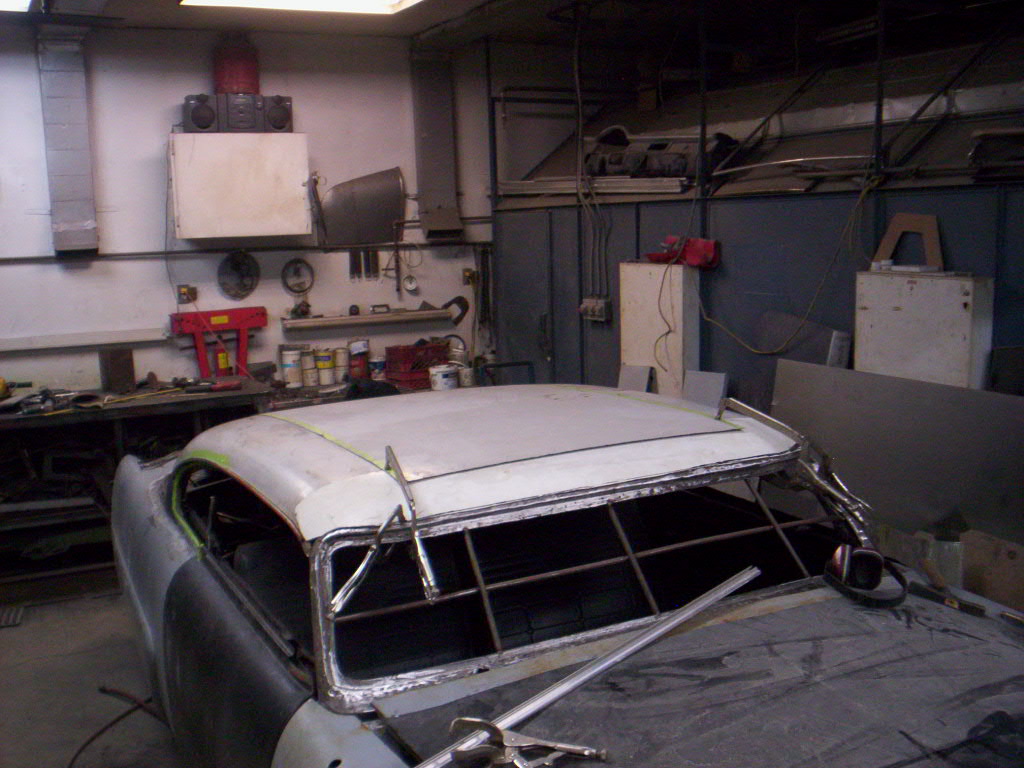

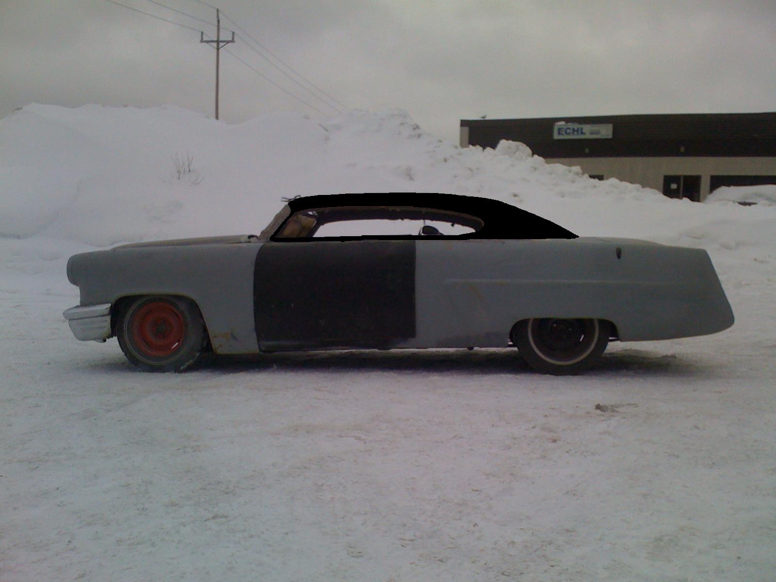

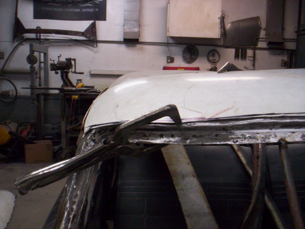

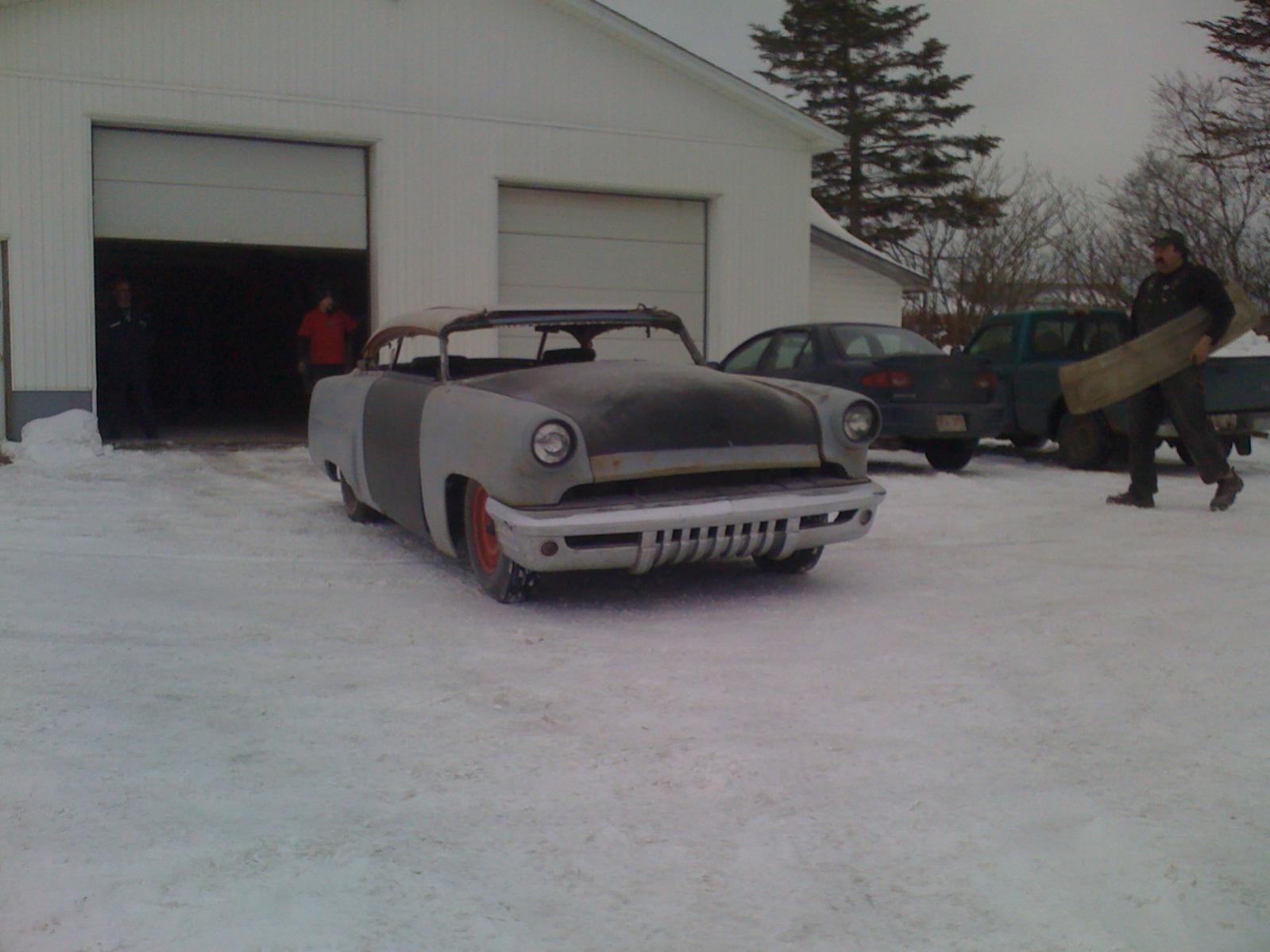

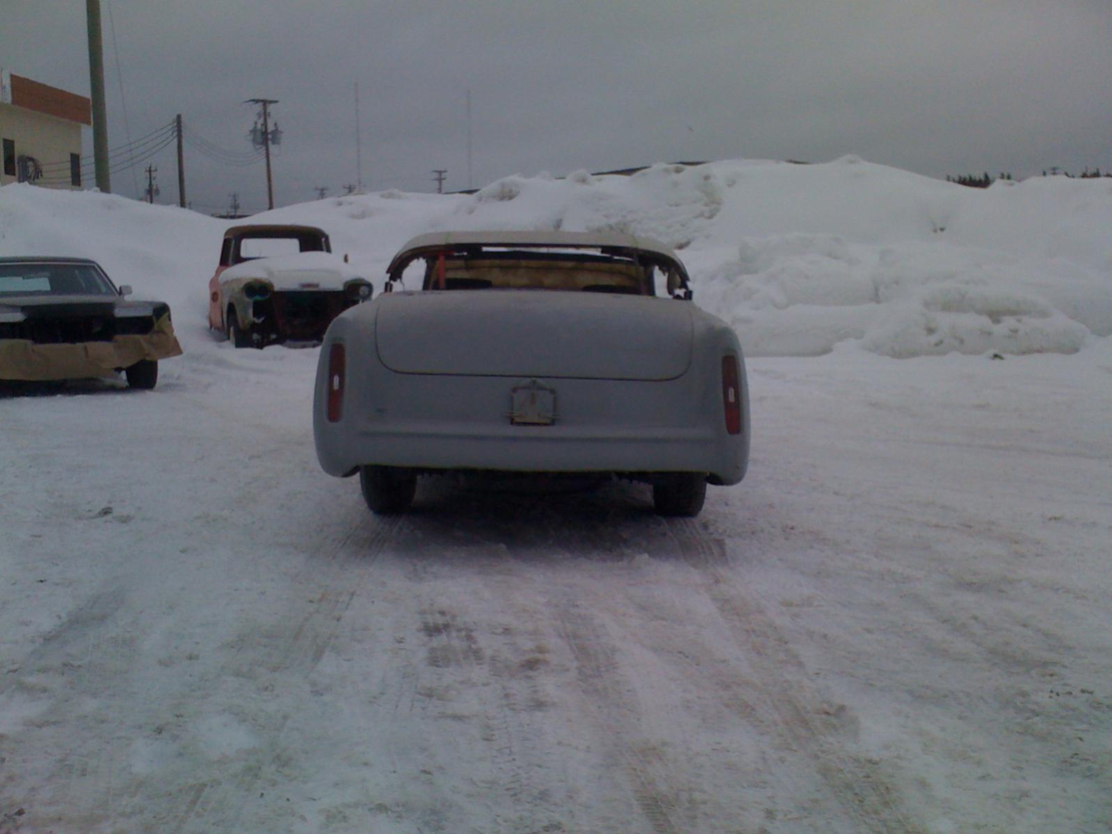

    Well Mocked the front frame together and cut the roof up for mock up. Played around with different heights in the back and found this to be the best flow to the roof. Lots of head room.!!We rolled it out by the door for a better look and I did a quick photochop of the roof line. Having trouble deciding on what way to flow the rear window but the way I have it done here seems to grow on me. Going out to the shop today for some time at the car. Plan on seeing if I can get the front window frame finished.

    Looking good ! cant wait to see it come together.

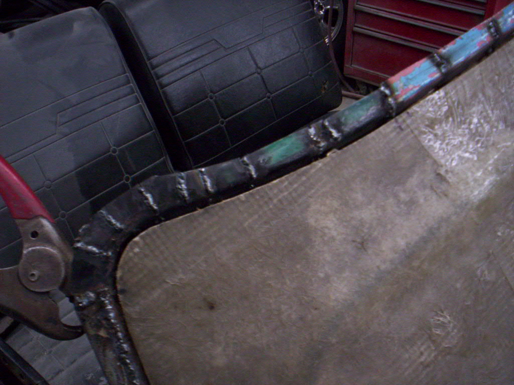

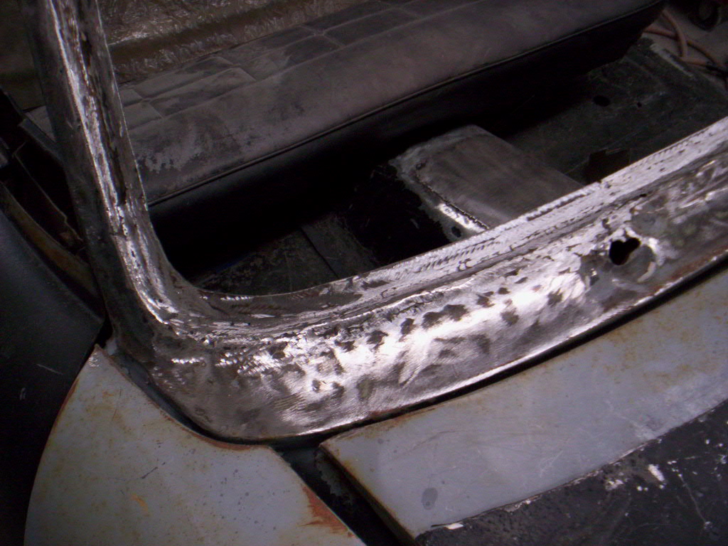

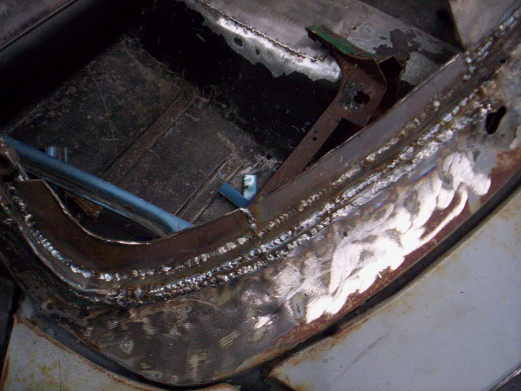

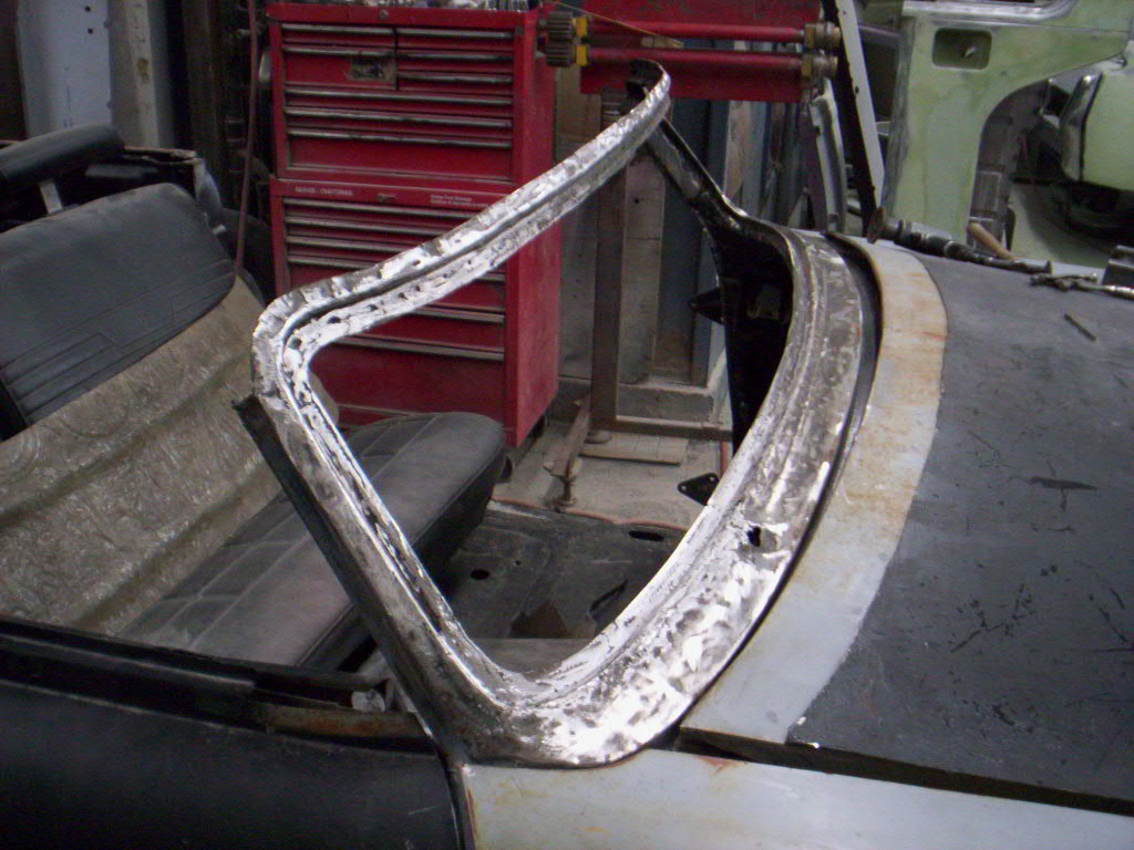

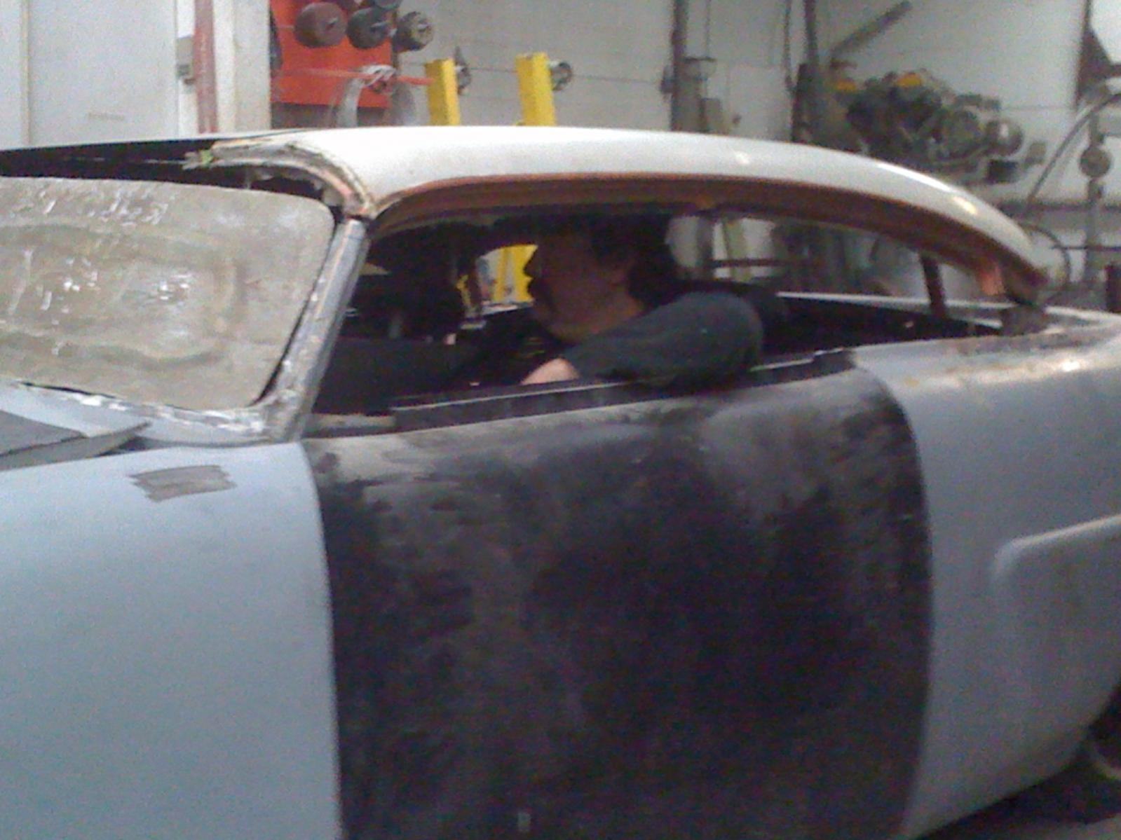

    It was a long day!! I had it in my head to get the front window frame all welded up and cleaned up.Well 10 hours later I have it done. First i had to fit the gl*** and cut the frame to fit the gl***. Both lower corner had to be chopped out and completely made from scratch. Tool some time but worked my way around the frame cutting bending welding as I went.I mounted nuts on the frame and gaped the bottom and sides with 1/4 plate. Did this to set the gl*** at the right height and to have a 1/4 gap around the frame as I built it. Plan is to flush mount the gl*** and mount it in urethane.
  19. fitzee
    Joined: Feb 26, 2003
    Posts: 2,862
    fitzee
    Where the gl*** is going to be mounted with urethane the lip the gl*** sits on is too small for this.These frames were setup for use with a rubber seal. With this i had to make the frame wider. never got crazy here making each piece just so. I welded pieces of 16 gage on the edge and cut then to size after. After all this was welded it was time to clean it all up. Was not looking forward to that but before long it was all cleaned up. Now need to move on to the sides of the roof and role the top of the frame to the roof.

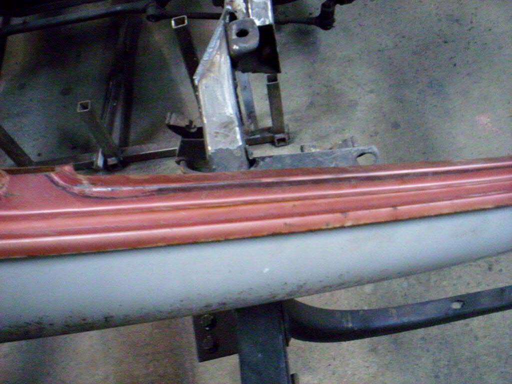

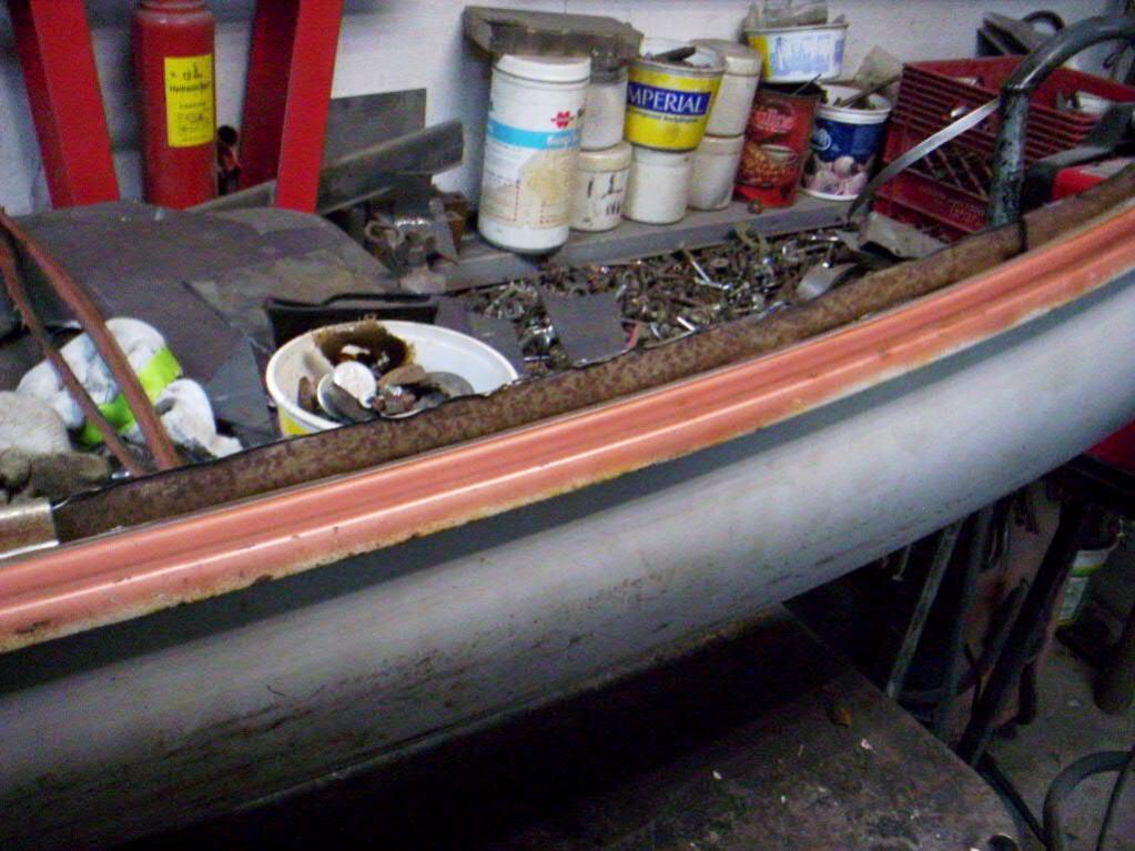

    While I was at that Jason Had some spare time from his Model A project to lend me a hand. The Pontiac Roof was off a post car and where I am making the merc a hard top there was some work needed to be done to the sides of the roof before I mount them.There is a second edge on the lower side of the drip rail that had to be cut off. Jason cleaned this up for me. This will be the next job to cap these in.

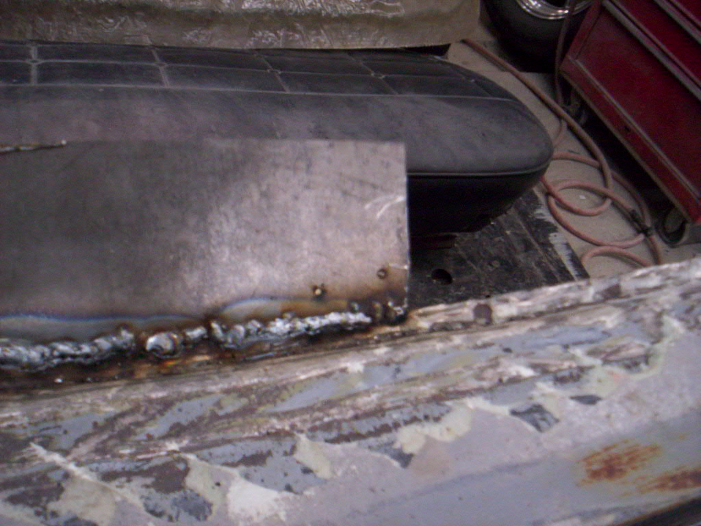

    Time for another update. Day started out ruff. Before welding the roof on the car i figure i fit the door gaps. Well P***enger side was a joke. Seems when the roof was chopped off of it the cowl dropped. Door bottom gap and rear gap don`t line up. You get one and the other will be off. I seen this before so it was not new to me. All I did was set the door up so that the gap on quarter was the same from top to bottom. never mind the rocker gap. When this was done I found the door overlapped on the rocker by the quarter and there was a nice gap at the leading edge of the door by the fender. also the door was dropped about 3/8 of a inch on the back. I let the front body mount go only to find out that it had been crushed at some time!! Then I just jacked up the rocker in front by the door post. As you did this the rear of the door would rise and a gap appeared on the rocker by the quarter. Did this to the p***enger door and shimmed up the mount and the door was fixed. But the drivers door!!! no way. spent 4 hours this morning chasing the alignment. Seems someone had problem here and ended up with a half inch gap on the door to the quarter at the top and a 1/4 inch gap at the bottom. Had to grind a bunch of filler out of here to see the problems. But after moving the door around for 4 hours I got it. Was a little pissed cause it took so long. Did not want anything to move on that door so I welded it shut till the roof is done!!lol. So after all this this is what I ended up with!!

    Now that that was done it was on to the roof. Finshed off the lips on the lower side of the roof sections and then set up the p***enger side and welding it in place.Now I needed to figure out what I wanted for a rear side window. I ended up cutting about 8 inch off the end of the drip rail and making a round section for the end of the window from some 16 gage. The idea I photo chopped was not doing it for me and I was seeing the look of a 70`s car. But having the window like this it reminds me of the earlier mercs. I then cut and trimed the drip rail to flow with the turn of the window. I placed tape on it to get a better look at the lines.
