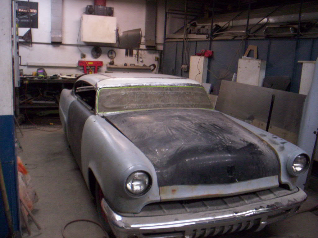

    That really looks good Fitzee! I love the shape of the side window it really changes the look of the car , what do you have planned for a backlight?

    HUH!! Had to look that one up!!! Sorry no LCD on this car!!LOL As for a back gl*** I had a front gl*** from that 1980 chevy truck. Plan is to cut it down to a size and shape I like and build a frame around it. I never got that far yet so the idea might change. Did not want to think too much about it cause it is another issue that I need to figure out. I`ll figure out something

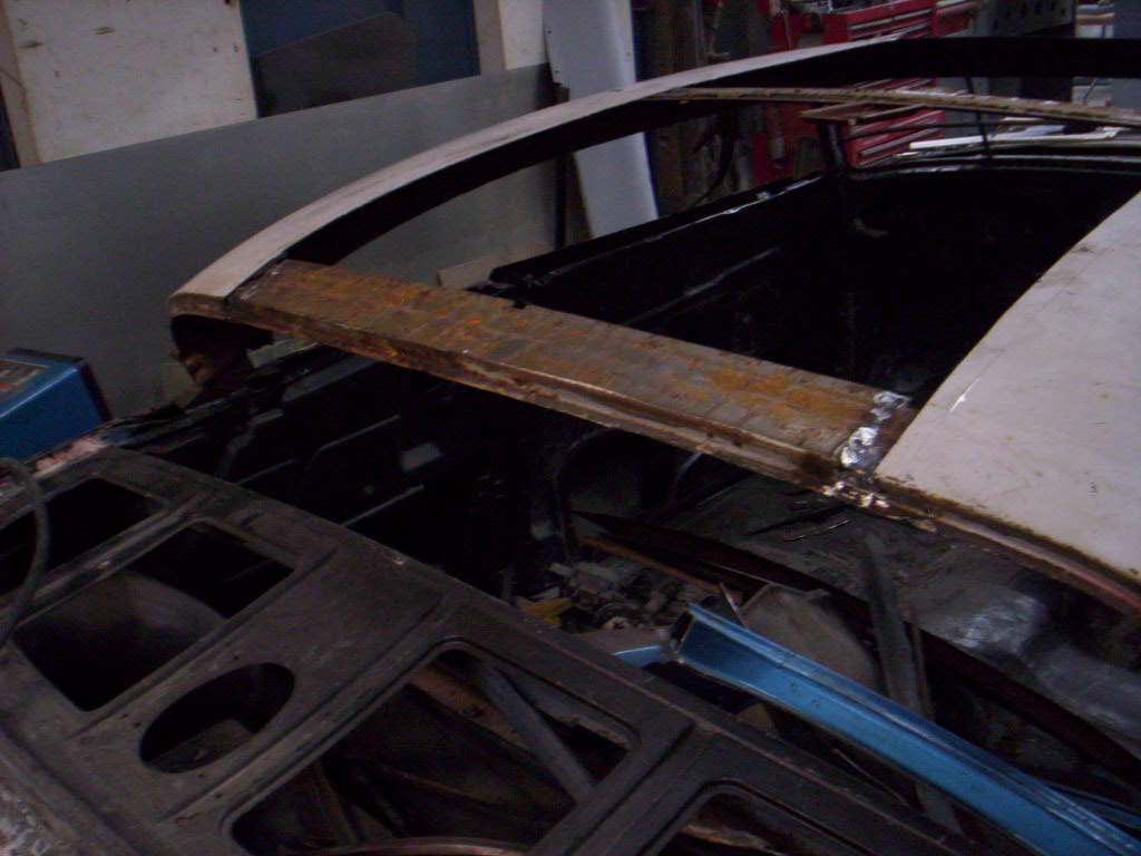

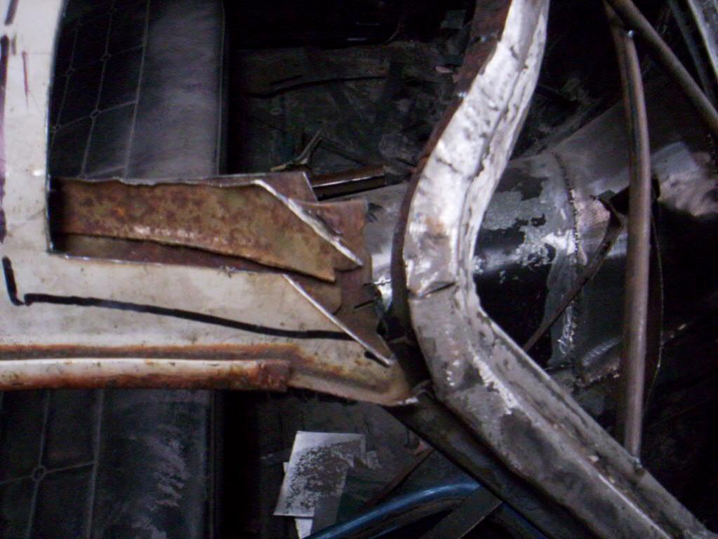

    Went back at it today. Want to get the roof all tacked together. Before i put the roof skin on i had to join the middle frame on the roof to the windshield post then cap the out side. Still have to join the inner frame to the roof but will do that when I weld everything inside.

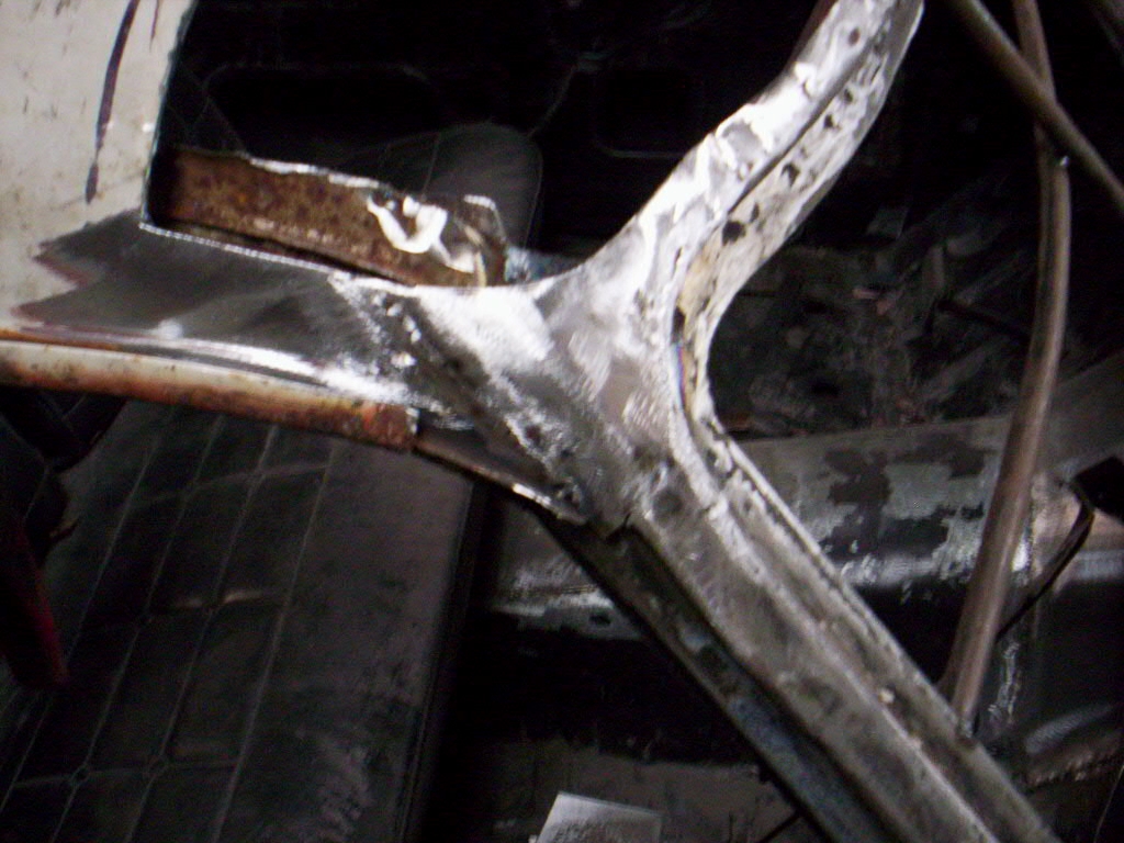

    Next I fit and welded the front section on the roof. I had to watch it here cause it didn`t take much for the roof to drop on me. Had to cut the tacks and try again. After that I reinstalled both cross member in the roof.I bent these a bit cause i found they ere a little flat for my liking. After then came the skin. Took my time here checking the roll of the roof after each weld. Well I going to wait till i weld everything up because I might see something I don`t like but as it is now I`m very pleased.

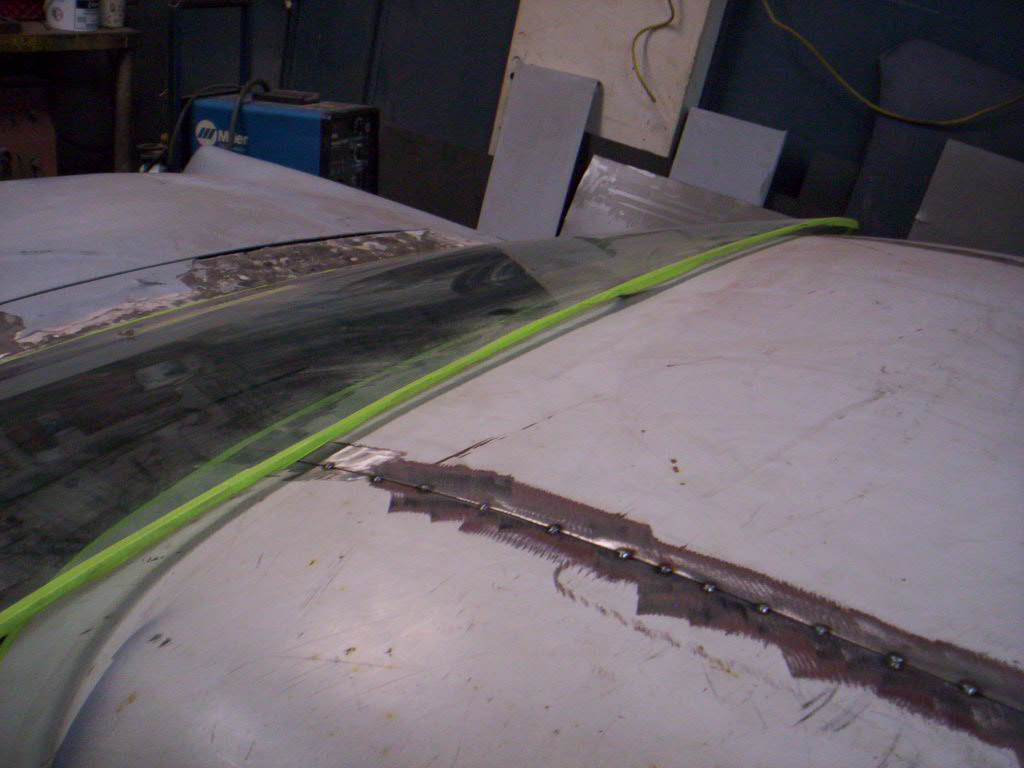

    I finished this up early so i figure I would play around with the back window and see if the front gl*** from that 80 chevy pickup will work. it has the right curve for the top and from what I can see just might work. I marked out some tape line to see how big of a back gl*** I can make. There something about it that is not doing it for me,might be the window is too square but I follow the lines of the body. What do you thing??
  7. Try giving the top line a gentle curve
  8. koolkemp
    Joined: May 7, 2004
    Posts: 6,006
    koolkemp
    Try and make it a bit narrower as well, more like what you would see on a carson topped custom for a back window...
  9. Squablow
    Joined: Apr 26, 2005
    Posts: 18,698
    Squablow
    Roof is coming along great. I like the big rear window opening that it has now. I realize it'd be near impossible to fit a gl*** to that hole, but I'm not feeling the little tiny square rear window. I saw a 50ish Merc chopped using a 70 Firebird/Camaro rear gl*** that actually looked pretty nice. It worked well with the low top since the Camaro has a similarly low roof profile. Don't know if you'd have access to one or if you'd want to use it since it wouldn't be period correct but it's a thought.

    Roy I was thinking about a 3 piece gl*** like in the 57 Buick. I could use the pickup gl*** for the middle just need to figure out something that has a curved gl*** for the two sides. Now this is just a idea. Might be a lot of work Also I forgot to check today but i have a front gl*** for a 58 Chevy truck. Was wondering if I turned it around and laid it flat could it work.

    The 70 camaro gl*** don`t rap around. Might be long but be nice to see a car with one in it

    I thought about that.That kind of window looks good with a padded top,don`t know how good it will look with a painted roof. I need to skin out the rear roof with some stiff cardboard to get the look of the roof then play with window treatments.

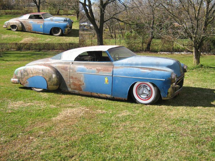

    Here's one with camaro back gl***.

    That car looks like it has a whole camaro roof.

    Yes and that gl*** is too narrow for my car.

    That's the later style Camaro gl***, the early one doesn't curve around the sides. Although on that particular car, it actually looks pretty damn good.
