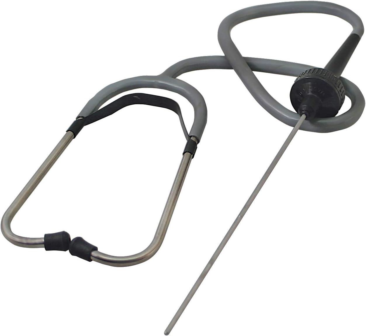

  5. To me through my computer speakers it sounds like header gaskets. Get a stethoscope from the auto parts store, run it with just a hose around the flange (upper and lower).

    Long screwdriver works great to pinpoint internal noises. Handle held to ear and tip against engine.
    Make sure to keep clear of pulleys, belts and fans.......:eek:

    Get a length of garden hose (3 -4 feet), hold one end to your ear, and float the other end around the engine/headers, you'll hear the noise, and being a hose, if it's coming from the headers, you can get right in between the pipes to locate it and you won't burn your hands..

  18. This will make ya grin. My dad had a genuine engine stethoscope (I got it now). He used a long screw driver unless there was a client in the shop. I do the same, the stethoscope is just for looks.
