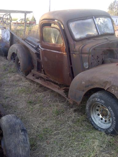

  2. 41chevytruckinga
    Joined: Mar 11, 2011
    Posts: 33
    41chevytruckinga
    Dean,
    here is a link swifter sent me to help me with what I thought were 2 1946 chevy trucks.
    http://www.brads41-46chevys.com/id14.html
    Turns out one is a 46. It will tell you the most of what you need to know, however if the tag on the cowl is missing, you might have to go by the engine serial. They do make repro cowl tags but you have to take it somewhere to get the numbers stamped. I will post a pic that shows where my 46's is located. you can see it just above the fender.

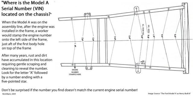

    This is the information that I have gathered over the years on Model A serial numbers (now used as VIN's). Stamped only in one place and it was matched the engine number, which was stamped when the engine was built (not as it was going down the ***embly line, sometimes the engine sat for months before being installed in a car.) I have owned Three Model A's and all of them only had one number in the frame. Sometimes you will find one with no number as the guy on the ***embly line got behind and just skipped one. This is very rare for Model A's, but common on T's,
    Ford also stamped numbers in the body itself, but this was just an ***embly number indicating what plant is was made at and the body style. These are stamped in the horizontal floor front body crossmember and the body side rails. Some Fordoors and Cabriolets had them in the Wooden body cross member as well. Briggs and Murray did a tag that could be on the firewall or the body crossmember. Again these are not serial numbers but only body ID tags as to where they were built and what type.
