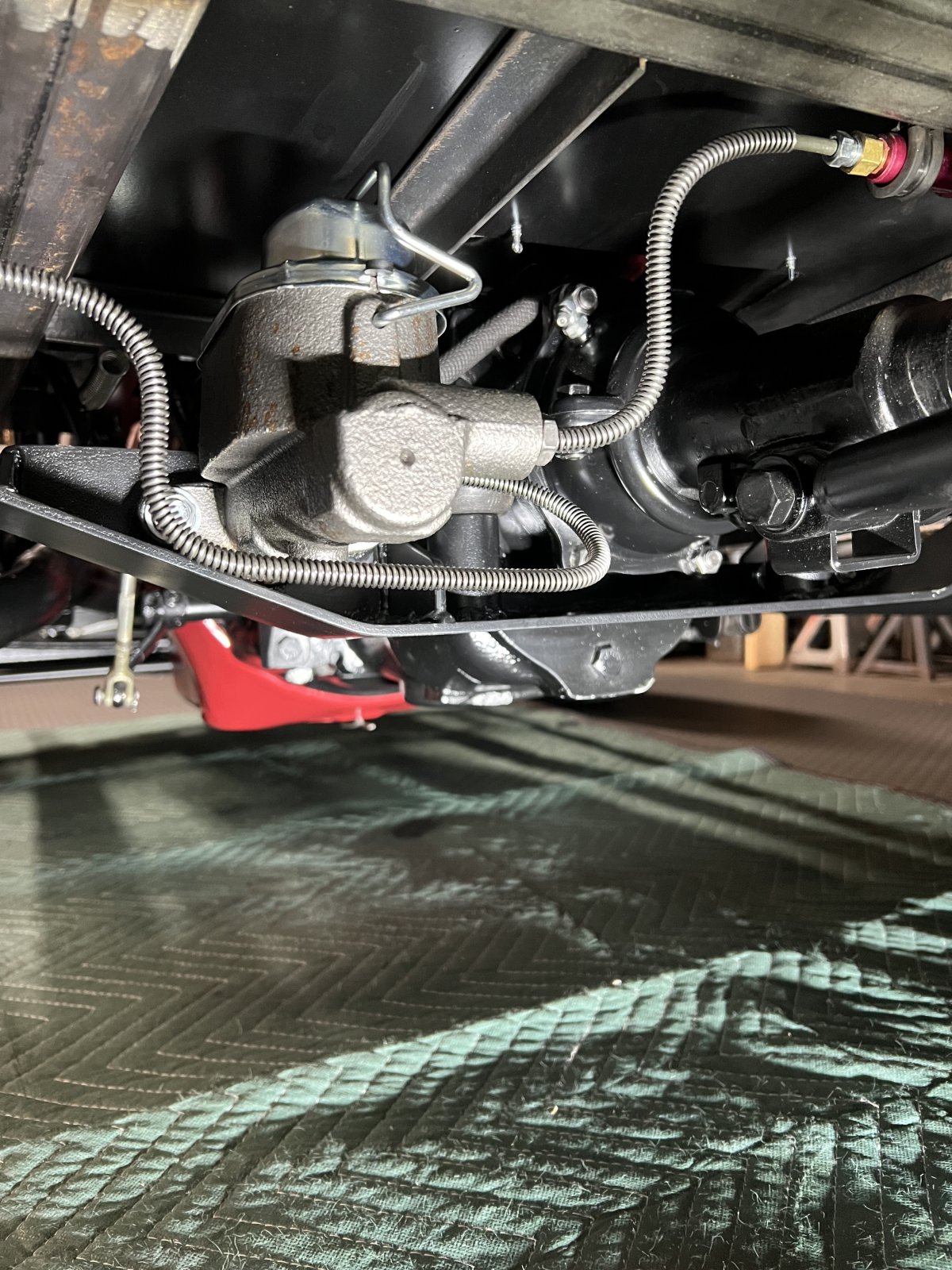

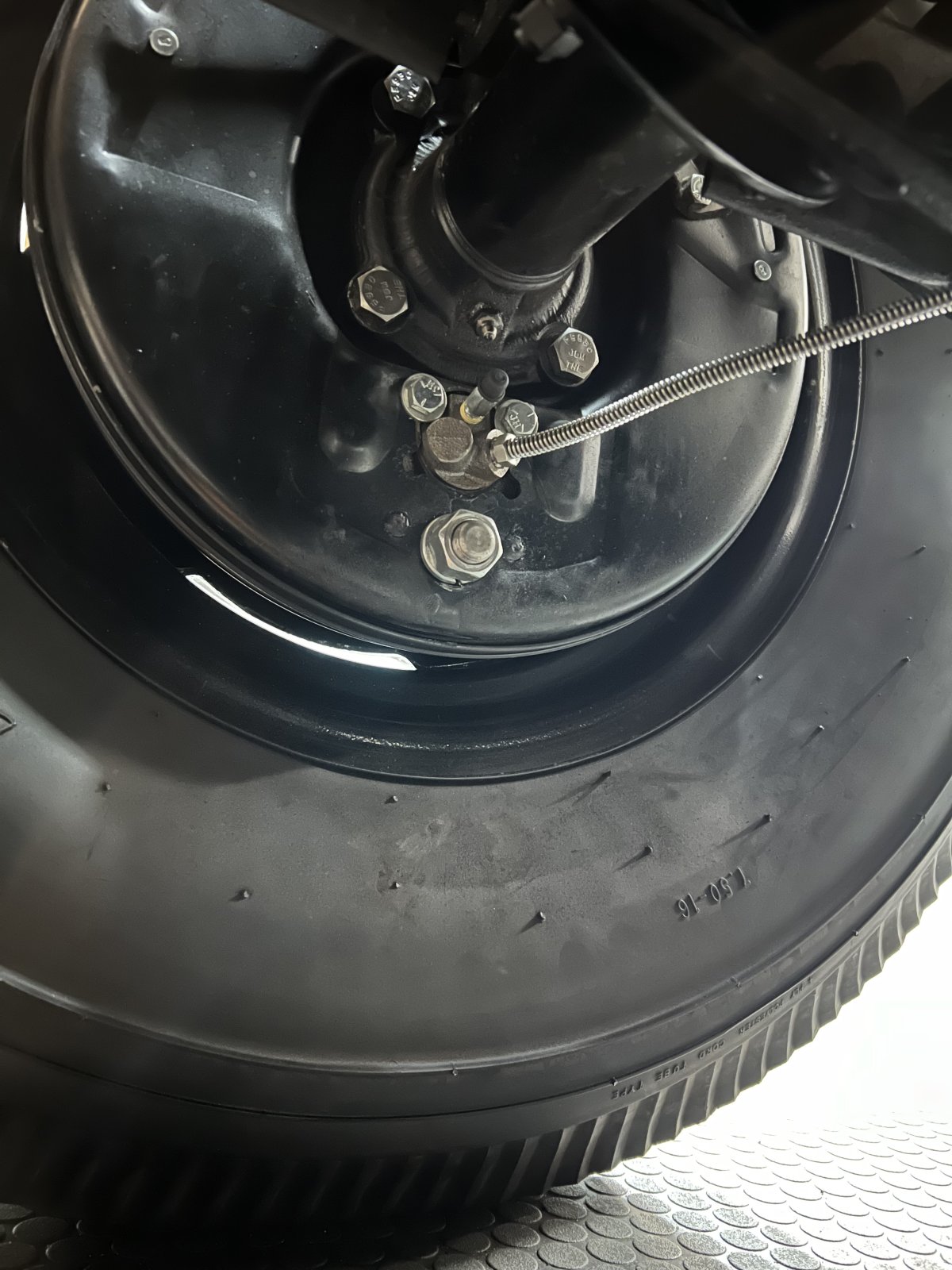

    Pictures are attached to just show if lines off master are what is causing air in system still. Rear backing plates are nothing new of what others have done when using model a rear end.

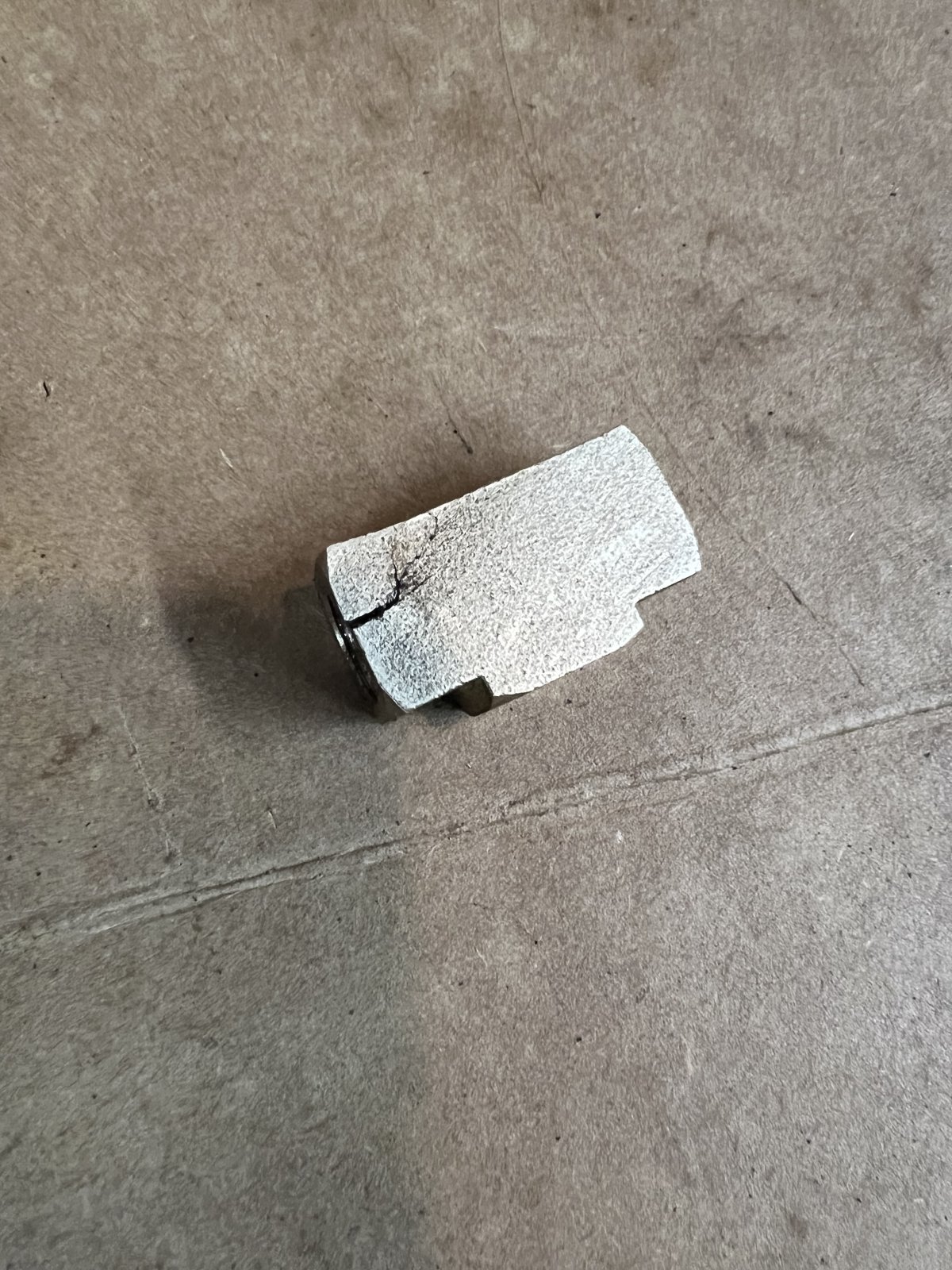

    I think I found it. Brake T fitting for fronts. At first it probably was a hair line until I gave it a little more tightening. Inspecting the flare fitting the center was not centered causing this from the start I believe. Not sure how the fronts were firm when bleeding but guessing it was just enough to let air in more than it wanted to push fluid out.
    Hopefully this is the culprit.

    That will do it.
  18. Good detective work!

    A slightly faulty flair on a brake line will pretty much do the same thing allow it to **** in air but not show a visible leak at first.
