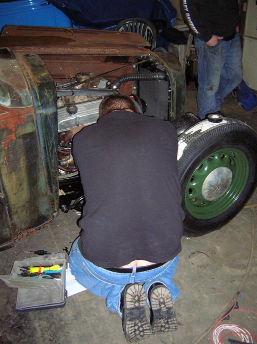

    I have had the BJ Auction on all this week and that took up a little time. Last weekend yngrodder came over and got the Sea Hag running since I am to stupid to do that on my own. Ha Ha Ha
    The whole thing is pretty much done except for glass and exhaust. I probably should have chopped it and I still may do so but not until I am happy with my progress on the Atomic punk.
    Here is a pic of yngrodder at work. I should be a professional photographer since I seem to be able to catch people's best sides.
    The Sea Hag runs awesome by the way.

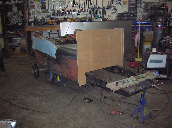

    My buddy Jim from Metalace had come over and helped me shape up the top of the cowl, but I needed to figure out where the firewall was going to curve in order to nail down the top of the shape.
    i took some cardboard and trace out the shape and folded it in half to make sure it was symmetrical and trimmed it up.

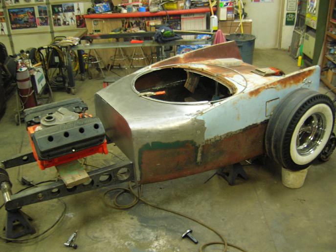

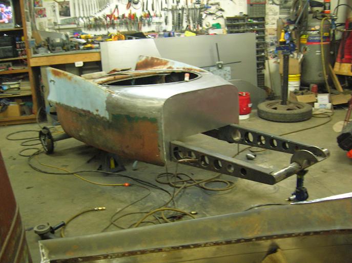

    Inkorekt came over on Saturday and we spent the majority of the day welding up his frame and rear end. I have a way of annoying my friends into working on their cars. I can be a real pain in the ass about it. Ha Ha Ha
    After that, we worked the top of the cowl into shape a liittle further on the wheel and trimmed it to fit the hole and tacked it all in.
    I spent most of the day Sunday finish welding the cowl and getting it smooth. I still have a bit of work to do on it, but it is pretty close. I am pretty pleased with how it turned out.

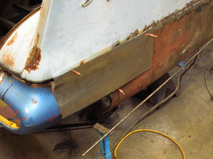

    I started to figure out the rear patches to tie the Chevy hood into the rest of the car. I got about this far when I gave it all up to go inside and lay on the couch and watch TV.
    Clecos are your friend.

    This thing gonna have a bubble on it?

    I am using my Hobart 175 on Heat setting 2 for the most part. As for my technique I don't really know how to answer that. I just weld a little at a time to prevent warpage and then use a hammer and dolly across the weld and the area next to it to stretch it back out a bit in order to use "precious little filler" as Boyd would say. Ha Ha Ha
    bubble? yes
    Zumo, yes that area is going to be covered by the tire...for the most part.
