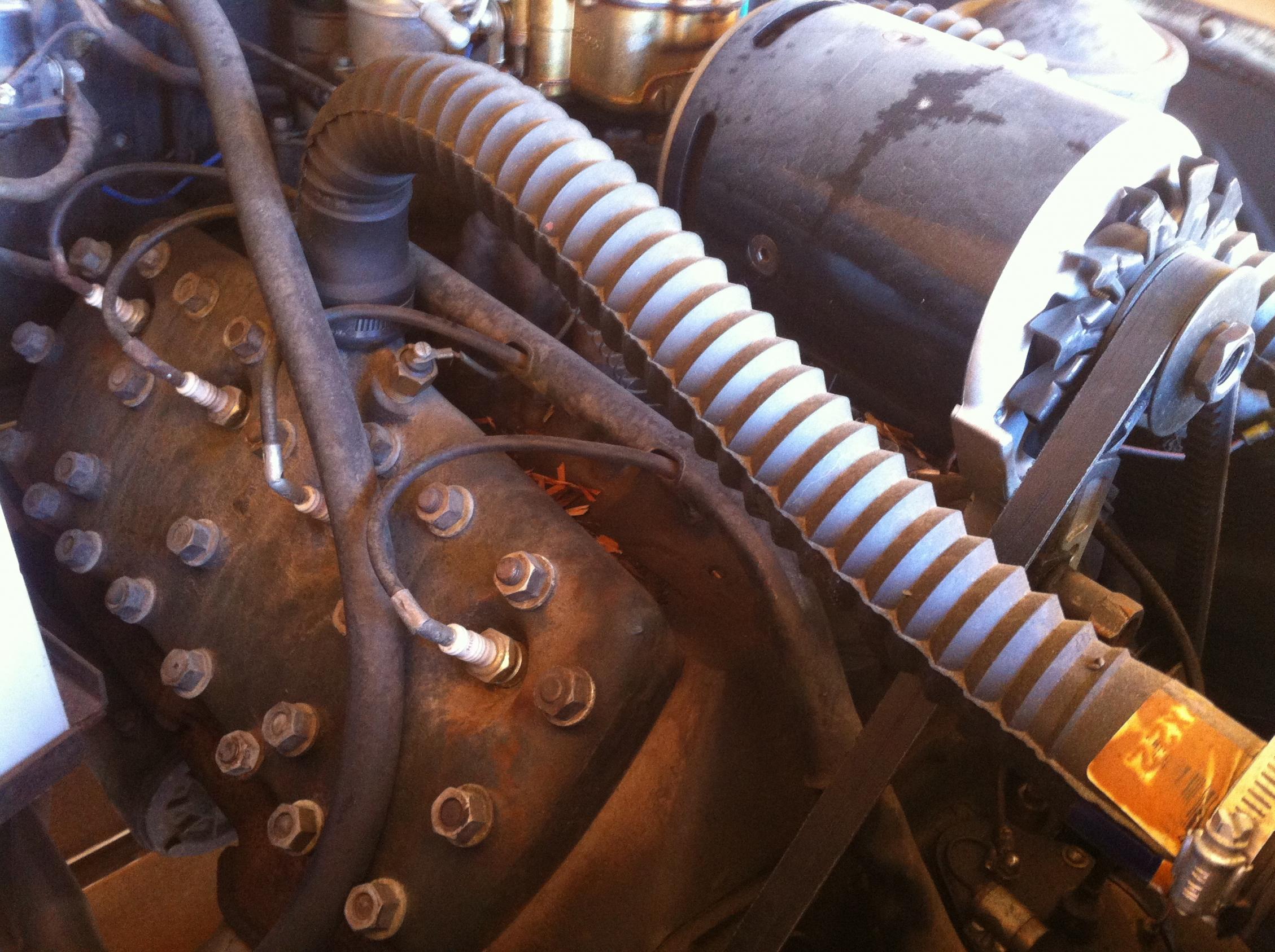

    I didn't realize a posted an altered photo. Here's the regular one
  15. 53Chuck
    Joined: Sep 19, 2011
    Posts: 47
    53Chuck
    The back side
