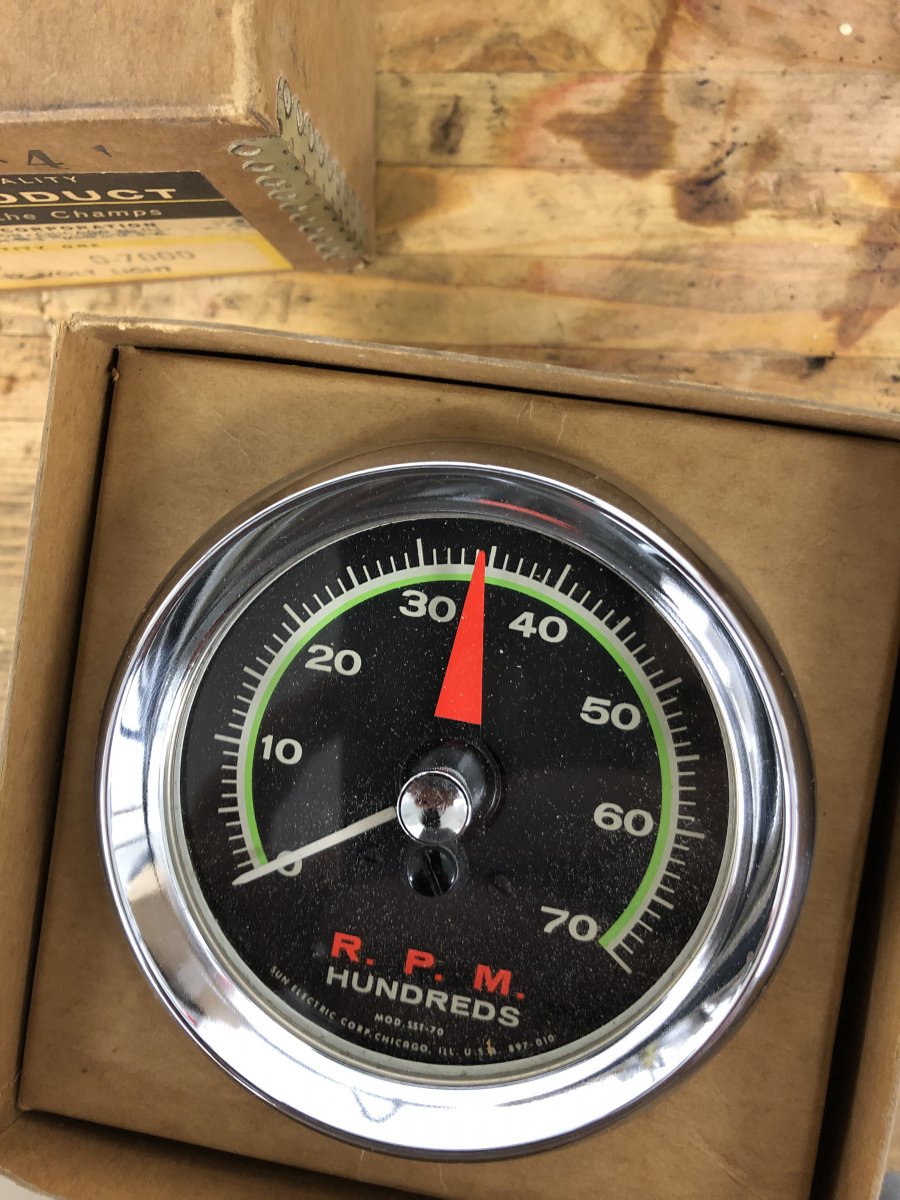

    Did this model tach ever use the transmitter box? Or was it just the earlier RC model Sun tachs?

    Take the chrome cup off it and take some picts. Most of those Suns did use the transmitter it was the best way to do it at those times.. They can be updated but you might not get it back. I had one and sent it out and never got it back.. One things for sure, those Sun gauges were the best looking gauges ever made. At night time they look so beautiful...

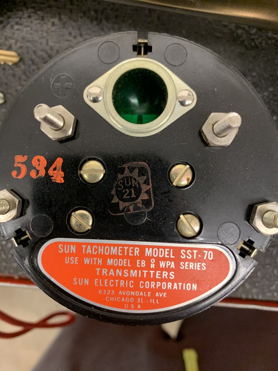

    @Aaron63Nova You seem to have the original box. What is the part number of the tach that you have? That will tell whether a transmitter is needed. From the picture you posted, it does look like that tach will require a transmitter. The old transmitters require a battery which is no longer available.

  11. squirrel
    Joined: Sep 23, 2004
    Posts: 59,805
    squirrel
    says 551-70 on the tach face (you have to do some clicking on the pic to get it big enough to read)

  16. Aaron63Nova
    Joined: Jun 6, 2018
    Posts: 29
    Aaron63Nova
    It’s the same as the far left one in the ad in your next post. This is the back. Finally took it out of the box this morning to get a pic. Suppose I could’ve done that before posting this thread and answer my own question.

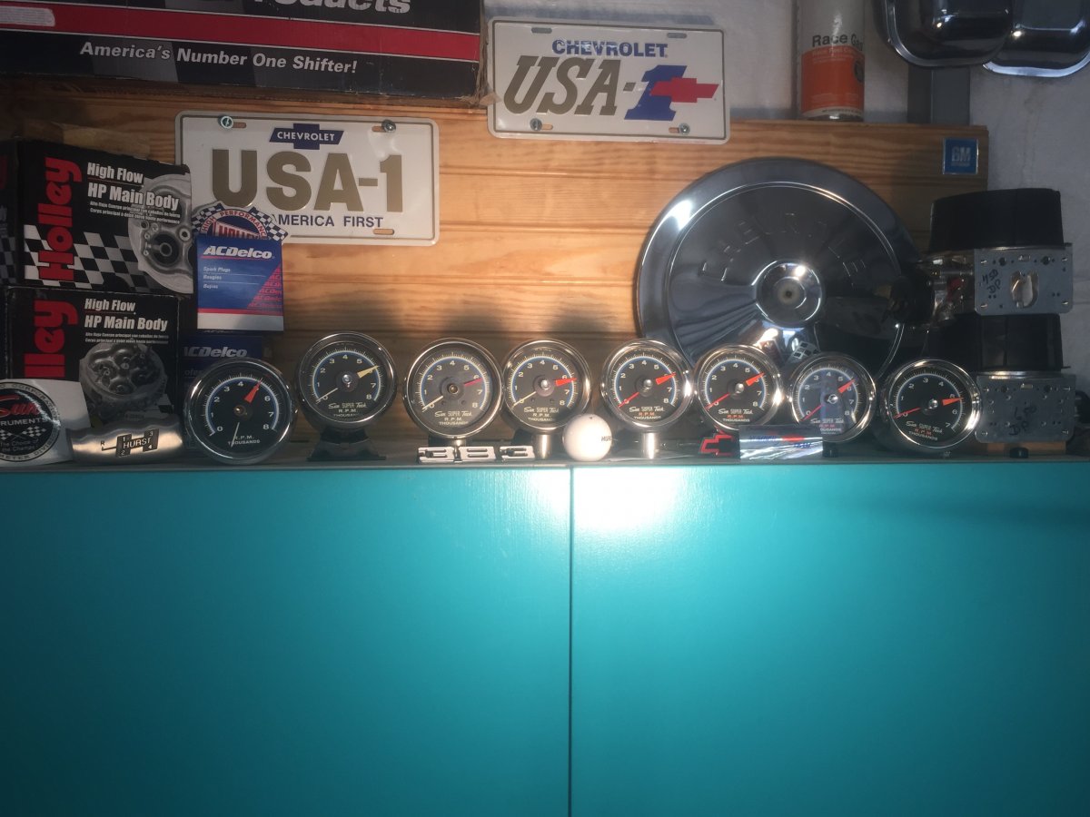

    Amen, brother !
    This begs a thread****led....
    “Show Your Sun Super Tach”
    1Nimrod likes this.
