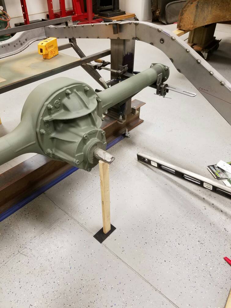

    Hey all,
    I know tri-link has been covered in multiple threads, and I have read and researched. It's enough to make your head spin, but I thought it was time to actually do something.
    So I'm out in the shop about to start the mock-up, and it occurs to me I'm unclear where the upper arm angle is measured from!
    I am planning on 7 degrees down. Is that 7 degrees in side view or along the length of the control arm?
    Thanks,
    Jeff[​IMG]

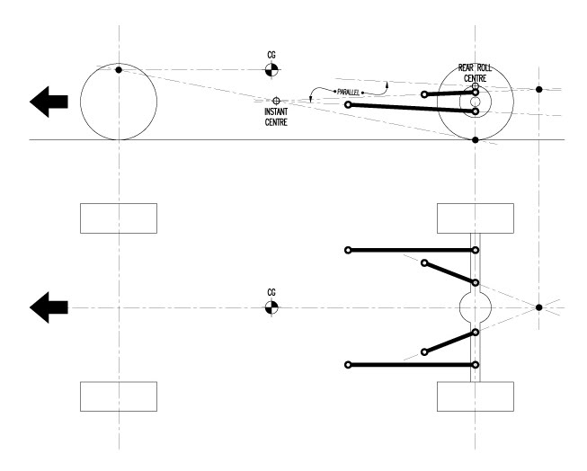

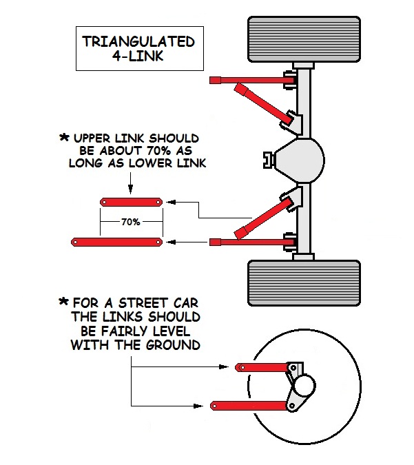

    Setting it up at ride height is the key to success. Correct pinion angle is critical and having some degree of adjustment is a bonus. Most kits leave no room for error with initial set up angles being final setup angles. Lower arms need to be set up so they are NOT pointing down towards the front

    Yup, mocked at height with correct pinion angle, will have threaded rod ends. No kit, but will not build in any other adjustability.
    I have seen these layouts before, I have copies on my computer. They contain conflicting elements, both in control arm length and angles. I think this is what makes figuring out what to do so frustrating.
    I know there is that Excel spreadsheet download that you can plug #s into. I was hoping not to dive in that deep. Maybe I'll mock it up how it works for me and plug in my #s and see.
