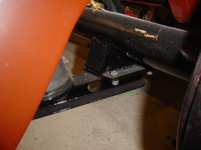

    If I might make a few suggestions, sleeve a hole with DOM tubing at the front of each arm to press in bushings and use leaf spring mount pads with a plate welded on flat to it under the axle tab with 4 holes drilled in the plate, then weld two "wings" to the back of each tube with the same bolp pattern to mount the arms...

    I was planning on the DOM in the front....at the rear I was think of what you sugested or (I've seen lots of pics with one Ubolt) I was thinking of drilling the arms in the center and welding a DOM sleeve where the U-Bolt p***es through so I dont risk the arms crushing down any. But thinking the "dogbone" idea will be better with 2 Ubolts instead of I and welding in a stiffener to prevent the arm from crushing. Thanks agian for the suggestions and ideas...

    The bushings will absorb torsional twist, stock truck arms work great...I'd stay away from u-bolts unless you have a pin or other locator so the truck arm and axle tube can't shift...

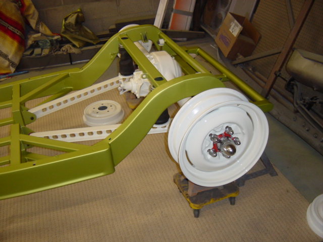

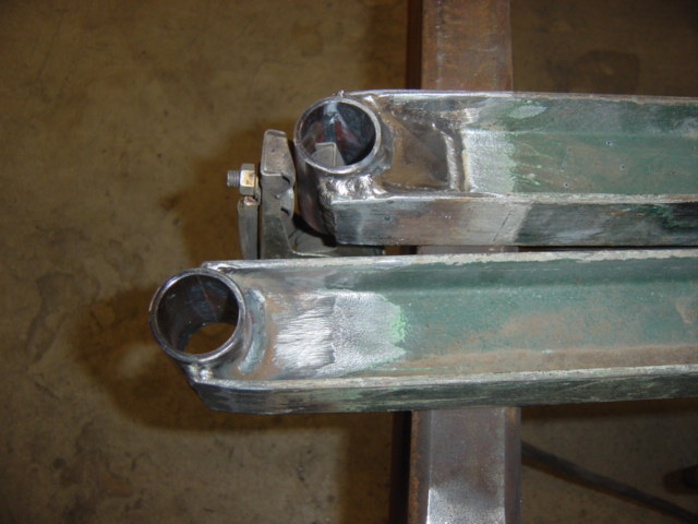

    I use I beam to make my own truck style trailing arms. It allows twist and they do twist quite a bit.

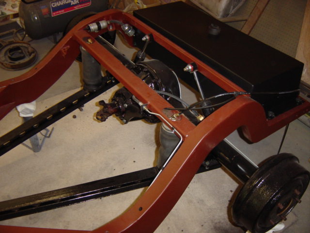

    when i built the truck i didnt have a stock ch***is at all (a friend and mentor gave me the cab and rear fenders)
    knowing i wanted trailing arm rear suspension (and air ride) the choice of a 67 chevy truck ch***is seemed logical.
    as it turns out the wheel base was very close, and the local u pull it had the ch***is sitting there bare...
    the only thing about using the 67 ch***is was that the front track width was too wide, hence the narrowed control arms

    I think the web of the beams is about 3/16".
    Jr's car (lime green coupe) had a strong 383 stroker and Jr doesn't have a light foot.:D
    I recently bought a single pair of bushings that will work at the speed shop. They were from energy suspension and were for an 80's Mustang transmision mount. I guess they are for the crossmember that holds the ******.
    Here are some of the pics I started to take in the past. Hope it holds you over till I can do a tech. Take note of the gussets at the front of the I beam.

    Thanks alot Clark...I believe a I am going to use the I beam .....
