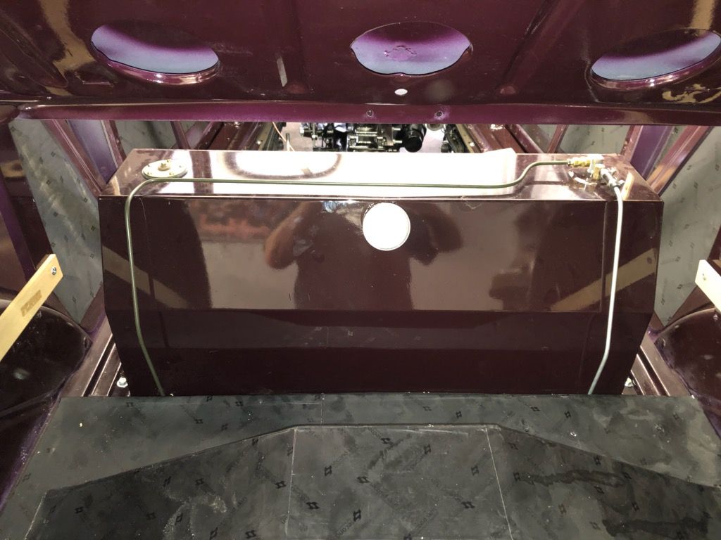

    Here is mine in the trunk of my A roadster. Tanks Inc. also. Fit well.
  21. Fitnessguy
    Joined: Sep 28, 2015
    Posts: 2,044
    Fitnessguy
    Thanks brother proud of what we built for a home shop
