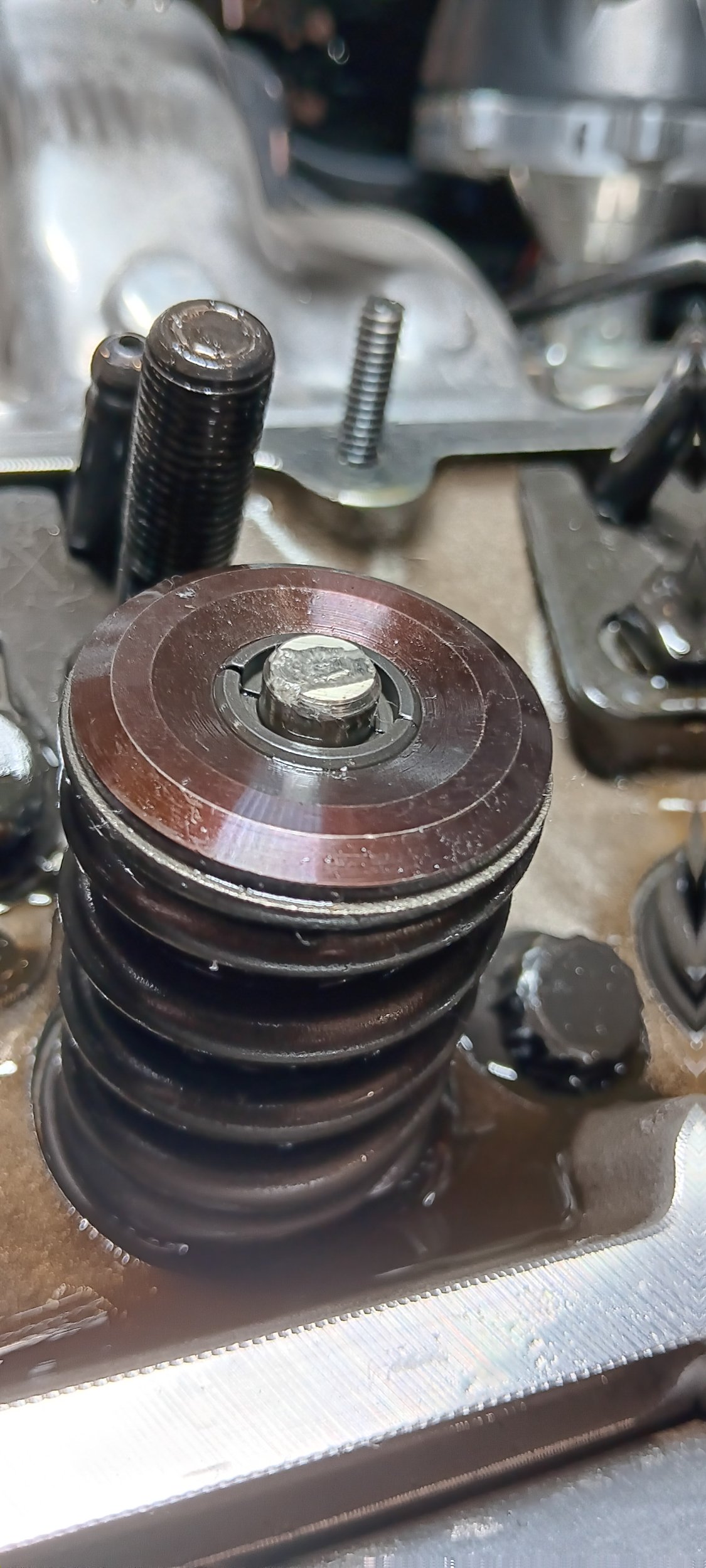

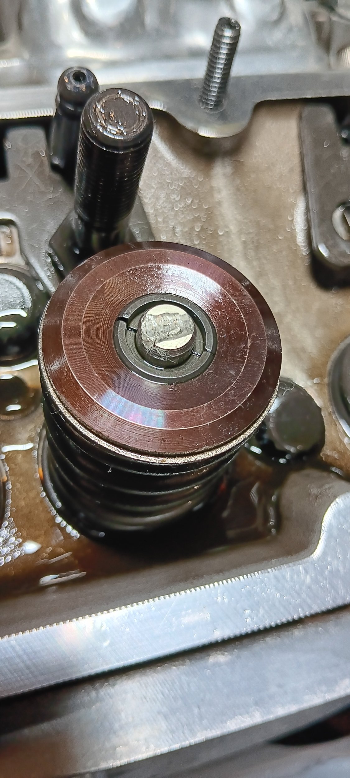

    Somebody screwed up ! fortunate it wasn't run long enough to drop a valve.

    Stuff is not adding up .
    Unless this was some very high dollar race engine or a set of high dollar race head some one got that knew nothing about , nobody that knew anything built a street SBC ( ***uming this is a street car ) with ***anium valves on a set of no name heads and then used what appear to be basic average steel retainers on this. ***anium valves are used in very high RPM race only engines and then with very light weight valve train to go with it and there generally in a set of very very expensive heads with like a 2.08 or bigger intake . Its going have a big solid roller cam and all the other expensive valve train bits to go with it . There would be zero reason to run a ***anium valve on a SBC unless its going over 7000 RPM or so and more likely 8,000 RPM . I cant recall the last time I saw ***anium valves in in a SBC like in a sprint car that did not have a shaft rocker set up and its been even longer since I saw ***anium valves in a sprint car that did not at least have stud girdle . ( Likely around 1994 or so )
    Im not sure a picture could be taken that shows less of the heads . there is a Part number on them but its not readable in the picture . It looks like what you see on cheap China casting. Almost anything worth putting a set of ***anium valves in is going to have some identify features . RHS years ago did some unmarked castings for special customers like Joe Geartie and others who built sprint car engines according to RHS ( I have a set ) but there a max effort type deal.
    Comp does not make heads to my knowledge.
    These days you can get 7/16' studs and adjustable guide plates and everting shown in that pic on a set of $1200 ebay heads that have intake valves that are like $80 a set or less in other words cheap **** . If the owner had the engine built or knows any of the details he's going to know if he paid for ***anium valves on what would be about a $4000 set of heads likely. Is it possible some one bought a set of old race heads at a swap meet and slapped them on not knowing ?? Sure . I have a couple sets of who know what was done on them heads. but the the valve spring diameter is m***ive and you would know there not some cheap no name Ebay or Speed Master or even Blueprint type stuff .
    ***anium valves need lash caps and there for a high RPM short life race engine .
    Same with ***anium retainers that wear out as well as keepers , the best lighter weight street able retainers are the thinner lighter weight tool steel retainers .
    ***anium is not magnetic so unless they have a built in steel cap or tip a magnet should not stick to them and that would be the first test . Pull the springs and stick a magnet on the stem .
    My guess if this is not a roller cam is you have a lobe going flat that lead to valve clearance and then the rockers hammering on the valves and there a cheap valve .
    you have metal in the engine at least from the wear on the valves and rockers Id be cutting the filter apart minimum . Id pull the heads and replace the valves minimum and the rockers are junk . get a good pick of the part number.
    the intake sealing area and how its shaped can also help sort out the brand of heads as can if there is extra holes for a Vortec intake once the manifold is off .
    Also check for a bent push rod that would have added clearance and caused hammering .
    What's the history of the engine, how long ago was it built and by whom?
    Older aluminum race heads have numbers stamped not done with little dots.
    like you see with newer heads like on the blue prints and Speed master and such .
    generally is there a high quality head then the company is proud enough to mark them some how .
    MY guess is cheap heads and cheap valves and maybe a cam issue .

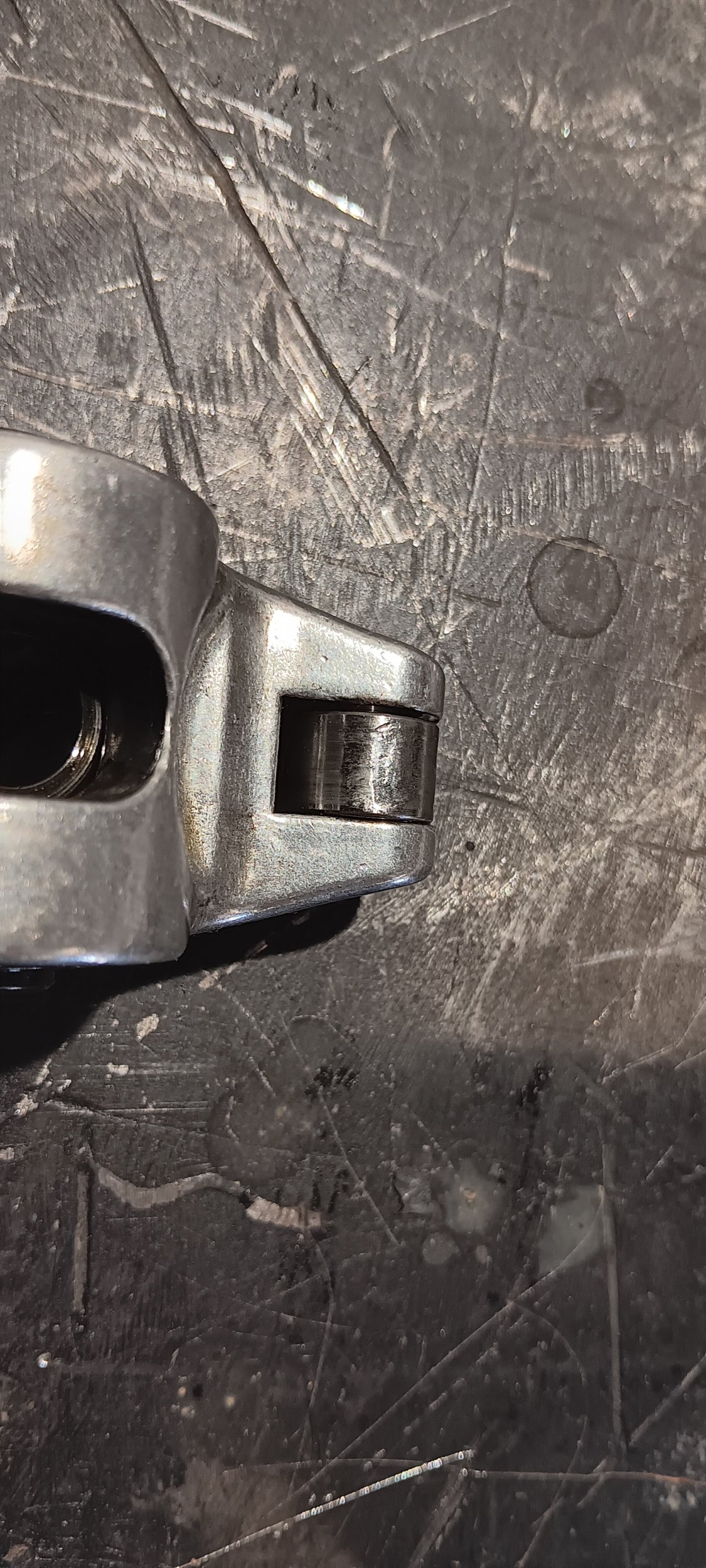

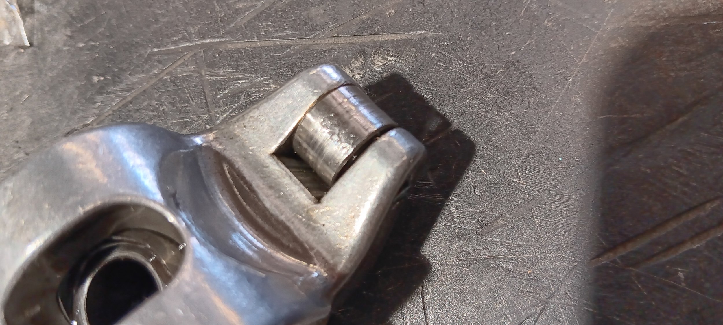

  10. jimmy six
    Joined: Mar 21, 2006
    Posts: 18,036
    jimmy six
    New rocker arm, push rod and a lash cap and be right down the road in 30 minutes..

    Has anyone mentioned the pushrod tip condition as yet?
    It definitely looks like there's a lubrication problem and the center hole appears to be possibly blocked/restricted.
    We used to have this happen on our race SBC up until when we started applying ***embly lube to the pushrod tip prior to our first start-up for the day.

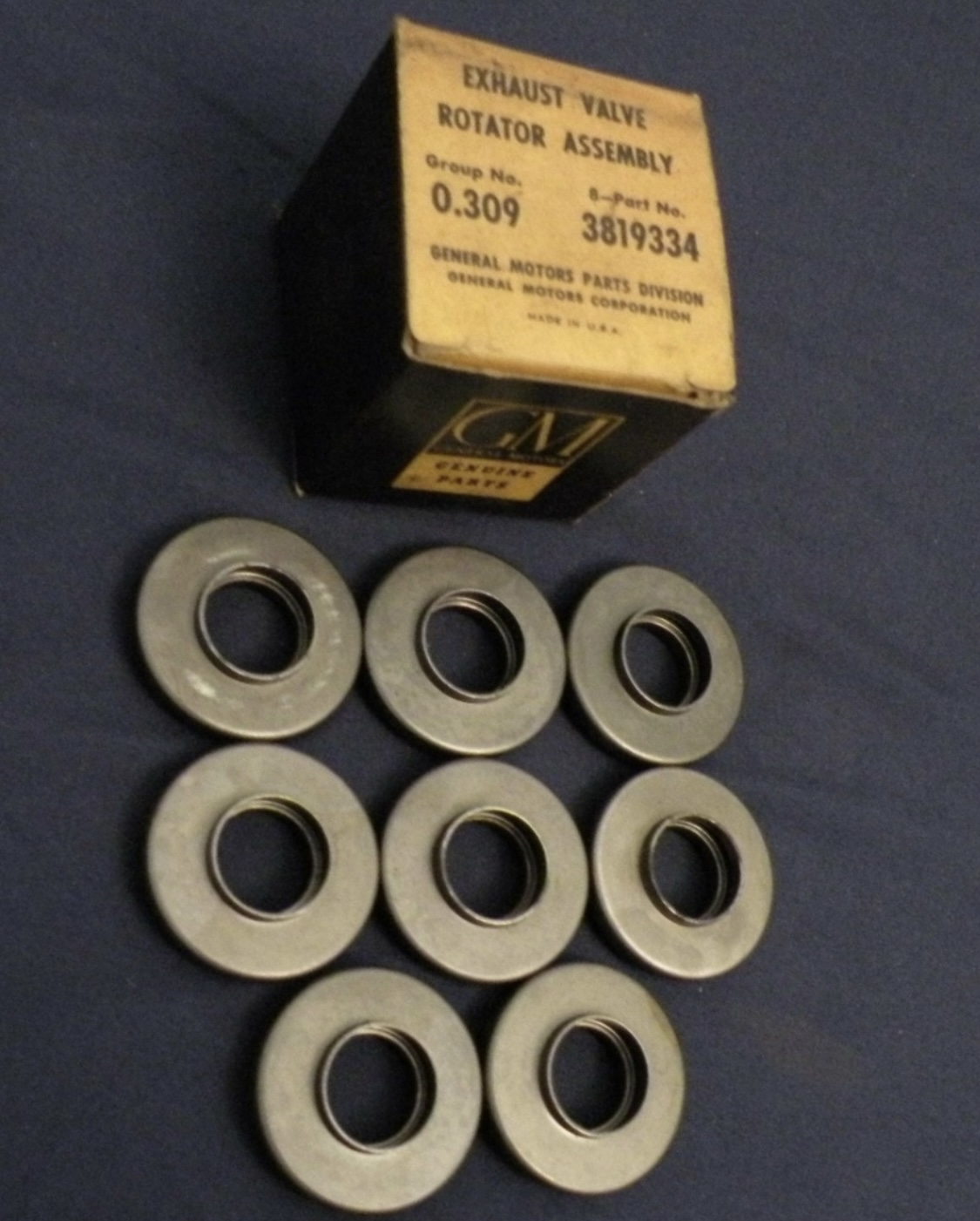

    Valves that rotate????? Never heard of such a thing? How would the keepers stay in place if they rotated?
    As for lash caps, it might fix the bad end of the valves, but still need new rockers. And then there's the question of where are all those little pieces of metal that chipped off those valve stems at now? How long before they eat up bearings? And what about the oiling issues? New lash caps might get eaten up quickly if the oiling isn't better to protect them.
  18. Johnny Gee
    Joined: Dec 3, 2009
    Posts: 14,998
    Johnny Gee
    from Downey, Ca
    This is how. They set in the spring pocket of the head (exhaust only). Really not used in modified engines. IMG_4304.jpeg
    GuyW, warbird1 and anthony myrick like this.

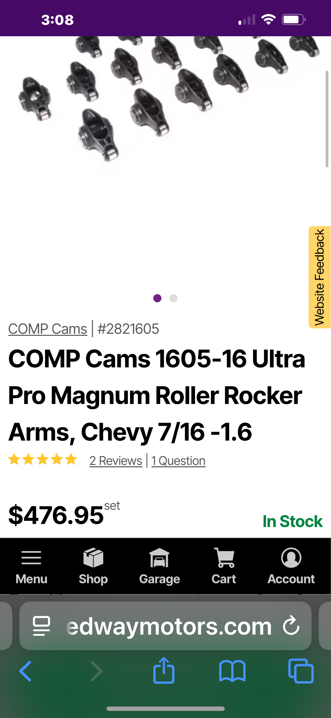

    Just looking around ,
    Entry level decent full rollers rocker
    Are $500 up Now
    Billet & Chromoly
  24. wheeltramp brian
    Joined: Jun 11, 2010
    Posts: 3,541
    wheeltramp brian
    The place that built the motor Skip White, recommended scorpion Rockers as that's what they use now. About 450 a set.
  25. 19Eddy30
    Joined: Mar 27, 2011
    Posts: 5,141
    19Eddy30
    from VA
    Skip white , Tennessee ?
    If so things do not look right ,
    Like parts where miss matched changed around after leaving S-W,
    I see cheap parts being sold in 632 bbc's
    Not my $$
    I think this a better choice
    Pro Magnums ,
    I have turned over 7,000 rpms
    On 220 seat pressure , iffy up there .
    Harlan and Sharps unless The quality has went down in the last 25 years
    Scorpion Rockers is cheap rocker
    Unless there another Scorpion,
    Seem to remember counterfeit made.
