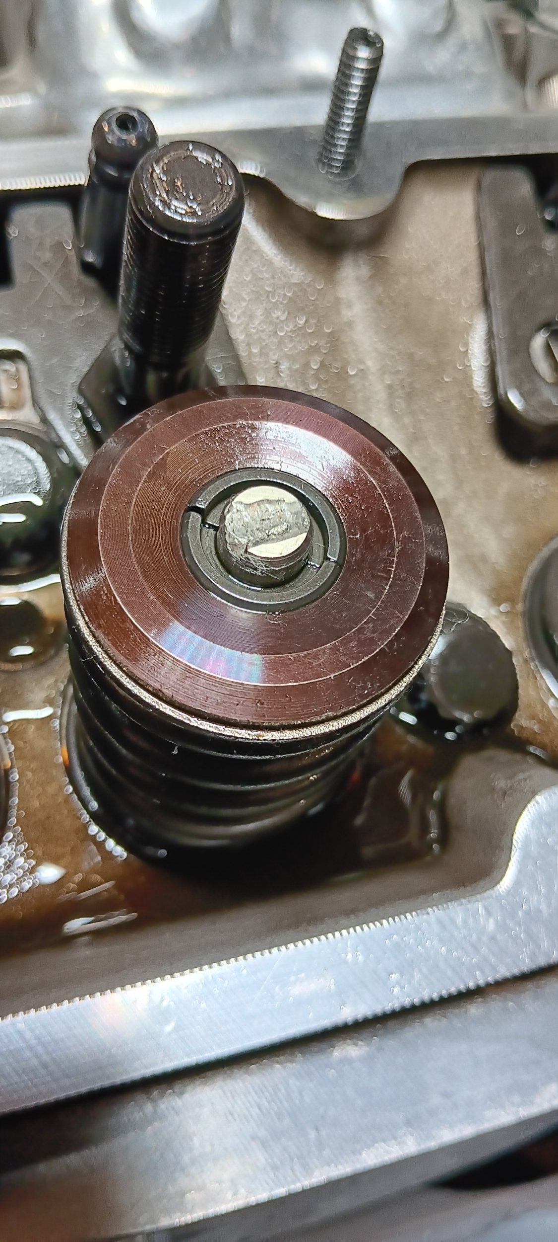

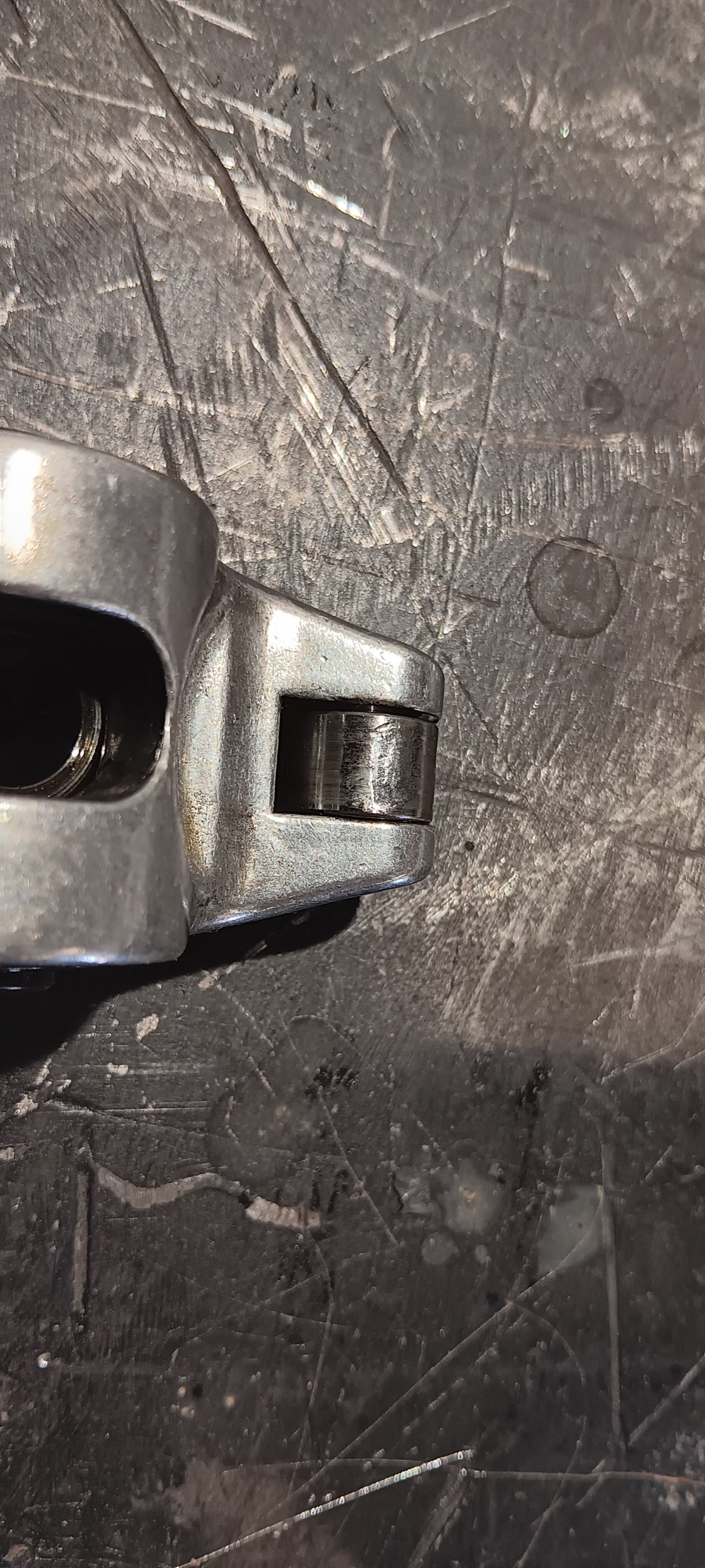

    My friend wants to put the valve caps,new pushrods, and rockers on,its up to him. I'd probably do the same too.parts will be in tomorrow, and I'll report back

    Best of luck, @wheeltramp brian
    Please make sure your friend understands this is a patch, not a freshen or rebuild!

    Sorry to say this but a lot of red flags being are ignored with this one. :eek:

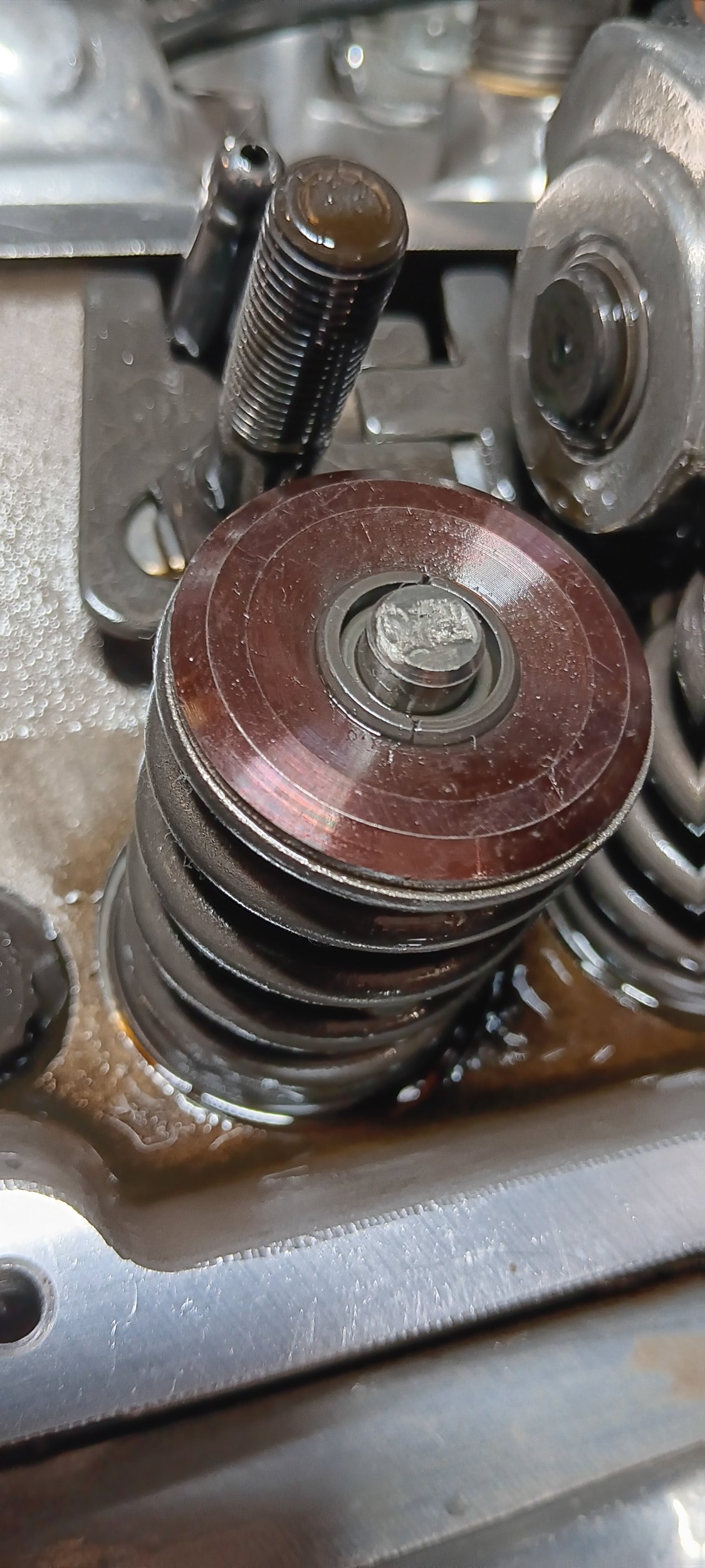

    Growing up in my uncles machine/race shop and still building engines 45 years later, and employed at GE (circa 1991) where we get to see ALL types of metal and NDT testing and see some things destruct on their own demise.... i see 3 things and there mentioned above..... 1) lubrication...2) material hardess/compatability 3) most obvious in 1st pic is misalighnment of the rocker stud and the valve guide...The wear pattern shows their not parallel... Probably very common of the M*** produced chinky junk.... JMO

    to answer some questions. oil pressure is great,runs great with plenty of power, A couple of rockers were crooked because of the adjustable guide plates that I will loosen the studs and move them So they line up correctly on the valve tip. I did drain the oil and maybe I'll cut the filter open today.If I still have it I may have thrown it out. I did find a couple noticeable metal shavings on the driver's side head where the oil pools up near the back.

    No noticeable loose ones but Exhaust rocker arm on Cyl. #2 was extremely crooked and ran off the tip on the valve stem. Chewed up the rocker roller and some of the tip of the valve stem.

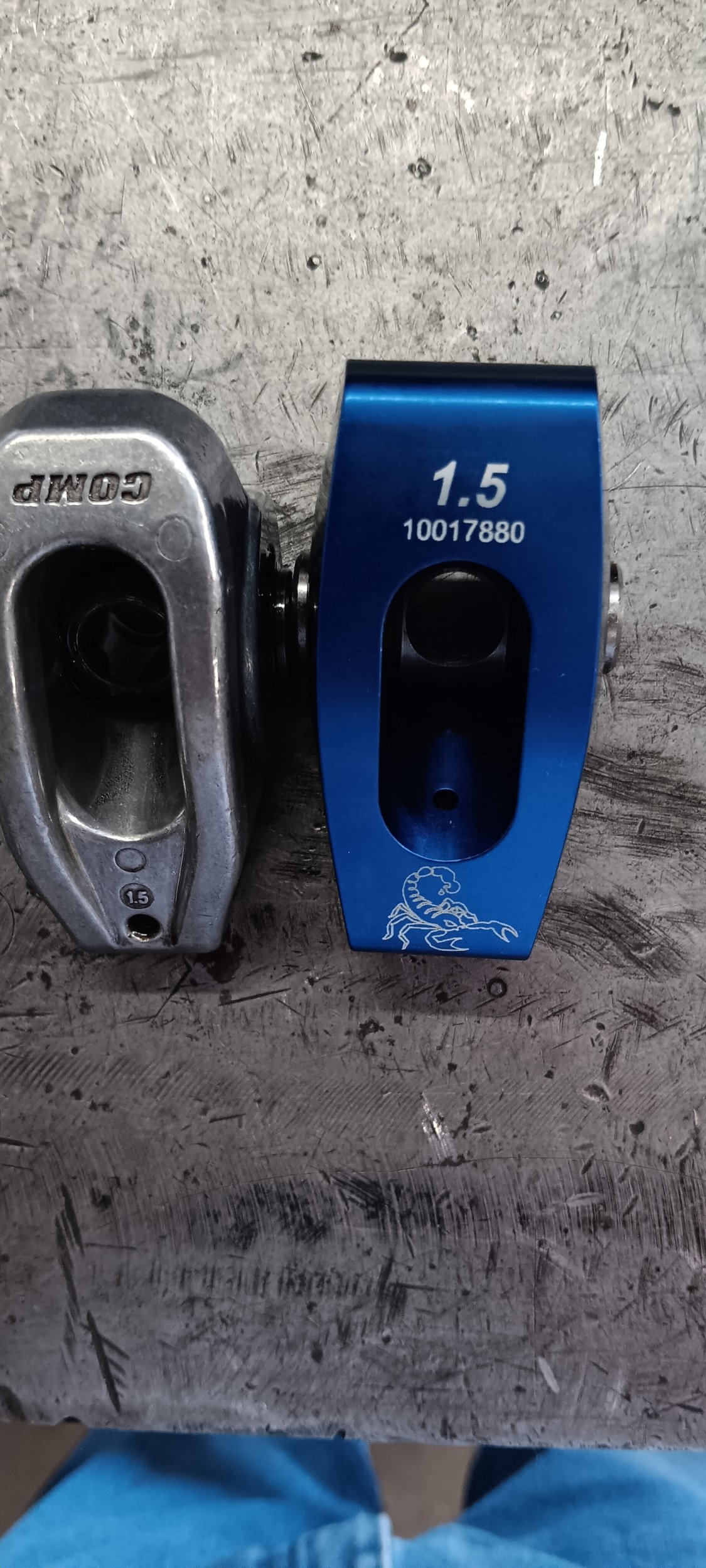

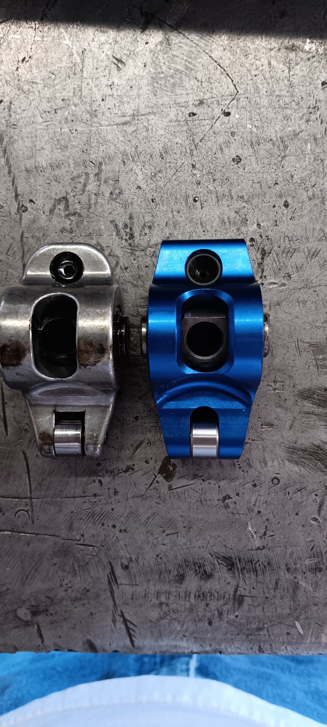

    Cut the oil filter open and didn't see anything alarming. What I did notice is that the paper inside the filter was hard I figured it would be soft being covered In oil. Was a wix filter. I got all the new parts installed and it's quiet and runs good. It's 95° in the shop.I think I'll get out of here 20250711_152330.jpg 20250711_143417.jpg 20250711_112109.jpg 20250711_102519.jpg 20250711_102537.jpg
