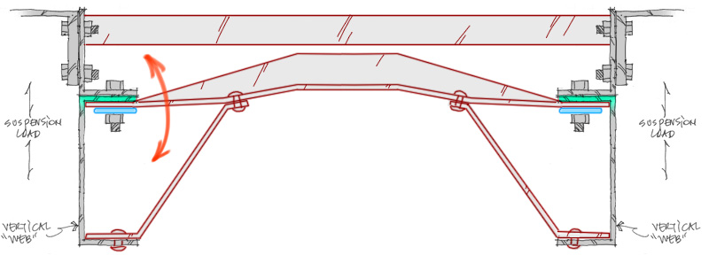

    OK, I'll do the listening now. :) What basic principals am I missing? I need to know, this is cool stuff! ;)
    How does your design take the basic principal of frame flex into account? Those cross-braces seem to add rigidity....to members attached to a flexible frame. Shouldn't all 4 points remain independent, so they can move when the frame flexes? Otherwise, something will give.....the bolts, or the frame....I think. No?

    i think I might understand voodo's concern, which is also mine.
    Instead of the load now being on the SIDE of the frame, in the C channel area as it was designed. now the load is on the TOP of the frame, that area would be more prone to failure, but adding a plate to compete the BOX of the frame in that general area would help to stiffen that top area of the frame.
    Not sure if that was his concern really, but thats the only part that scares me.

    yeah i too thought partial boxing plates along the inside of the ch***is rails would be good but pretty complicated with the original Xmembers there and quite prob wouldn't gain much....plus partial boxing plates can generate there own issues.

    I'm not an engineer, but from what I've understood* about old truck ch***is' is ....
    They were designed to flex & move around, then rebound to their built position.All of the components attached to them were designed with this in mind.
    Anything that you do to TAKE OUT flex at some point, will add stress to the other 'still-flexing' parts, in the form of metal fatigue/cracking,
    Often at joints to crossmembers or bolt/rivet holes.
    This is why we see failures next to a partial boxing plate, not at the boxing plate.
    As long as your design allows you (and future owners who might hold you liable) to inspect for signs of this stress, It's all good!

    Alright, I'm not here to explain how my design takes "the basic principal of frame flex" into account. Frankly I feel like you're avoiding my question about your initial concern so I'll ask it again.
    Please take a look at this picture of my frame based on your drawing.
    I have added the parts that are in your words inconsequential. These parts are outlined in red. Now tell me exactly how the "suspension load" is going to move those upper flanges – which are highlighted in green – in the way you described (indicated by the orange arrow) with your "piece of tin" example.

    Kevin, unless your gona be carting lots of heavy stuff with your truck and/or traversing rough terrain and/or travel tight winding mountain roads on a regular basis ....theres absolutely no issue with your set up .
    After lots and lots of road miles its poss you maaaay get a couple fatigue cracks...but i'd bet not on the upper flanges of the rails..lookin forward to seeing how you remount your deck.I may do mine in similar fashion to how you've done yours.

    Nice job on the drawing Kevin, I like that! To your question: the frame rails will flex due to irregularities in the road surface, they will not remain parallel to each other (that crossmember only exists at the front hangers, not at the rear where most of the frame flex will occur). The welded ***emblies are rigid, so when the rails go out of parallel due to frame flex, a bending force will be placed into that top flange much like my tin example.
    Back to the primary concern though, the original suspension attached to the vertical web of the C frame, which is quite strong and resists bending and shock forces much more so than the small horizontal flange that you are now attached to. That would be my primary concern, which is why I recommended that you somehow tie the angle iron into the vertical web. If one of those flanges cracks (60 year old metal, which you found corrosion on?), someone is in for one heck of a rough landing.

    I read his concern completely different than he or you illustrated. I was thinking about a vertical plate that ties the vertical web to the new piece that you added above the frame to prevent those two seperating.
    Not questioning your design it looks really strong I just enjoy good discussion about these types of things and learn from them.

    Yes, that is what I was recommending. Tying the new angle iron to the vertical face of the Ford frame. And I would remove the tube that ties each side together, to prevent the "lever action" when the frame flexes. Let the frame flex all it wants.

    Sorry man, you're just wrong.
    First, there is another crossmember at the back mounts which performs the same function. And where are you getting "that is where most of the frame flex will occur" in the first place? It reads like you're just making that up because you didn't see the crossmember back there.
    You're talking like these frames are just flexing all over the place several inches at a time with every tiny bump. They don't.
    And you're singling out this top flange like it's hanging out in the breeze bearing the entire weight of my truck. It isn't.
    I've been hinting at triangulation over several posts but you're not picking up on it. Even your suggested fix fails to really correct your own concern... which is actually nonexistent anyway.
    So I'm done now. And no hard feelings – you can all continue to armchair this thing to death. I'm convinced a few of you don't really understand how things work.

    "And you're singling out this top flange like it's hanging out in the breeze bearing the entire weight of my truck. It isn't."
    So, if the weight of the back half of the truck isn't on the top flange where is it?
    My point, your design has the truck suspended off from the top flange of the frame, maybe 2 inches wide at the top of the C, it was designed to hold the weight from the vertical part of the C about 5-6 inches thick and in the middle of the C.
    Why not finish boxing the frame, or as suggested, maybe add a plate onto the vertical part of the frame to SHARE the load along more than the top flange of the frame?
    Maybe your top of frame mount will be fine, but when its OBVIOUS that youre suspending the truck from a much smaller piece of the frame than it was designed to be attached to why not add in some help?
    Open your blinders and see what we are trying to say.

    I understand how it works perfectly. When the frame flexes, the 2 rails change planes (go out of parallel) the most at the far rear. So the deflection is greatest at the rear hangers. Yes the top flange of your frame IS suspending the entire rear weight of your truck. If we can't get past these basic facts, then you are right, there is no point in continuing to discuss this because that's where this all begins. No hard feelings at all.

    Q: did you grind the heads of the rivets on the top flanges down flush where you put your new angle brackets ?... to allow them to sit right down on the rail..
