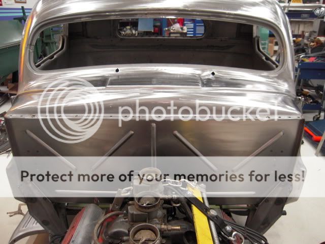

    Next he works on the firewall. He thinks it's easier to make a new firewall rather than to modify the original one. Easy for him to say!!! First he draws it out on the computer.
    Next he punches it out on his computerized punch.
    Here's the completed firewall and in place ready to spot weld in.

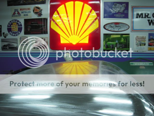

    Here's just a couple random shots. Check out the reflection on the roof of the shell sign on the wall. It shows how straight it is.
