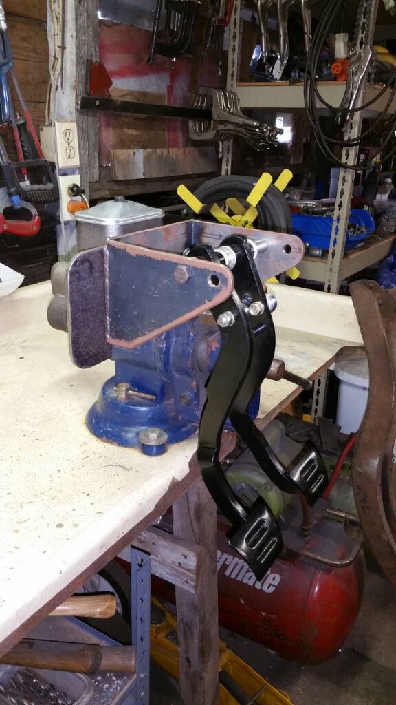

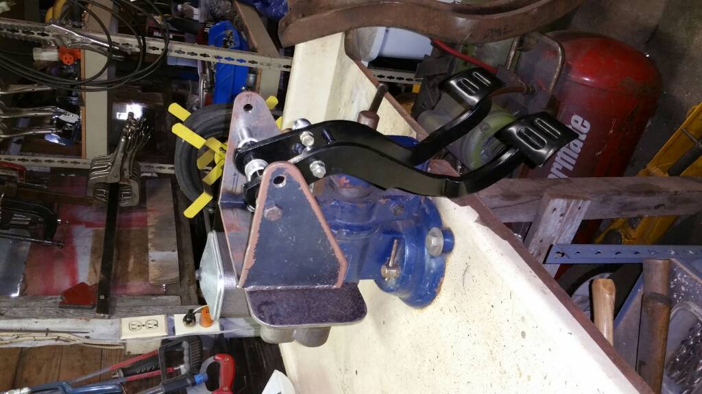

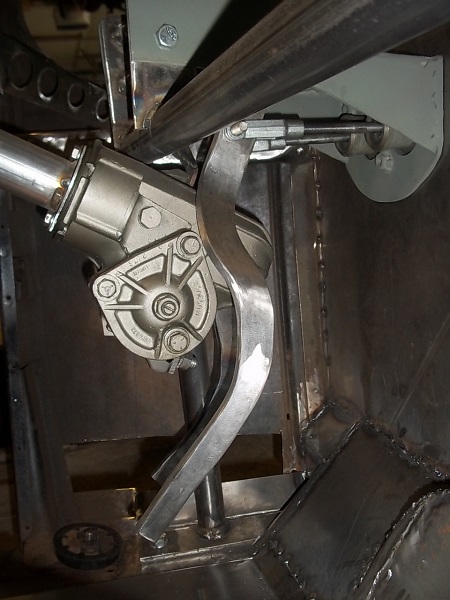

    20160219_165509.jpg So I built a set of Ansen style swing pedals to use the 60-62 chevy clutch/master cylinder combo. My problem is that getting a 6:1 pedal ratio that can perform a full stroke of the master cylinder bore puts the pedal pads 12" or so from the firewall where the ***embly mounts.
    Does this seem typical for swing pedals?
    It only leaves 11" from the pedals to the front of the seat. Which would be damn near impossibly to drive. From pictures I've viewed of others seem to have less distance and a shorter stroke.
    Do people build or use swing pedals that could bottom out on the firewall before actually reaching the full stroke of the master? Im at a loss here
    Please ignore the area that kicks forward. It will be cut straight down to save a few inches.

    Those are awfully long pedals !
    dave

    You can reduce the ratio some, it will just make a little more muscle required to operate. Chances are you are stopping a lighter vehicle, so the increased effort will be offset by the lighter weight.

    After the bend at the bottom is cut off they are 14 inches long. Does anyone have a functioning set they can measuse the pedal length for me? Say from the pivot to the pad and pivot to firewall.

    Take a look at Hot Rod Pro's thread on building his 5 window. He uses longer pedals than the standard Ansen and he's done this before so I ***ume it works as he's a big dude and needs room to maneuver.

    I dont doubt that it would function properly. Im having space problems and I dont have any physical pedals to reference. I think my 36 cab is smaller inside then a 5w or model A. I want to try my hardest to avoid going to an automatic but I need to have something i can actually drive.

    As far as the ansen drawing, mine is very close. My pivot is 5" from firewall not 3 3/4 and my pedal length is 14" not 12 7/8. The master cylinder i have has very close to a 1 3/4" stroke to bottom out. I have a 5.9:1 ratio which takes 10.5" of swing to fully depress. Adding in the width of the pedal arm and pad it just keeps coming closer to my seat. I have roughly 24" from the firewall to the front of my seat.
    Is this just too small of a space?
    What kind of leg room are you guys working with?

    RodNoc, if I'm understanding what you wrote correctly, you're figuring pedal ratio wrong. It's not how far from the firewall the pivot point is. It's how far from pivot point of the pedal ***embly to the master cyl. rod pivot point. You have way more than a 5.9 to 1 ratio there. Just guessing that to be about 2" that would give you 7 to 1 ratio.

    The pivot to the push rod is 2.375" and my pedal is 14" from the pivot to the pad. That should make for 1:5.894. A 1.75" stroke at the pushrod to bottom out the master multiplied by 5.894 gives me 10.3 which is really close to the real world swing of the actual pedal.
    The more I look at it I think I can build a recess in the firewall for the pedal arms to swing into. That should gain 3.5-4" and thin the width of the pedal a bit to change when it will contact the firewall also. Maybe a new or modified seat to get more leg room.
    It should be possible, but it has to be a little comfortable

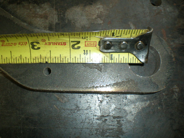

    Here are a couple of pictures of some pieces I made that are a direct copy of a set of Ansen pedals. We have put quite a few sets of these type pedals in As, '32s and '34s, without any swing problems. Tightest was in a '34 truck with a flat firewall; but that still worked OK. From your measurements, it still seems your pedal is too long, that couple inches will add quite a bit of travel if you consider both directions (depressed and released) of motion.

    So Rich B it looks like from your measurements that you would have a roughly 5:1 pedal ratio. Ive been trying to stay as close to 6:1 as possible from what I've read on the hamb but I have no actual experience with this setup.
    I suppose the image is deceiving because of the angle. The top pivot is only 14" away from the pedal pad. Unfortunately the math just isnt in my favor with this short cab.
    Unless when people set there pedals up they only are concerned with the usable throw and not with being able to fully bottom out M/C

    You always need to set the pedals up for full travel, which you will need most of for the clutch anyway. Concerning the higher pedal ratio, I never heard any mention of excessive pedal pressure problems on any of the pedal set-ups we used. I have a single hanging pedal built to these dimensions in my roadster pushing a '40 style master, the pedal pressure is pretty easy.

    Thats good to know. Armed with that info I can alter the overall pedal length, pushrod mounts and length and most likely the pivot point as well.
    There may be hope yet.

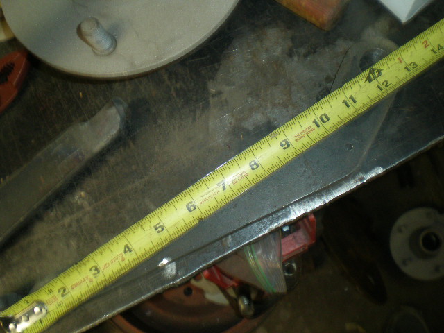

    I measured my set up this afternoon. The set back from the firewall to the center of the pivot is 5 5/8, arms are 16 inches overall to the center of the pivot, 13 1/2 to the center of the yokes and the ends are 11 inches to the firewall. Best I could do in my application with the cowl setup. Still some tweeking to do as far as final alignment but they should work out fine. Shot some pics to give you a visual:
    I based my design on a 64 Chev brake pedal ***embly and robbed some parts from it for the ***embly fwiw.

    As for size I bet mine is comparable to that. Then imagine if the front of the seat was 12" from the pedals. Pretty cramped.
    I think im going to try and bring my pivot in to 3 3/4" as opposed to 5" from the firewall and reduce my pedal length down to 11 1/2" from 14". That should gain 3-4" and maybe a small pocket for the pedals to swing into at the bottom of the firewall should gain a few more.
    Probably going to be a few days before I can get out to the garage but I greatly appreciate everyone's guidance and input. When I find a successful combination I will post it.

    3 3/4 is about where I started with my first design built out of glued up cardboard. I made several attempts at arms in cardboard to get the travel thing to work all to no avail. Now my only choice would be to shorten the arms slightly when we get to that point with the seat and my big *** (6'1")in the car!

    Here are my redesigned pedal ***embly. They now use 70-71 camaro pedals which are 12.5" long.[​IMG]
    I have also decided to make room in the firewall for the pedals to swing into. Like the stock firewall had before I changed it.[​IMG]
    I just love doing things over because of my inexperience. I should gain 4" or so of leg room this way.

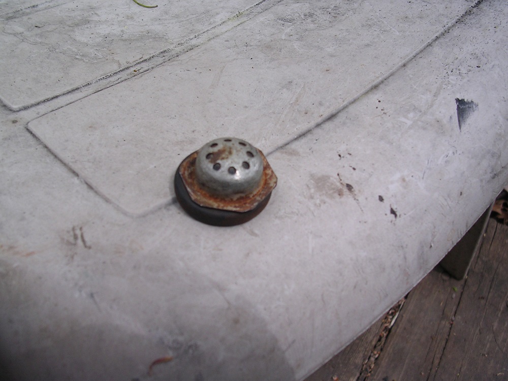

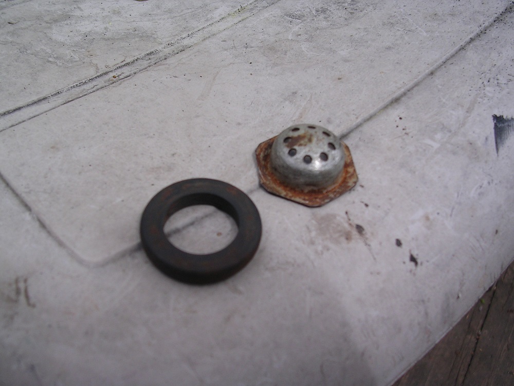

    Here are the two parts of the residual valve that will be in the brake bore, not the clutch.
    The black washer is rubber, and it is the seat for the metal residual valve. The rubber washer is the first thing put into an empty bore; it sits flat in the deep end of the bore.
    the valve sits on the washer as shown.
    then the long spring fits onto that dome part of the valve. you can see the rust mark where the spring sits.

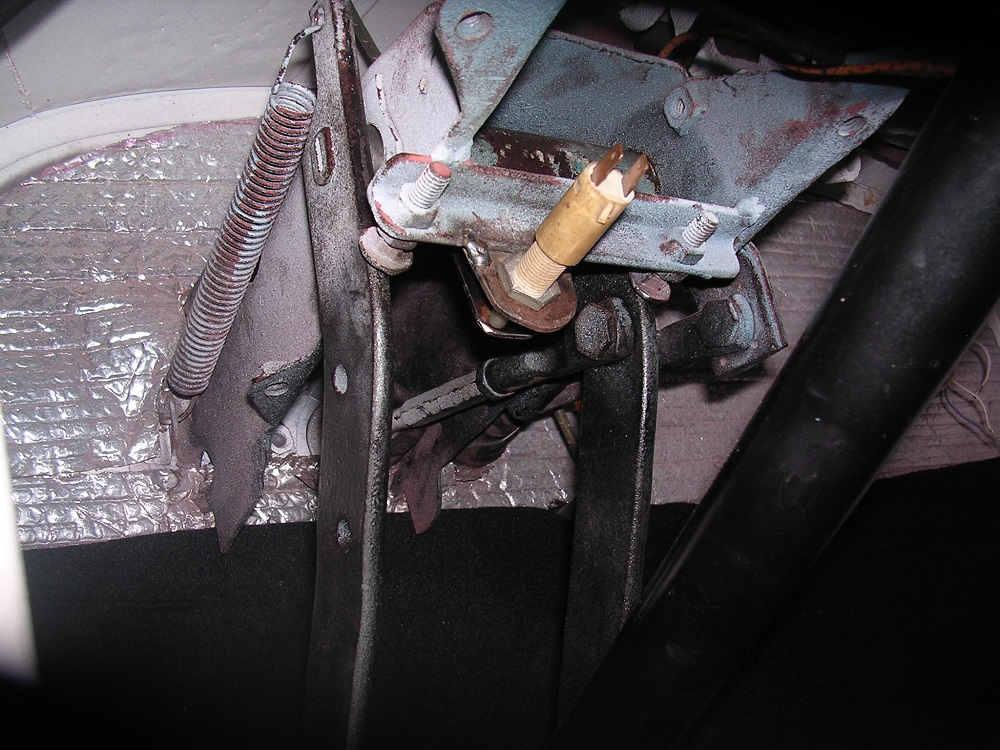

    here is my 60 pedal setup modified with small pads. Relocated 60-66 Chevy truck brake light switch. And a piece of angle iron with two welded nuts for the adjustable stops..with lock nut on each.
    Under dash pic:
    You can see one OEM Chevy return spring, and it hooks to the pedal with an extension on the top of pedal. You can weld an extension on yours if that is where you want the spring.
    you can also change where you want the brake switch, by welding a similar extension, either below the pivot or above it.

    Just a quick response, yes I did remove the brake residual valve and the shiny silver between the pedals is a cut tube to act as spacers. Eventually I will figure out brake light switch, neutral safety switch and pedal stops with springs. Thanks for the tips
