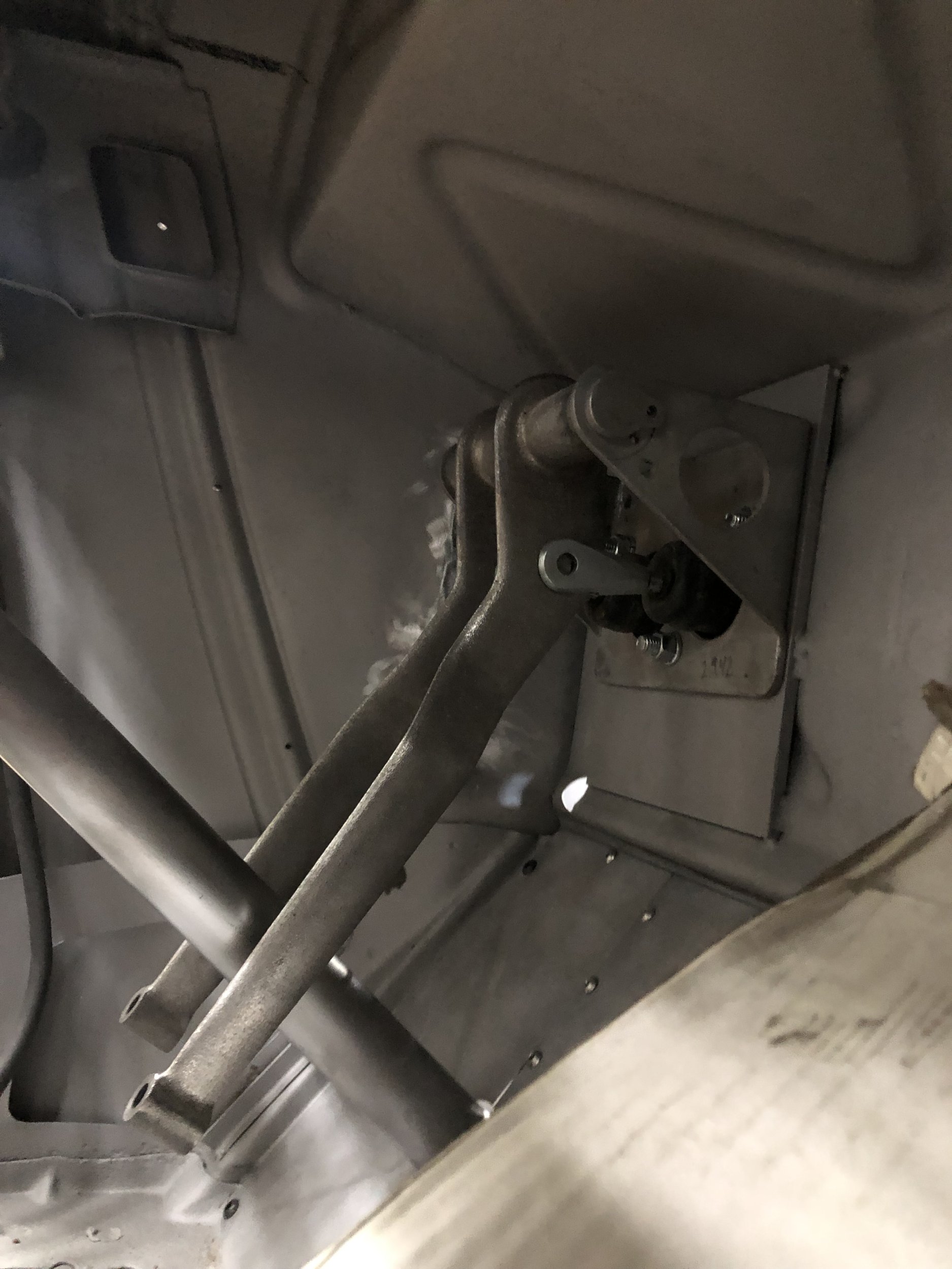

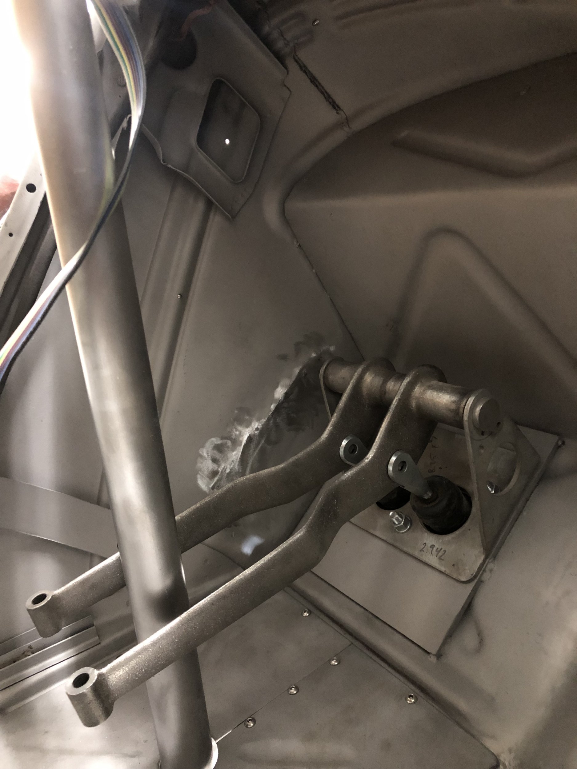

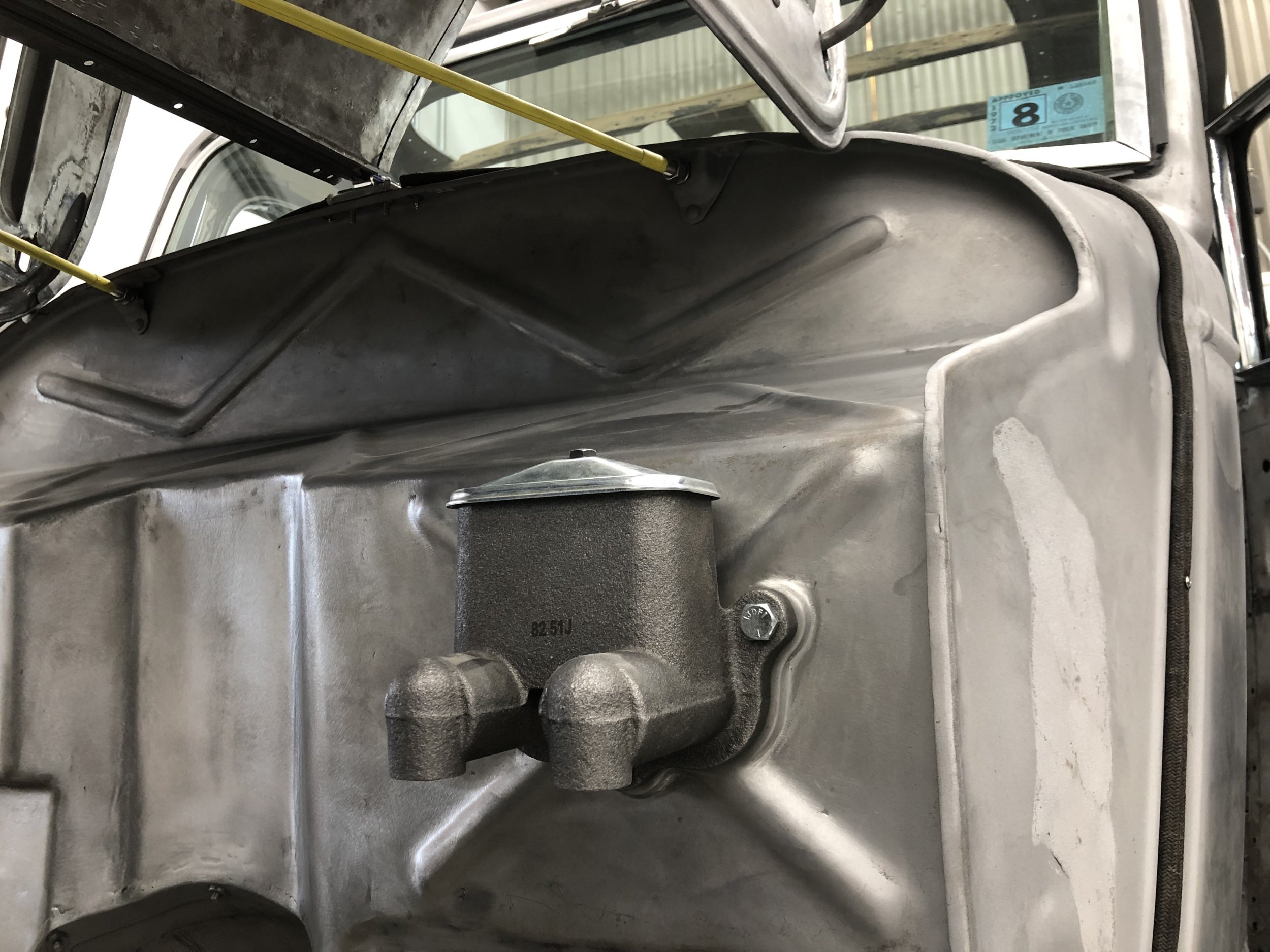

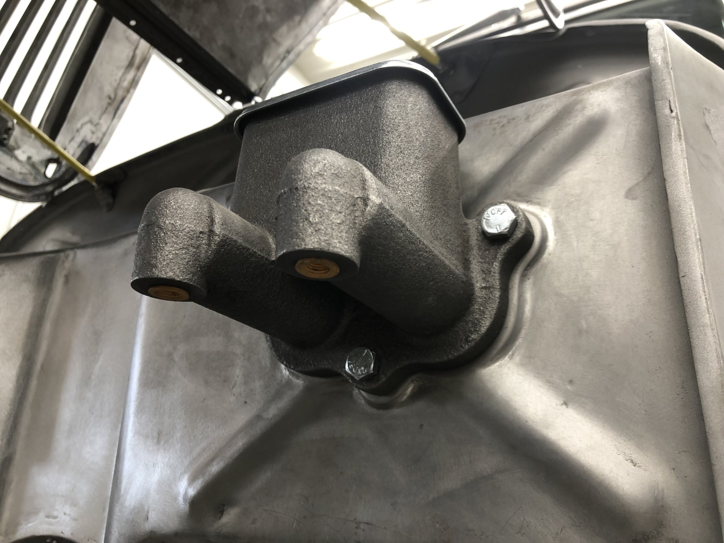

    This is from a few years ago, The mount/pivot bracket is still ansen but the rest I made. we were looking for a little more angel away from the toe kick and room around the column. then heavily ground radius’d and scaled for that cast look

    Dam good looking. I've done a couple swing set ups from R-Jays and have step drilled the pedals and m***aged the pedals like yours.
