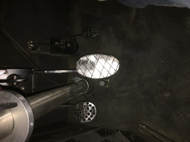

    Hey everyone, thanks for the help,
    I'm wondering what I should expect from my brake setup as far as stopping performance.
    This is all in my model A coupe, 2500lb, bias ply skinnies.
    Here is my complete setup,
    Front drum 12x2 dendix style new from speedway.
    https://www.speedwaymotors.com/Bendix-Style-Brakes-for-1937-48-Ford-Spindles-12-x-2-Inch,32648.html
    https://www.speedwaymotors.com/12-x-2-Brake-Drum-for-Bendix-Style-1937-48-Ford-Brakes,5847.html
    Rears 11" brake kit from quick performance
    https://www.quickperformance.com/Ford-9-Inch-Drum-brake-kit_p_4031.html
    Rjays ansen style single reservoir M/C which they provided. (I did swap the internal residual valve with as they are backwards on the stock M/C as instructed)
    https://rjays.com/shop/ols/products/rjays-firewall-mounted-clutch-brake-kit
    3/16ths brake line and a line lock for the front.
    I have about 5000 miles since finishing the car, they work ok, I can stop and slow down moderately, but I cannot get the brakes to lock up. From what I see the brakes all stop evenly, I don't have a lot of pedal travel until its rock hard and fully applied.
    When inspecting the shoes, the fronts may have a bit more wear on the leading edge of the one shoe, but this isn't adjustable with self aligning brake in anyway?
    I have adjusted them a number of times, thinking they just needed to break in, I usually go so there's drag and hard to rotate tire them back off to very slight drag. Each time I have adjusted the all seem to take about the same amount.
    I'm guessing all this is normal, and probably mostly due to the pedal ratio in these setups?
    I have not measured this, but would seem most likely?
    I do have line lock, if I hold the brake down hard and lock the front it will drive through them, I had hoped it would hold better for when I put slicks on and go to do a burn out. That's really the only reason I have been wondering about locking them up, and a search on the hamb has most saying that it should lock up all 4 corners.
    If there are any suggestion I'm all ears,
    Thanks.

    From what your describing I would question the pedal ratio, but that would be hard to change. You might see if you could get front brake cylinders with larger diameter pistons. That should give you more pedal travel and mechanical advantage to the front brakes.

    Just went and measured my pedal, pivot to push rod is 3", and to pedal is about 11.5", so only 3.8:1 ratio. Should be probably 15" atleast long for a 5:1 ratio so yeah 3" longs would make a huge difference.
    Probably whats going on there then.

    The ratio is push rod to pivot vs pad to pivot. Measure the pedal arm from the pivot all the way to the pedal. Is that 14.5"? If so, that 4.8 to 1. Still not the prescribed 6 to 1 standard, but better than 3.8 to 1.

    Edit, Sorry I wasn't clear earlier. Both were measured from the pivot.
    It is 3.8:1

    I think I will cut off the end and add as much as I can, I do understand that manual drums should be 6:1. That's almost twice the force, crazy. I thought I was getting on it pretty hard, that going to create a lot more force on the firewall as well.. Will have to look at that as well.
    I know I have enough 15" (5:1), or maybe try making a longer pedal and see how it feels before hacking too much.

    Move the pivot point ( new side brackets) and re-drill pushrod point...

    Made an extra long pedal today after work, locks them up in a panic stop pretty easily.
    Still wants to roll through with line lock but I’m sure if I dropped clutch harder it would be fine.
